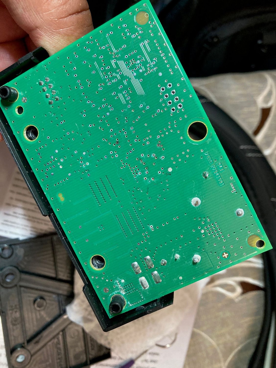

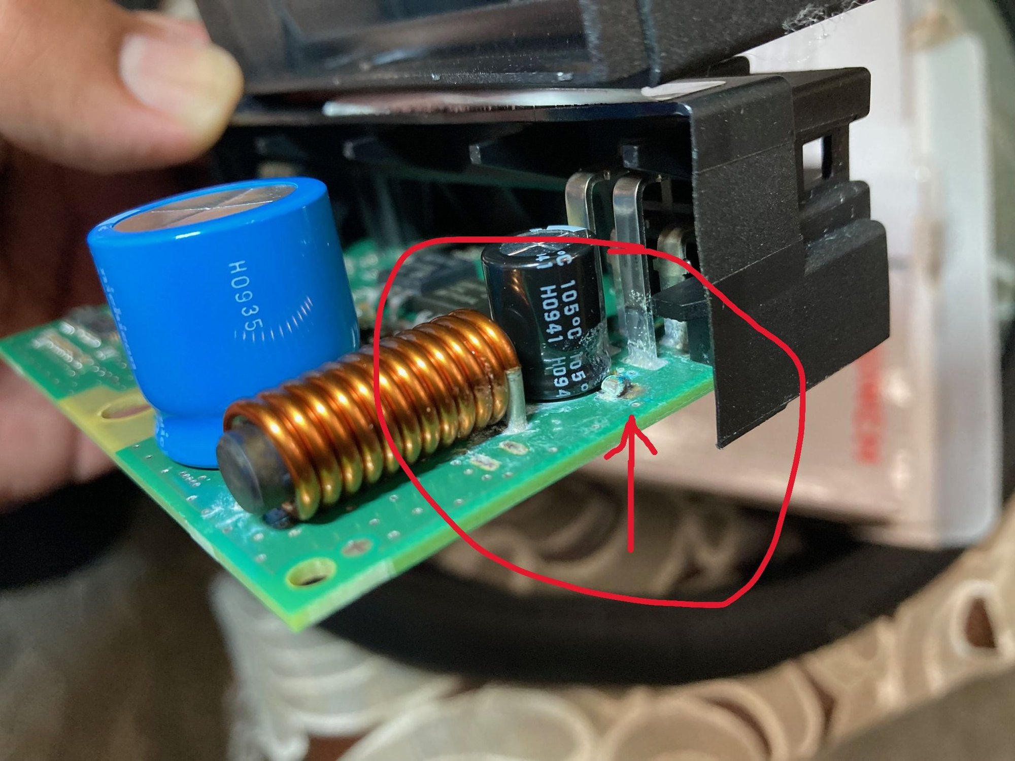

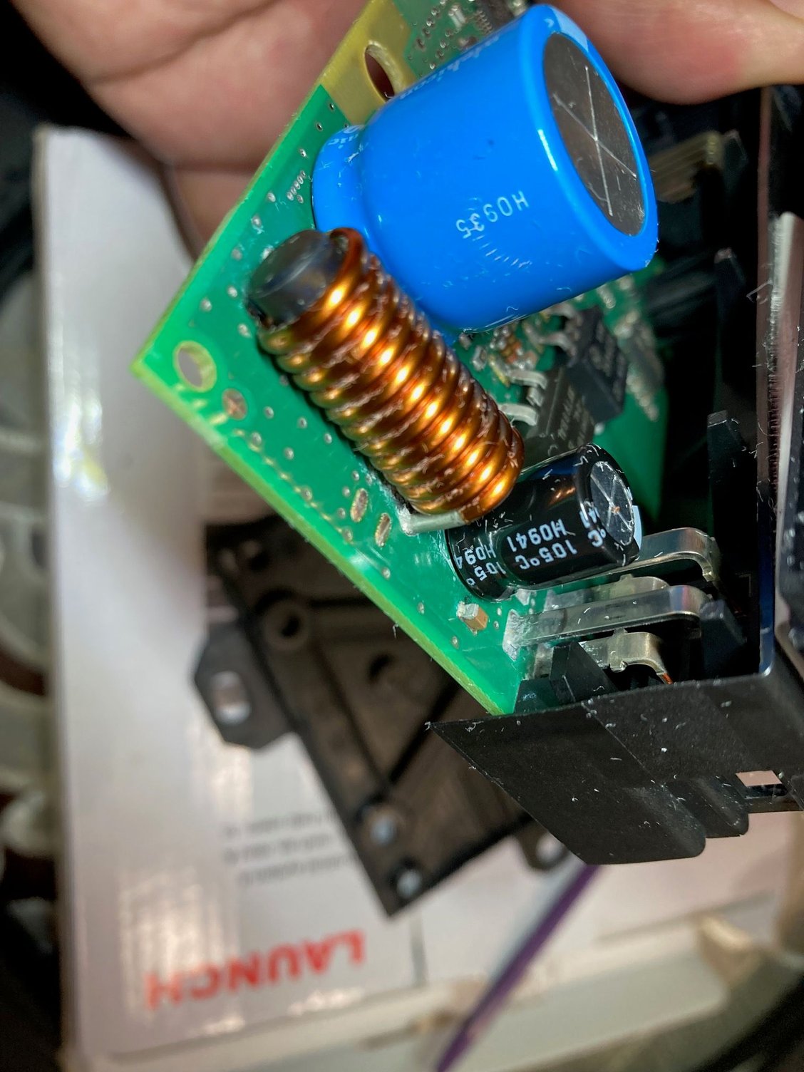

Old Jul 18, 2025 | 10:13 PM
ISMAELX's Avatar
Joined: Jan 2017
Posts: 20
From: Ventura County, California.
2010 E350
I received the new scanner, Launch creader elite 2.0 for Mercedes Benz.
It shows 3 codes, same as my BlueDriver scanner
ECM - Engine Control Module (ME)
2145 The output for the fuel pump has a short circuit to ground
2269 The pressure in the low pressure circuit is too high
FSCU - control unit "fuel pump" (N118) code
062900 The output for the fuel pump has a short circuit to positive
Checking live data from FSCU shows:
Live data Qty (6)
Battery Voltage 14.30V

I open the FSCU and I found some kind of mold, look at pictures, I clean it really well with a toothpick and Clorox wipes, after clean it up it doesn't look like it's fried, what do you think?

WATER SOAKED FSCU
And to answer your questions, I can hear the fuel pump only when I turn ignition to second position.
Good job: there you have it! Your FSCU got soaked...
Fix the water source to prevent repeats offense.
IGN-2 Pump should time out after 15.Seconds or less....not run non-stop!
You may get lucky cleaning the circuit board - It does not look real bad: 70/30 chances.

Yes, the FSCU inspection revealed the oxidation all over the circuit board. It is now officially proven bad.
At least pump is kept running and control module responds to network but its functions are impacted... module is nearly junk.
This FSCU runs directly on VIP engine CAN-Bus. It must be reliable on its best behavior to prevent aggravating ECU/TCU networking delays.
You may want to brush on a layer of protective coating on your new/used replacement module. This will help prevent failures besides finding the water source that caused damages.
