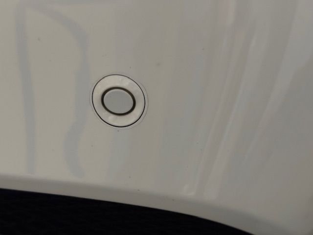

My dear wife was washing the car today and told me something was wrong. She pointed to a sensor on the front of our car and said, see there. Something is wrong. Fix it. Sure dear.
Sensor pushed back into bumper
The way it used to be
So what do you think has happened to push the sensor back from the front of the bumper and what will be required to fix the problem?

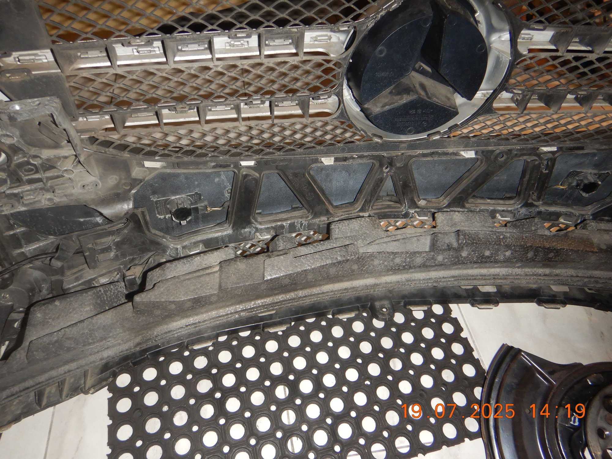

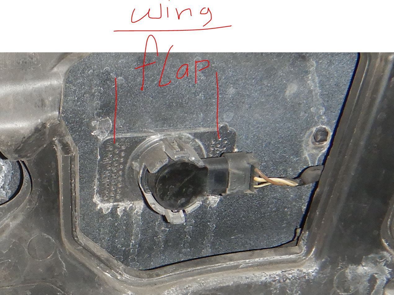

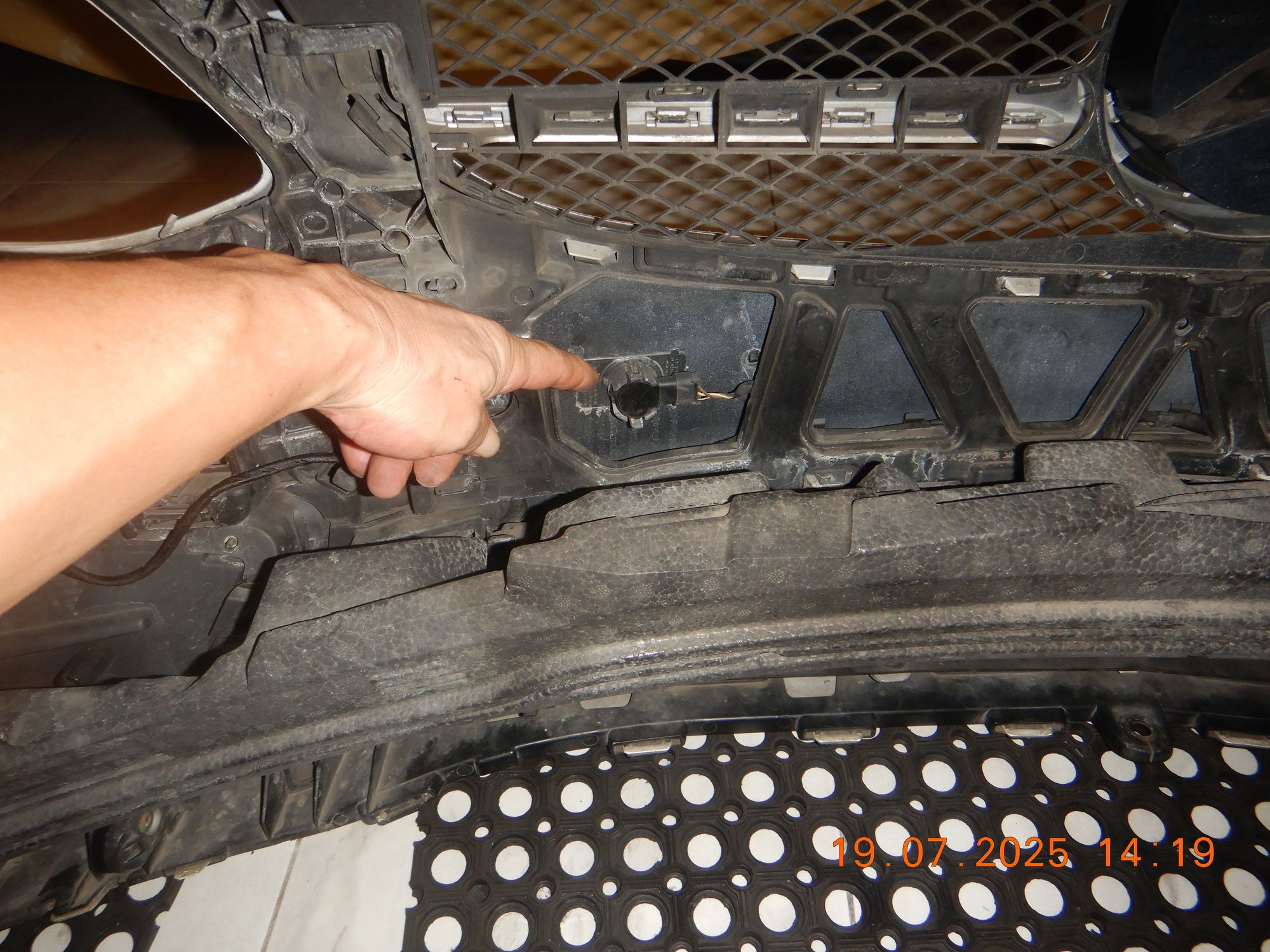

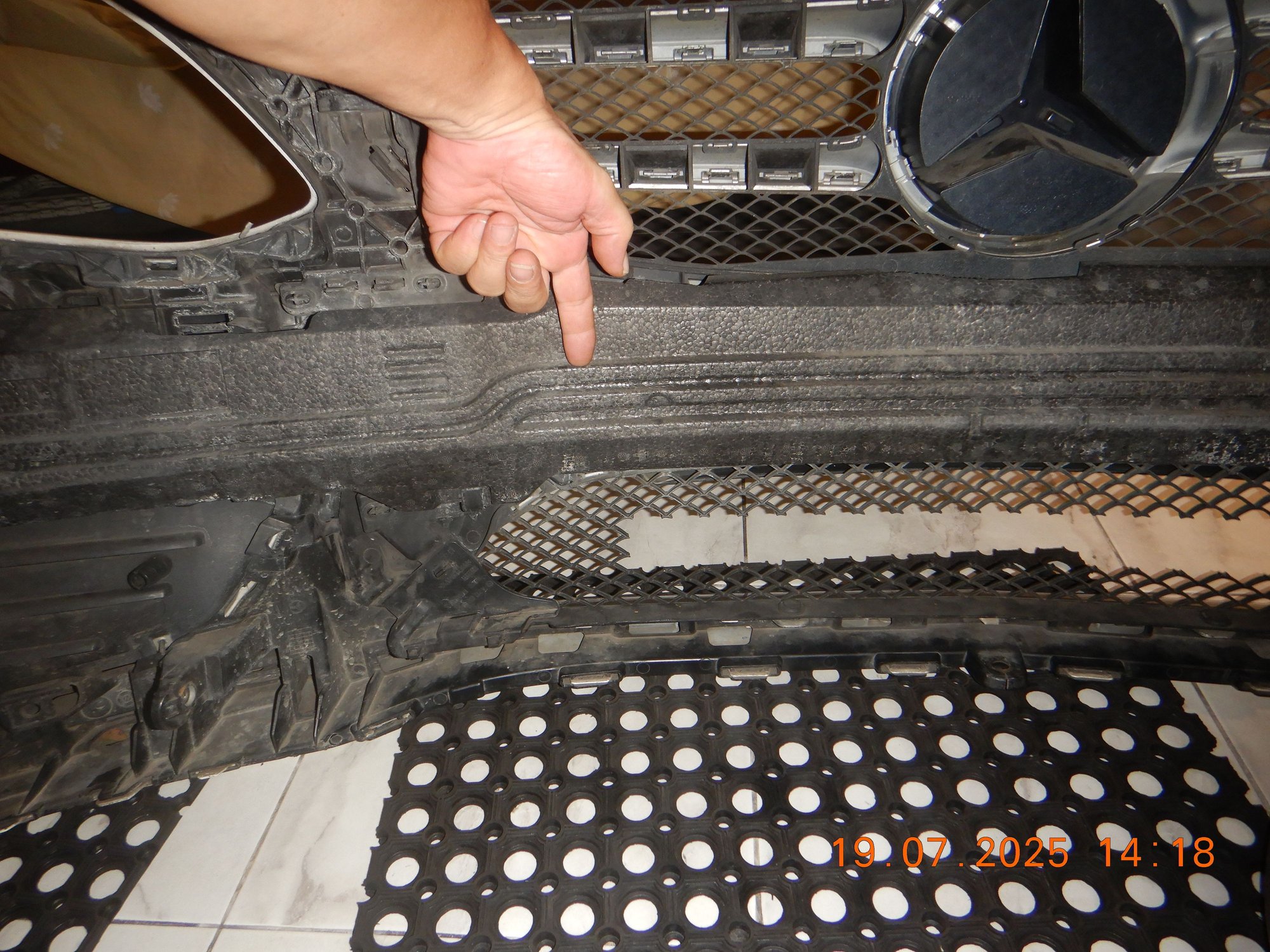

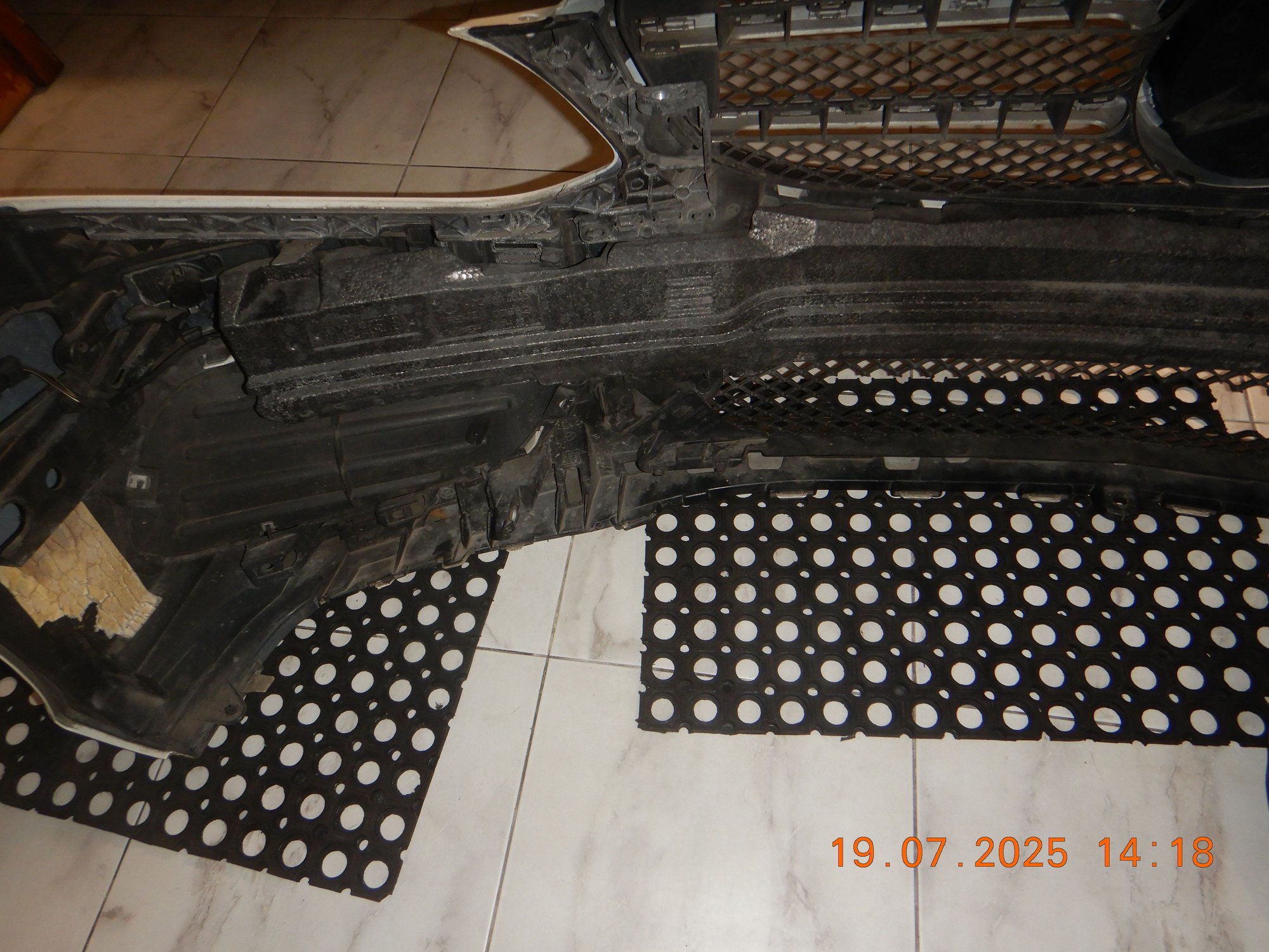

Let me provide you with photos of facelift version bumper inner side, which would suit your 2016 car.
Bumper removal is easy, but best two people.
Zoomed.
I will be also re-glueing mine, my right middle one lost its adhesion to bumper on one its plastic wing/flap.
Sometime ago like 2+ years ago, I also glued 1 side, same problem 1 wing/flap glue un-done, I forgot left or right side, but it is the side one.
Yep..... remove the bumper.
