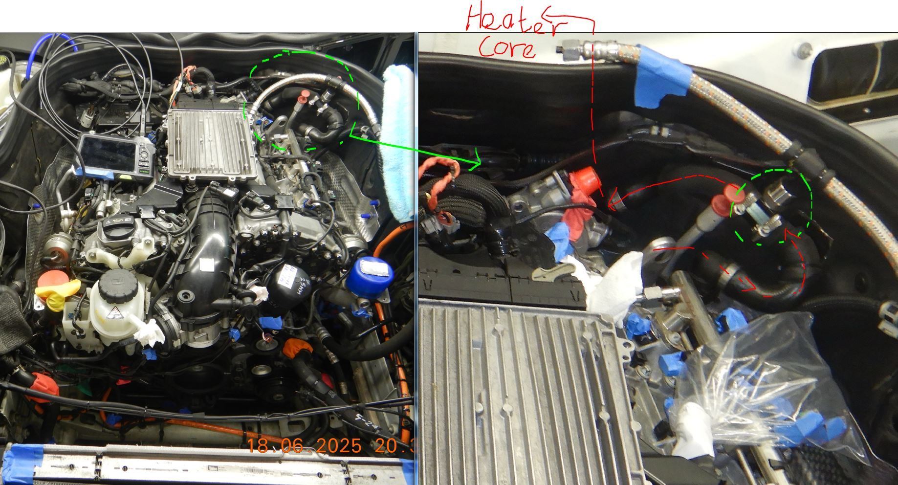

Here is a simple example of coolant pressure at the bank 2 rear azz output feeding the heater core of HVAC core vs RPM vs Coolant Temperature.
The only data I do not have but I know the temperature range is ...... is the thermostat full opening to flow coolant to radiator.
I am in the tropics, so its always hot.
This is the location of the coolant pressure sensor.... on my M276.820
So it is truly reading heater core input in terms of pressure and heater core output goes back to mechanical coolant pump INPUT .... with a Tee to 12VDC pump for heater assist.
This means the 12V DC pumps works on suction mode.
This the best location to tap coolant pressure , I been testing a few location and this is by far the best.
Azz view of ur M276 coolant output pipe to heater core
2 pipes

The picture of the 2 coolant pipes that goes to the heater core, located on the back of the motor that S-Prihadi posted, I see it's all plastic, so I'm wondering how often do they fail?
Looks like a pain to get to.
Might be a good idea to be proactive and replace that before it actually cracks and leaves a mess behind or get stranded somewhere because all the coolant leaked out.
You need to remove vacuum pump to do these two pipes.
You will also need to do 2 hoses downstream of these pipes if you are in there
1 hose from end of 2nd pipe to fake firewall engine (outer) side
1 more hose from inner fake firewall ( inner side ) to the heater core itself.
When you are there, get the o-ring seal for coolant temperature sensor, replace urs with new one.
The first pipe is holder or locker for the coolant temp sensor.
