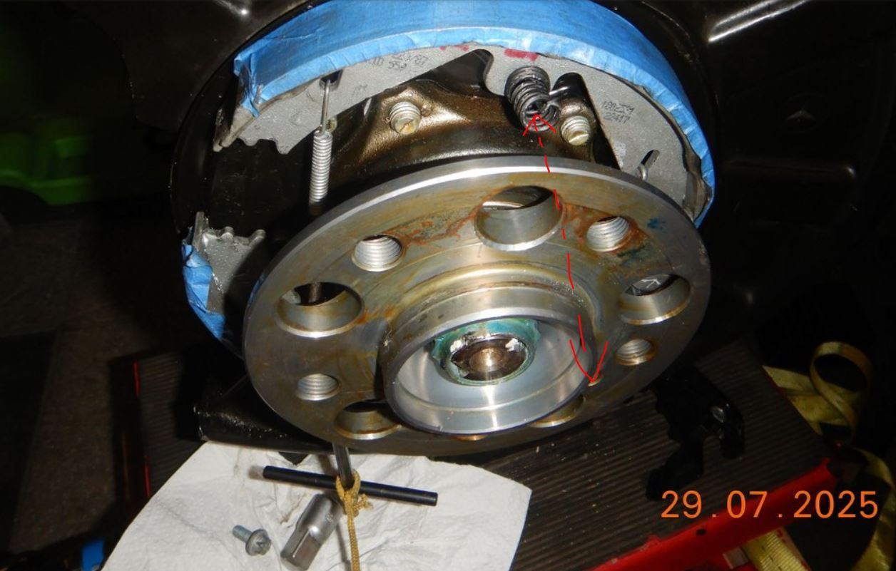

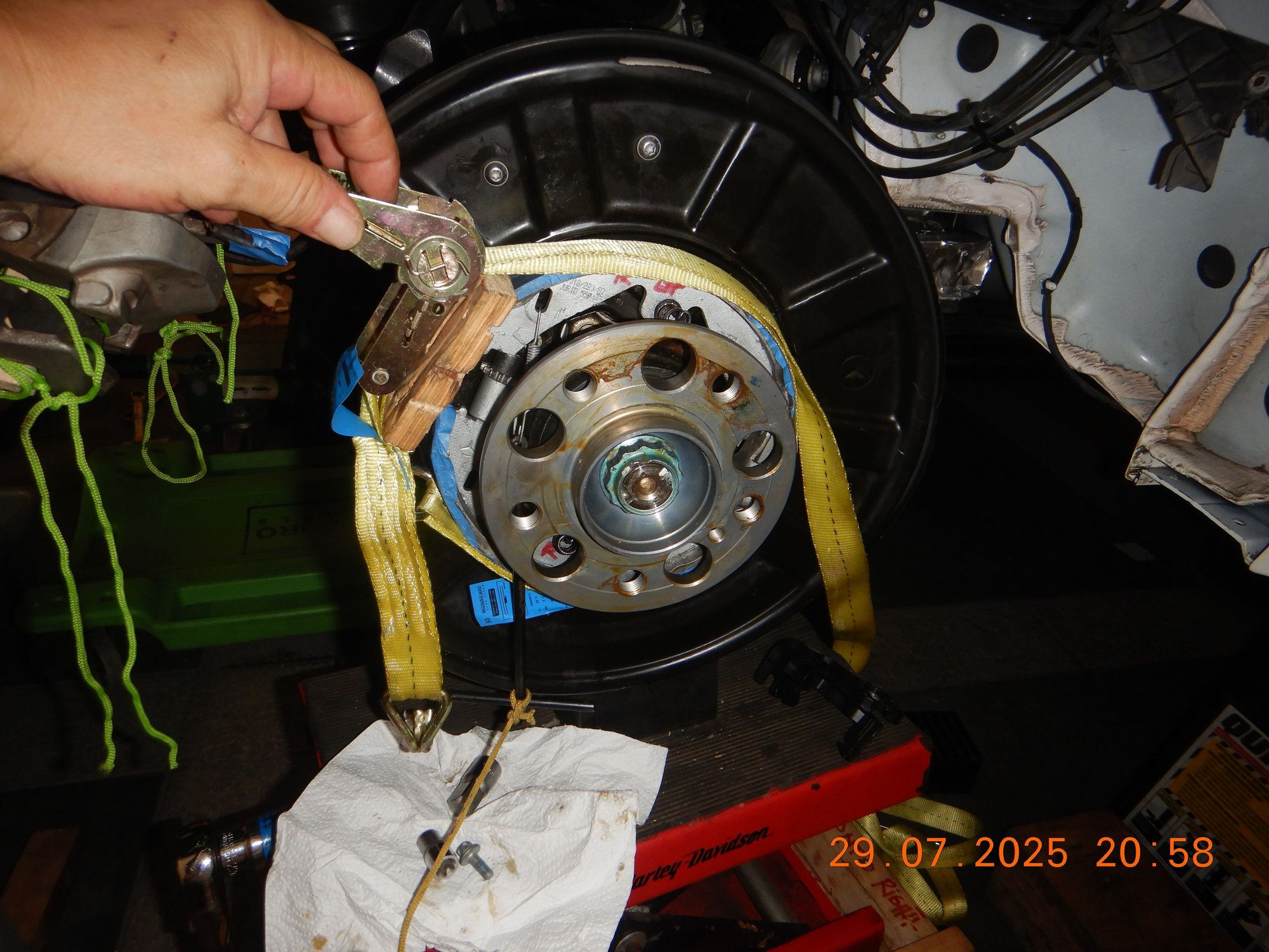

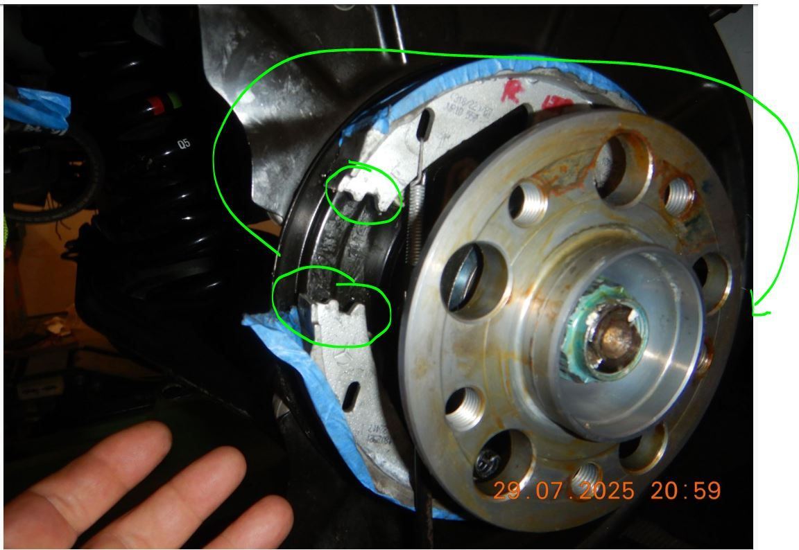

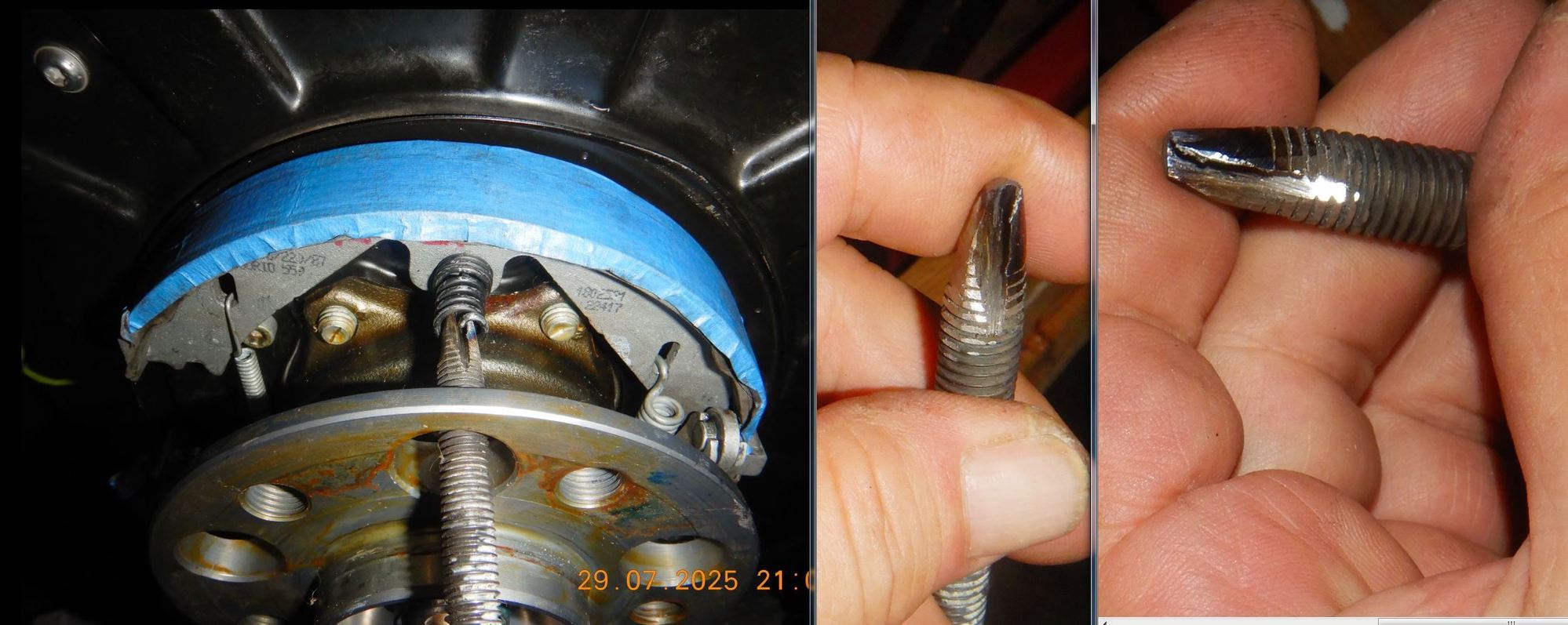

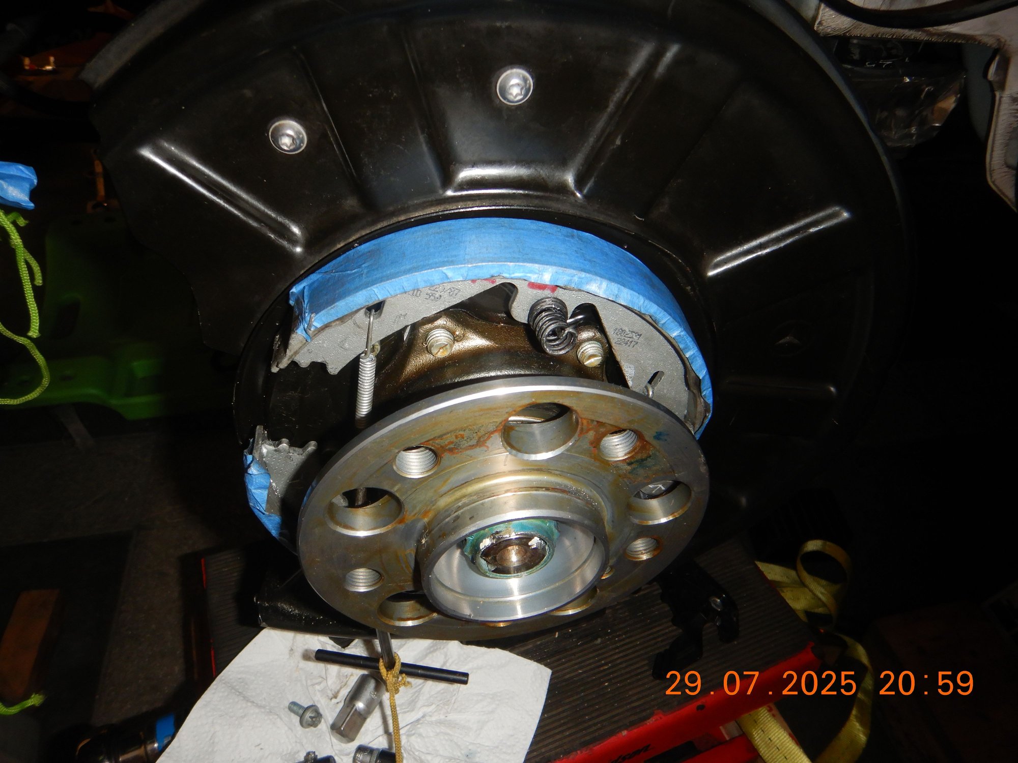

Anyway, I made an emergency version today. It worked awesome.
But me brain kinda dead today..........
Guess what I did wrong ? Below :
Make a guess.............

STICKY BLUE TAPE
You forgot to buy rear disks to get new Pkg drums or something about adjuster missing or up side down??
black grease
black petroleum grease
You used "high-temp synthetic brake grease" - It's a basic lubricant that quickly turns into a sticky glue. Only good as pads anti-rattle.

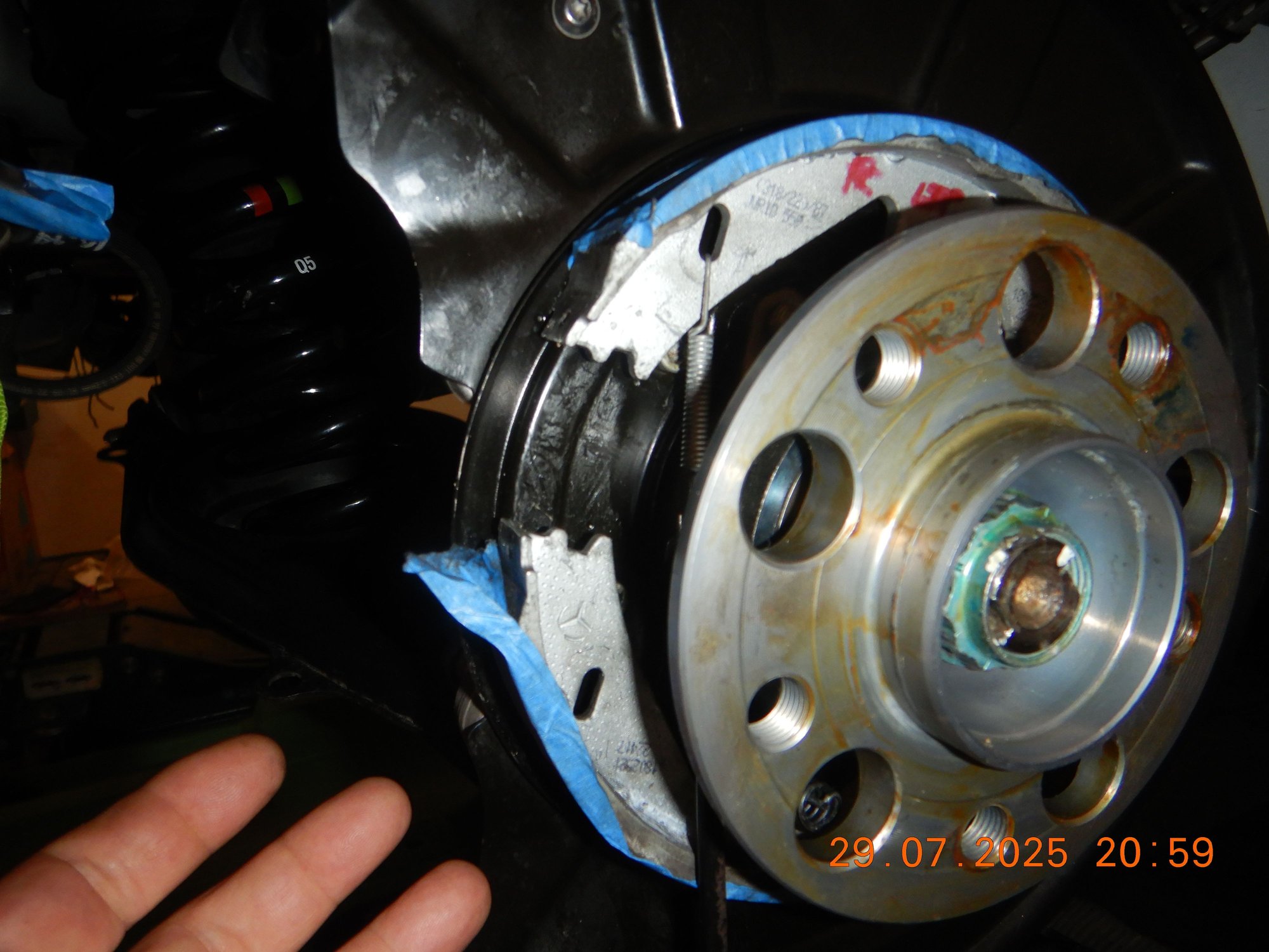

I place the parking brake shoe wrong orientation....lol
This side is for the pull cable and not adjuster...ha ha ha
Must be single protrusion ( teeth) and not double teeth if for adjuster.

Top side down parts... good thing you were not in rush to call this done! Your rear end is soon gonna be super tight.

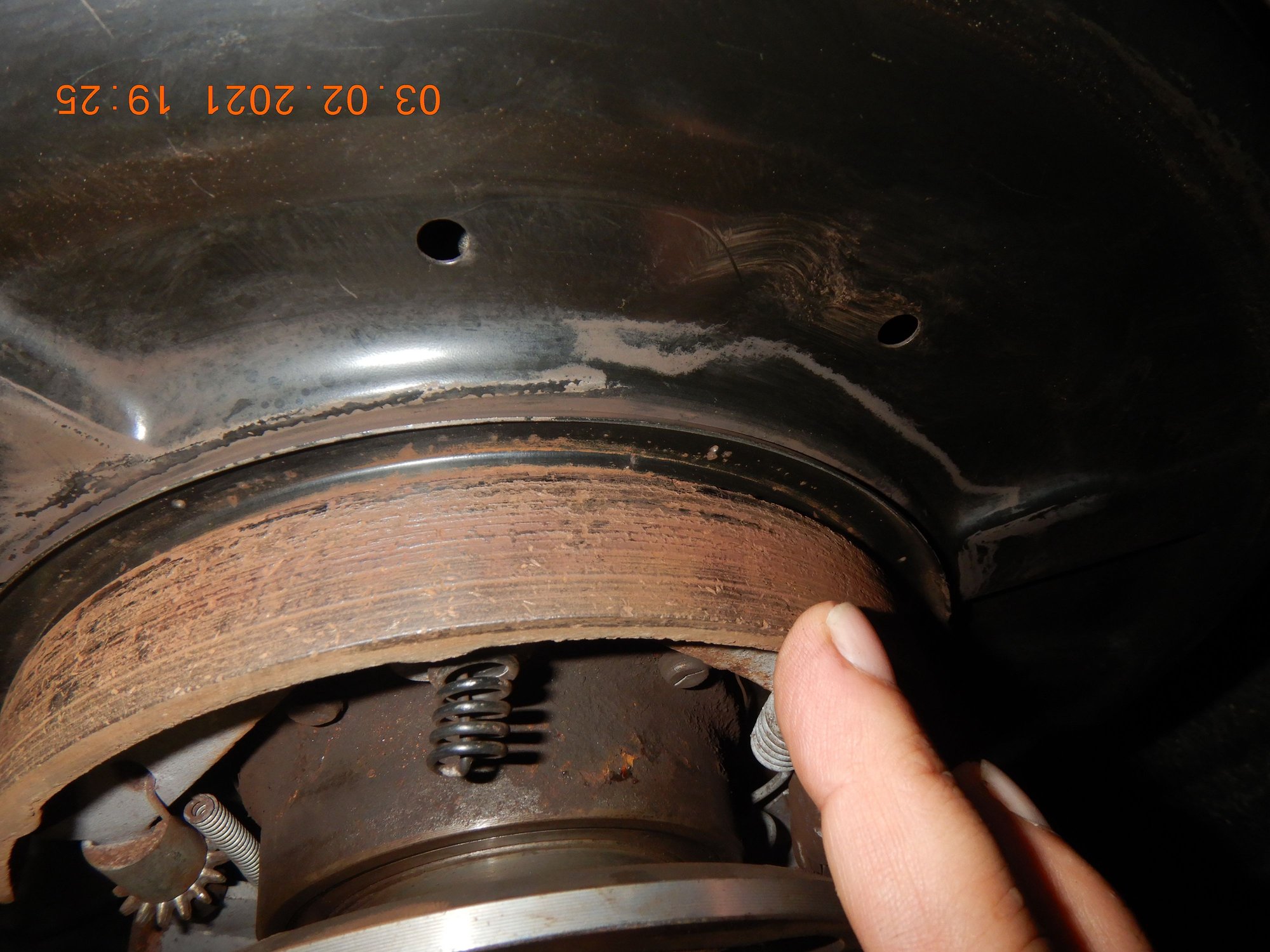

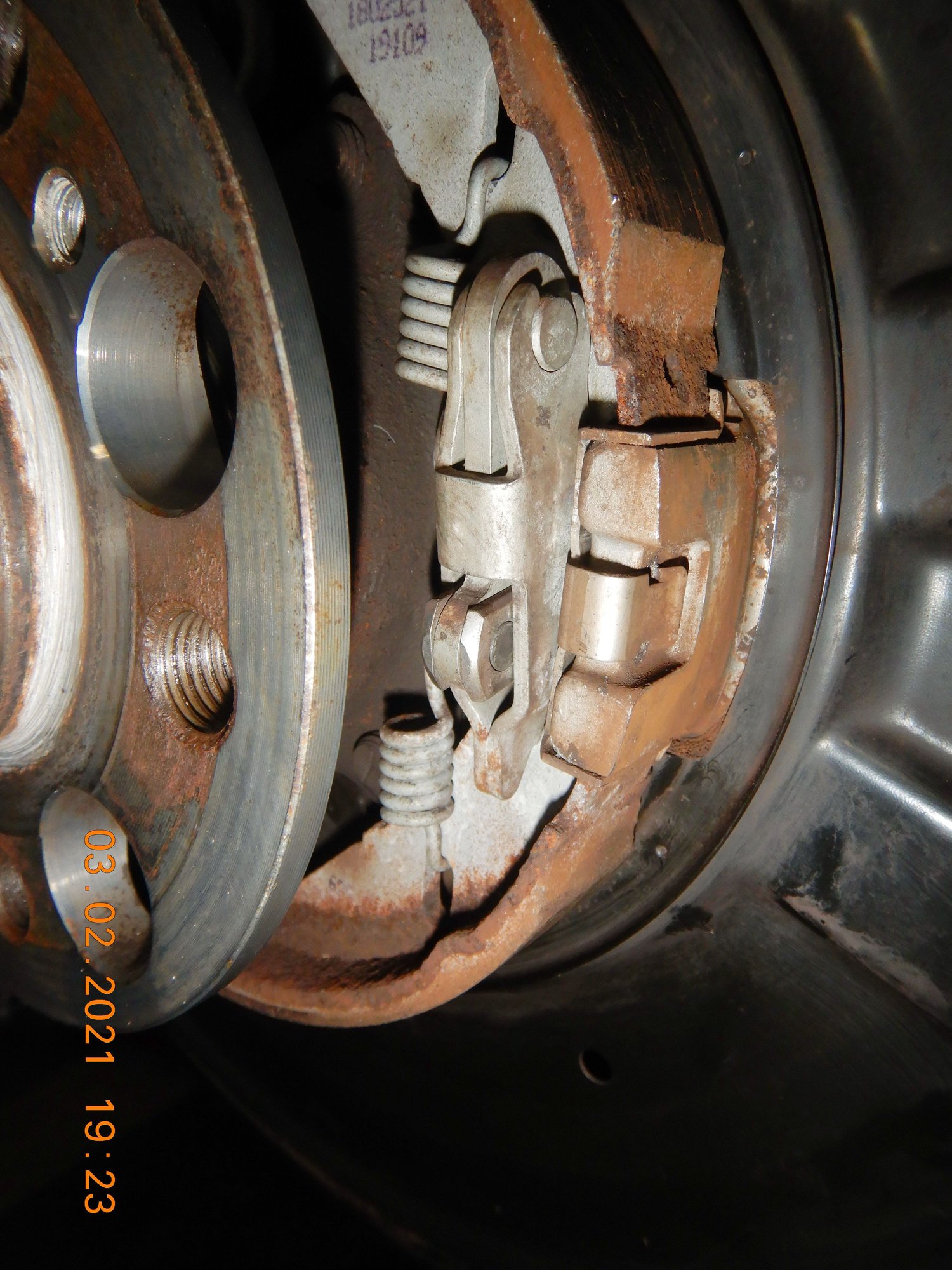

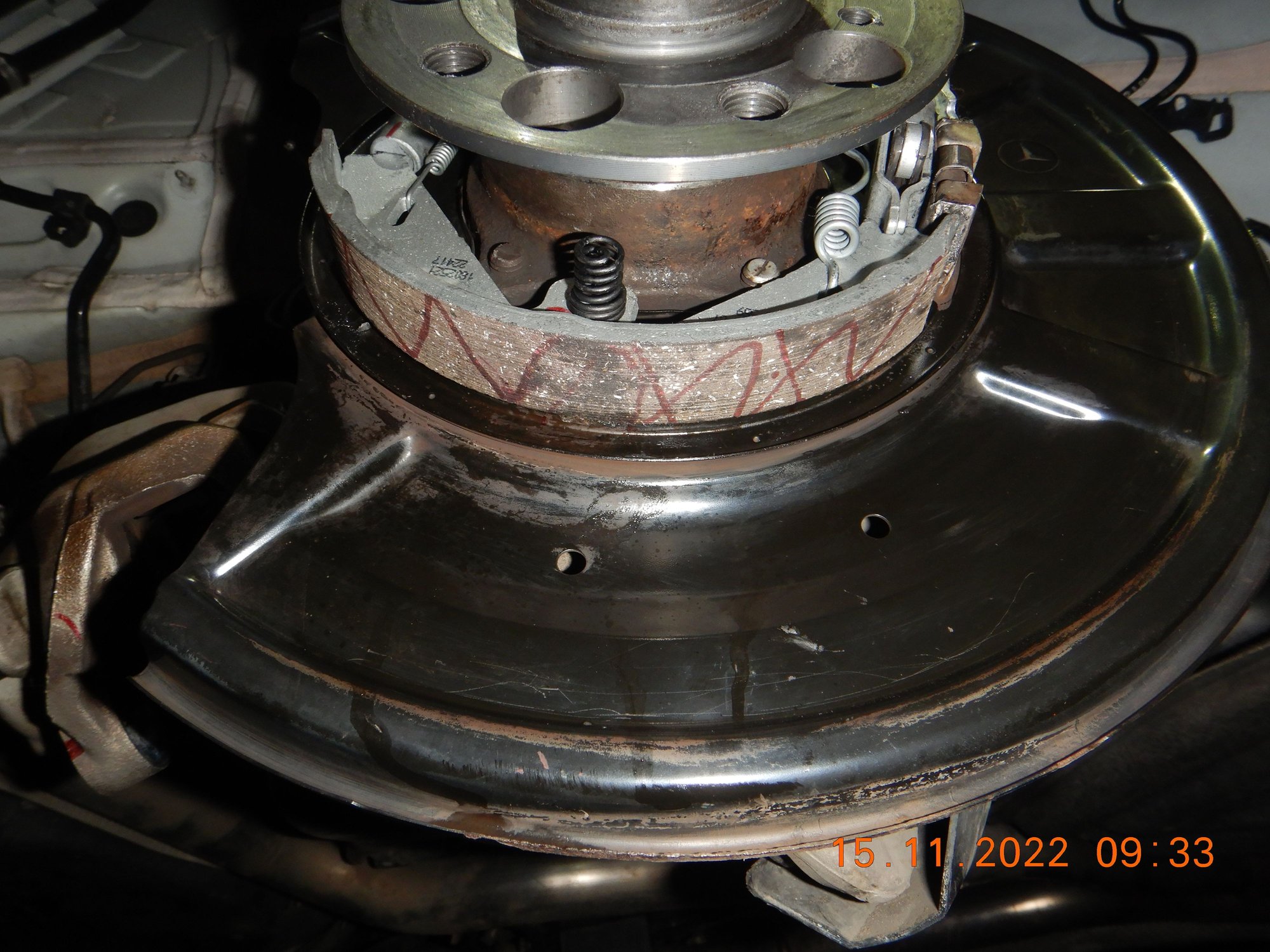

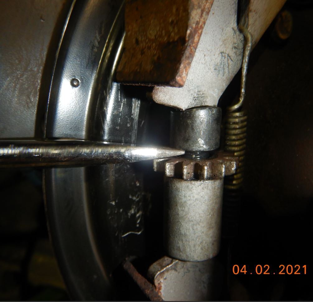

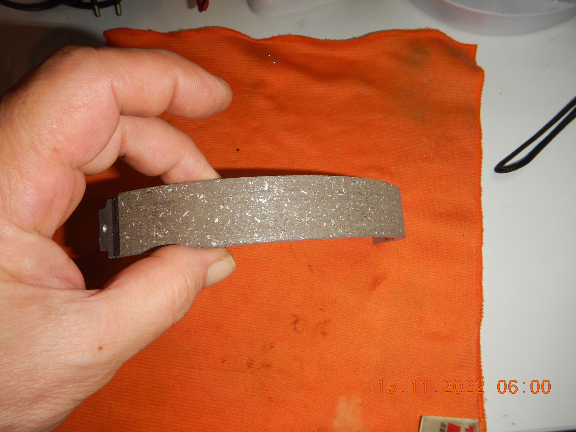

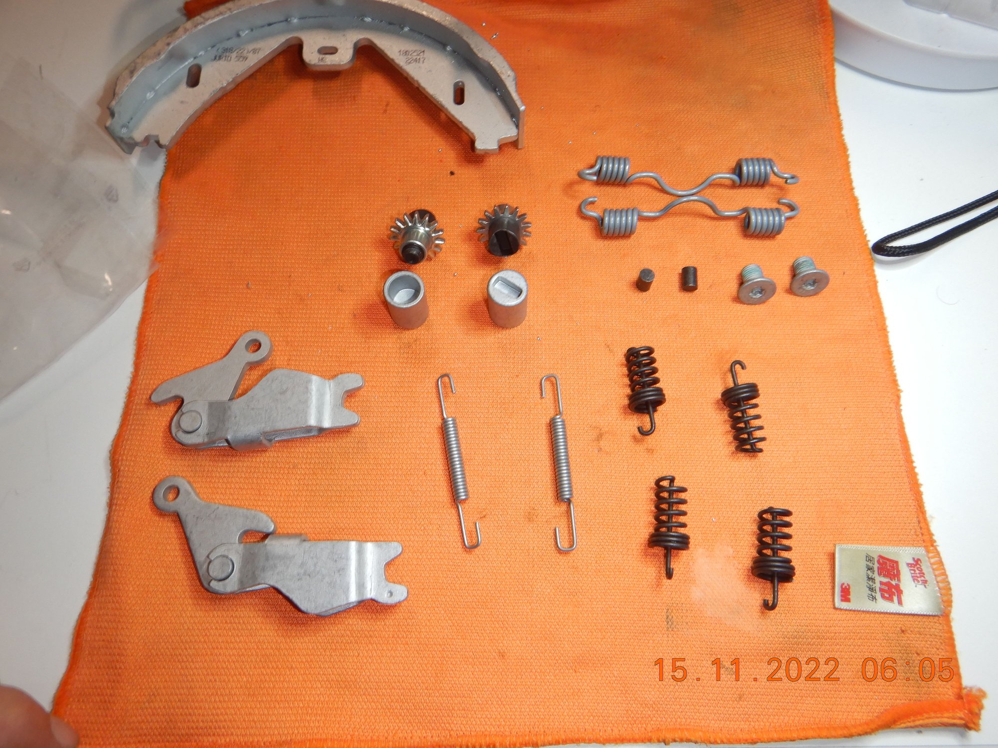

That was 2021 photo, of original parking brake pad to the car. After that I bougth all new ones. I hate rusty looking parts.
If must be rusty due to washing car very often by 1st owner and my driver.
Once a week car wash is mandatory, due to dust.

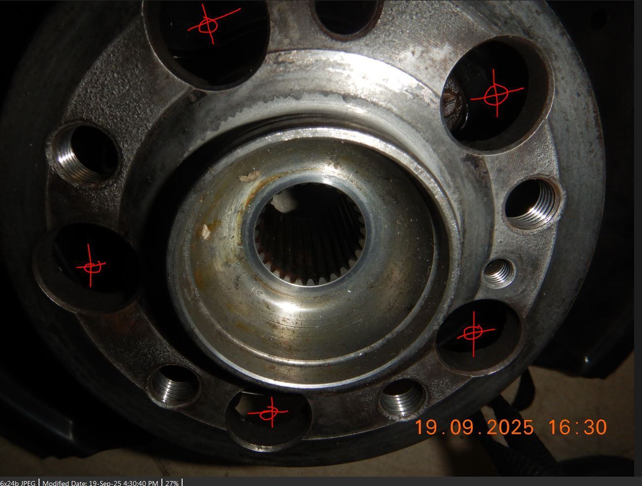

Even my rotor disc inner side, the contact surface for parking brake is not smooth...due to rust.
Look at the old parking brake shoe....what a disgusting surface condition.
New set in 2022 till now........ parking brake don't get thin down from use, it dies of rust dust.....

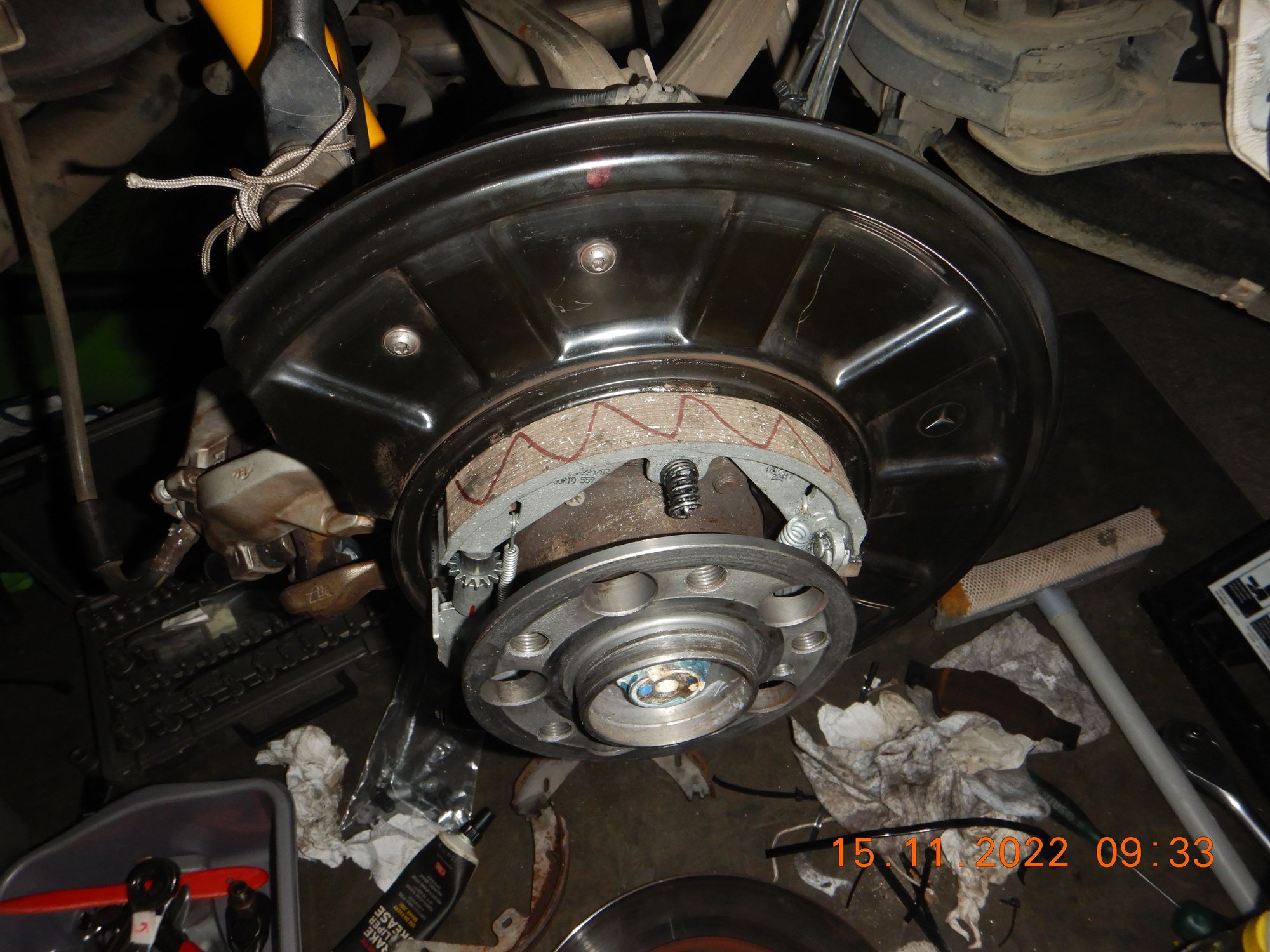

Touch/contact zone marker...
Above at bottom is the blackie brake caliper grease

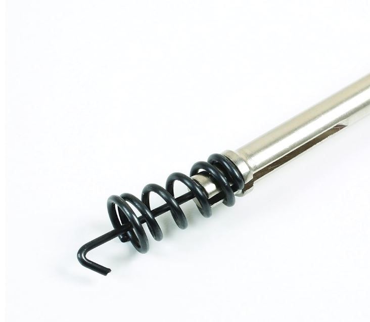

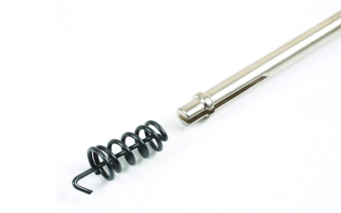

I use needle plier too, but it is not as good as it can be using the DIY tool or that proper special tool.
Pushing in maximum while twisting is very easy with the special tool, no slippage.

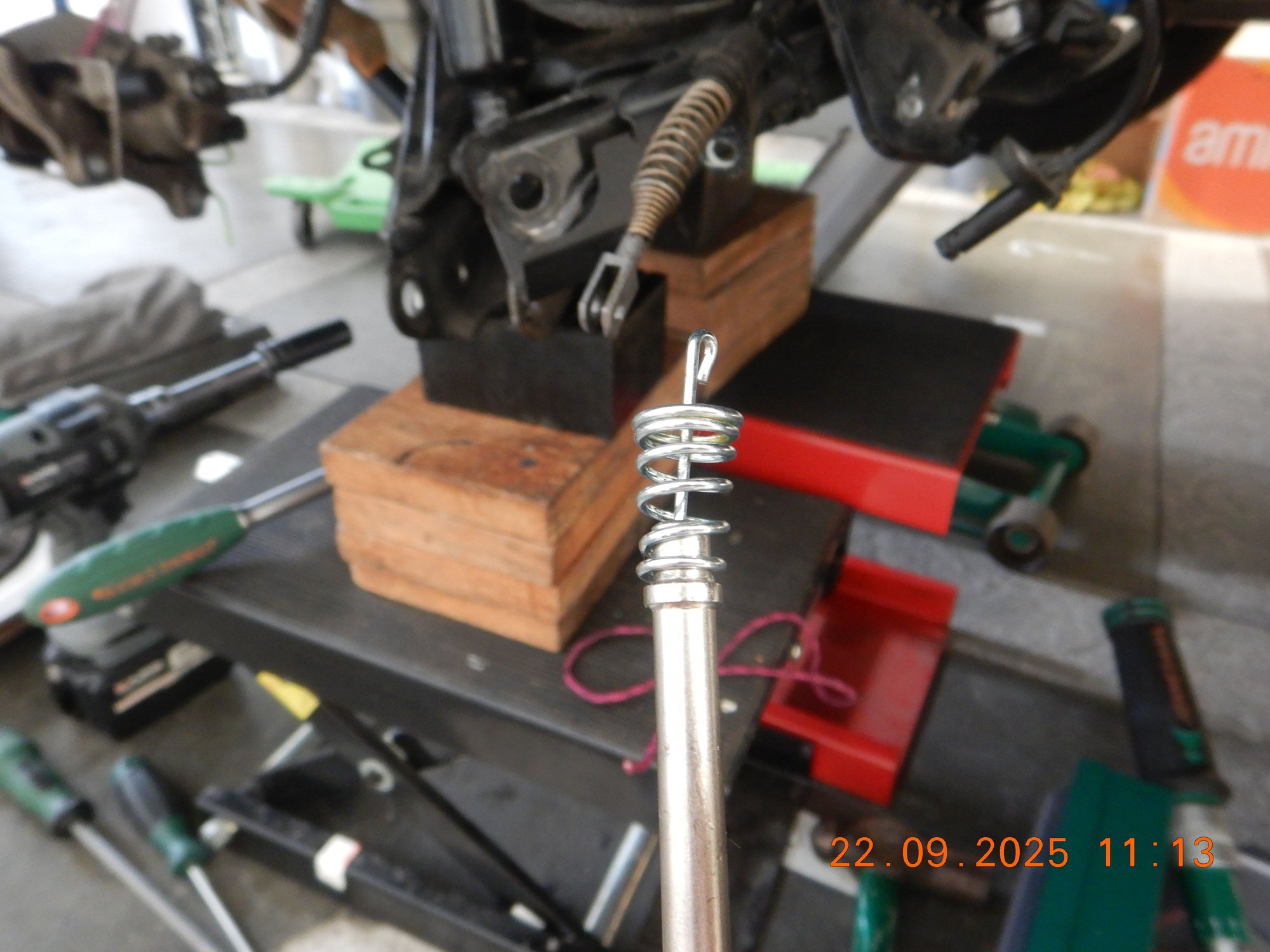

Old Sep 22, 2025 | 03:03 AM
S-Prihadi's Avatar
Joined: May 2018
Posts: 6,600
Likes: 6,547
From: Jakarta-Indonesia

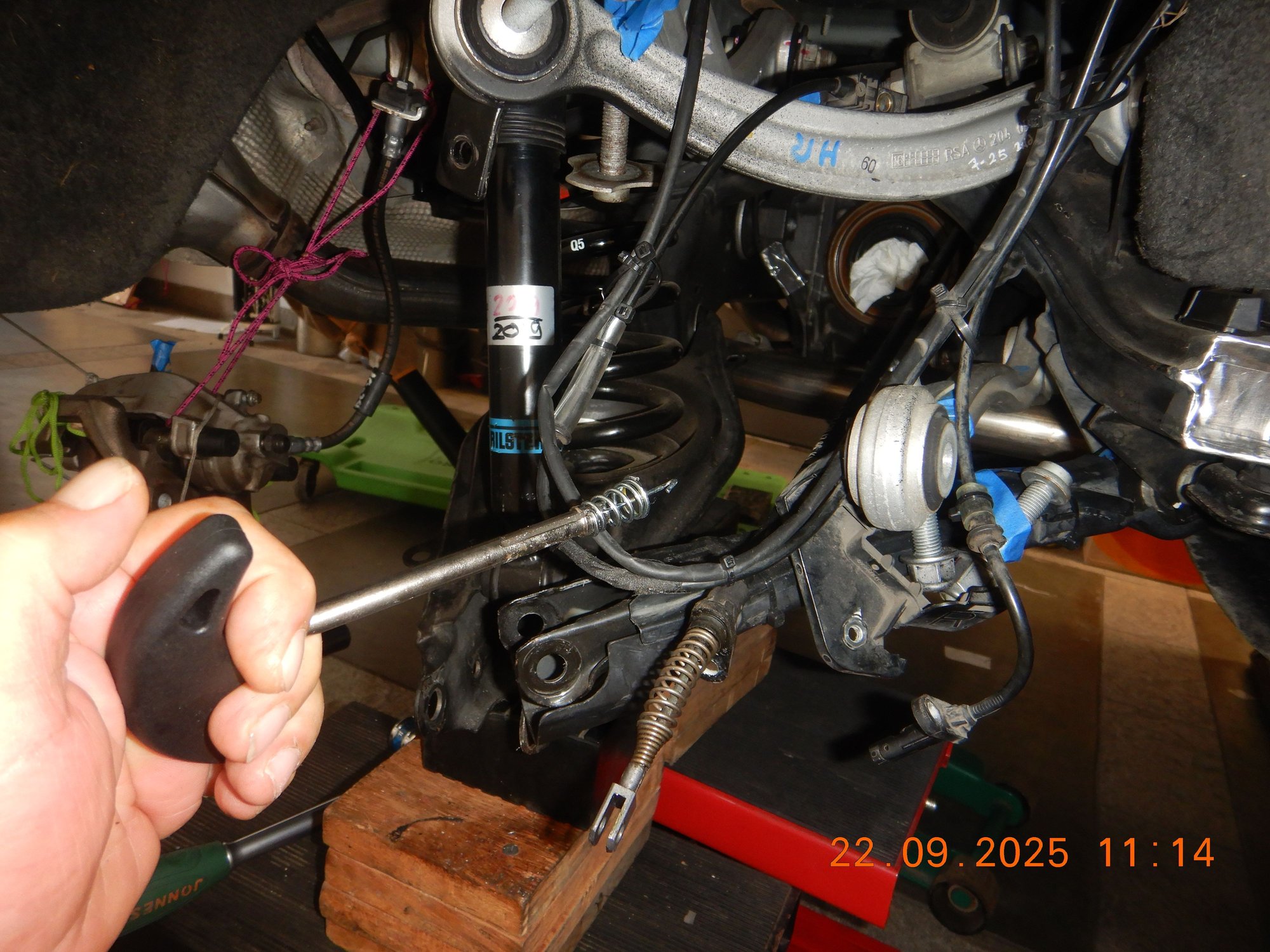

This cheap tool is so worth the money

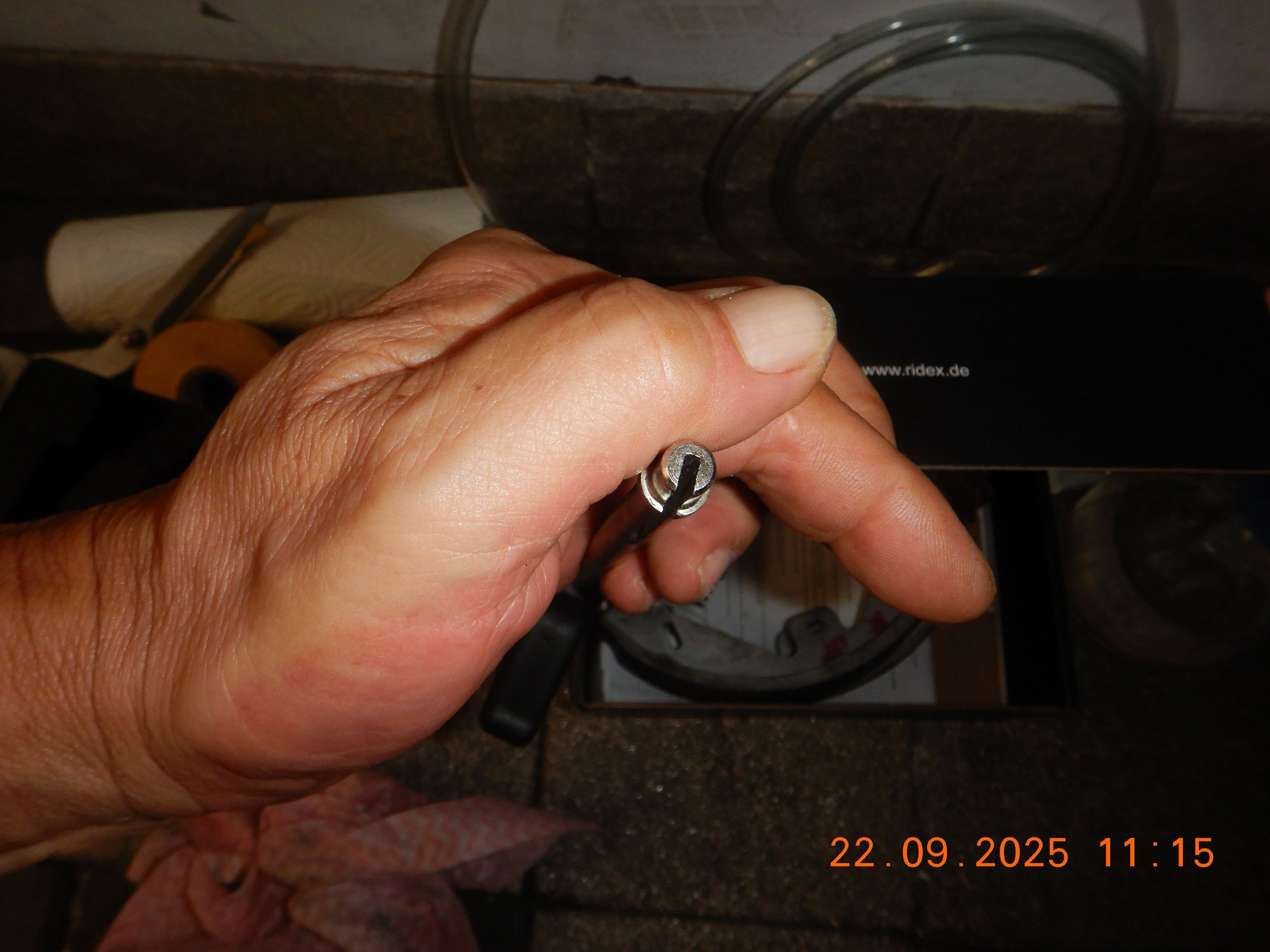

The tool shaft dimension is very accurate, the spring stop edge is just nice and the T handle is good , removing and inserting the spring is so easy now.
With plier you must apply constant force to keep jaw closed to bite the spring, plier handle is not a T handle where you can spin easy and fast and no need to apply any force to a plier jaw.
Plier actually damage the spring cosmetically because it can only bite a tiny bit of the L shape part of the spring.
The middle cut slot to hold the L shape part of the spring is most important, because this L shape is a marker too for where the other end of the spring is at, the hook shape end.
The tool grip the L shape part of the spring nicely, no need effort on our part to "grip" the spring like when using plier.

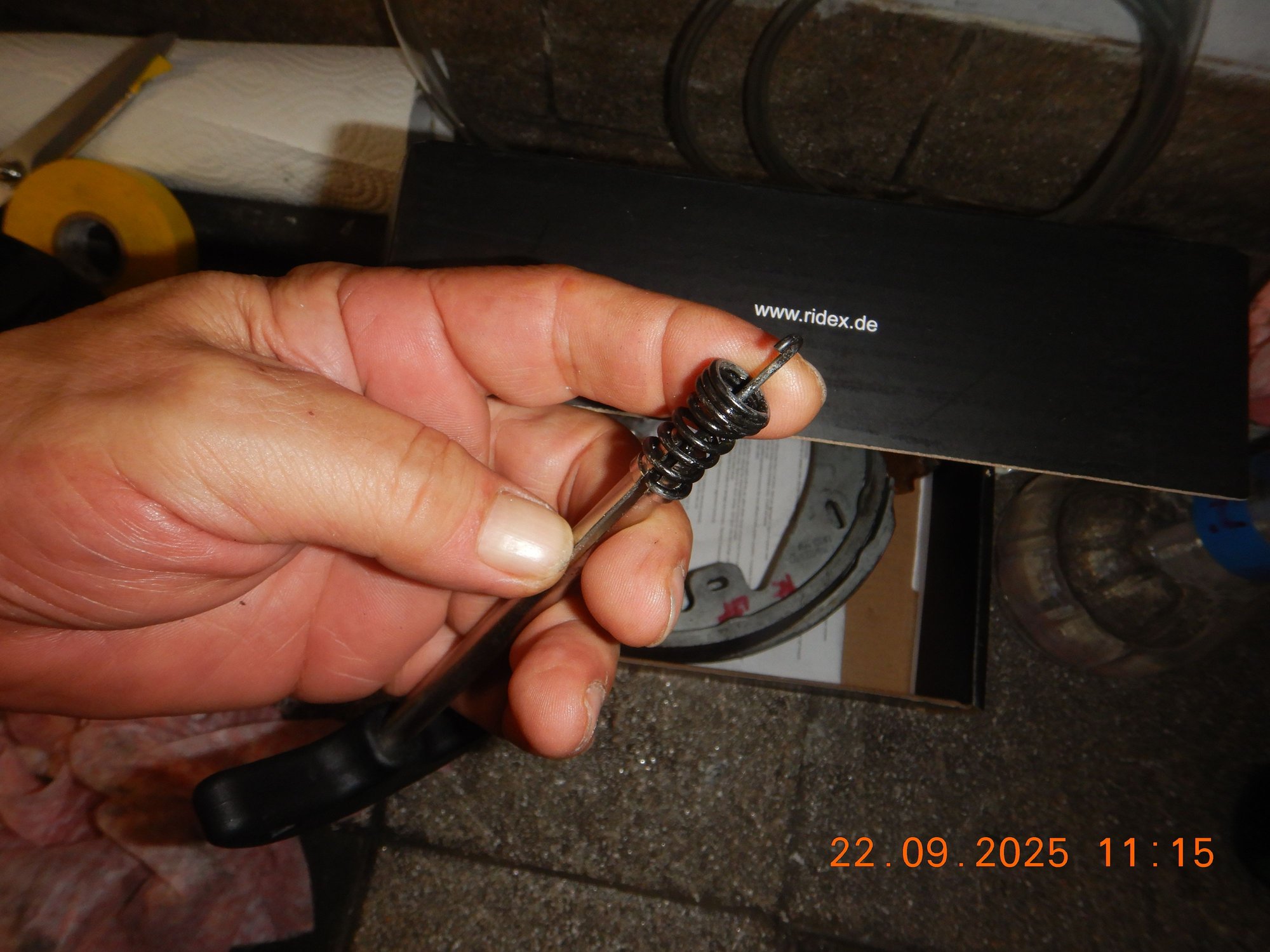

Black is MB original spring. Shiny one is Ridex spring.
Total I have removed and re-install 4 times the parking brake pad and this cheap tool is a must have, too cheap to NOT have if you want to do parking brake pad with ease.
