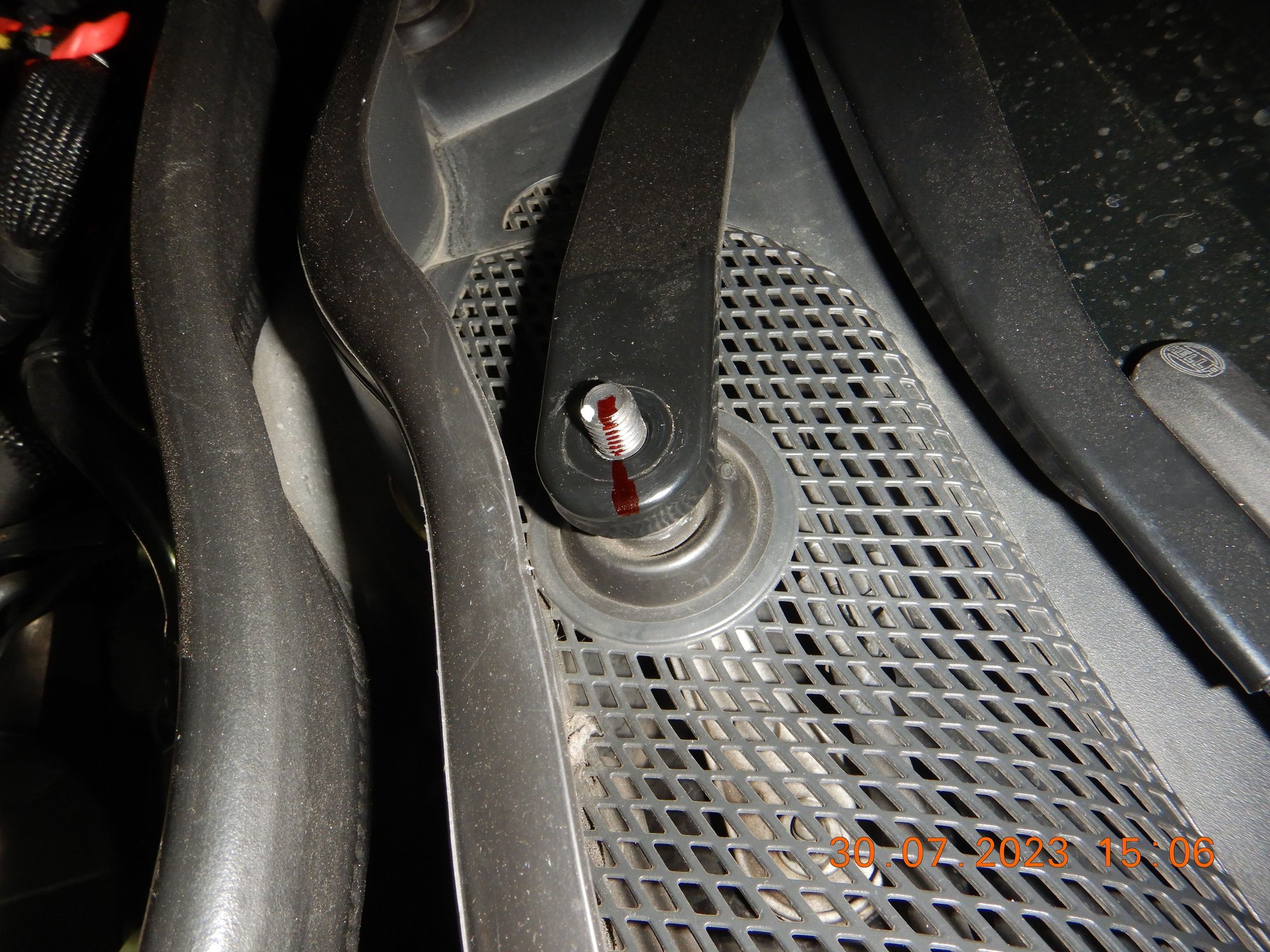

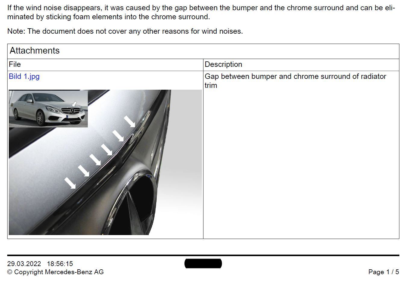

There was a TSB on whistling noise at 60ish MPH caused by the grille, but not hissing. Its on facelift model. Attached.
Mine has this issue but I ignore it but did test with masking tape and noise went away.
HVAC evaporator with low R134a charge can make hissing noise, its from the TXV.
Other wind noise which may enter the car is when the vent flap of HVAC is in FRESH AIR MODE..... but since the air box above the battery for HVAC is on purpose there
to trap and discharge rain water plus 2 of 90 degrees airflow diversion and the windshield wiper cowling design does not force air into the HVAC system, this condition is rare unless something there is blocked or obstructed.
My new in mid 2023 windshield wiper cowling vent holes has fine wire mesh, old one of 2014 was diamond shape opening without fine wire mesh.
I wonder if the wire mesh get clogged plenty, will there be wind sound ?
Old windshield wiper cowling vent holes, no wire mesh
New version has wire mesh
Only HVAC fresh air vent being open , is the way any significant amount of air can enter the car AC air handling system aka your AC mid vent.
Good luck on the search......

Where do you get the foam elements from? I didn't see a part number.
Old Sep 19, 2025 | 06:52 PM
S-Prihadi's Avatar
Joined: May 2018
Posts: 6,601
Likes: 6,547
From: Jakarta-Indonesia
I have no idea, but foam is easy to buy from online stores.
