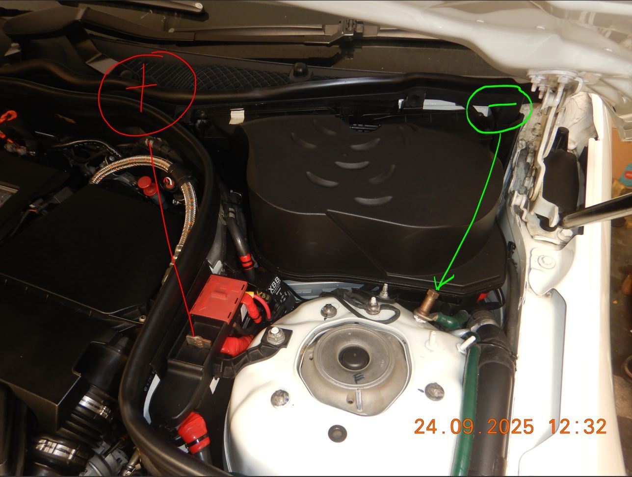

Charger positive and negative crocodile clips are to be connected here :
My car is RHD , but all the same.

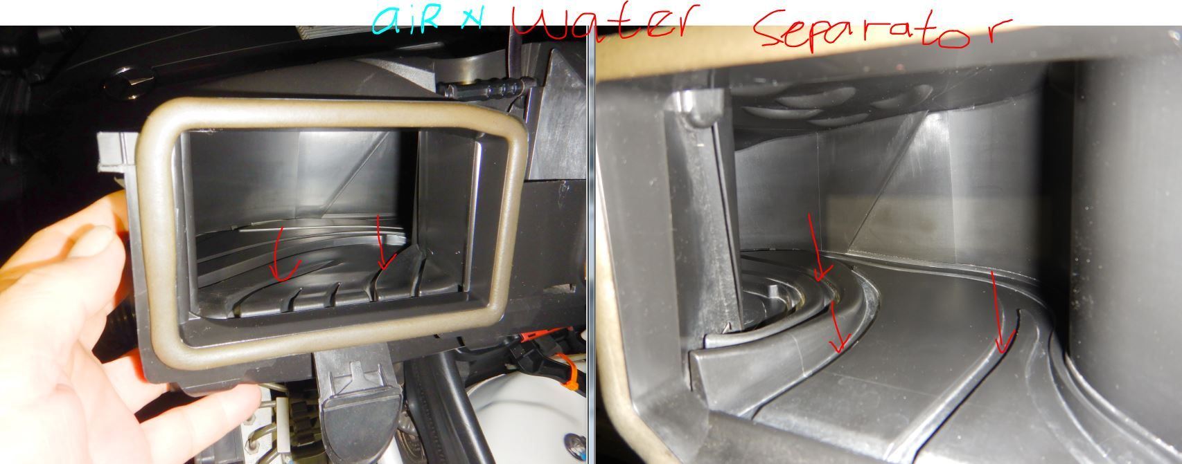

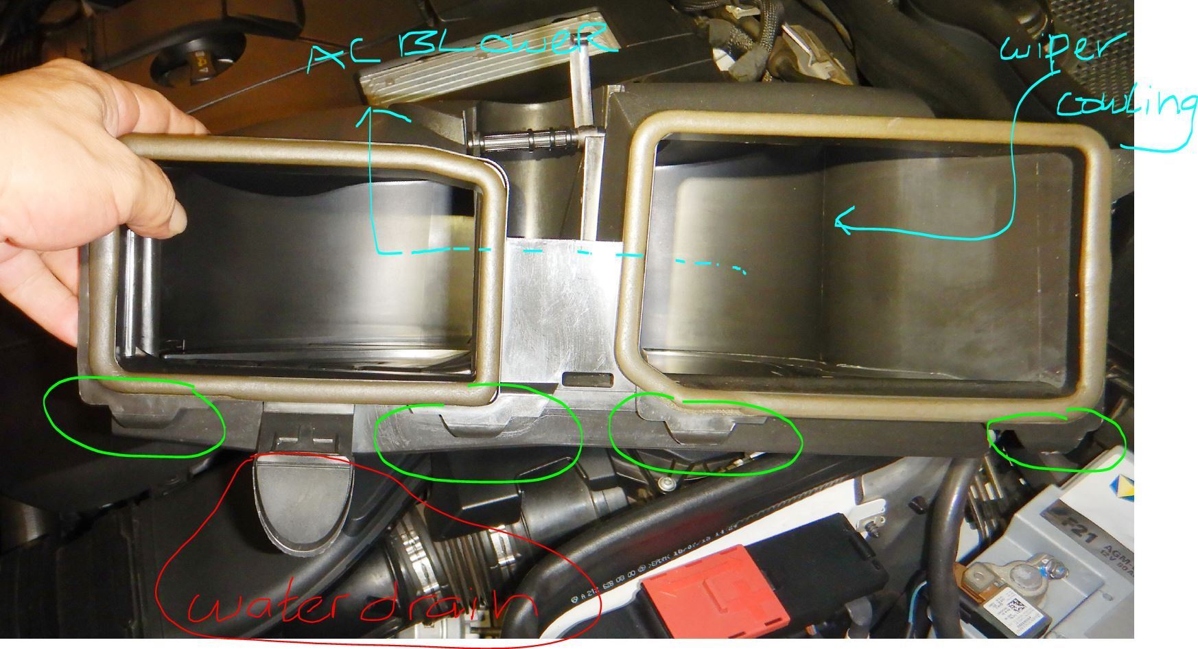

DO NOT remove the airbox on top of battery, that airbox allows your AC to suck in FRESH air from wiper plastic cowling instead of hot and smelly engine bay air.
This is the fresh air flow into AC blower, if flap is set as FRESH and not CIRCULATION.
This air box on top of the battery is also a rain water separator, mind you.

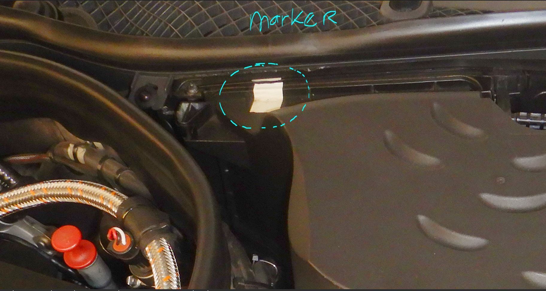

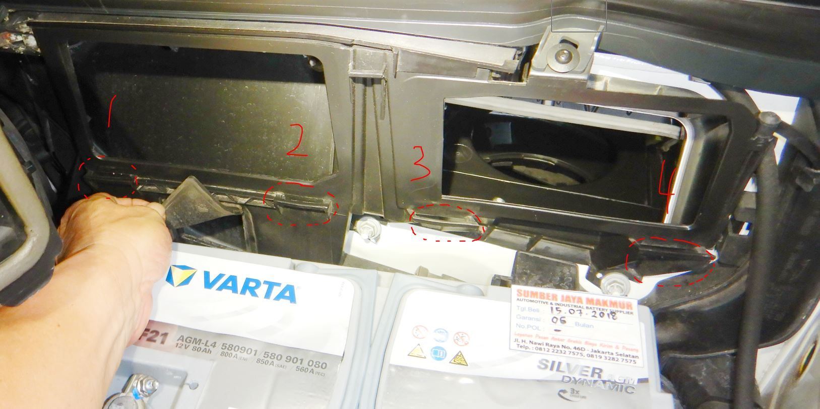

When you remove and re-install the airbox on top of the battery, do be very careful as you could miss the 4 "landing" latches in green circles and ruin the seal at the airbox.
Below are from 2020 archive
Many missed this 4 locking latch receiver and airbox then never seat well and tight. Air box is to "float" above battery, with this 4 latch support.

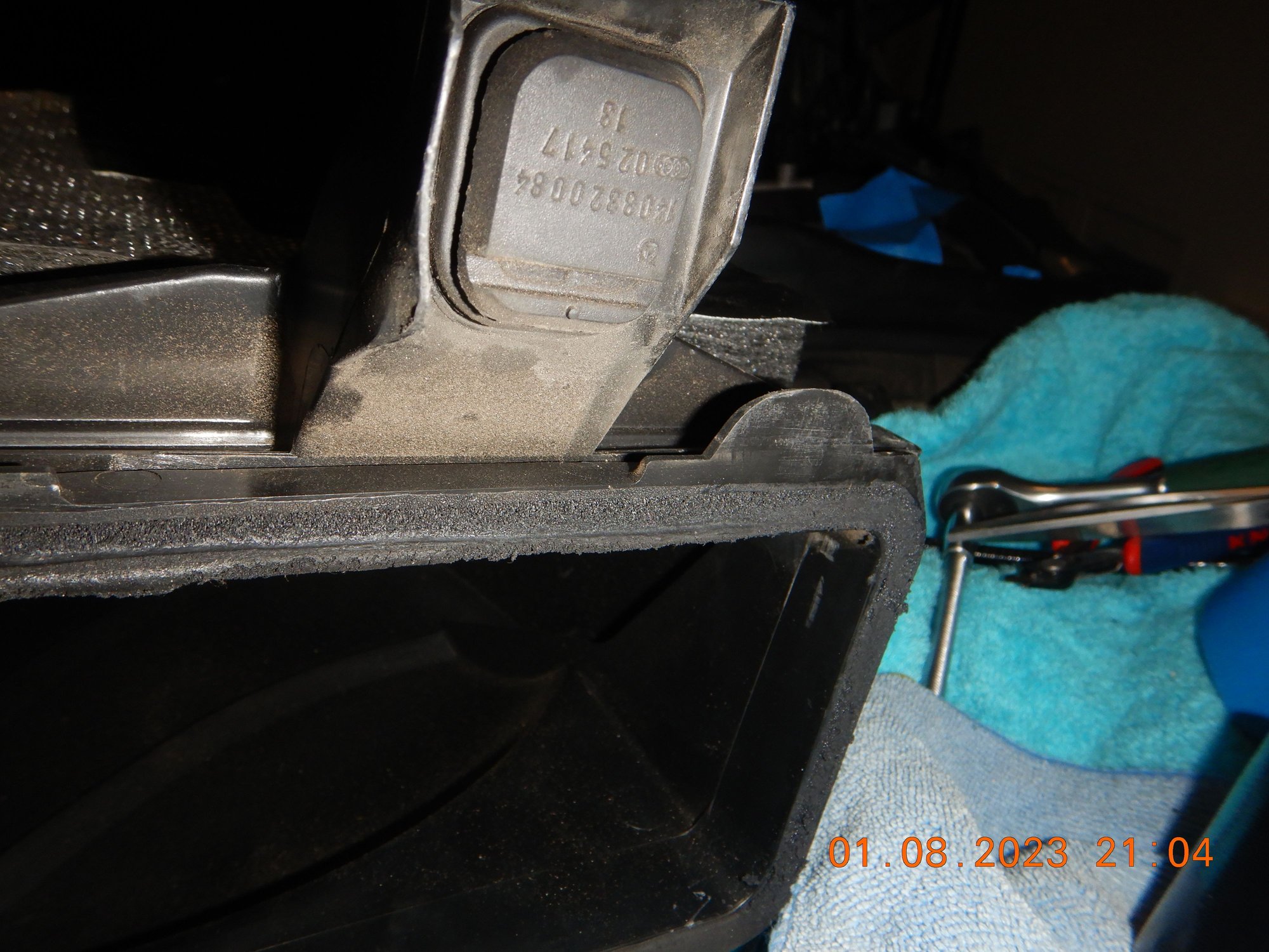

The proper installation of airbox has a simple technique to maintain the grey seal to not be damaged in anyway.
The top of the airbox is to be 1cm away from firewall, this way the grey seal do not get rubbed while you "park" the airbox 4 latches.
When 4 latches engaged properly and airbox is now "floating", we then pushed the airbox into the firewall.
I even used marker now for ease of "aiming" , as all these are black plastics and unless you work in very bright open air, me old eyes doesn't help me ...LOL

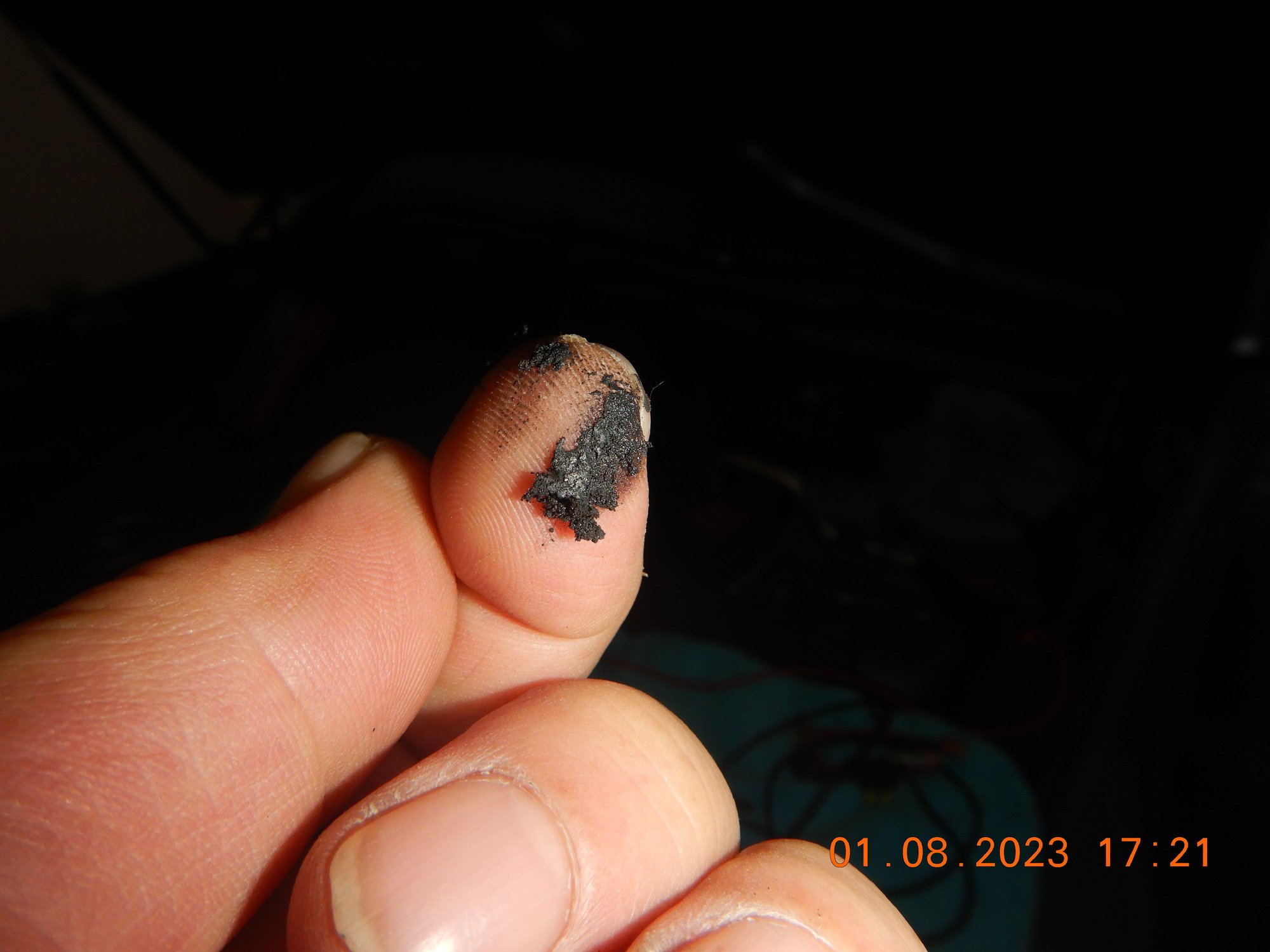

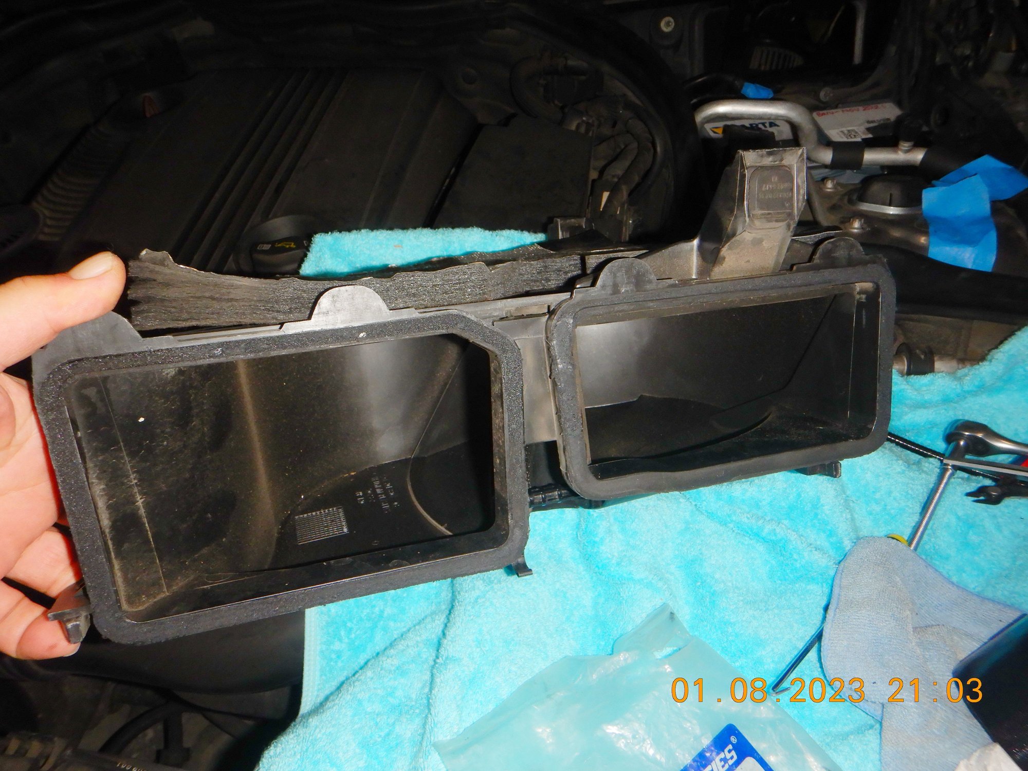

Inspect your airbox seal integrity, they will wear our or becomes gooey when and if your engine bay is oily filthy.
W204 of 2010. C200, filty oily engine bay
When engine has oil leaks and ignored, the amount of oil vapor they release into engine bay air is massive and will do damages to foam/seal and the like.

NORMAL BATTERY CHARGE
The topic of W212 battery chaos is a busy one.
You got a firm handle with automatic tender connected to jump points, not directly bypassing B95 LIN sensor.
Drained batteries & slow starter.... not for you.

So brilliant - thank you so much for the photos!!
