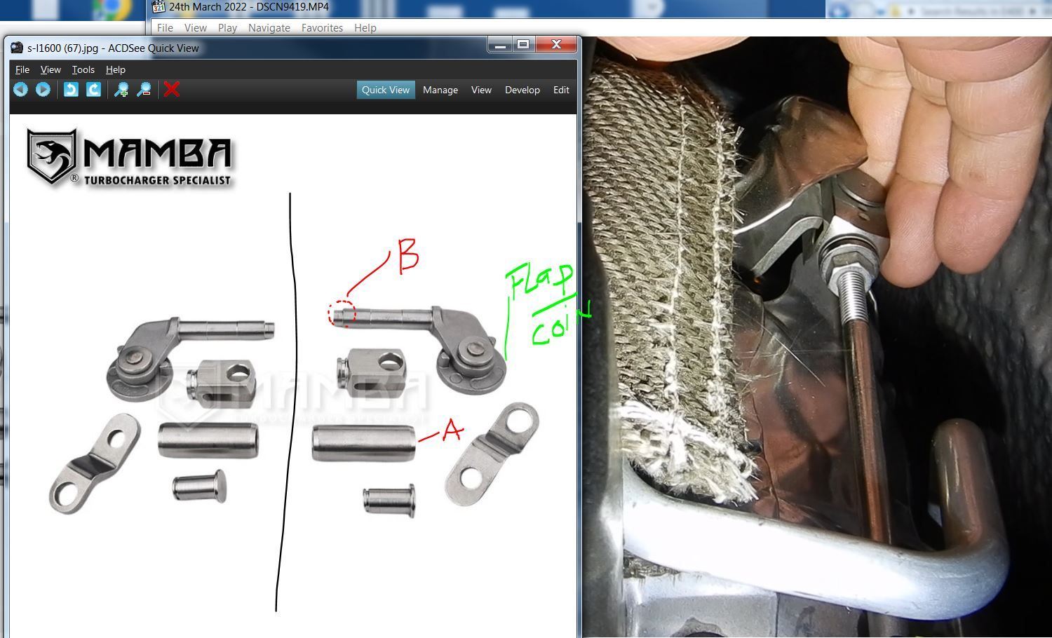

The only time the turbo wastegate flaps/coins rattle , it is when at light load . During full open or full closed, it will not rattle.
https://www.ebay.co.uk/itm/276466042597
The said rattle is not at the flap to turbo hole/port, but at the interface marked below A & B. B shaft goes into A bushing.
If during full closing of the flap towards the turbo port/hole and you still get rattle, that is when you will loose boost too because the wastegate components are wearing out and this is normal
after high mileage. If you had the low boost code, and the hiss I heard, there is a chance the item #1 flap surface is already not good anymore and thus it can't keep
pressure at the port/hole.

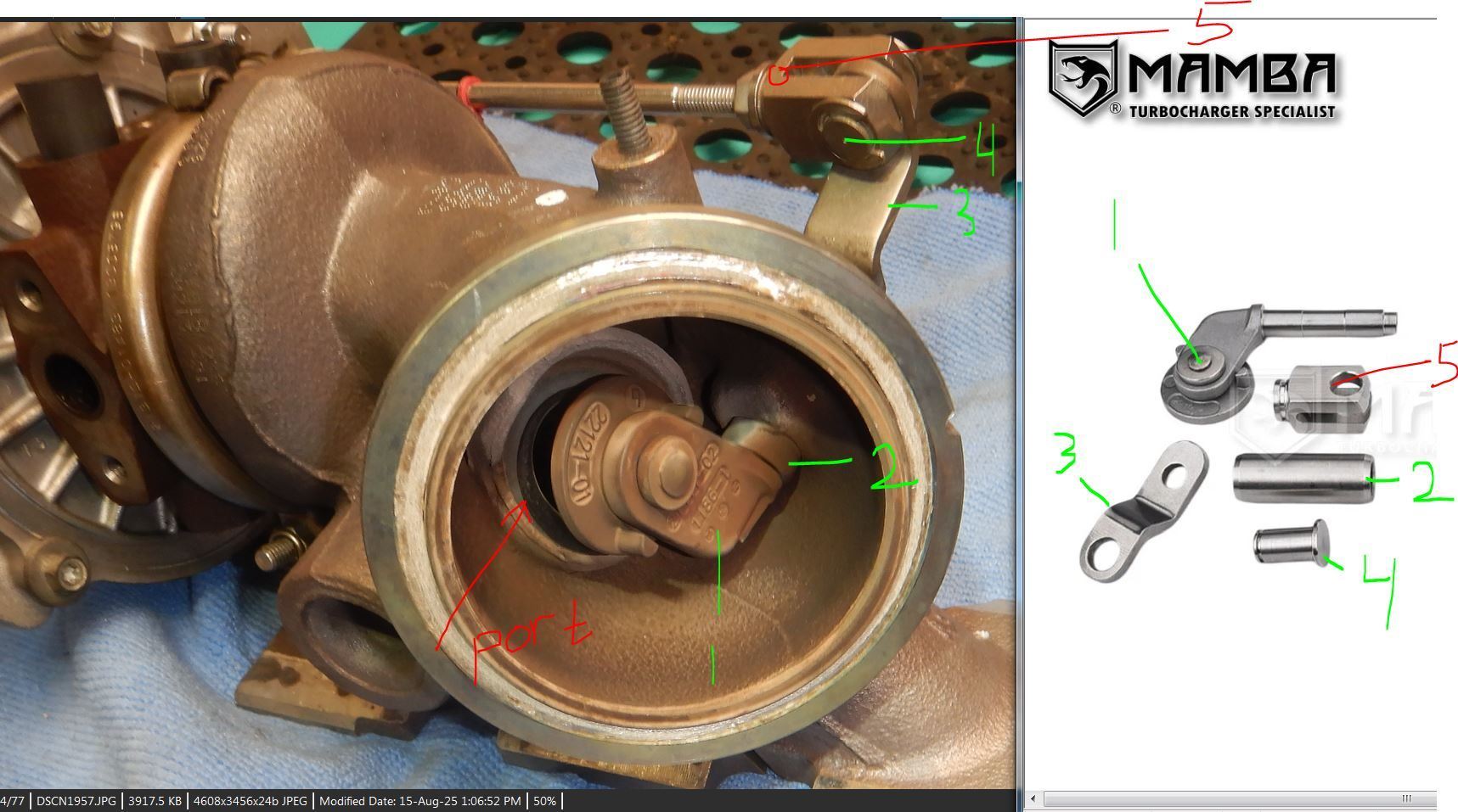

Well, As seen in the clip the whole Wastegate arms move ( sorry for the language, i'm from Romania) - they have a lot of play in it so they need to be changed. The mechanic said that it might be possible that it might also be broken in the arm so there is a possibility for them to fall down. I have bought the repair kit - should be here in 1-2 weeks. I will ask the mechanic to take some pictures of the installation aswell to document it here

Well, solved it. Unfortunately the mechanic couldn't take any relevant photos of the process, as he was working solo on the car.
Both turbos needed to be taken down and the old wastegates had to be drilled out, pain in the *** honestly.
But at least the result is good. No more rattles, i also feel like the car is building low-end boost much better.
If it bothers anyone else reading these, it does work, if not, you choose if you want to commit on changing them or not
