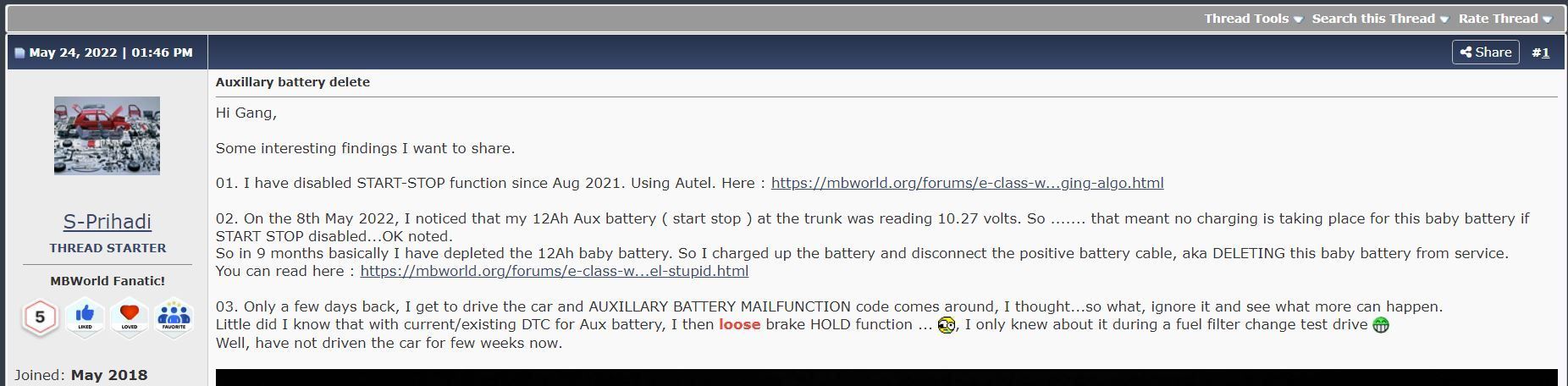

If your car is B03 start stop version with 12Ah medium size battery at the trunk...... YES, you loose brake hold feature when the AUX battery goes kapoot.
Read here : https://mbworld.org/forums/e-class-w...ry-delete.html
03. Only a few days back, I get to drive the car and AUXILLARY BATTERY MAILFUNCTION code comes around, I thought...so what, ignore it and see what more can happen.
Little did I know that with current/existing DTC for Auxbattery, I then loose brake HOLD function ... , I only knew about it during a fuel filter change test drive
Well, have not driven the car for few weeks now.
