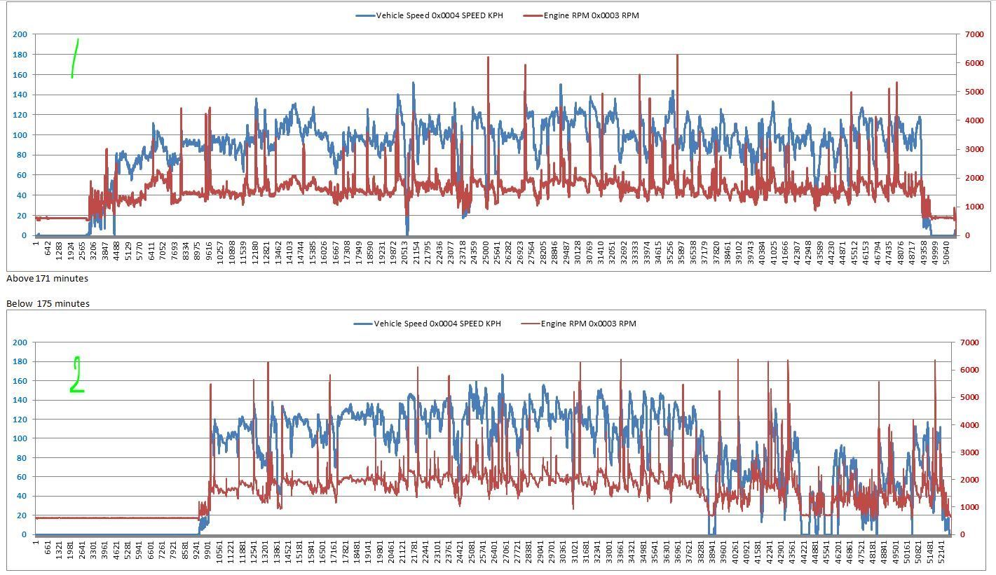

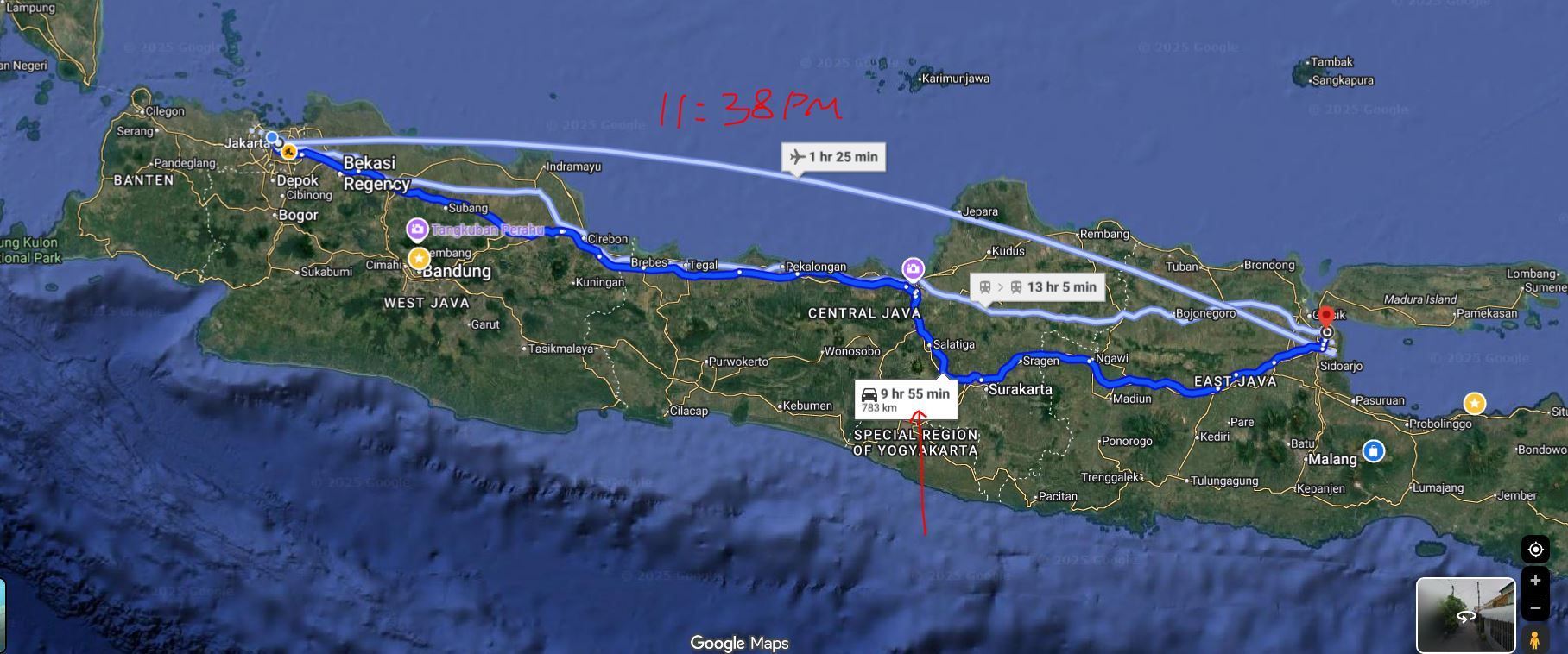

This is how lame driving on Java's paid highway, the slow traffic at 9AM from Jakarta start ..and to 6PM ish arrival in Surabaya.
Google map calculation below based on 11:38PM start and red eye drive Jakarta to Surabaya with least traffic. Imagine when I start at 9AM. Below is based on 100% on paid highway.
The light blue region 13 hours 5 minute is extra 4+ hours if using non-highway. Dark blue is all paid highway.

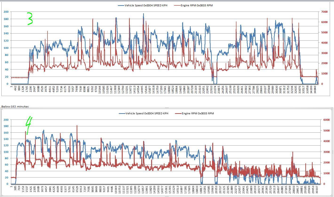

My actual drive 9AM start . Every 2.0 to 2.5 hours I refuel and take a leak , and also one lunch stop. Total 3 stops, 4 logs.
Total 9.41 hours or 565 minutes merely to do 786KM / 488 miles, Jakarta to Surabaya.
Average speed 786/9.4 = 83KMH or 51.5 MPH
I spent sitting in the car eating like 25ish minutes….LOL. Log #2.
Log #3 is 117 minutes.
Where you see speed dip down to 80KMH / 50MPH that is how lots of people drive on a 100KMH highway.
Log# 4 last 40 ish minutes, that is already Surabaya internal city driving , hence average 30KM/H or 18MPH.
This is why my fuel burn is always high, even in paid highway.

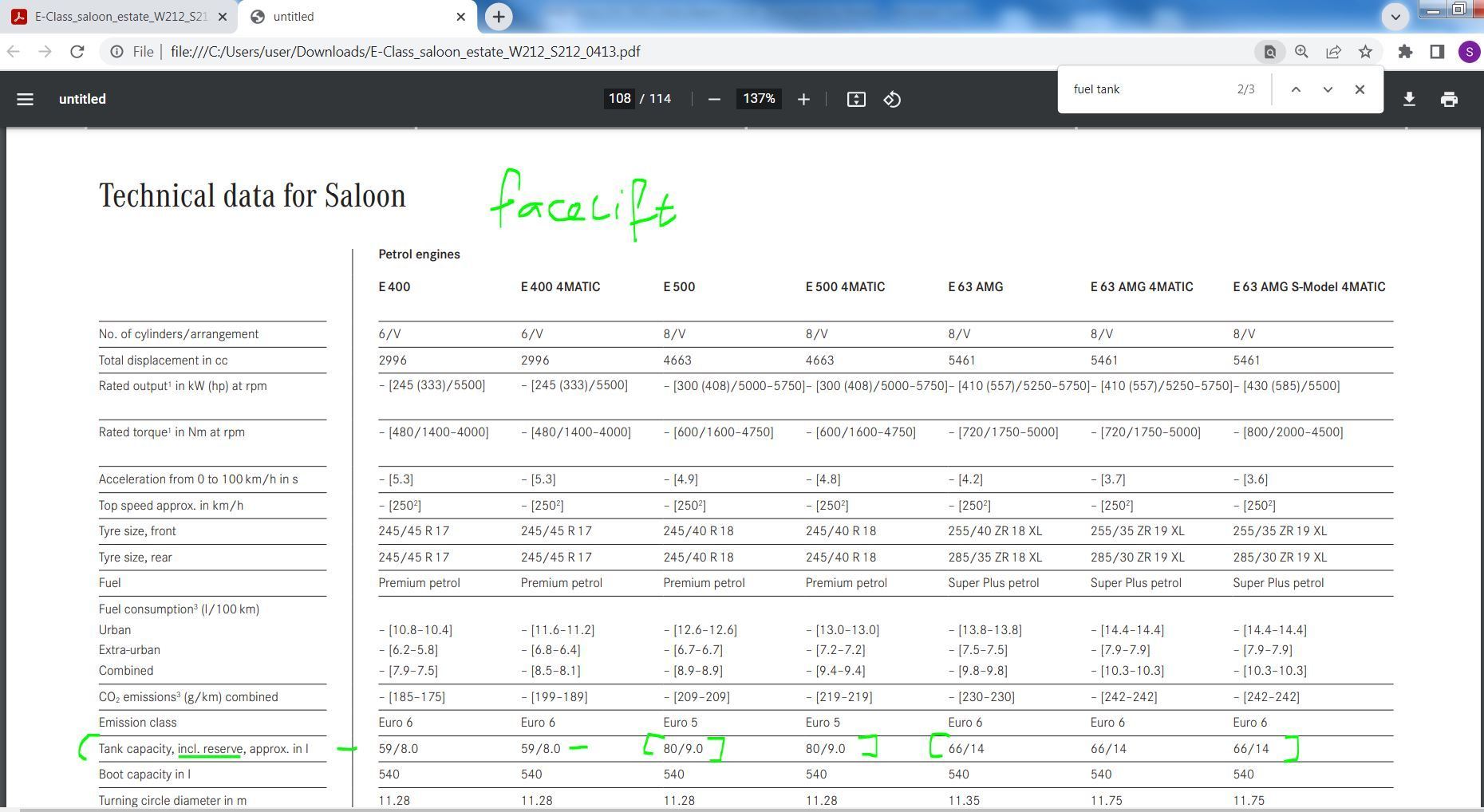

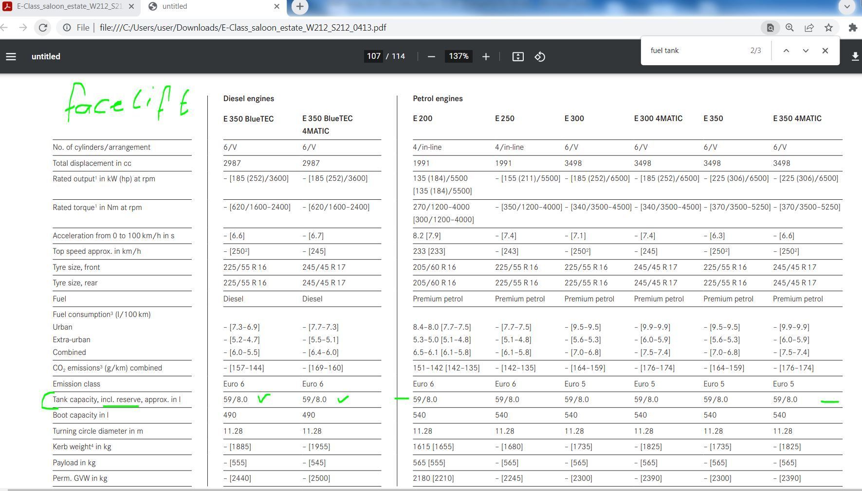

I think facelift model wants to use less plastic for ECO/GREEN sake, thus the plastic fuel tank becomes smaller ......thus I get 59 liters only
Mine confirmed 59 liters, including 8 liters is the reserve ( warning light ).
Note, facelift E300 is 3.5L M276 de-tuned one, no more M272 true 3.0 L. Such E300 with 3.5L M276 engine won't be sold in market with extra luxury tax for engine above 3.0L.
