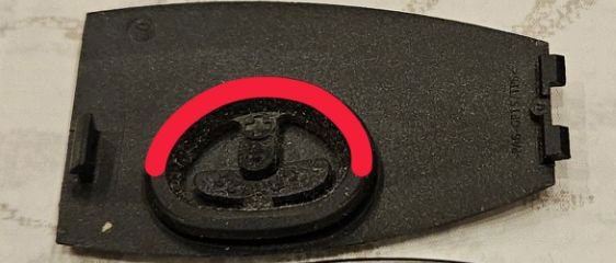

For me, the challenge in going to a CR-2032 battery is getting the cover to click back into place securely. (i.e., the thickness of the CR-2032 will bow the cover outwards, not allowing the cover to snap completely closed.) The cover then pops lose at random, and with my luck the cover will get lost.
To fix this, I removed the cover, and with a sharp X-Acto knife, I shaved the rubber in the area indicated in red. I removed enough rubber material in this area that allows the thicker battery to fill that space... and flatten the cover to it's normal position when reinstalled. You can remove all of the rubber in this area if you want, or just remove a little at a time, then test.
Once done, the cover snaps securely in place as it formerly did with the CR-2025 battery. Job done!
