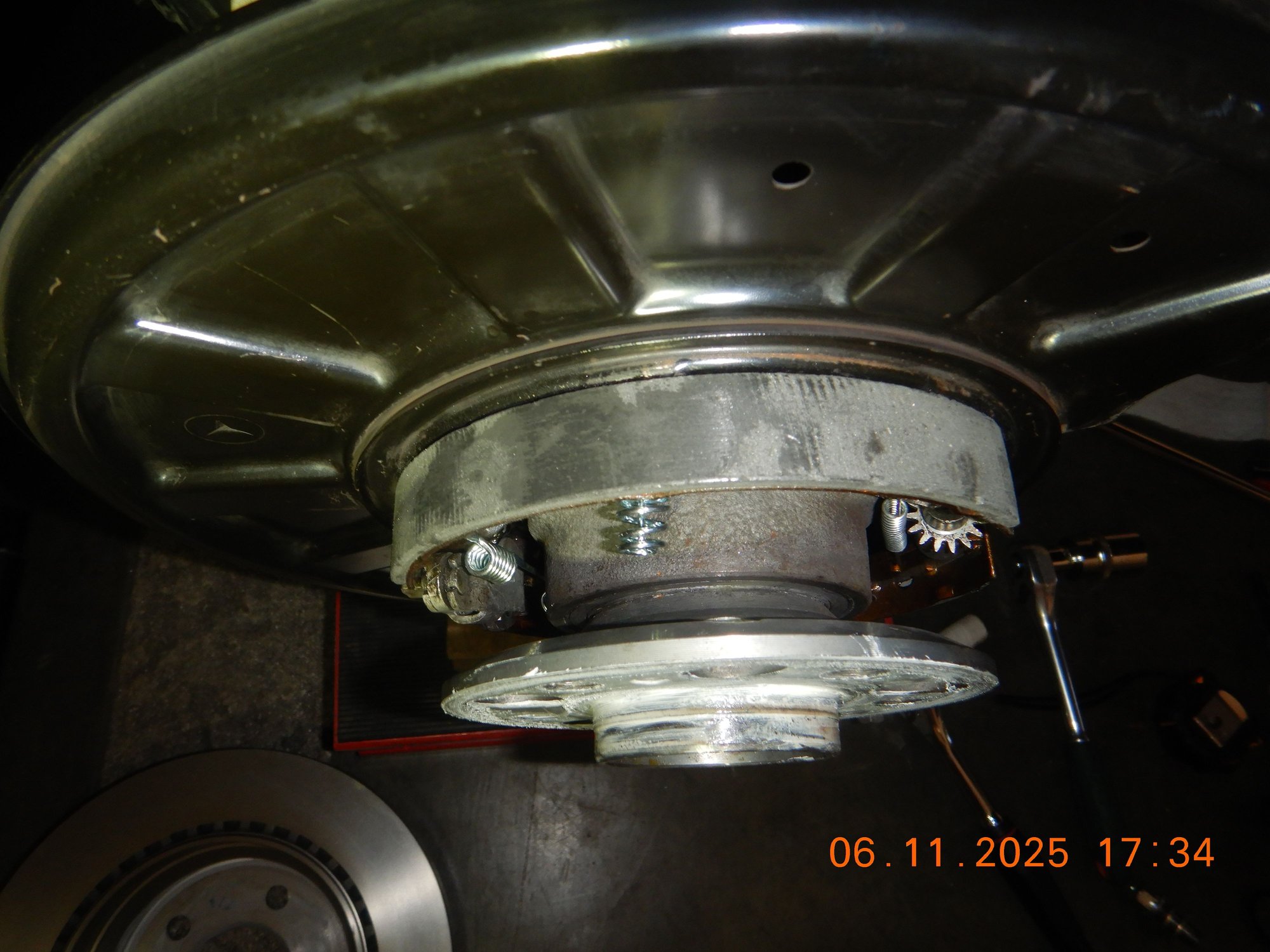

I did try this piece of sh-iet brand : RIDEX
I did not expect it to be sh-iet, until I compared it to a brand new MB genuine parking brake set...which I bought to complement the new Brembo rear rotor disc.
RIDEX, below
Ridex,below

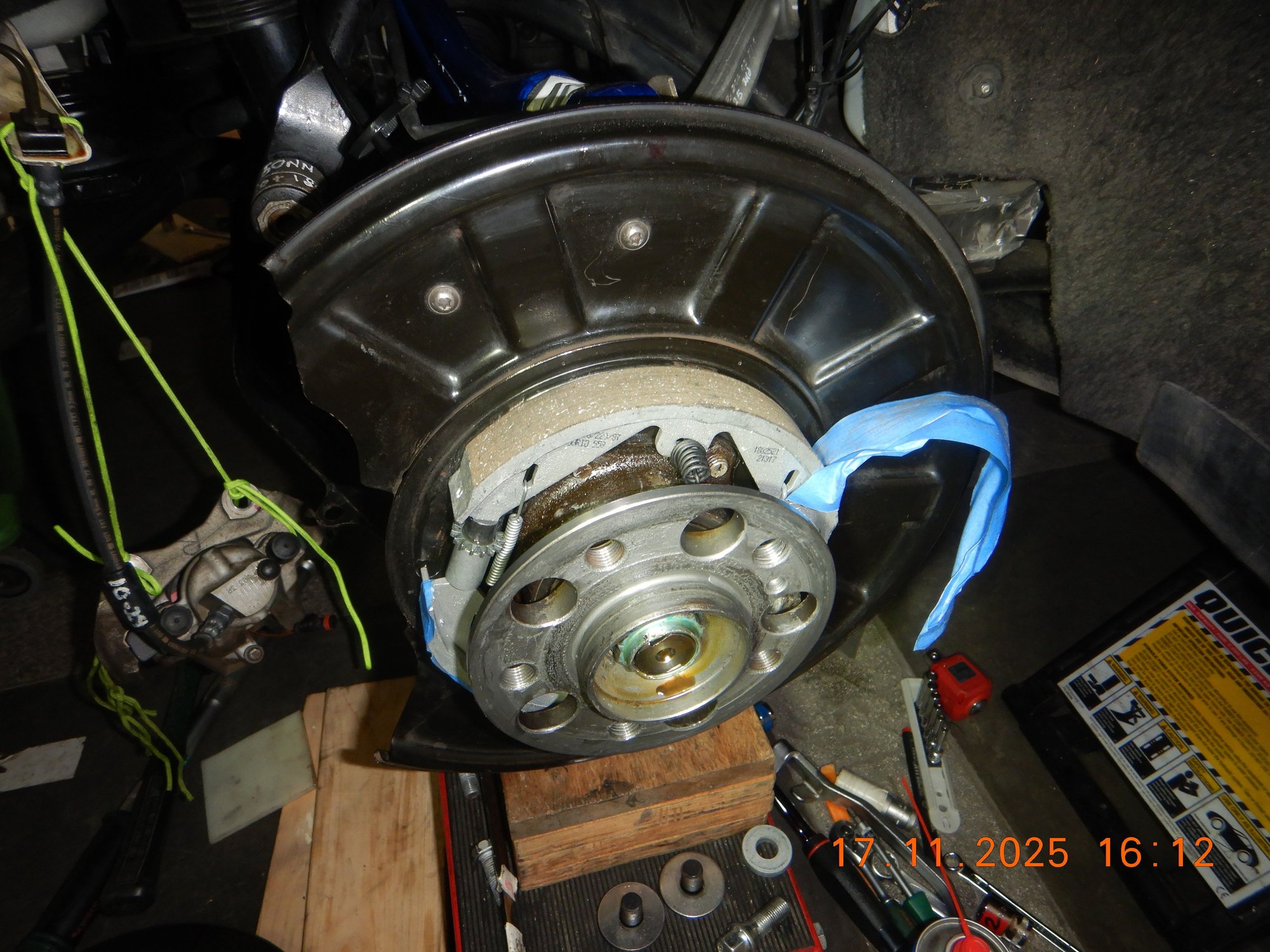

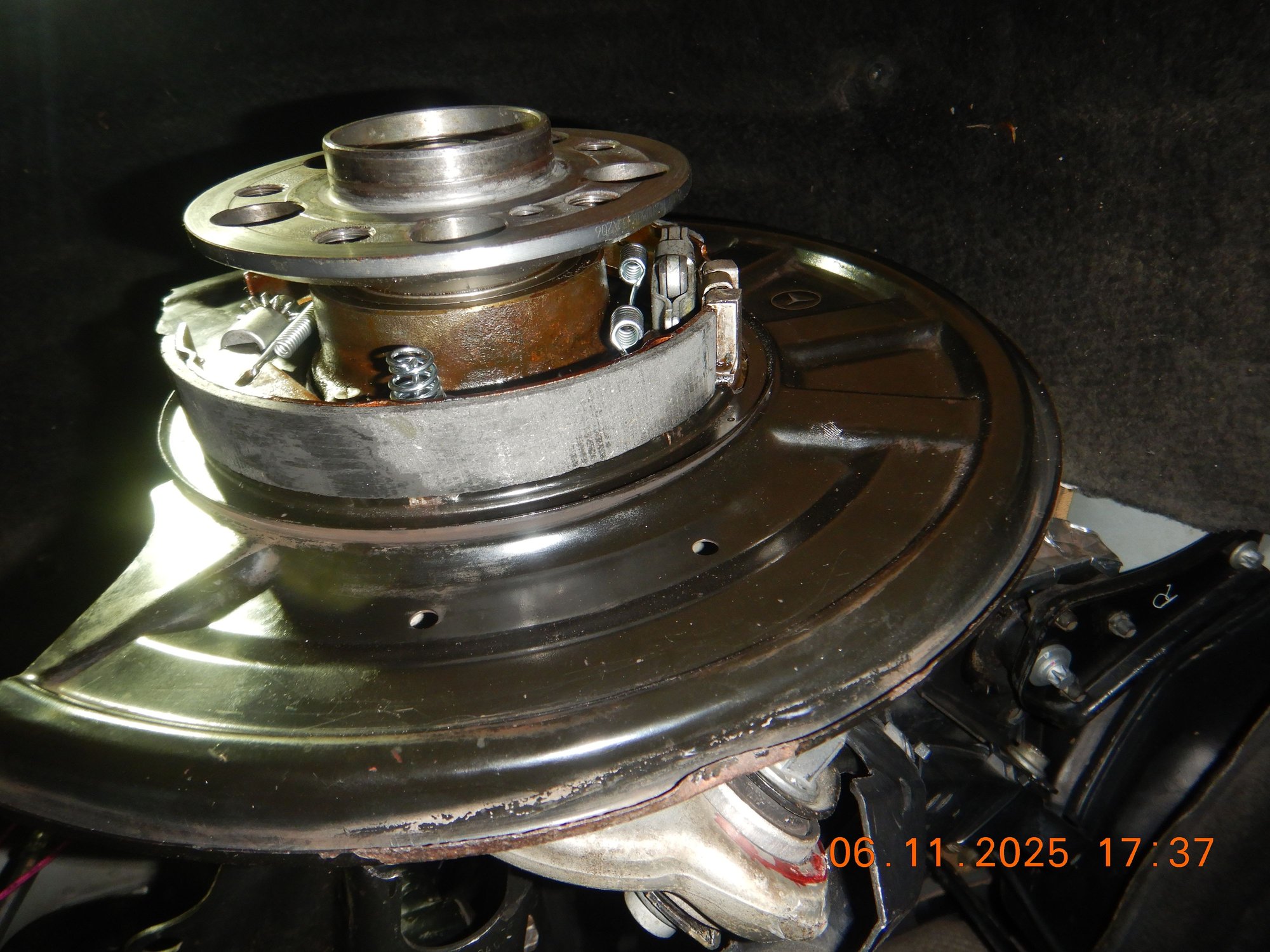

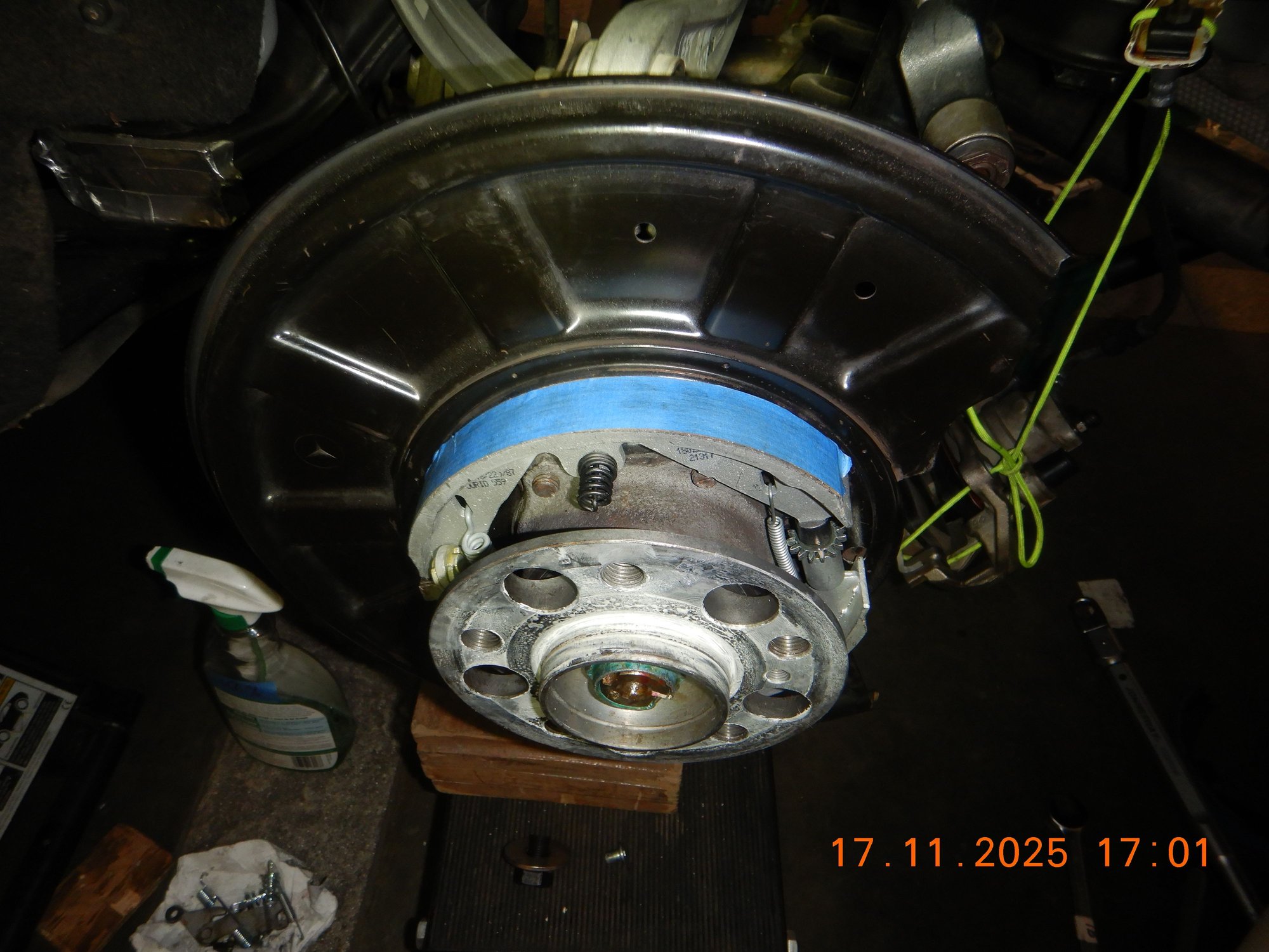

At 1 final click to last click of parking brake lever engagement, the Ridex can produce only 75ish Nm of holding force, even after I bedded the pads.
The MB genuine one, at the same 1 final click to last click will produce 170 Nm easy...wow !!!
The parking brake kit gets all new components.
Also the MB genuine pad is more abrassive and overall a bit thicker perhaps 0.75mm each pad overall , abrassive as proven from the one original to the car and the 2nd one I had some years later.
Now I am on my third one. I can't use the 2nd one (used) on the new Brembo rotor disc. I want virgin to virgin surface.
I said MB genuine one is thicker because I can feel it on my leg when actuating the parking brake, it is harder to press than when using Ridex.
The MB genuine pad to new Brembo rotor disc, no need much bedding too, its bitey from the start...wow.
This is my first time I feel virgin rotor disc to virgin parking brake pad.
Now I can set the parking brake pad to be super quiet, just super minor touch to rotor disc when parking brake not engaged.
At full engagement of parking brake, it exceeded 200Nm of grip. My torque sensor can only do 200Nm.
Due to servo action of drum brake type, only 1 pad will get the super minor touch when wheel rotates to forward direction while paring brake not engaged.

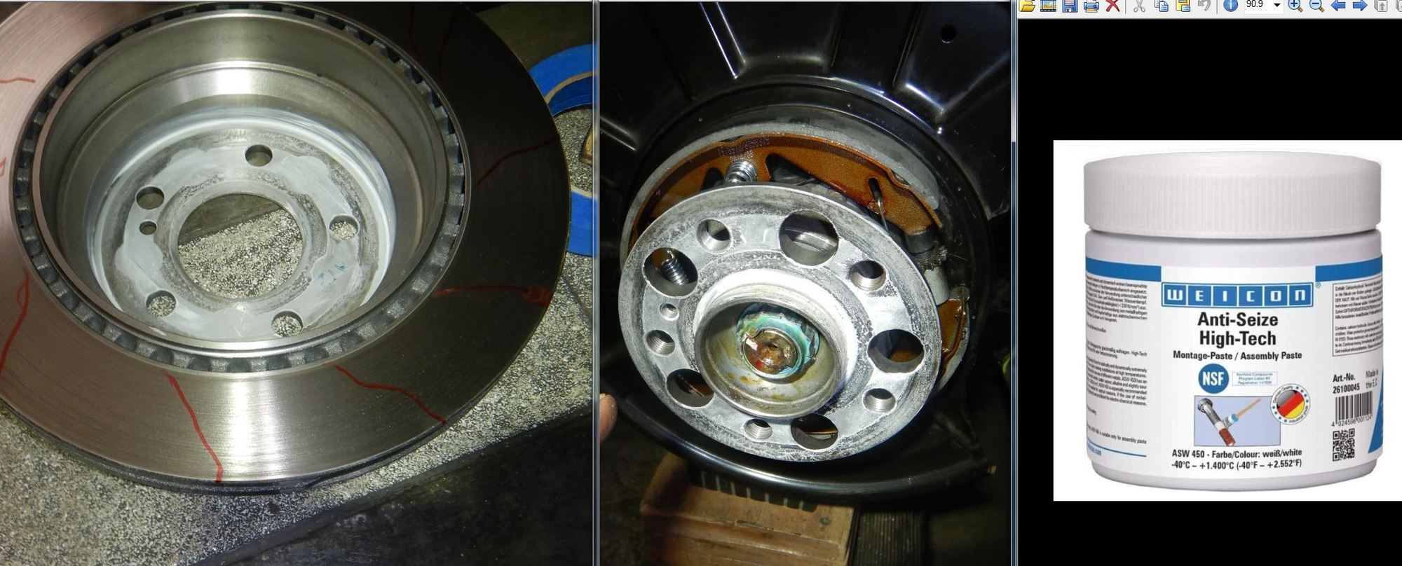

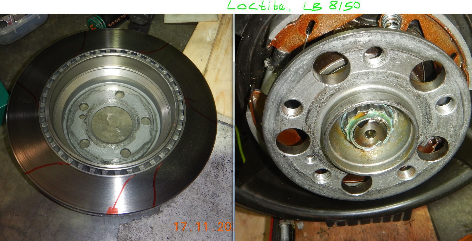

I am also testing new type of anti-seize as corrossion protection. This is super high temp for my exhaust bolt. 1,400C ( 2,562F) rated
This white Weicon is not as oily-sticky like the silver color Loctite anti-seize LB 8150 I been using which is only 870C ( 1,600F ) rated
Note : My front oxygen sensor temperature can hit above 900C if I pushed the engine hard.
This white color Weicon is easy to remove and clean, unlike crazy sticky Loctite LB 8150
Corossion at wheel bearing hub to rotor = vibration and difficult to remove the rotor from wheel hub.
Since I have no winter salt, so far the Loctite LB 8150 been the best..
The 1,400C rated Weicon is 4x more expensive than the Loctite. Hence I bought the smallest size one
Time will tell on the corossion protection the white Weicon can provide.
I suspect it can't be as good as Loctite for its adhesion to metal, if not on a thread.

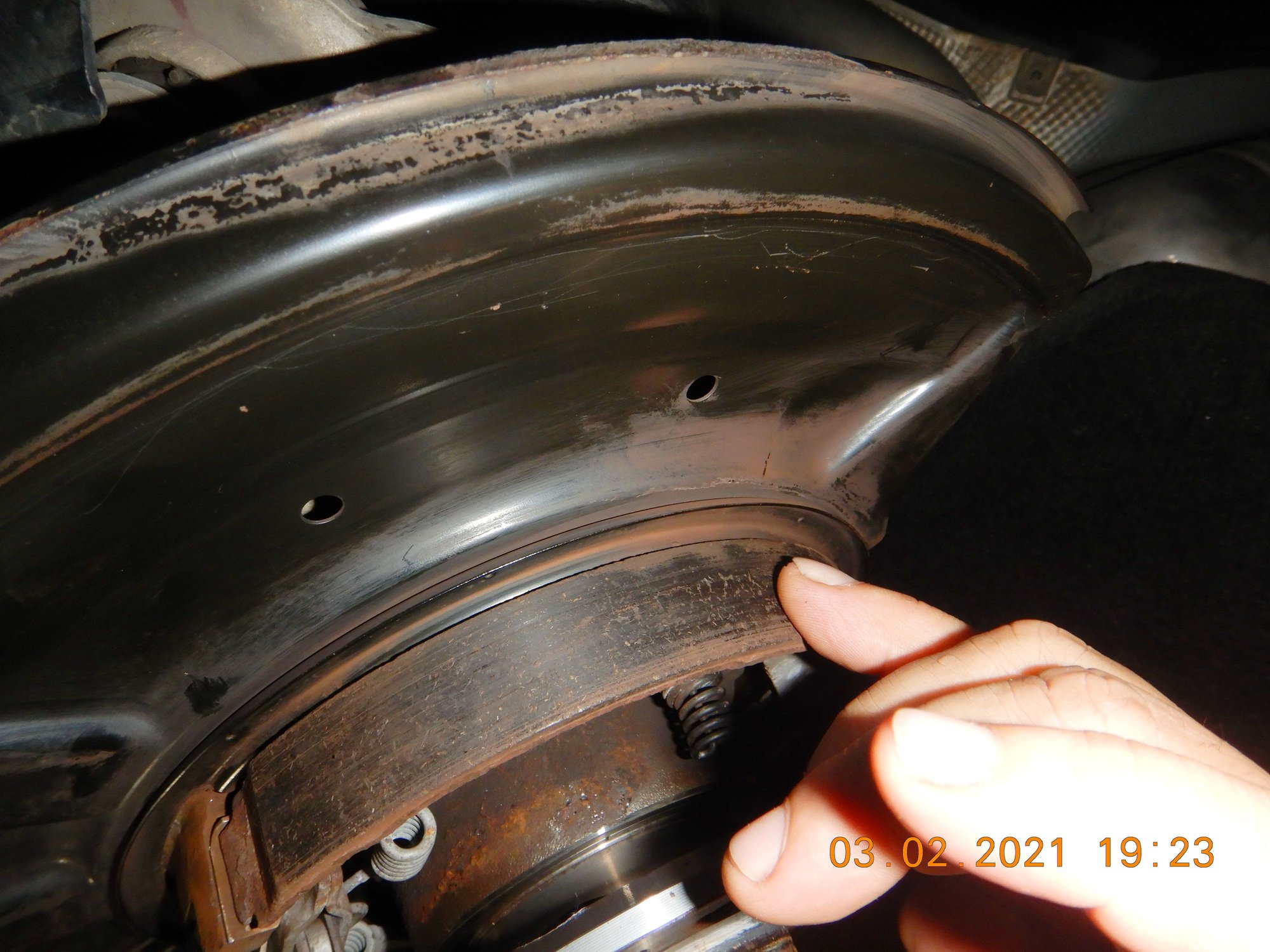

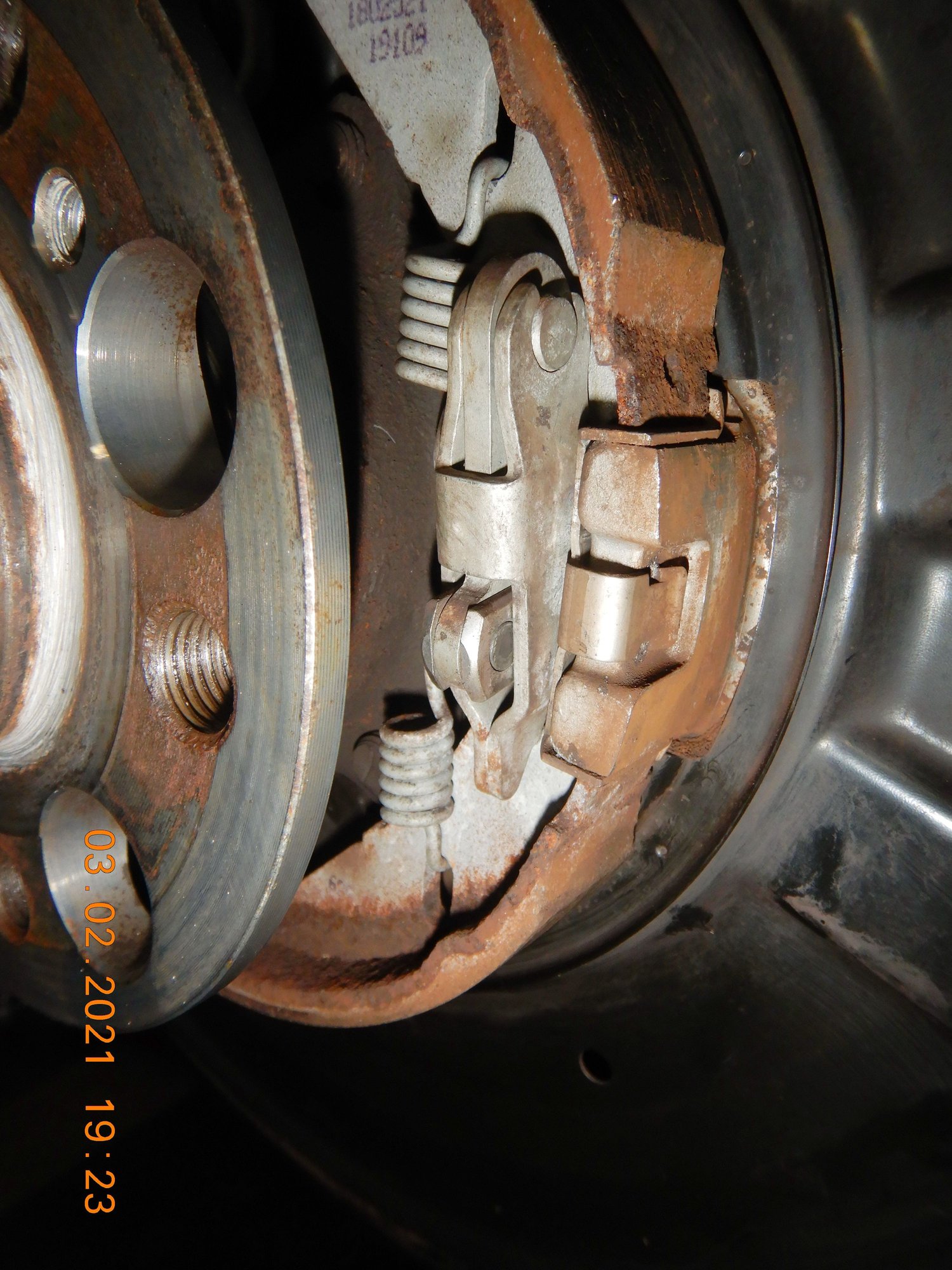

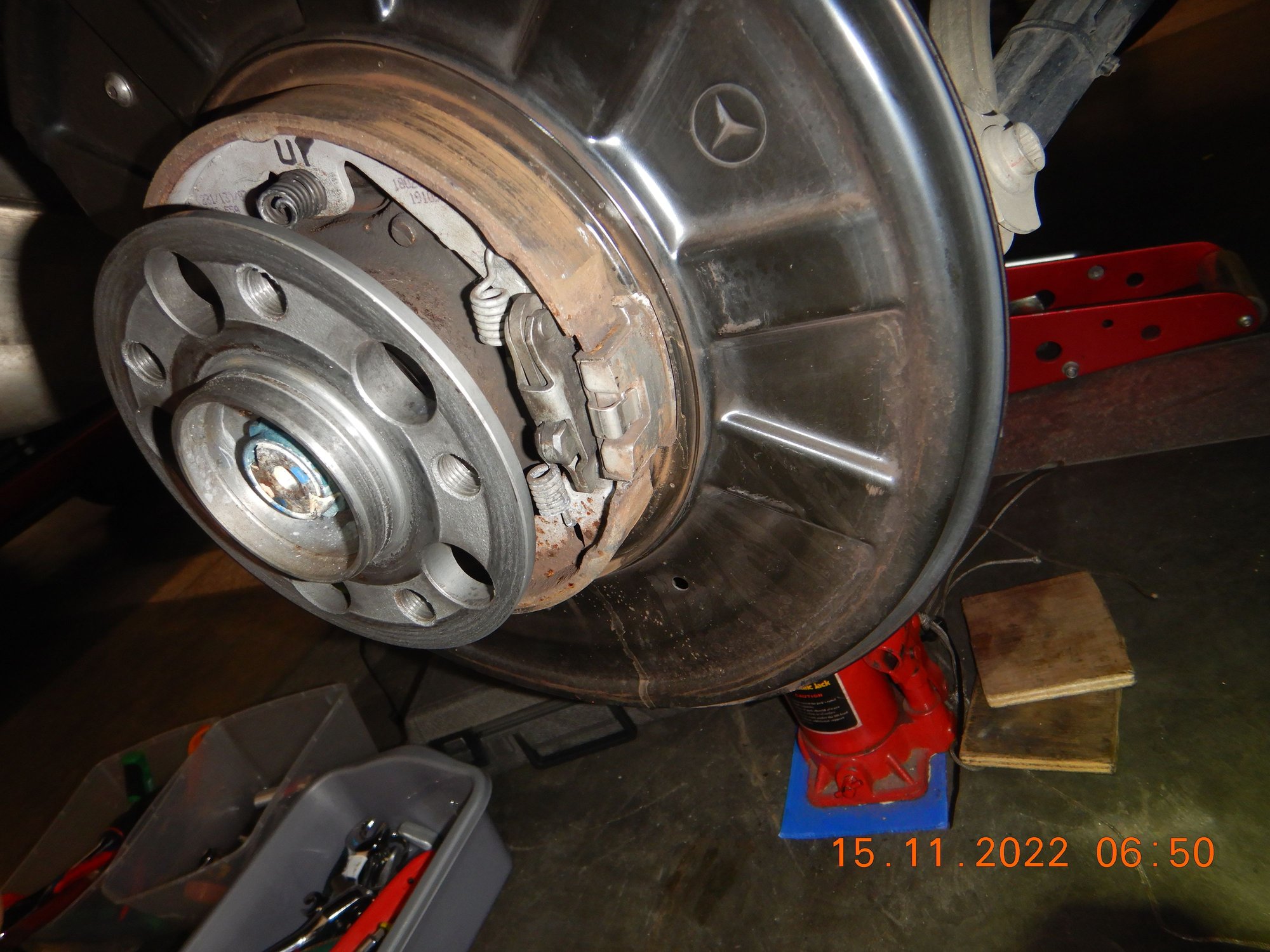

Well, first one original to the car looks so ugly , rusty yada yada.
I hate ugly rusty looking brake pad set, even parking ones.
2021 condition

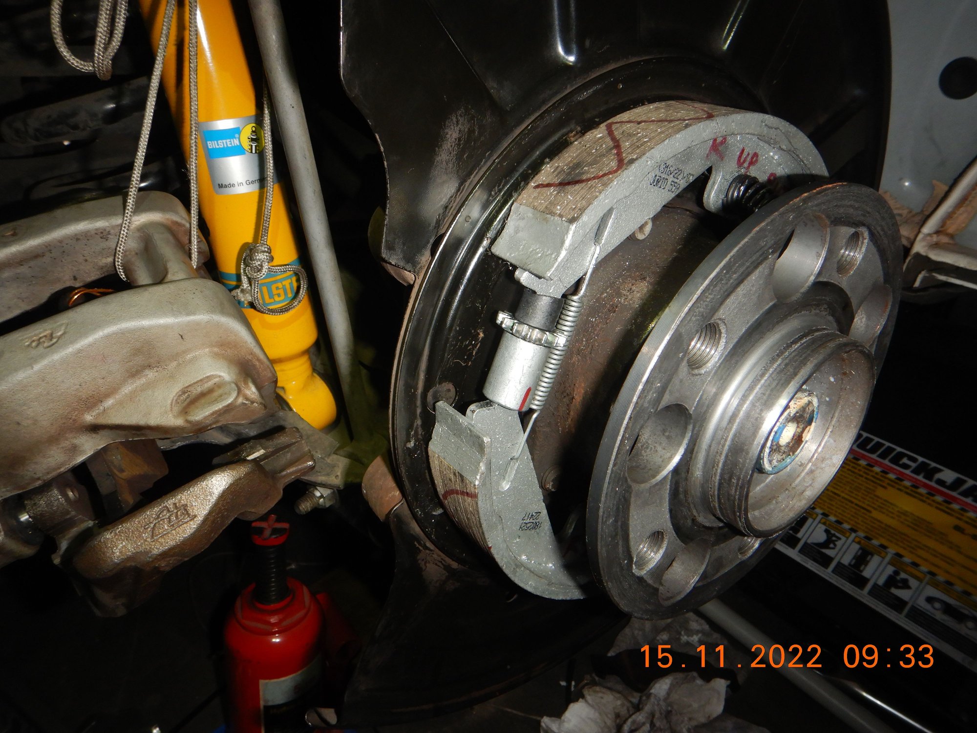

2022 I bought new parking brake set. To make it look less ugly
Ugly becomes prettier a bit...
Now prettier
This year, this month......I replaced the rear rotor disc, thus new parking brake pad ( and new rear caliper brake pads ) is a must. Total reset of the mating surface. Best quietness and best grip.
