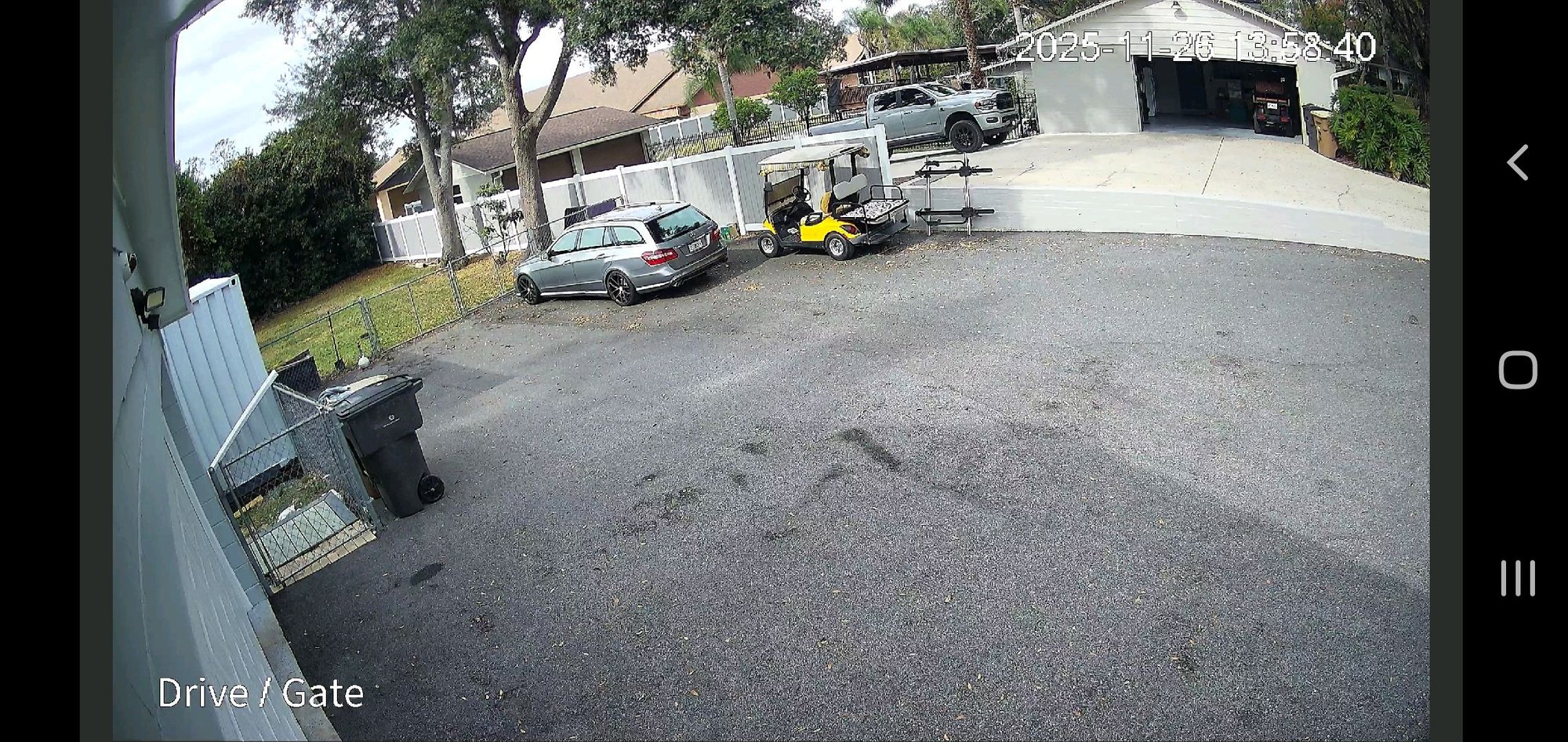

Originally Posted by Lexuslover
That’s why it’s good to have cameras everywhere because cameras don’t lie people do.!!
All blocked

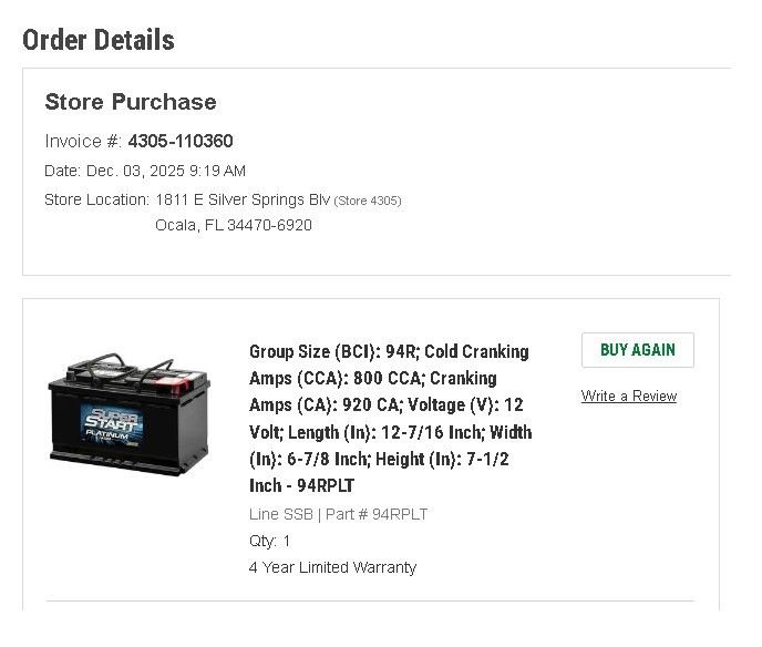

I still have not figured that car out. I put in a brand new battery....over night the new battery was down to 9.1v. Now, the car does not start again. The ONLY thing that changed was that airbag.
Maybe I am lazy but that car is just not high on my priority list.
