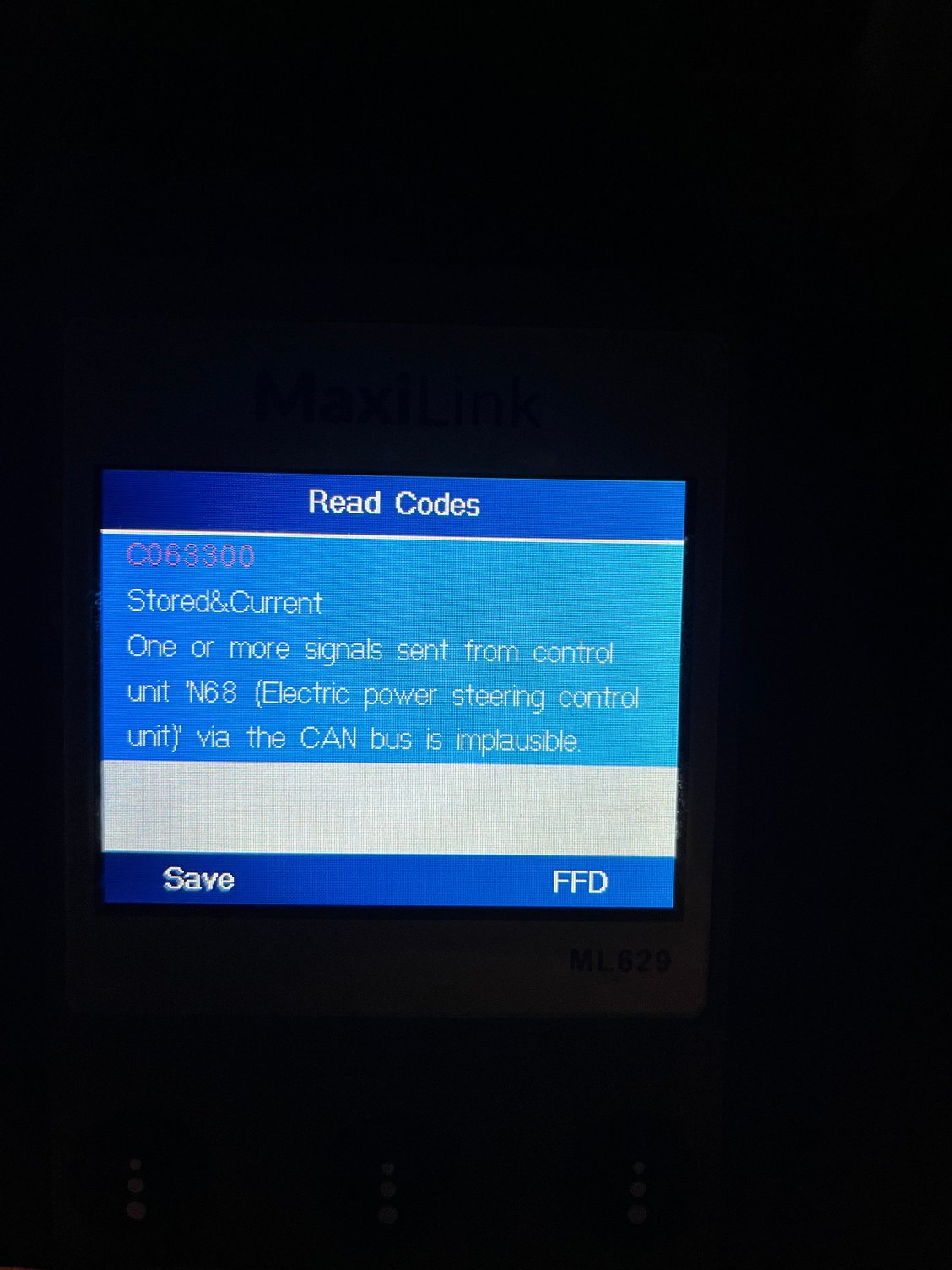

So I just bought a 2014 e350 and it has a power steering malfunction as well as interior lights don’t work and infotainment system either and the steering is hard I can’t drive it I have these codes from my scanner and I need to be pointed in the right direction the power steering rack was replaced as well as the alternator is good and I changed out the main and auxiliary battery and entire front fuse box please if anyone knows the issue would be really helpful

Ok I changed the aux battery out now only have 1 code how can I fix this
This non responsive fault message makes it sound your new rack is dead as door nail - Two in a row is uniquely....
-1- RACK Module reports "implausible Signal"
-- Confirm the ENGINE is RUNNING during the rack evaluations. (NO Batt status involved with rack)
-2 - Read rack live data PID with your Autel:
-- what do you (not) get ?
-3 - What happened to the first rack to initiate errors ?

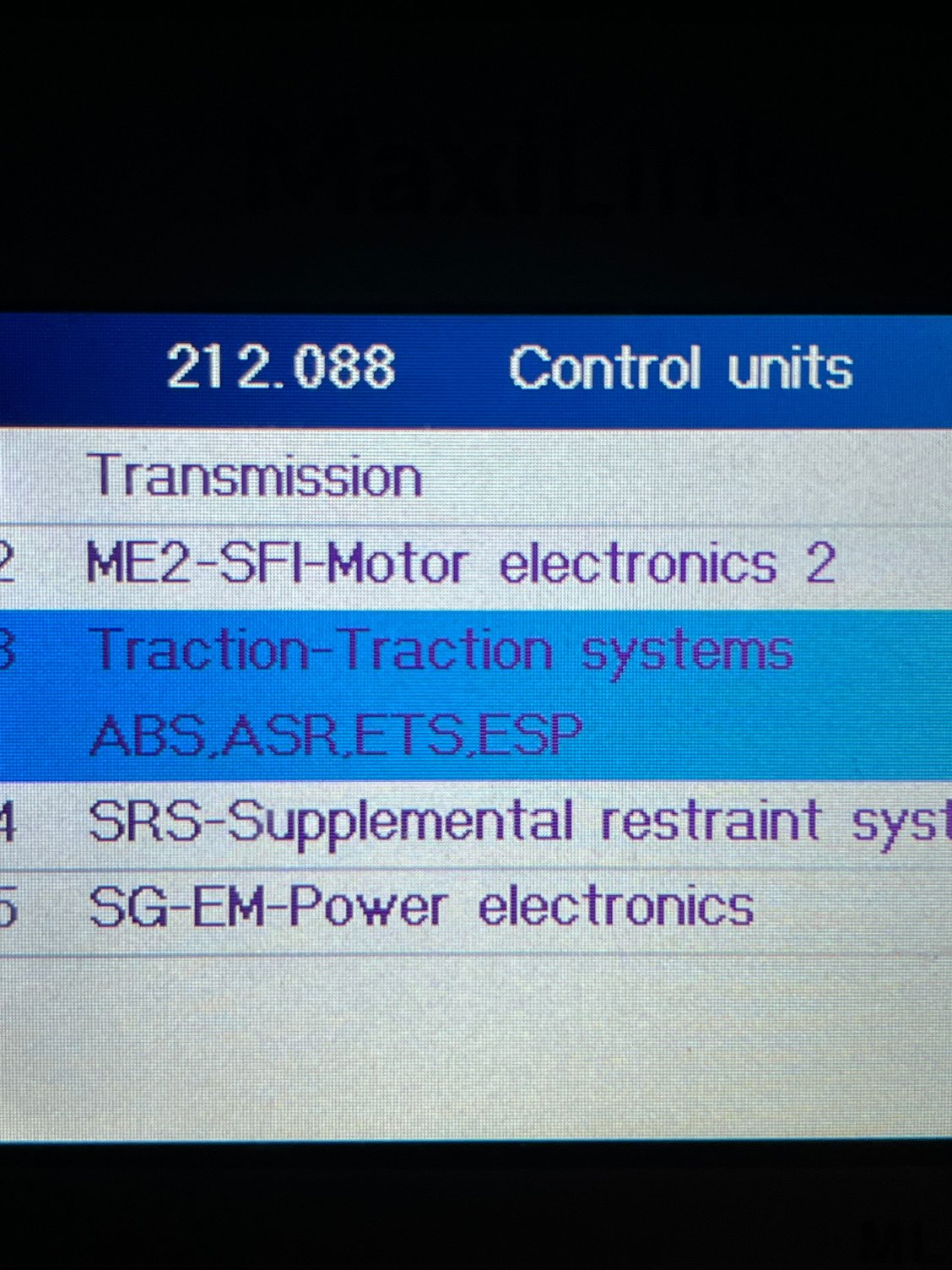

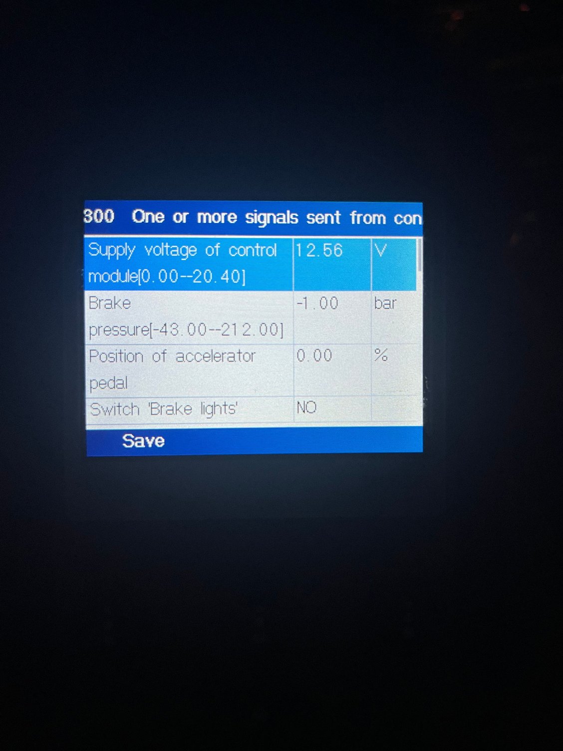

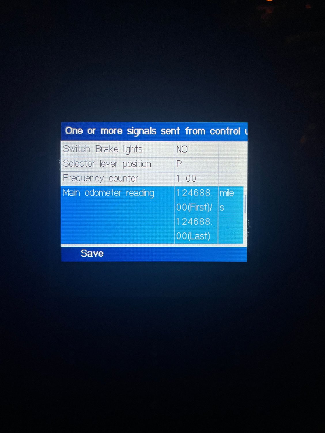

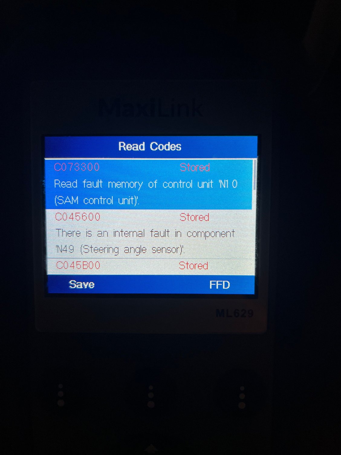

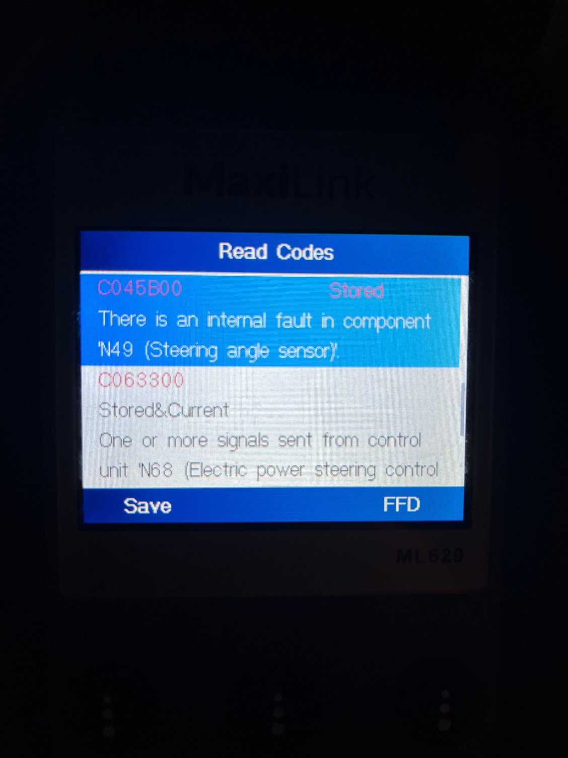

these are with engine run guns and codes and the voltage goes up to 14 which is good what does this mean I have a fuse problem or what
QUOTE=CaliBenzDriver;9264386]As explained... Rack assist is inactive without ENGINE RUNNING!
[/QUOTE]
what makes you think you have a fuse problem?
this is showing battery voltage... 12.56V
You do get ALT voltage right?
near 14.5V, true?
These data screens validate rack module is exchanging CAN data, at least some data.
WITH ENGINE RUNNING, Tranny in Park:
does you steering work as it should?
Clear faults and rescan chassis to collect fresh error report
