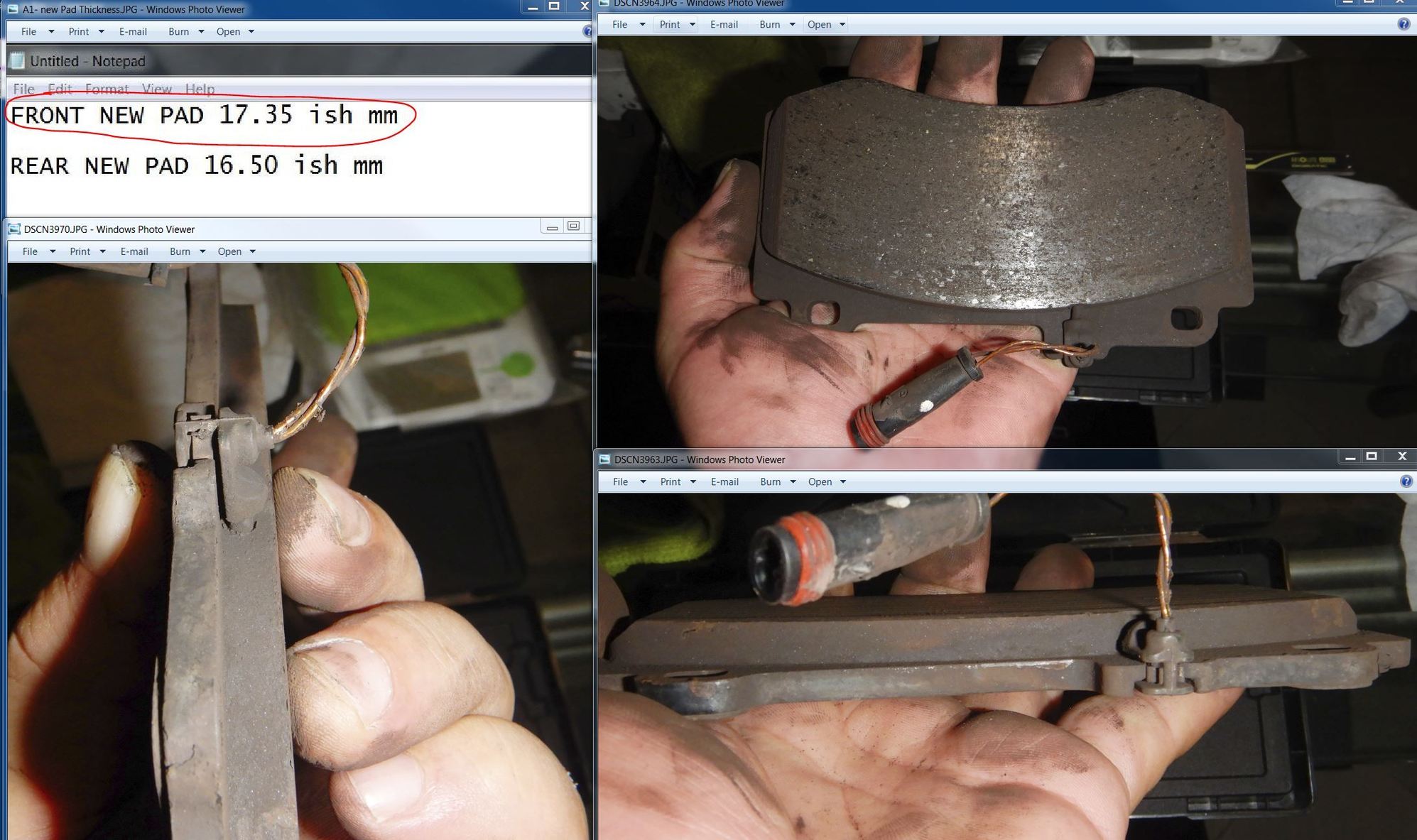

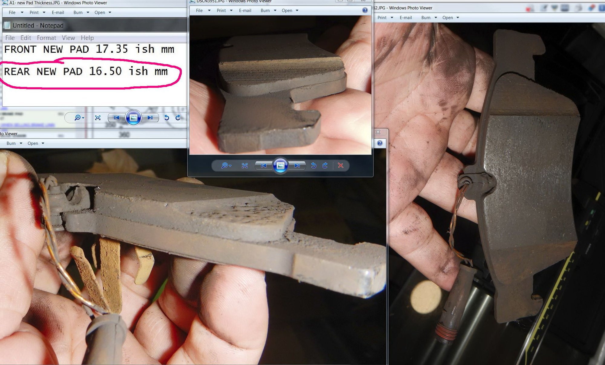

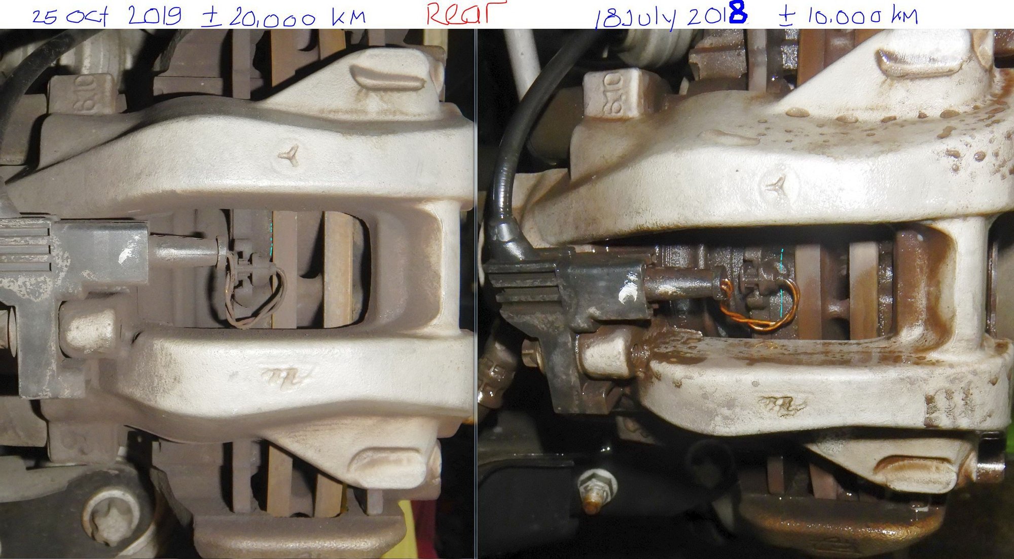

I can't say a 100% confidence for your cabriolet version which is a C class chassis, but 4 door W212 of mine , facelift,
has brake wear sensor only on one side of the rear and one side of the front brake pad.
However these are so cheap and important, I believe your cabrio must have such sensors installed too by MB.
The rear brake pad wear sensor is on the right rear brake pad. At 1 pad only.
The front brake pad wear sensor is also on the right front brake pad. At 1 pad only.
Both front and rear brake pad wear sensors been replaced, due to its wire coating looking bad. MB genuine.
Last year, I replaced again the rear brake pad wear sensor because I was doing-undoing the rear brake wear sensor so often due to parking brake and rotor replacement work/tuning.
This time I use knocked of MB parts...LOL. Work fine, because it was such a simple device, only copper trace, that is all.

The rear brake system, the caliper, if yours is like mine with plastic piston, you best replace the piston and also the piston seal + dust seal using Brembo Kit
Replace the rear rotor too and you get new good surface for the PARKING BRAKE and CALIPER BRAKE.
