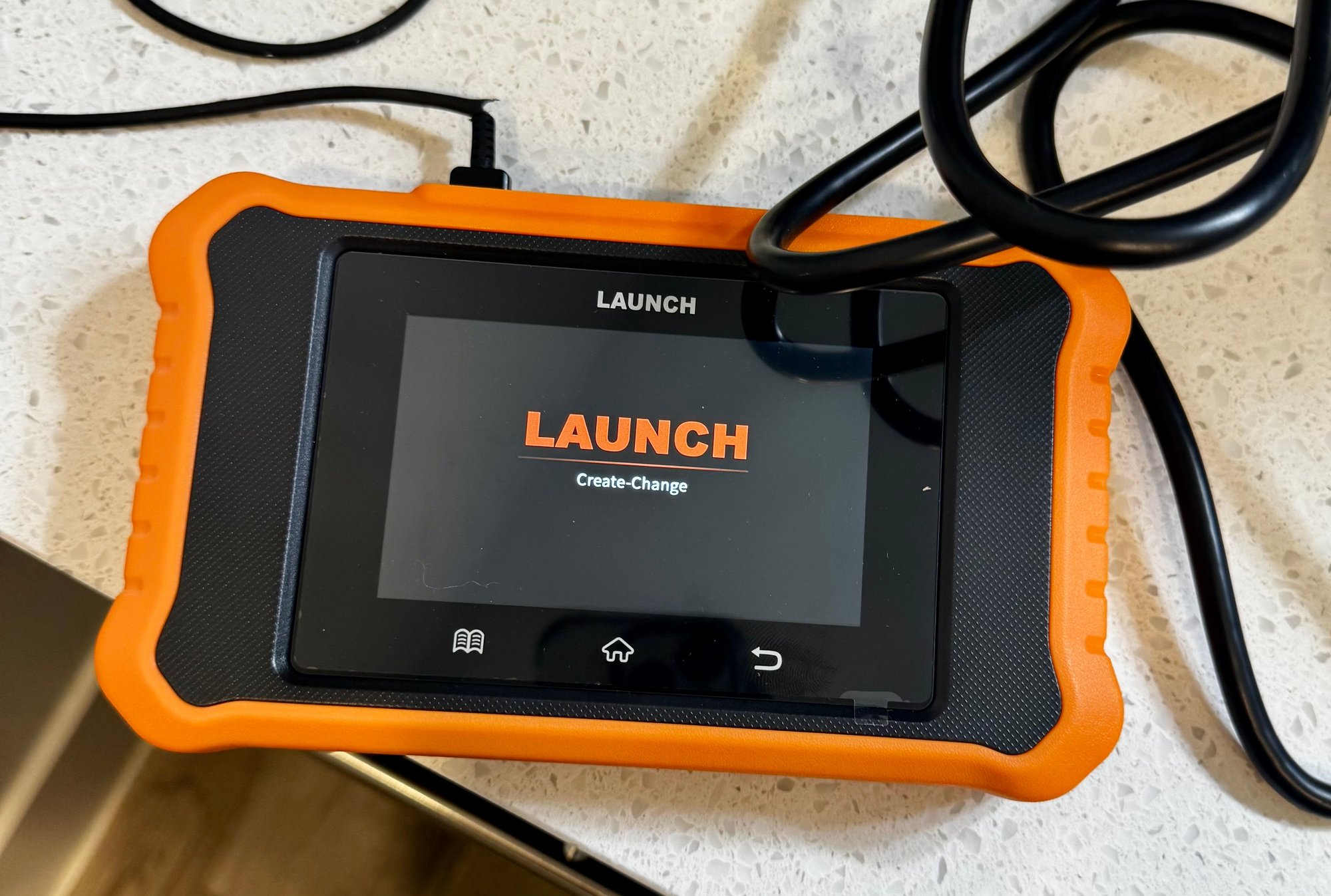

I’ll hopefully get this done tonight and then be able to use this new bad boy
What does the Launch device do that an Autel for example doesn't?

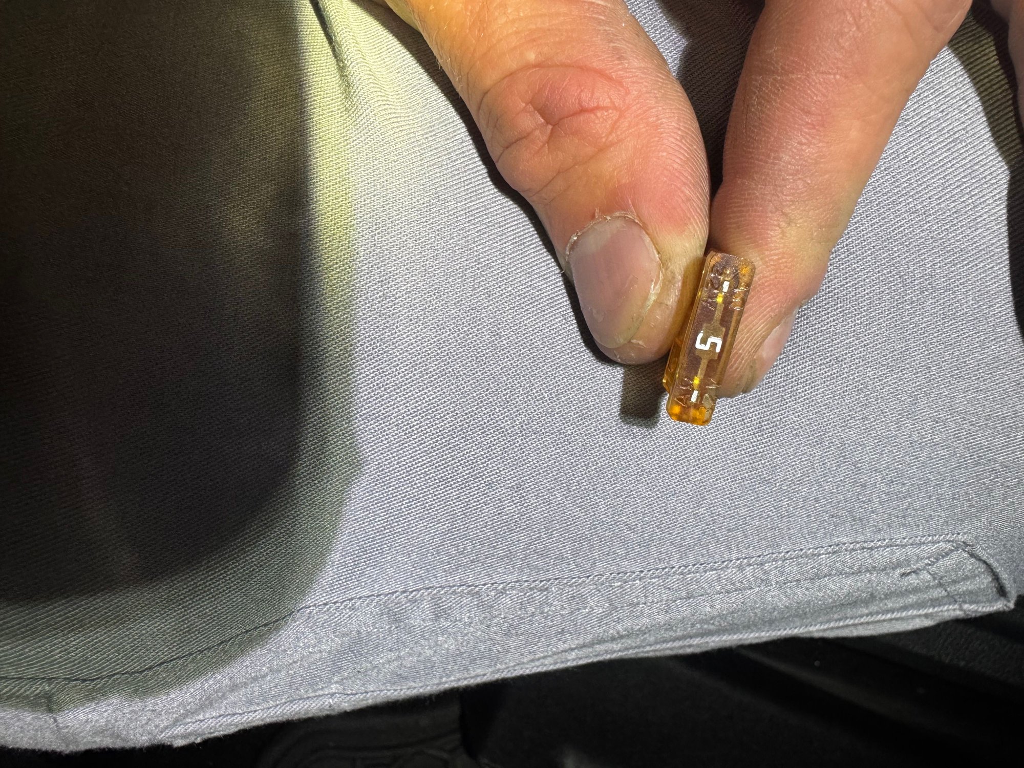

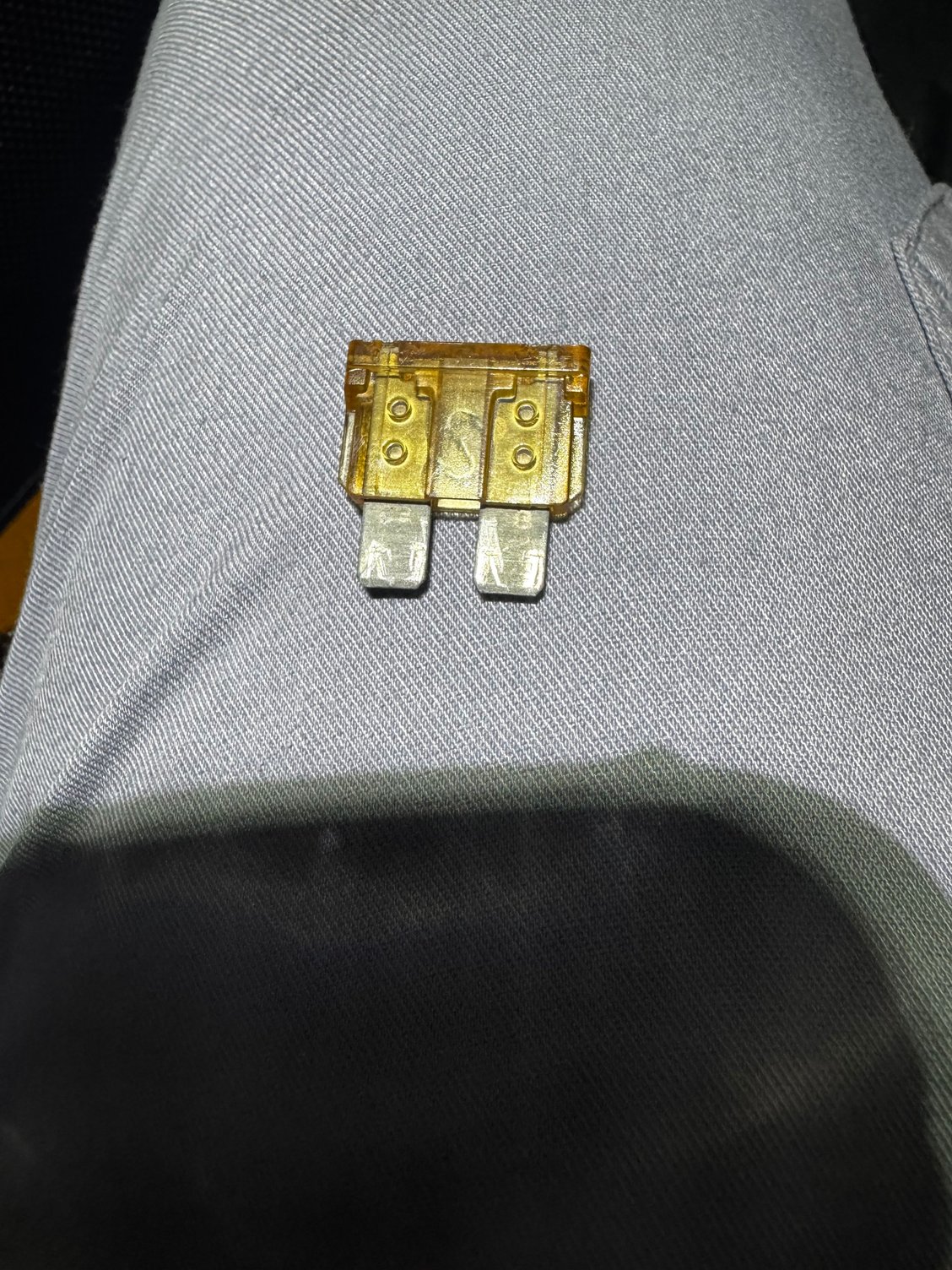

Is this fuse: Pass or Failed ? It looks fine.
The charging circuit is protected by a small fuse near AUX Batt. I think around 7.5A in Dark Red color.
The load side circuit is protected by a much bigger in-line fuse (70 to 100A).
You should try to keep your batteries charged full to minimize low-voltage glitches during crank. It bugs the snut out of CAN modules.

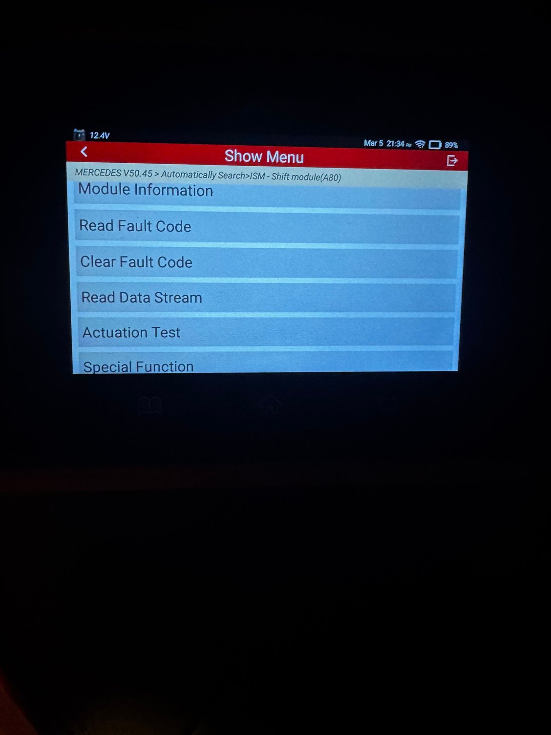

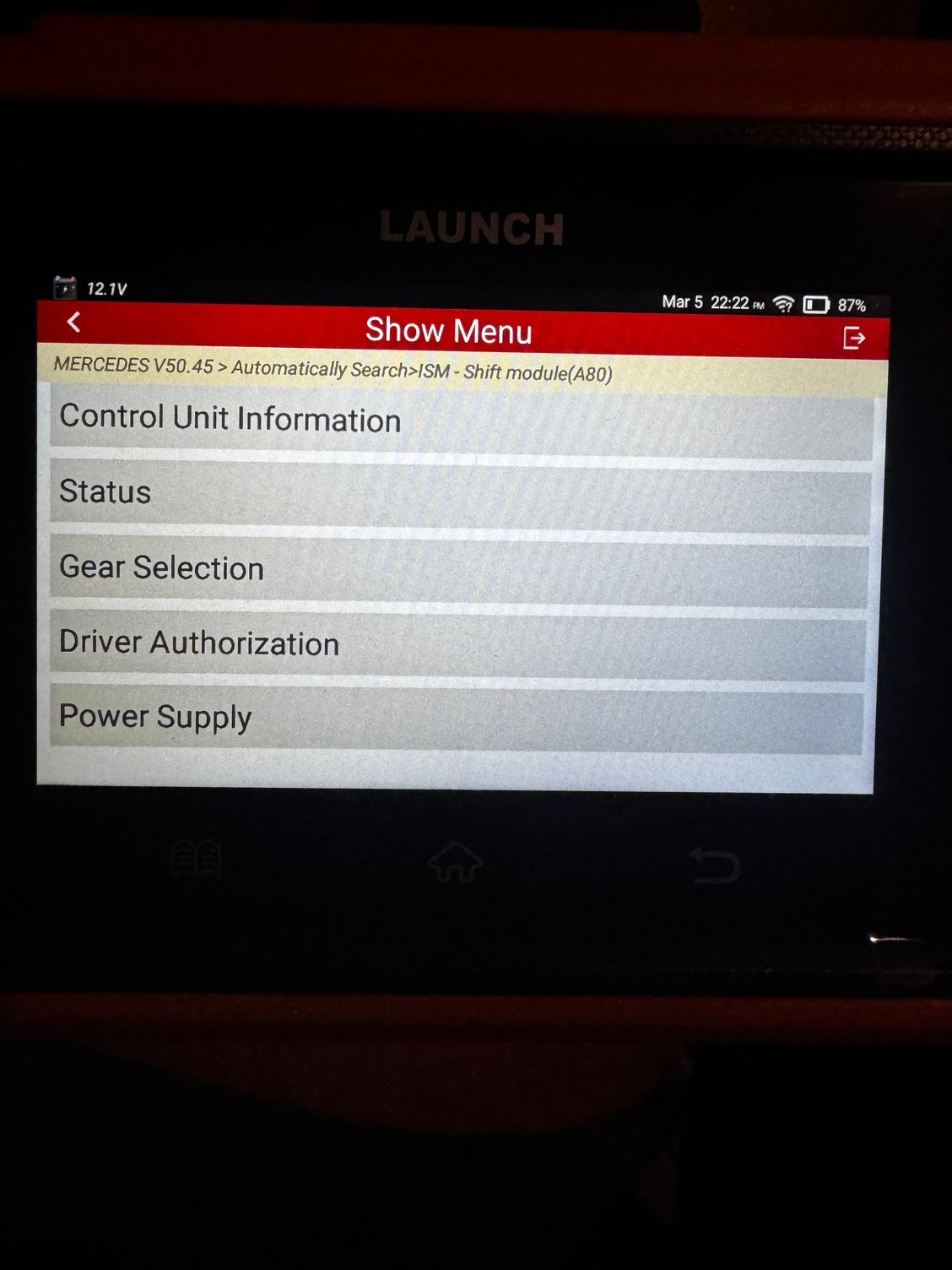

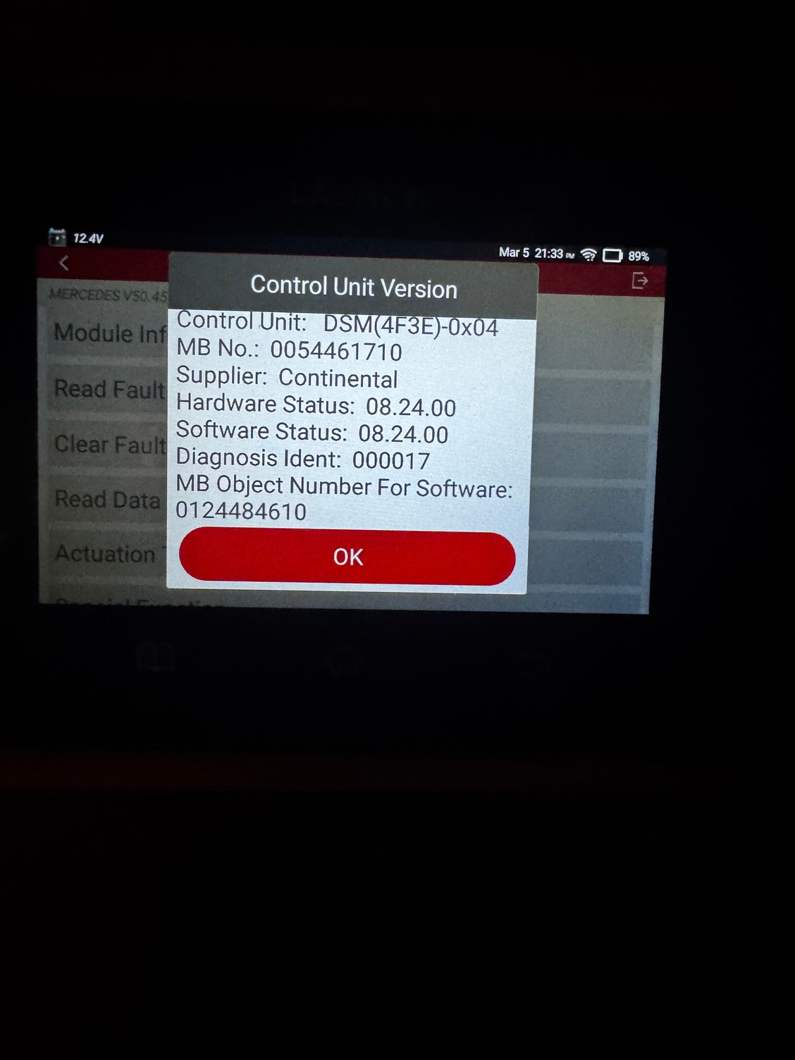

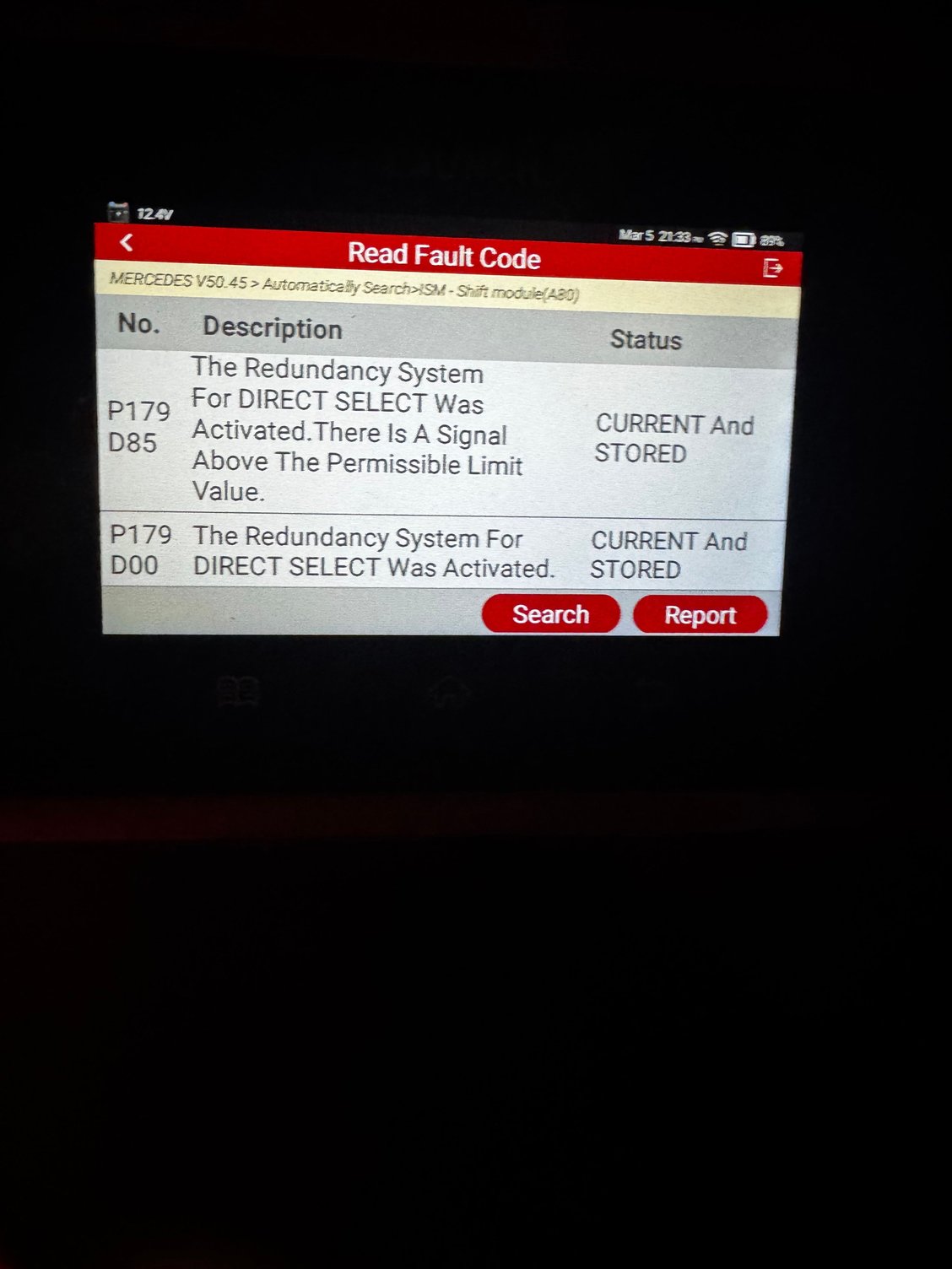

OK, so I have a report for both when the engine was on and the ignition on position two after clearing the fault codes. What a difference having fully charged batteries makes.
It looks like there’s definitely an issue with the ISM, but the EIS/EZS seems fine, which is a relief!
The tailgate is messed up due to the body damage on the driver side quarter panel.
The multi contour driver seat probably needs new bladders.
but what has me very excited is the temperature/humidity sensor warning for the AC that could be the reason my vehicles fan kicking on after shut off, killing my batteries while parked.
Let me know what you think possible ways to get my vehicle to shift. Thank you

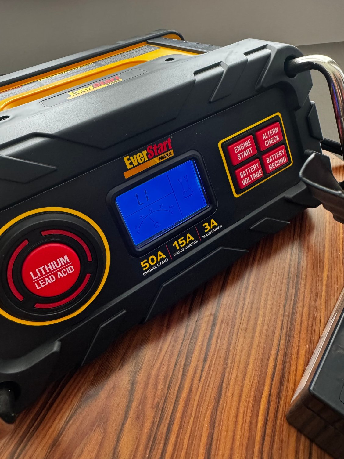

step by step...
This busy list cleaned up very nicely indeed !
Now the top concerns look like ISM + ESP + fan/drain by parking
The good news is your ISM is likely A-ok...
false troubles were triggered by "AUX power without MAIN" on-line.
Simply go in the ISM module menu to clear it's fault !
Use you beefy "Charger-power supply" to maintain your Main power higher than 12.6V under load.
Then you can deal with the fault of ESP module and your sleepless fan...

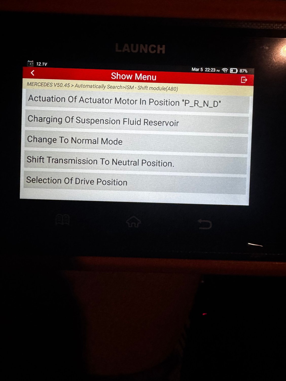

Well, I cleared the fault already and it came right back. Do you still think the ISM is OK?
Old Mar 5, 2026 | 10:02 PM
  #42
CaliBenzDriver's Avatar
Joined: Apr 2019
Posts: 11,921
Likes: 6,775
From: Silicon Valley
W212 MY'14 M276-3.5NA @75kMi
I hope for you it is: $$$$
Right now ISM is doing its normal job in safety mode because it has sensed a battery power failure - Go in the module and read data and fault: see what it says.
Your scanner is paying for itself when you use it.
ISM does have a cycle count - If its been upset too many times by low voltage it locks up like an oyster.

The AAC Module has MANY temp sensors in each vent, on the evaporator coil and in the cabin using tiny fans in the OCP using remote networking.
In addition the A/C condenser has a pression sensor that ECU reads to decide to overcool the engine. This sensor must read in range near 60Psi.
Use the scanner to work out the module faults... look at live data the exact way the system sees everything.
This is the one I was referring to…
FYI scan is almost complete, then I’ll clear re ISM fault
What makes you pick this temp sensor ??
You can change it if you want
then resume troubleshooting what is wrong!
Thousand parts could be bad... the one we are interested in are those that are actively messing things up.

2011 E350 4MATIC Wagon
I just cleared the code. What should I do next? Also, there’s a few different menus as far as the data stream and running an actuation test….
I think you should focus on putting ISM faults behind you once and for all
 ENU OPTIONS: live data stream &
MENU OPTIONS: live data stream & "actuation test"
"above permissible limit value...."
Your luck here is that the ISM go triggered when you had messed battery voltage + partially disconnected MAIN but not AUX.
So this is not the standard true ISM failure - It's a hick up
Live data stream menu
Actuation test menu
Actuation test menu
