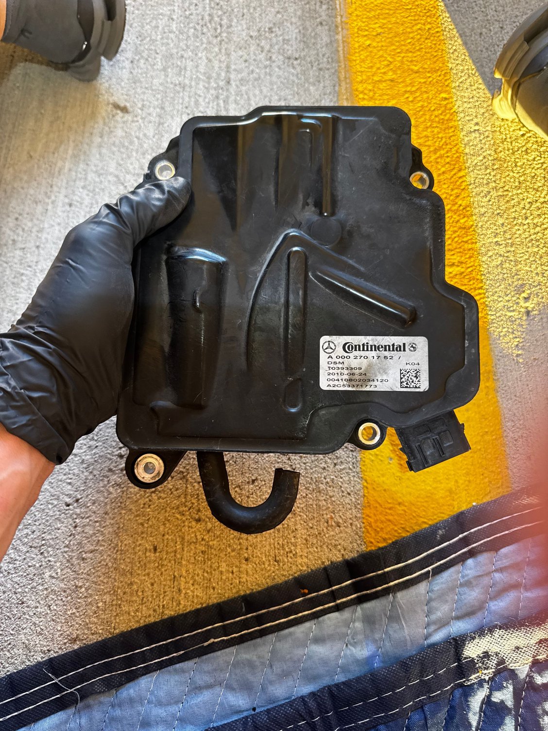

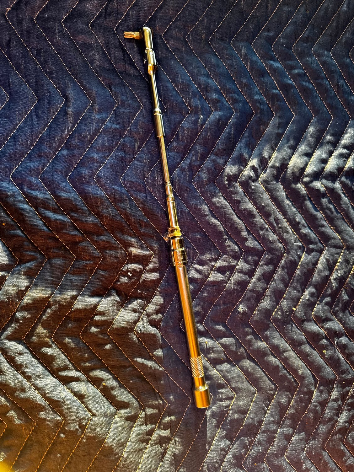

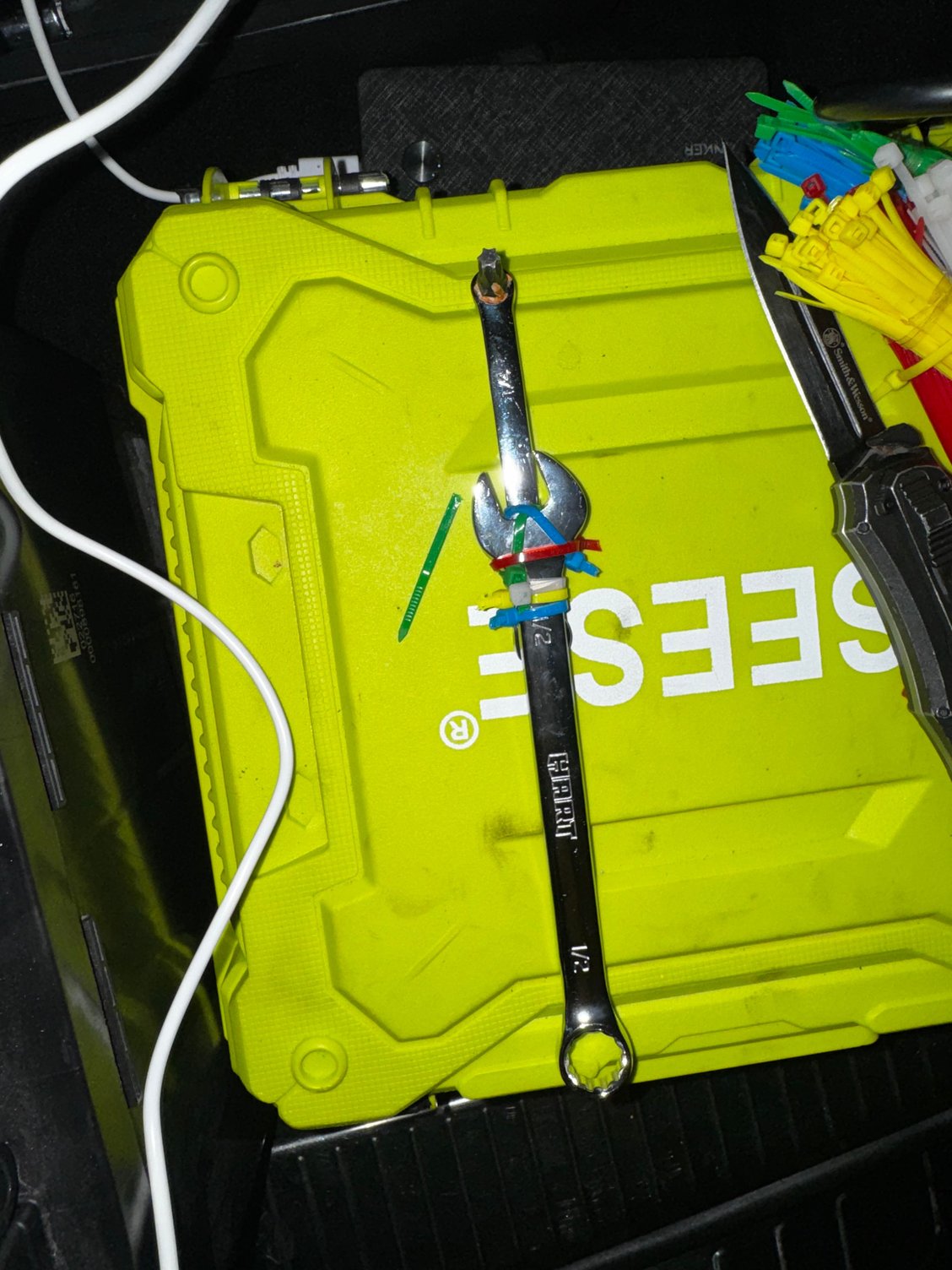

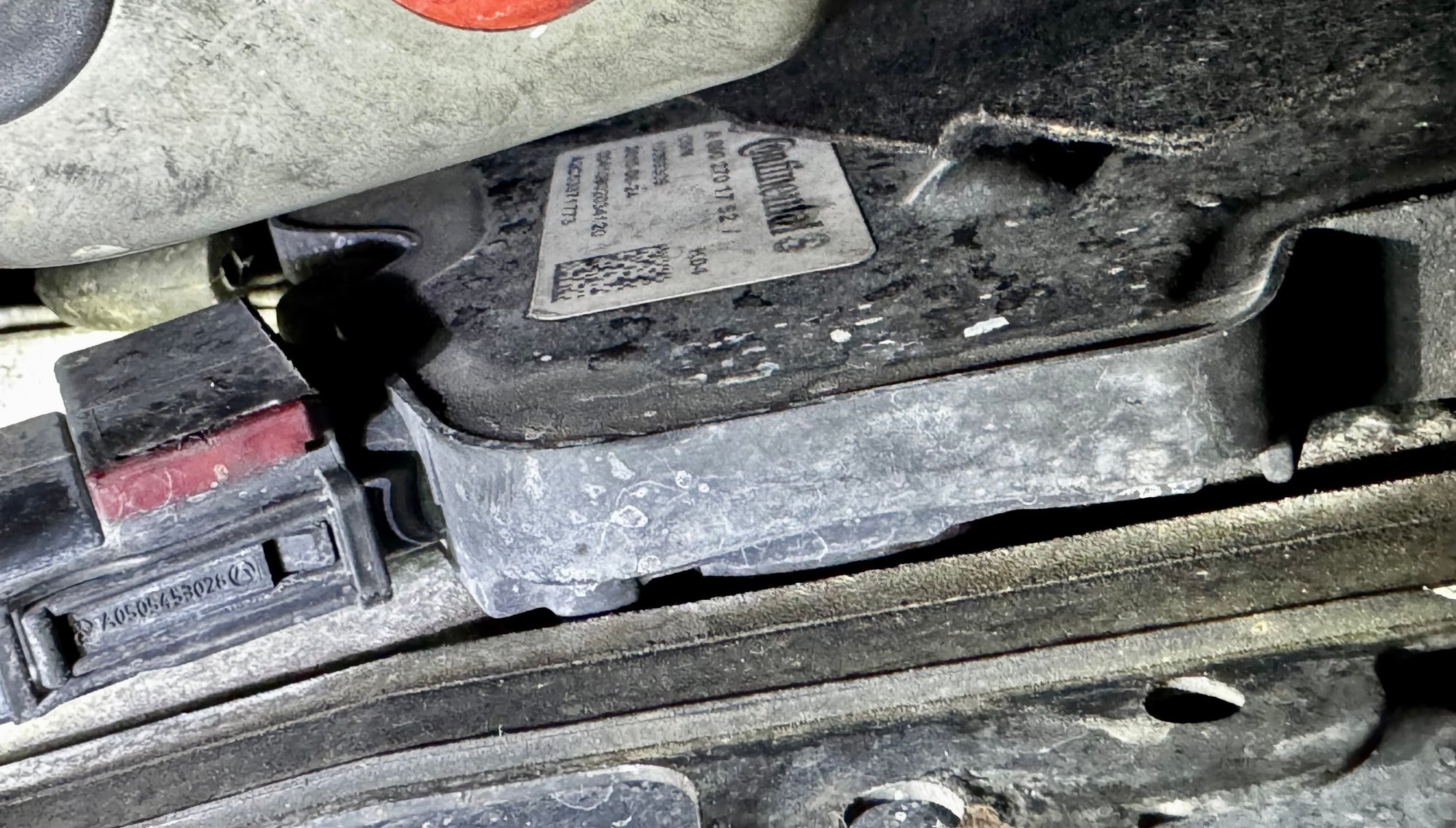

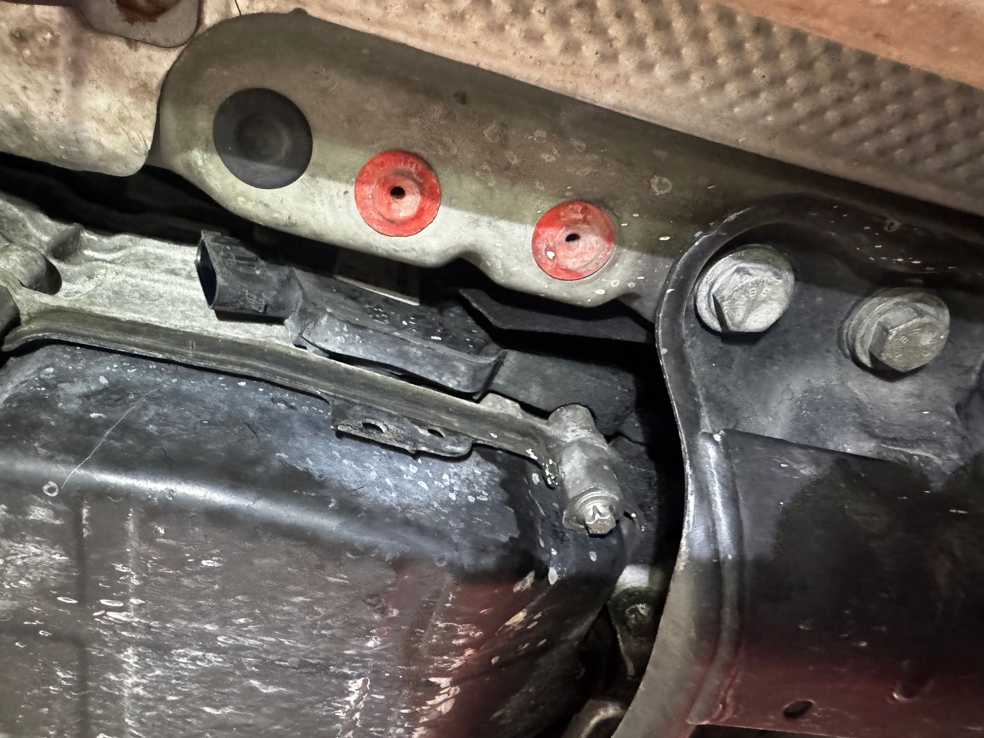

A few days ago I decided to go ahead and order a New aftermarket ISM from a seller on eBay. I know I’m taking a huge gamble and it probably won’t work, but he promised he’d take it back if it didn’t work so I decided what the hey. I’ll try it. Getting the ISM removed without doing the transmission is an absolute nightmare.
I had a floor jack and stands, so I did the job on my back with just inches between my nose and the bottom of the transmission. There is barely an inch between the ism and the body of the car and I had to use a mirror to see the top bolts. I ended up making my own tool, which believe it or not actually worked at getting the top bolts loose, but ended up getting a smaller ratchet at Harbor Freight the next day to make line easier.
If the new aftermarket ISM doesn’t work then I’ll find a used OE example and have it reprogrammed. I’ll know Monday night or Tuesday when it arrives.

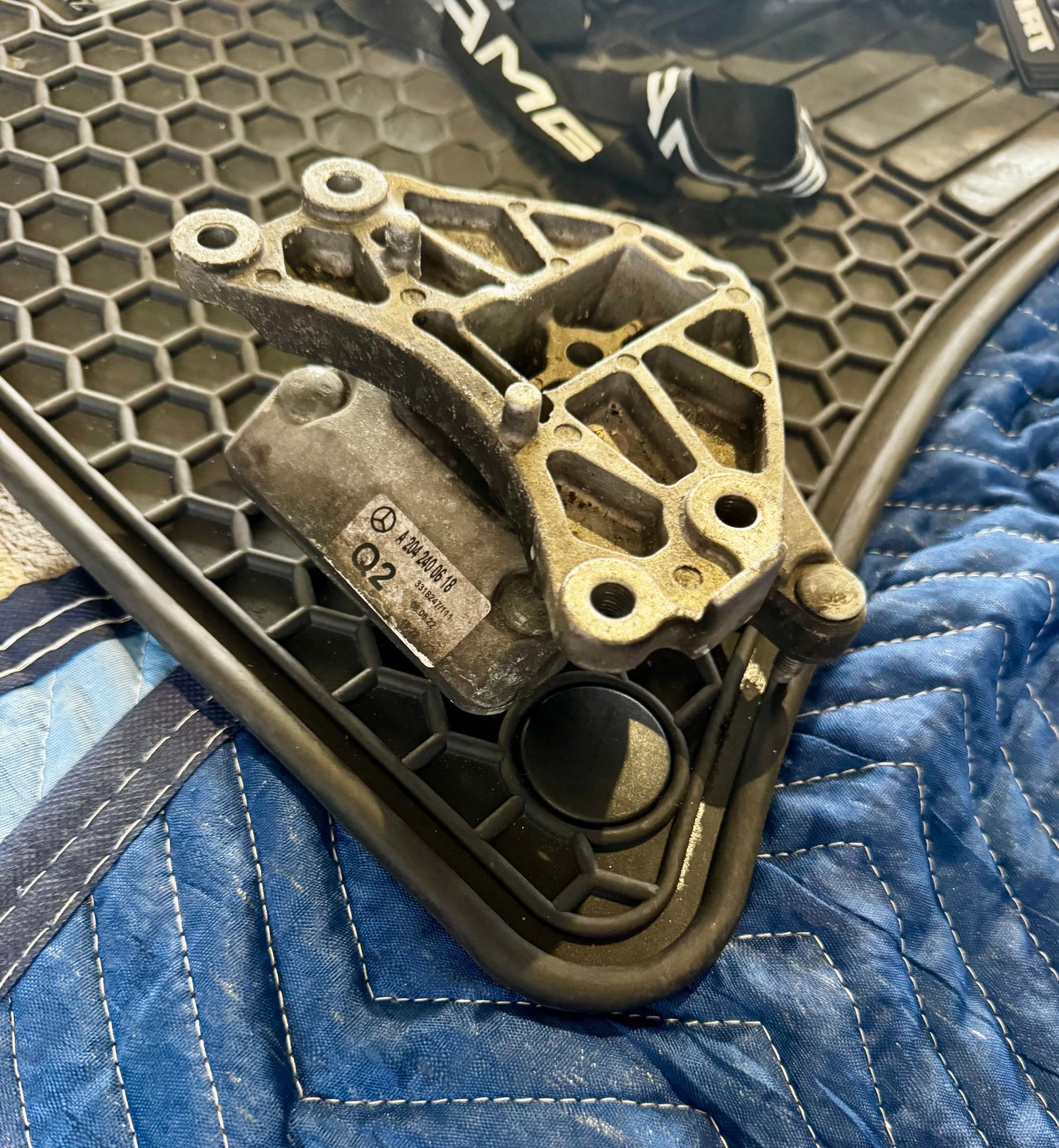

Might as well replace the transmission mount while I’m at it.
Makeshift tool
Makeshift tool

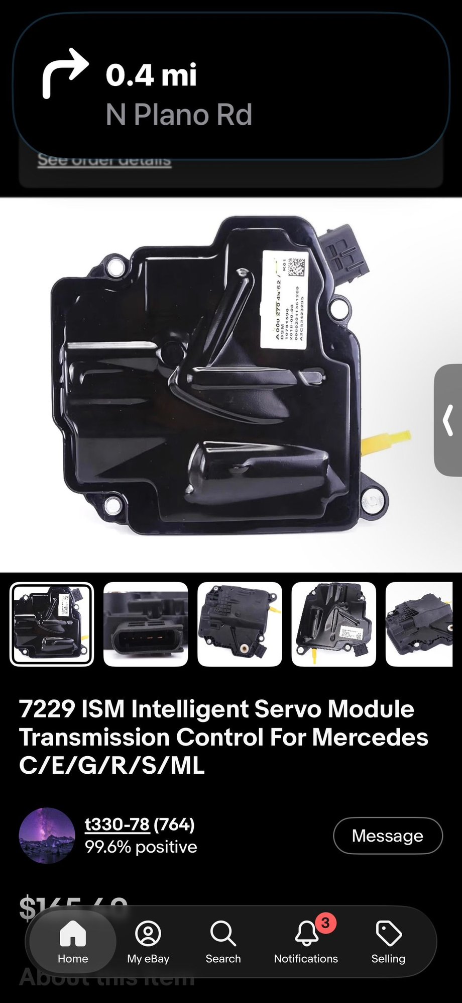

New aftermarket ISM
New aftermarket ISM

Thank you, sir. I appreciate that! I just received the new ISM in the mail this morning and put it onto this line and tighten the two lower torque bolts since the two top ones are a complete pain, and I don’t want to install them unless I know this new ISM will work. I’m charging up the battery separately outside of my vehicle as we speak so I can start the car with a full charge.
Any other suggestions before I get started here?
Just FYI, the ISM I just installed is a new aftermarket unit, not used, so there shouldn’t be any programming to be erased or the need to be “virginized”. The reviews of this exact one are 50-50 on Amazon, so fingers crossed. The brand is “LDGSUPH” from China.
If this doesn’t work, then I’ll find a secondhand unit and send that off to be programmed to my vehicle

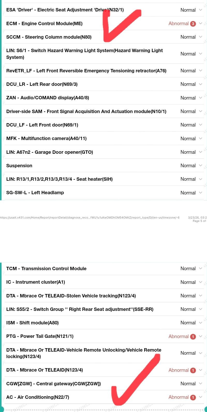

Also, here’s a scan of my vehicle with no ISM installed…

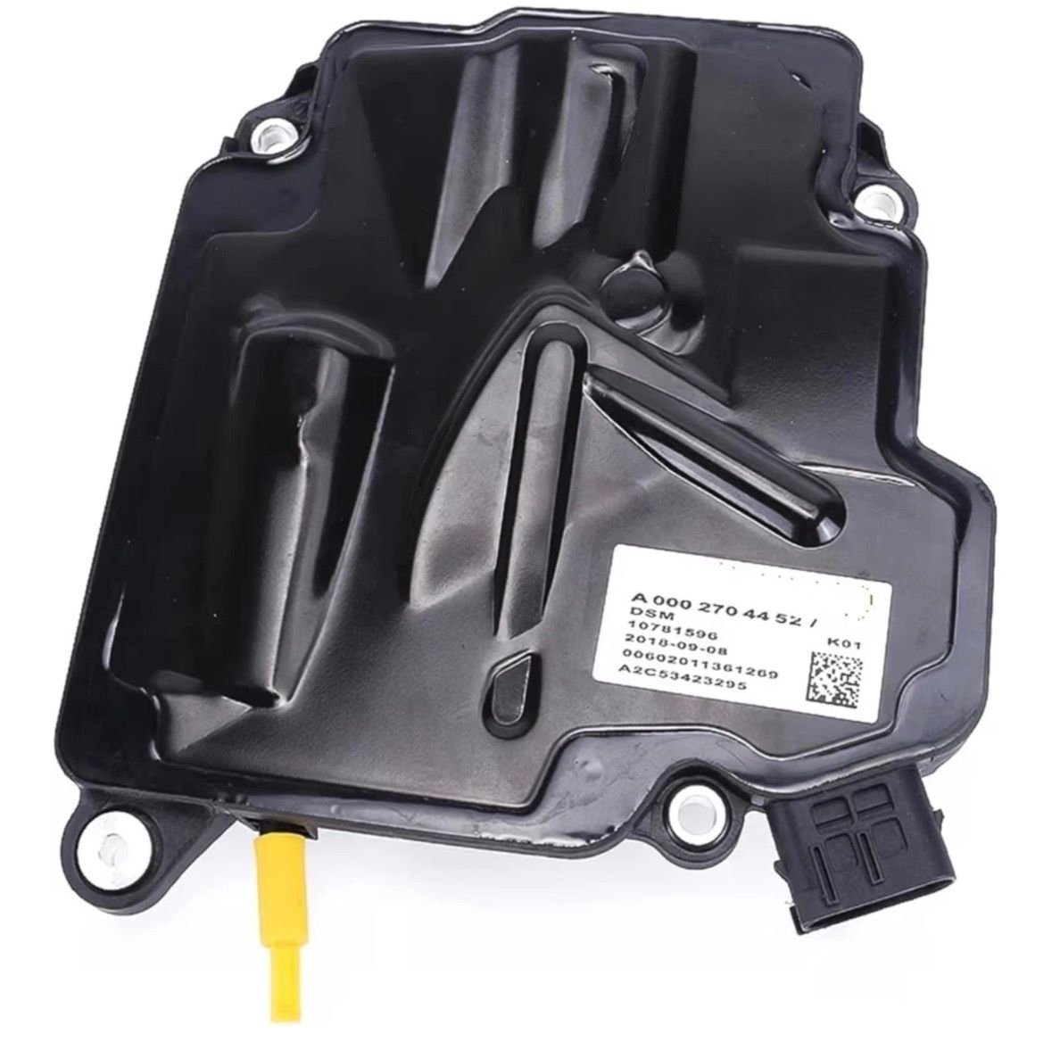

I can’t believe that ISM actually worked! We’re back in business!

NEW ISM MIRACLE
This is an extremely good news :
New ISM running without SCN coding
now back driving again!
ISM is a security part Mercedes does not retail to anyone without a professional licence. Price through the roof!
"Drive authorization" is linked to ISM with enrolled keyfob security.
This simply working is noteworthy: great!

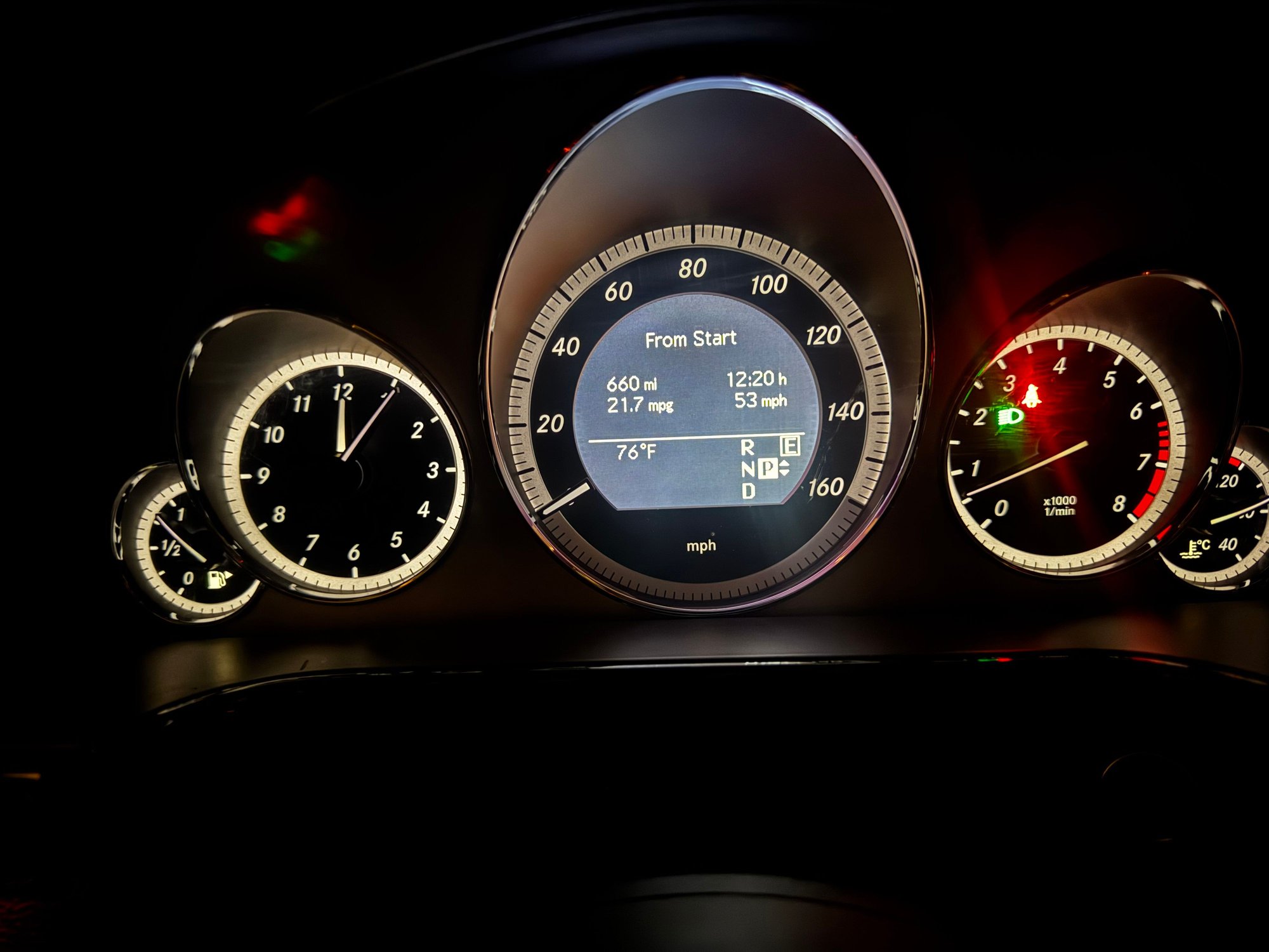

UPDATE: after driving from Plano (Dallas) to Lake Jackson (Houston) and back there were zero issues with the ISM, direct select, transmission, etc. all seem to be working flawlessly after repairs.

i used the existing harness as I didn’t have access to a soldering iron and the message went away with the new sensor installed and existing harness.
MOST RECENT UPDATE : The engine cooling fan won’t STFU when parked, driving, then parked again and the ambient temperature sensor warning is back on and won’t erase. I had to unplug the fan rather than kill the battery since I can’t also turn off the AUX battery.
Then a new problem started the health report. Check on my scanner keeps getting stuck at 70% progress when scanning the pneumatic pump for multi contour seats. PPAKS. So, I unplugged the 30 amp number 60 fuse in the rear fuse box and it scans on the way I’ll include it below the body of this this comment
You have your next steps all cut out with your Ambient temp sensor...
I read your scan report: very minimal issues, not bad. Seat pump usually gets a hot workout when seat hoses leak to burn up the pump (much like AirMatic suspensions).
You've realized that disconnecting Main AGM but keeping AUX only creates many troubles. Disconnect both batteries or none. Clear faults when reconnecting.
