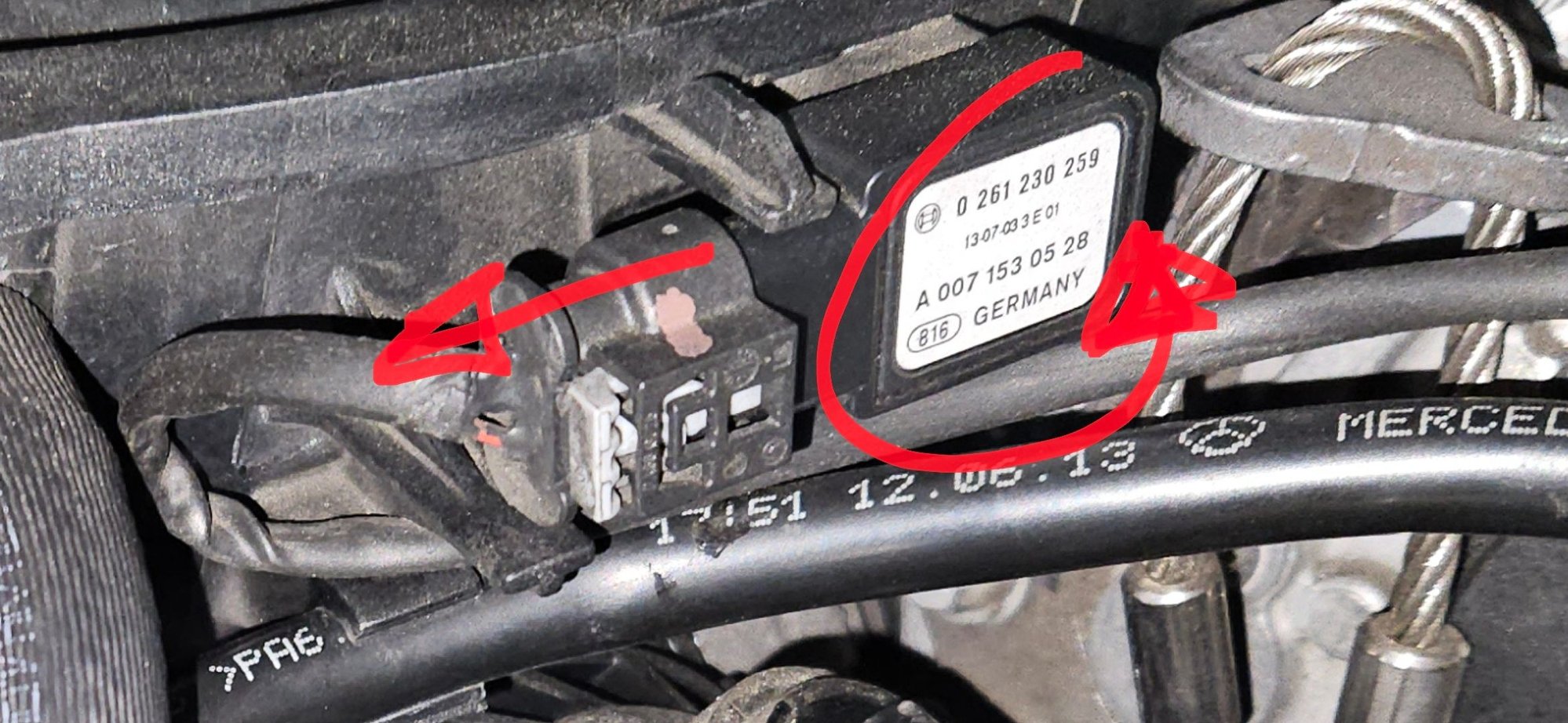

Where specifically is the MAP sensor?

> MAP vs. MAF....
The M276-NA runs with a MAP sensor located downstream to measures the intake negative PRESSURE ie. an actual vacuum.
The M276-TT runs with a MAF sensor that measure AIR FLOW charged through the intake.
Clean your oily MAP sensor with solvent or alcohol.
It's a solid state electronic unit, more or less rugged... do not blow pressure onto it !!
M276 NA Intake on driver side
The intake MAP vacuum sensor
> 5mn Cleaning Procedure:
  • Unlatch connector then pull it forward
  • Turn the sensor CCW 1/4-Turn down
  • Pull sensor out sideway
  • Clean oil /dry it out
  • Reinstall /reconnect harness
  • Clear ECU fault code...
  • Test drive.
