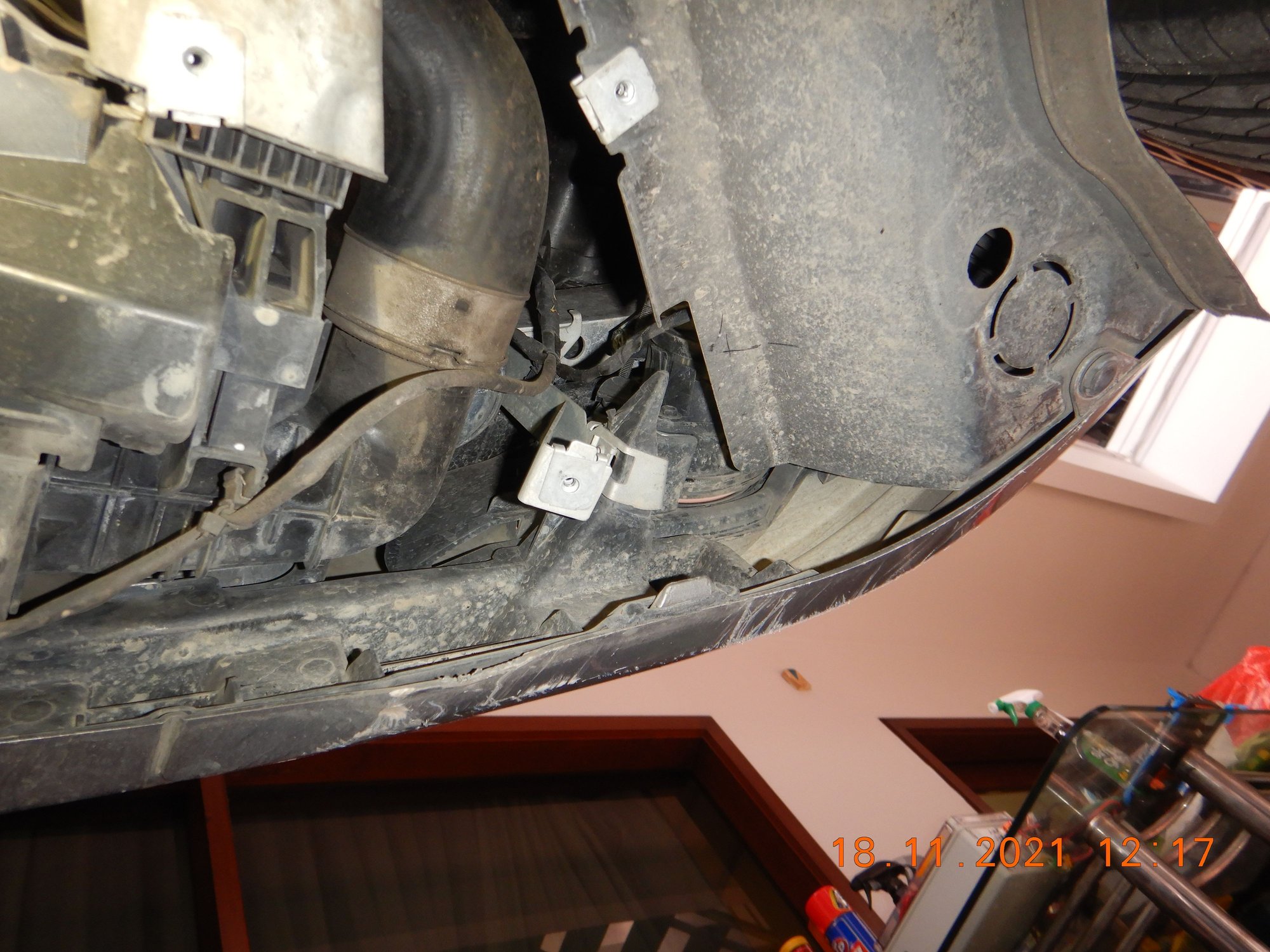

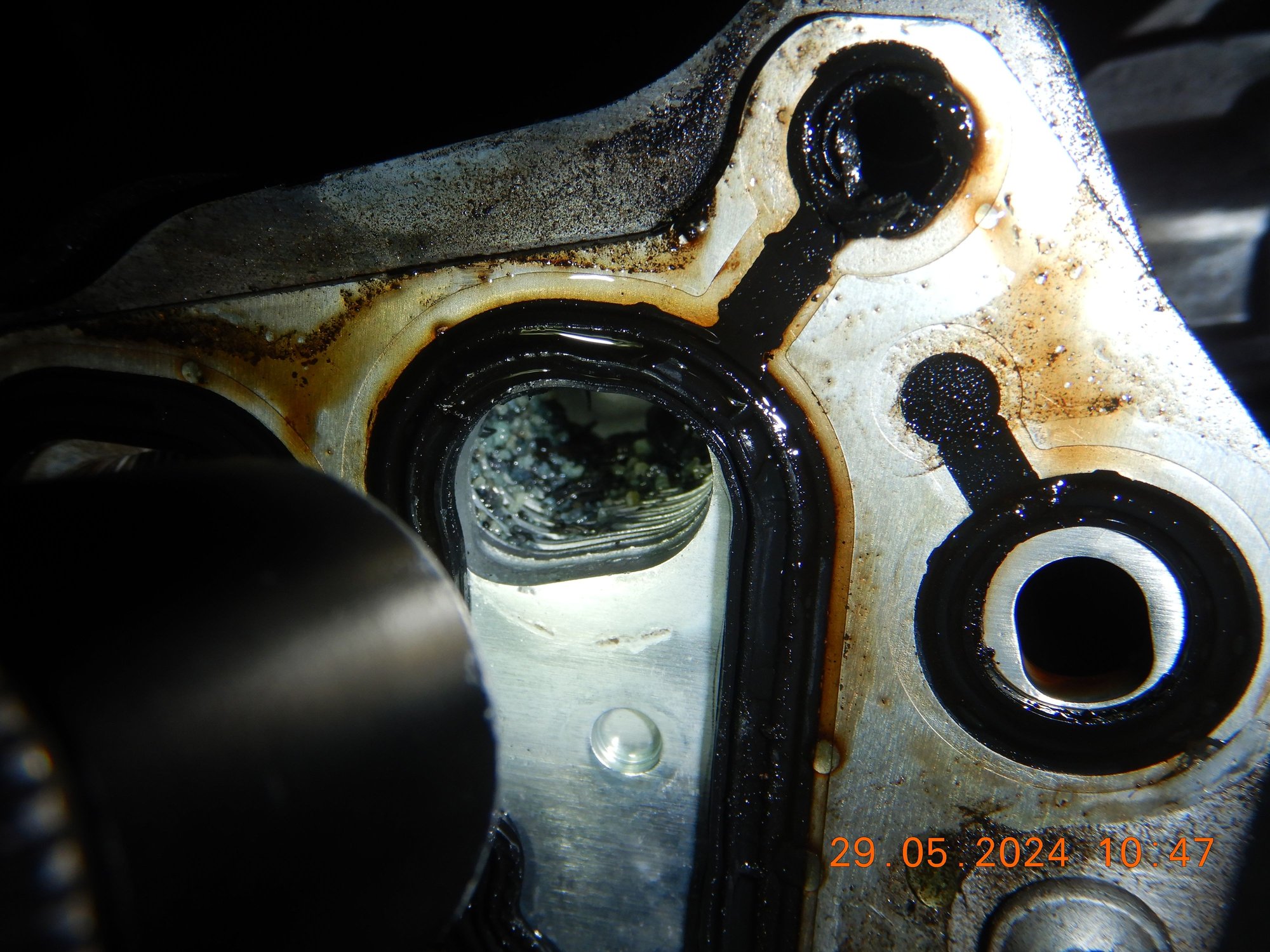

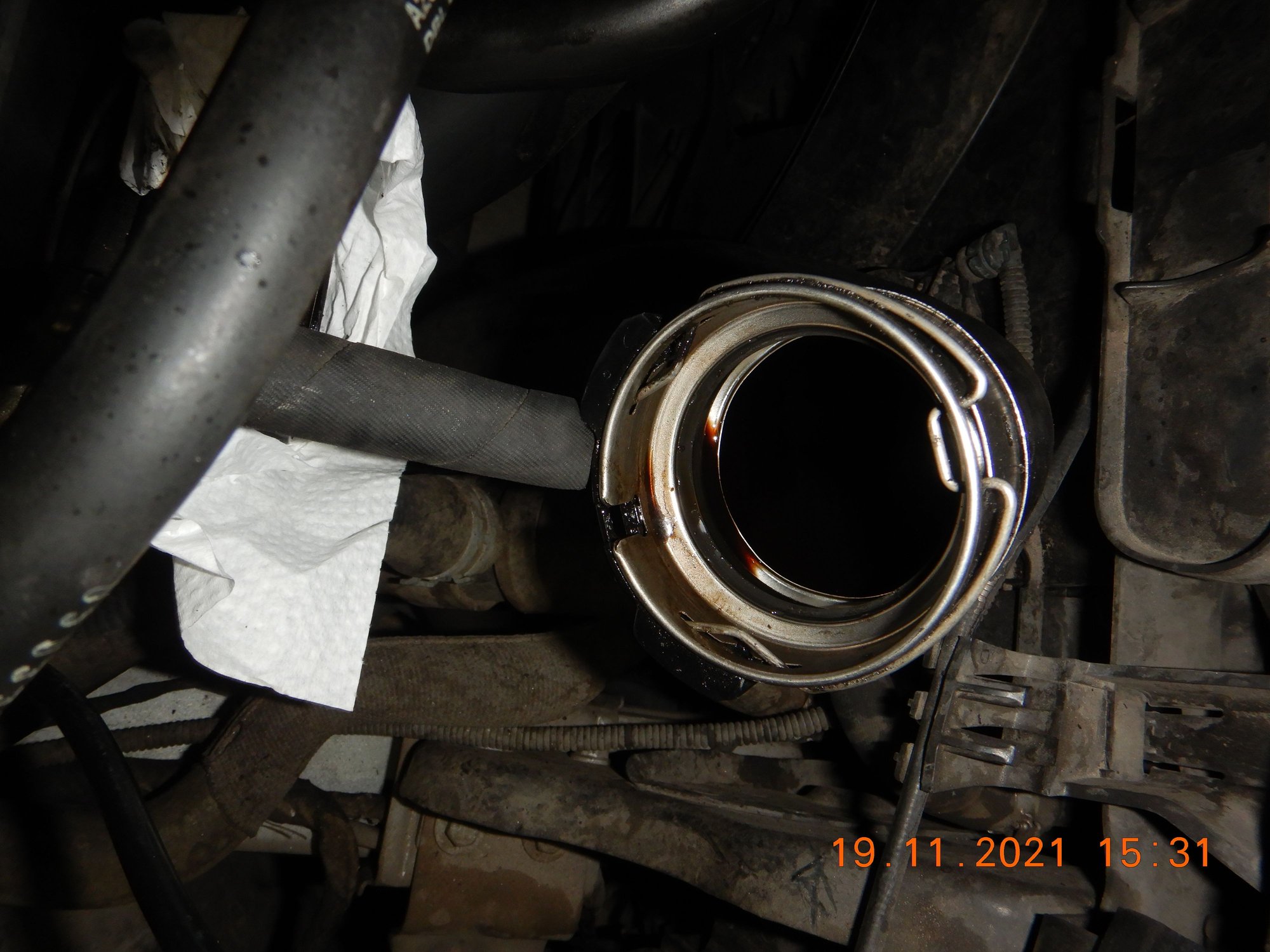

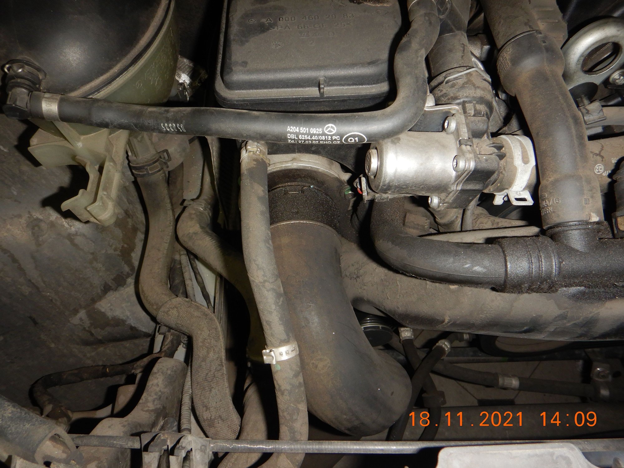

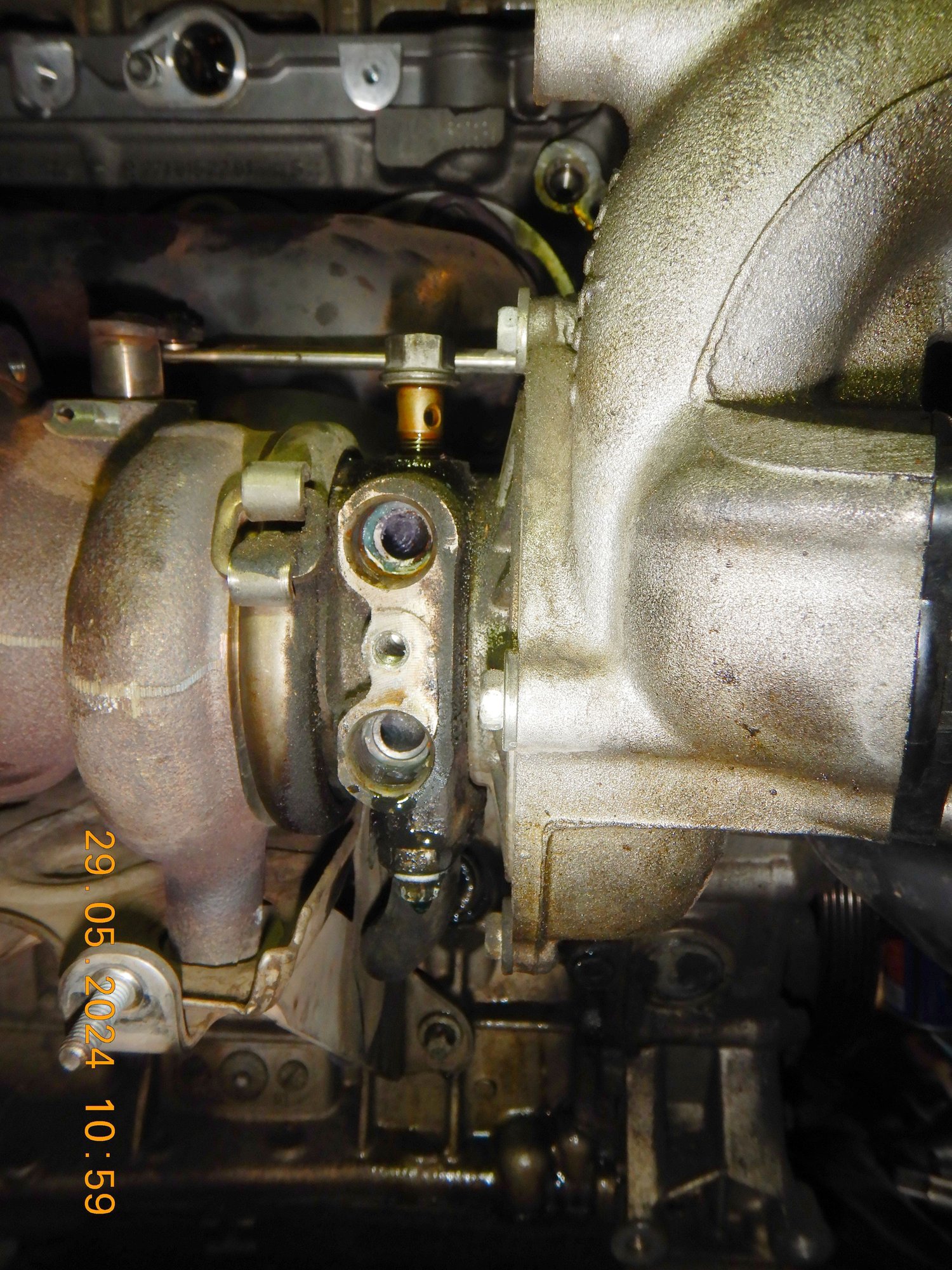

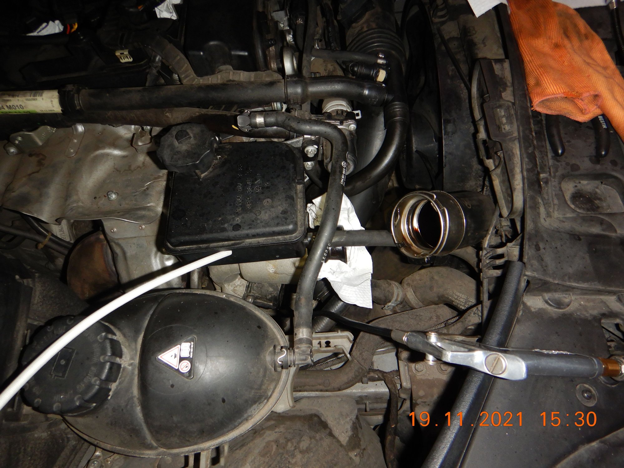

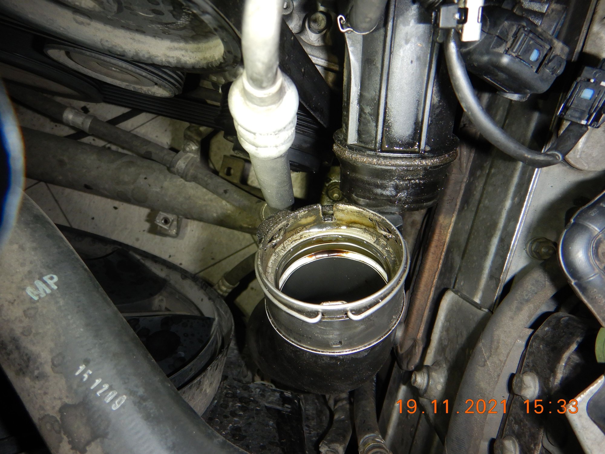

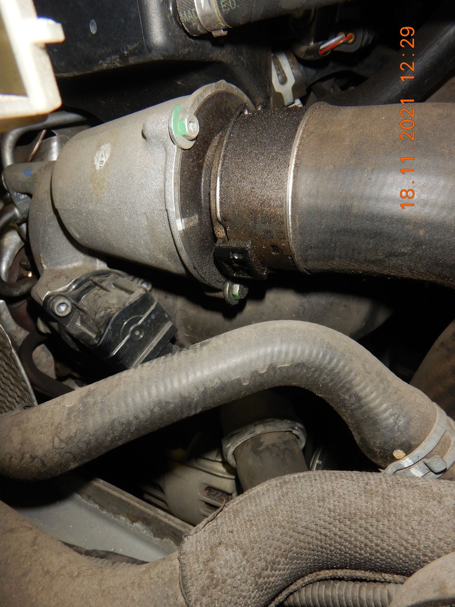

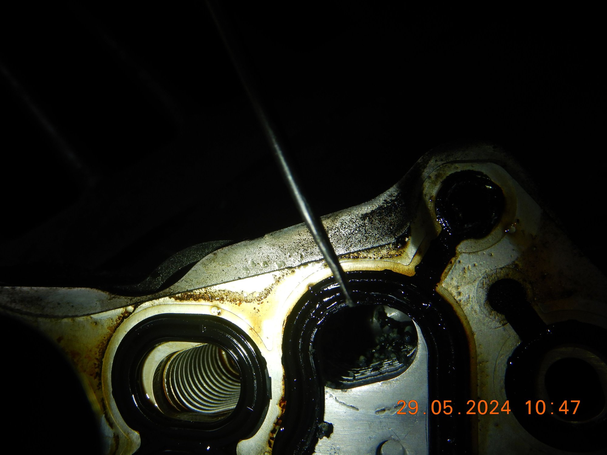

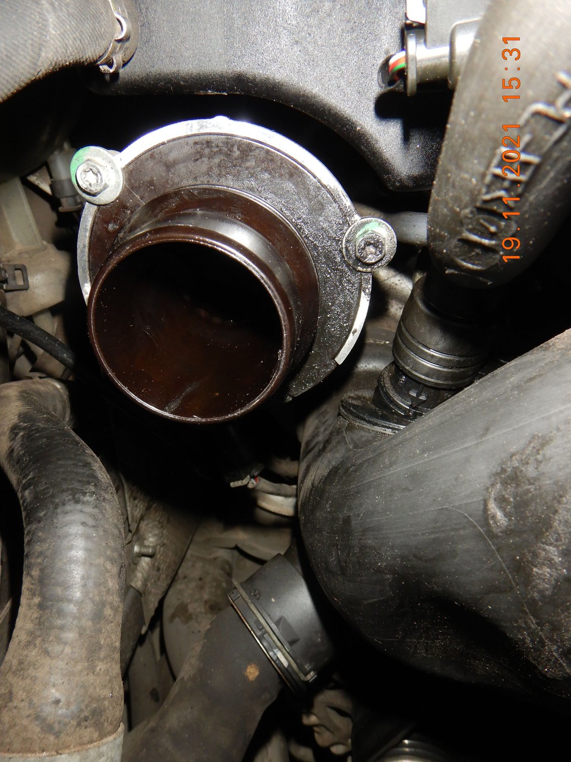

M271.8 uses air to air aftercooler.
Quite oily air , due to often bad performing breather system which among others is the plastic cylinder head cover as part of the PCV system.
The rubber boost hose has unique seal on each of its hose METAL end, it does not use hose clamp but a locking clip shaped like a U ring, hence it has o-ring as metal to metal/plastic sealing.
Attached the tech doc on M271.8 EVO, where owner can learn of his engine.
Turbo charged air output RUBBER hose #1, before going to aftercooler. See the metal oil hose end.
The above hose, its other hose end, into aftercooler
The special clip I mentioned.
The metal hose end has internal o-ring seal, which can also leak.
The 2nd hose, aftercooler output to intake manifold. This is the hose end at the intake manifold throttle body adapter
Throttle body seen from its plastic adapter
Your plastic engine oil filter +oil cooler housing combo if it never yet fail, it will fail guaranteed. Sad, I know, but it is what it is.
The turbo charger oil seal (2) and coolant seal 2), will leak too
This coolant plastic hose,will break too. Plastic with age & vibration = brittle. 10 years is good enough already. This W204 plastic pipe 13-14 years old when broken, very fair.
Soon your PCV system will need love too.
I wont post more photos, I do not want you to loose sleep.
Good luck maintaining your aging car, its always a challenge for us when many parts uses plastic and o-ring seals.
My W212 E400 is aging too........

Originally Posted by S-Prihadi;[url=tel:9276305
9276305[/url]]M271.8 uses air to air aftercooler.
Thank you for the immense treasure trove of information!!

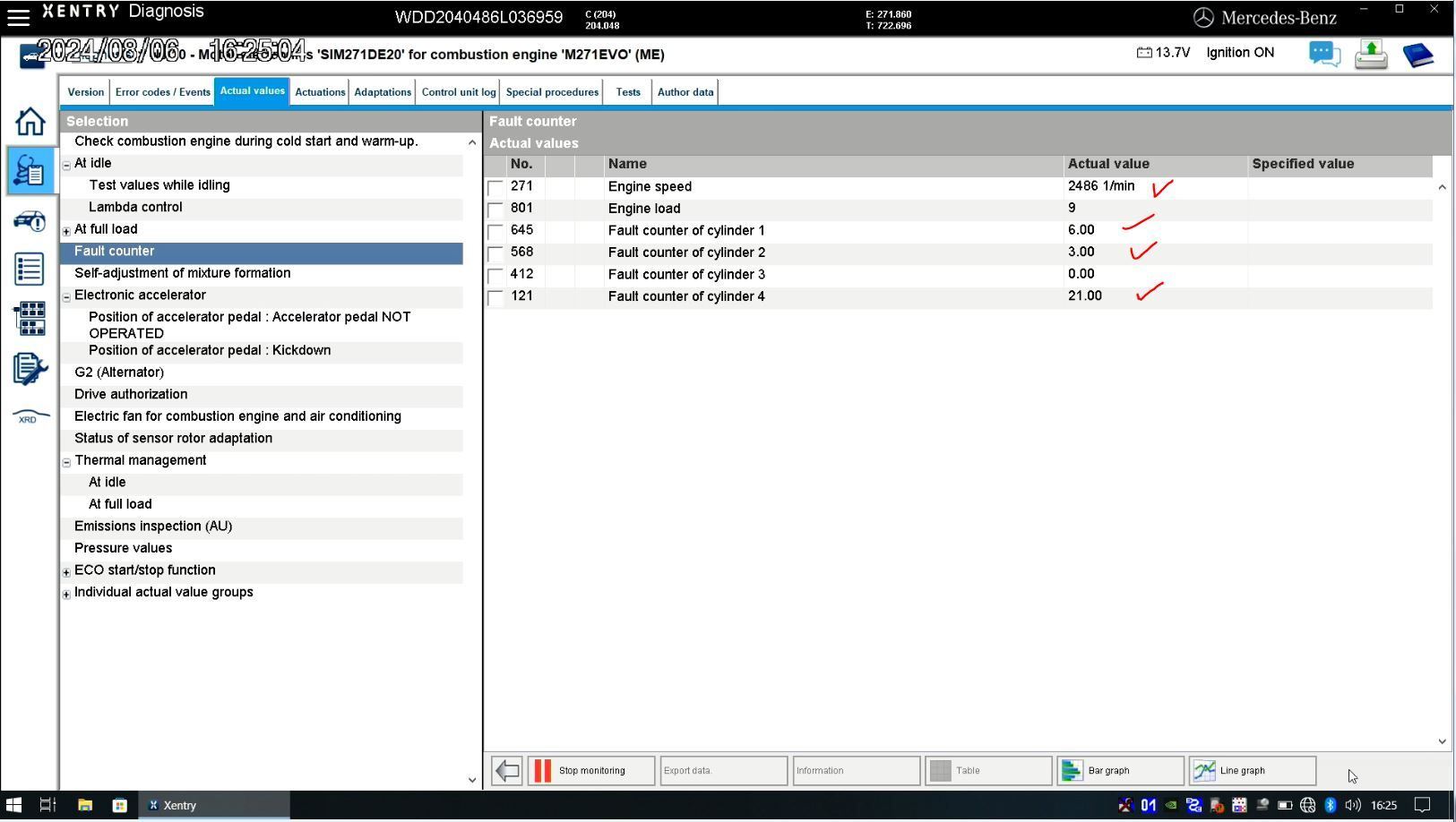

See if someone mess with the swirl motor and did not install it properly back to its ZERO.
Use a scanner capable of reading MISFIRES or FAULT COUNTER
Read here.........
https://mbworld.org/forums/e-class-w...ke-system.html
Good luck

Big Launch surely can read misfire or its equivalent name FAULT COUNTER or similar.
It surely will be under SIM271 EVO engine computer, as per the post I linked, see example below the top part is the module name
The swirl flap can it do full movement when controlled by scanner ?
I am having doubts with how you or workshop does thing ...........sorry but that is how I feel, because everyone doing cars, should know misfire count MUST COME FROM ENGINE COMPUTER....

Yes, use your LAUNCH scanner to read misfire............
and do the full test for swirl flap like what I did using MB Xentry.
Launch should have the same test menu like Xentry, or very similar.....
