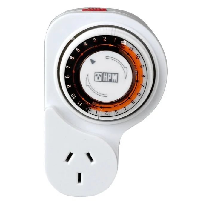

Use a proper battery charger ie one where you can select the correct battery type eg AGM
Have a rotary timer (or digital version) like you use on lamps when you are not home
So you have say 30 mins charge every day and then it switches off
This one has little fingers that you press down to select the time that you want it to give power
Use the direct battery connection under the red slide
Use the earth post that is like a fat brass bolt
Use leads that are suitable for the current
Have a fuse in line with positive, just in case the charger craps itself and puts a short on the battery
You don't want things going up in flames when you are not around
Be careful because under the red slide is heaps of current that can short out
Teach her what to do, and how to be careful.

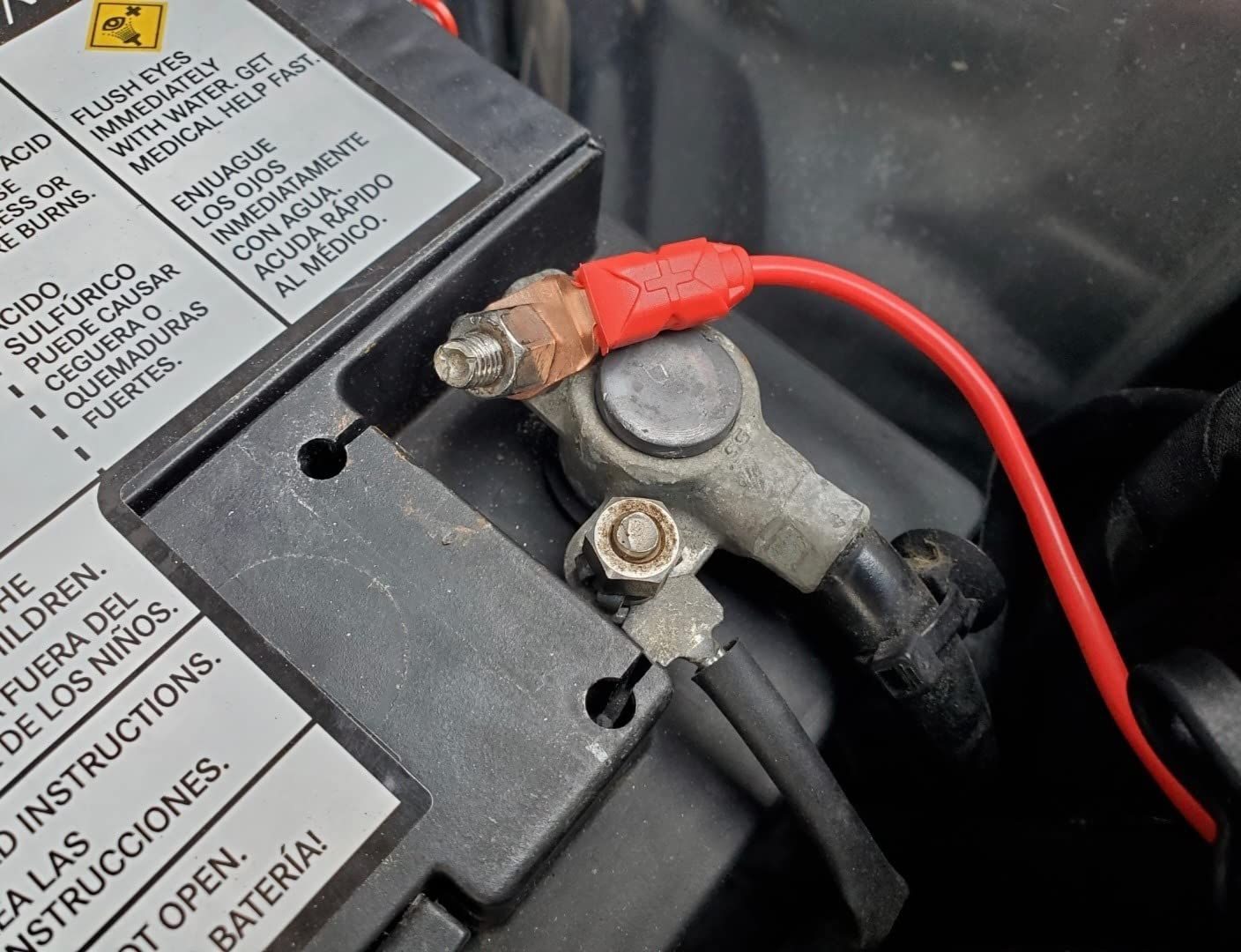

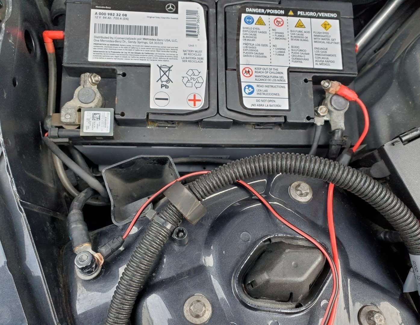

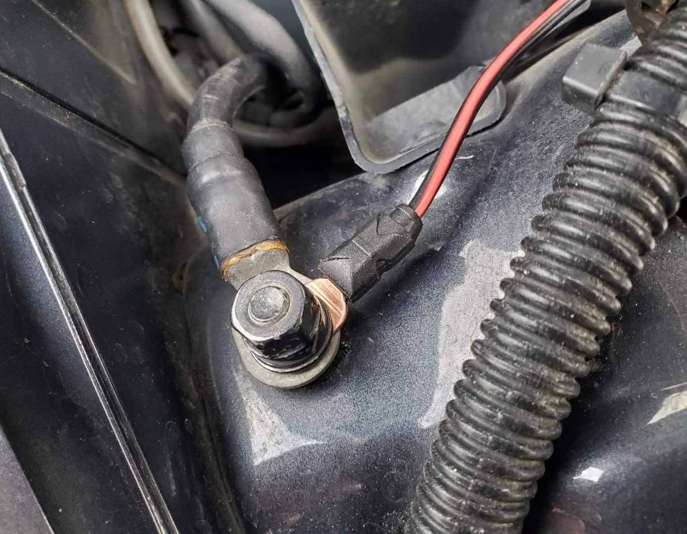

Is the car parked in a garage or outside in the drive way? In either case you dont want to connect the charger inside the car then you would have to leave a door or window open for the extension cord.

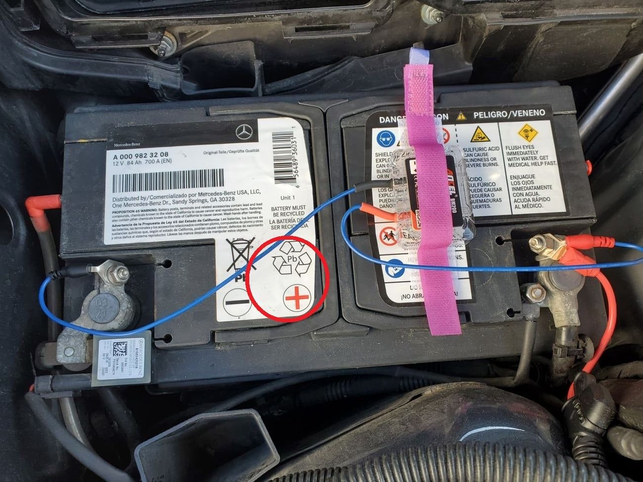

I recommend getting an inexpensive bluetooth battery monitor. You can easily see the condition of the battery from a cell phone without unlocking the car. Just stand next to it and see the battery voltage and ball park SOC. Then you can figure out how often you should charge the battery.
I have the Ancel BM200 battery monitor and have been using it to see how far I have to drive the car to have the battery fully charged. I dont put many miles on my W204.
I have a Noco Genius 5 battery charger also. I will connect it once in awhile in hopes it will "optimize battery for extended life", at least thats what the manufacturer claims. When i hook it up it appears to take around 3hrs to do its thing, for the lights to go from red all the way to single green flashing indicating its done charging and on maintenance mode. Its always around 3hrs for some reason.
I wanted to be able to charge the battery with the hood fully closed. Mercedes says to connect the charger to the jump start locations. This was not an option as i wouldnt be able to close the hood, at least easily. So next best option in my case was to hard wire the chargers adaper directly to the positive battery terminal and then connect the negative to the negative grounding point in the engine bay that the batteries negative cable is grounded to. This way the battery sensor can see the charging voltage.
When I want to charge the battery I place the charger in the engine bay behind the headlight and fish the extension cord thru the front grill which just barely fits.
