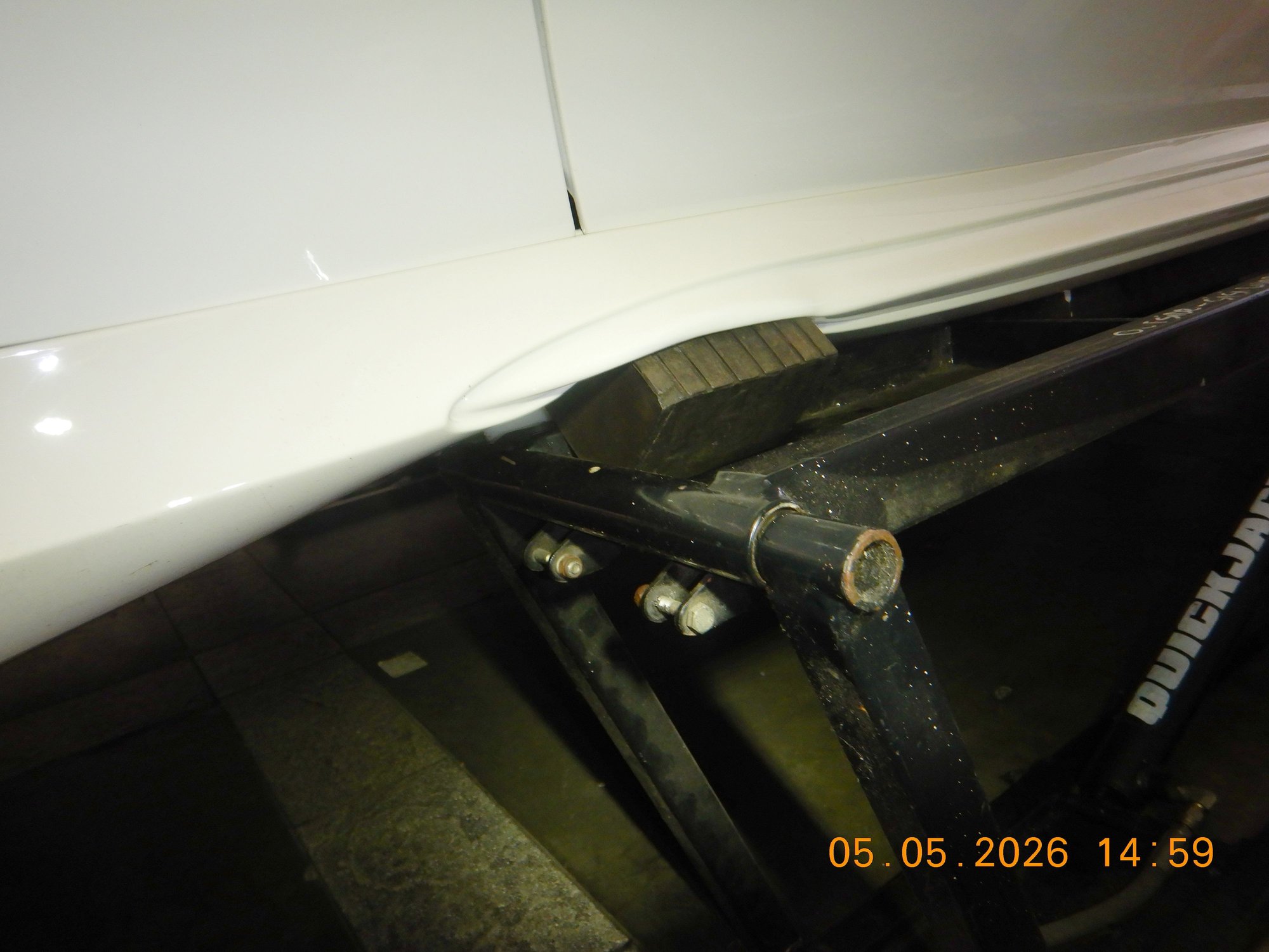

It all happened fast.... as I was lowering the Quick Jack by 2-3 CM to make it LOCK its CAM.

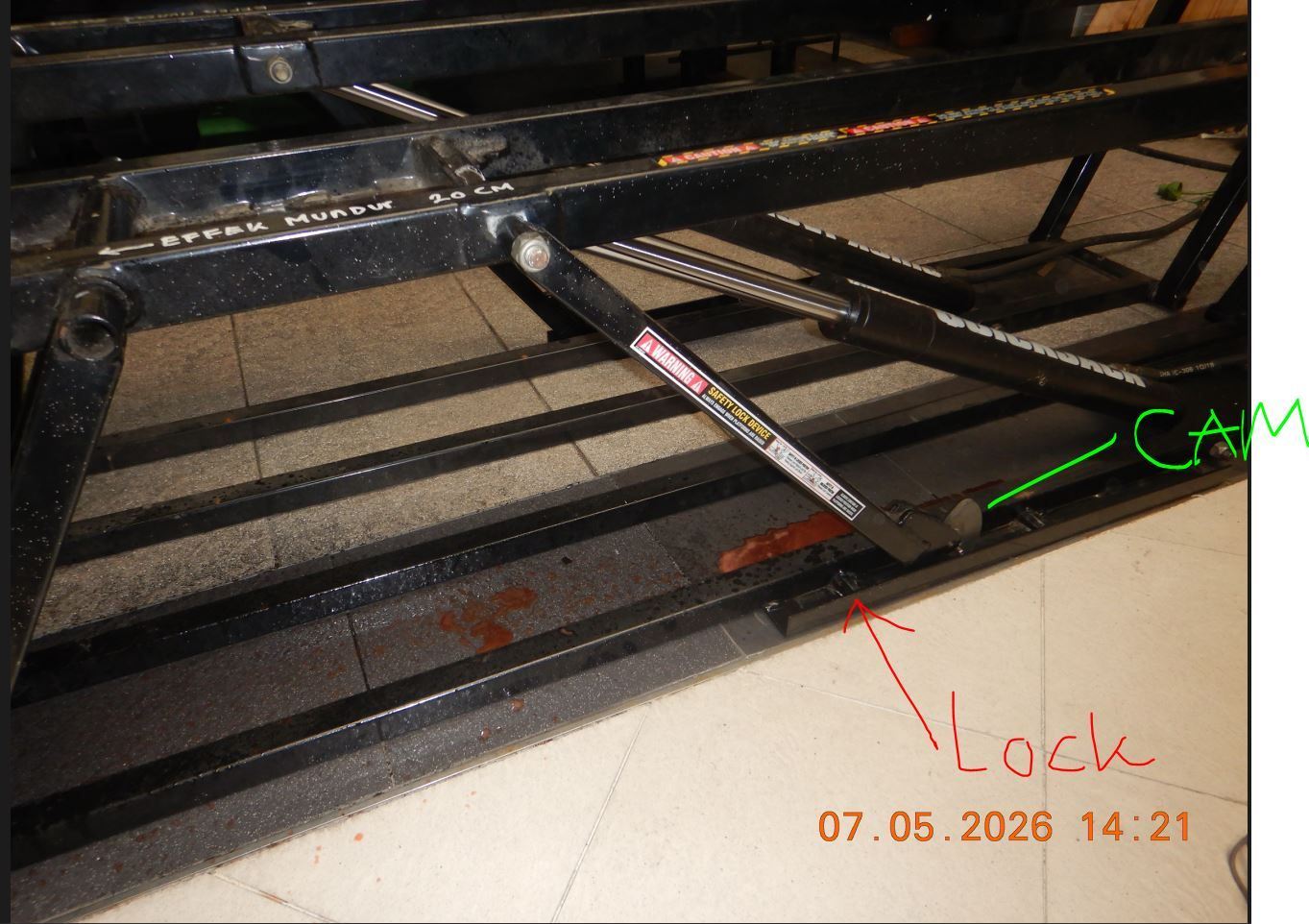

Left side did lock its CAM, but right side never fully extended its piston and thus its CAM will not LOCK

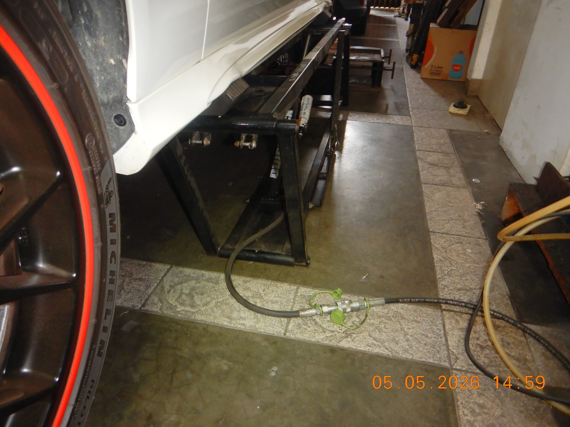

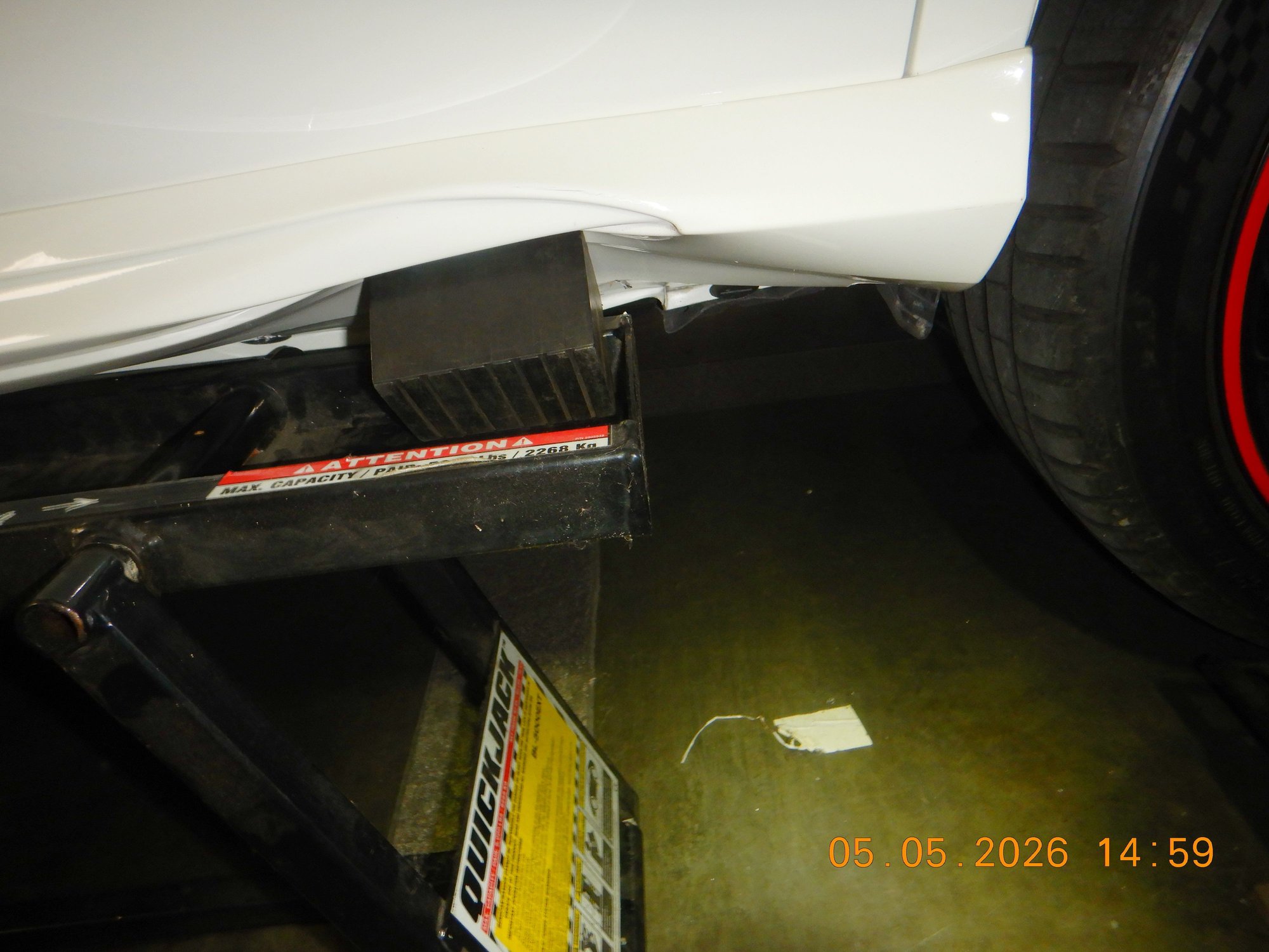

Below if LEFT SIDE, FRONT
Bwlow is LEFT SIDE, rear
Below is LEFT side

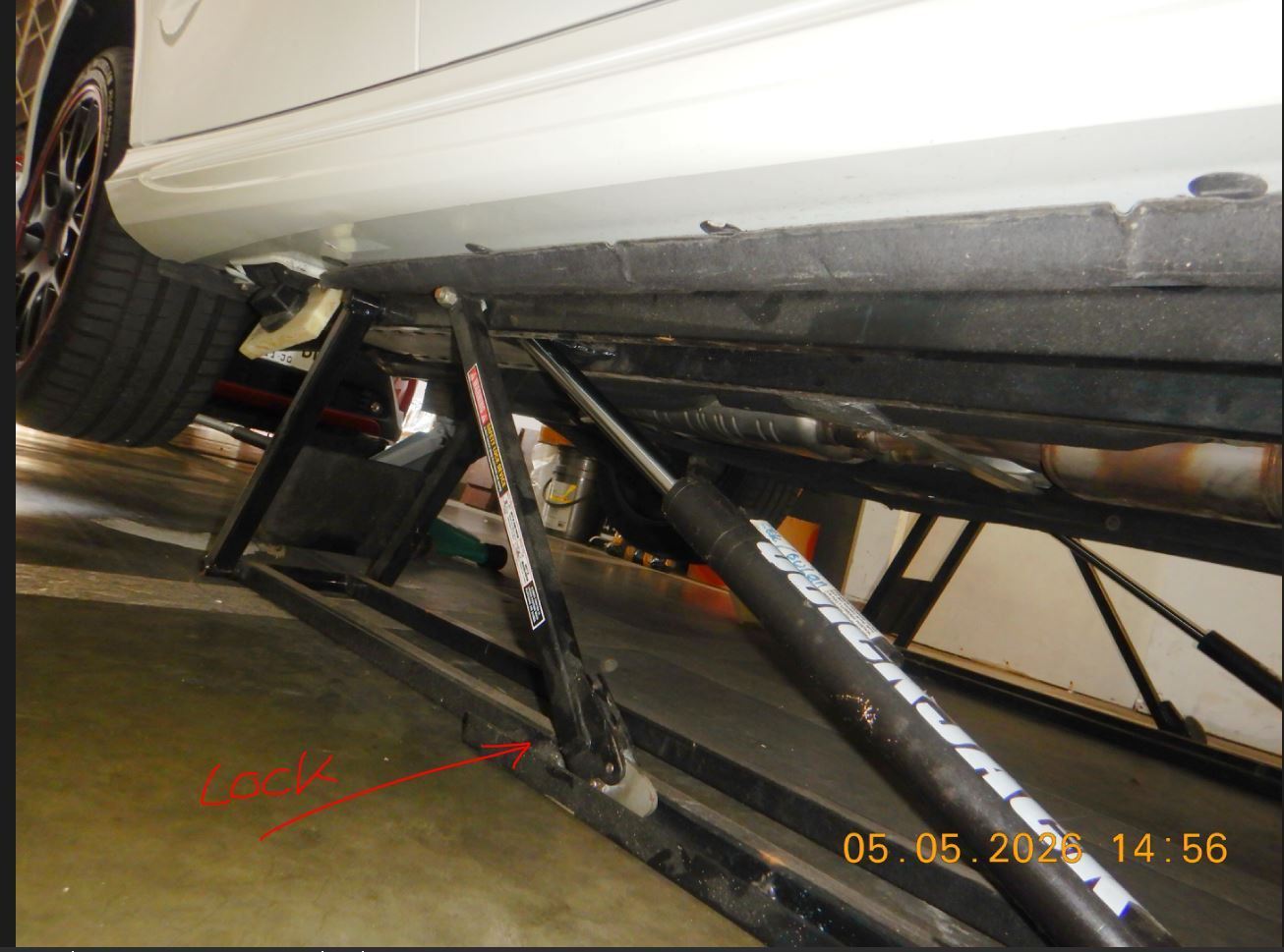

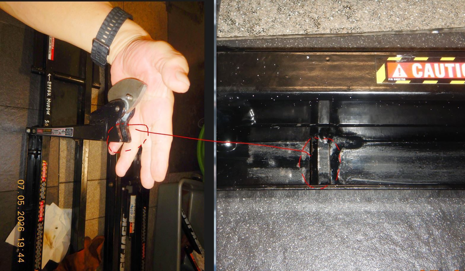

Below is RIGHT side, the one with the cylinder failing to fully extend its piston and IS NOT getting the CAM to LOCK.
See the CAM is short of like 7cm of travel to the back.

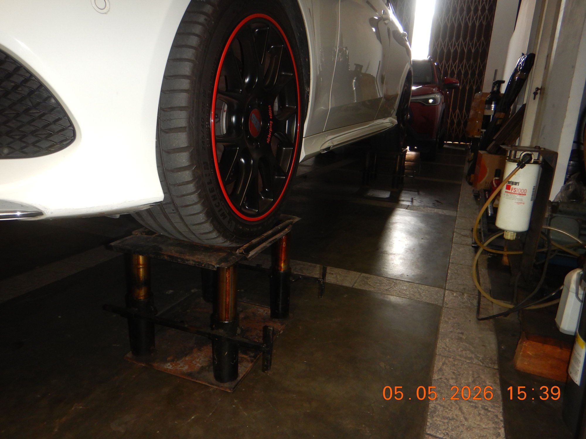

So basically the car was sinking towards its RIGHT side where the Quick Jack is collapsing alone. LEFT side is OK, but car shifted out of its support rubber blocks and nylon 66 jack pads.
Two big jacks saved the day and my tire support stands ( 4 units ) took over the car load, without these 6 devices, I don't know what will happen.

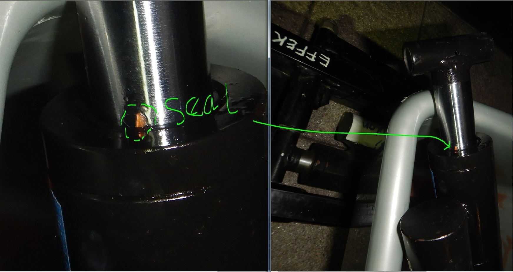

Today I tested Quick Jack without the car as load............ found the culprit.
Yesterday the piston shaft seal did not leak out oil yet, today it did.
How is the seal inside the cylinder ?

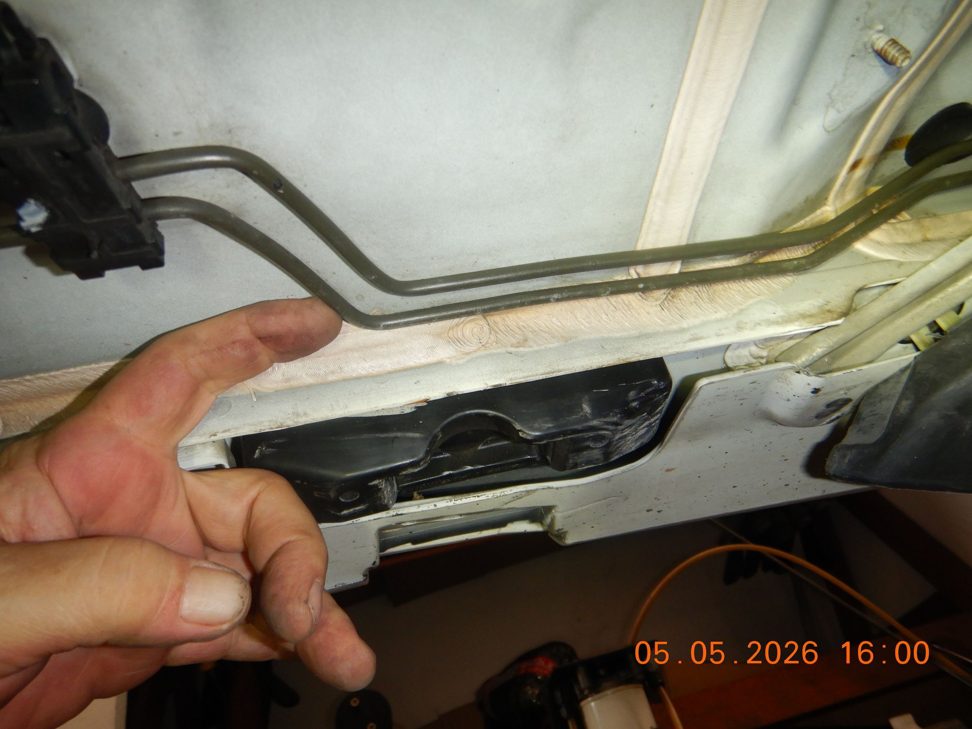

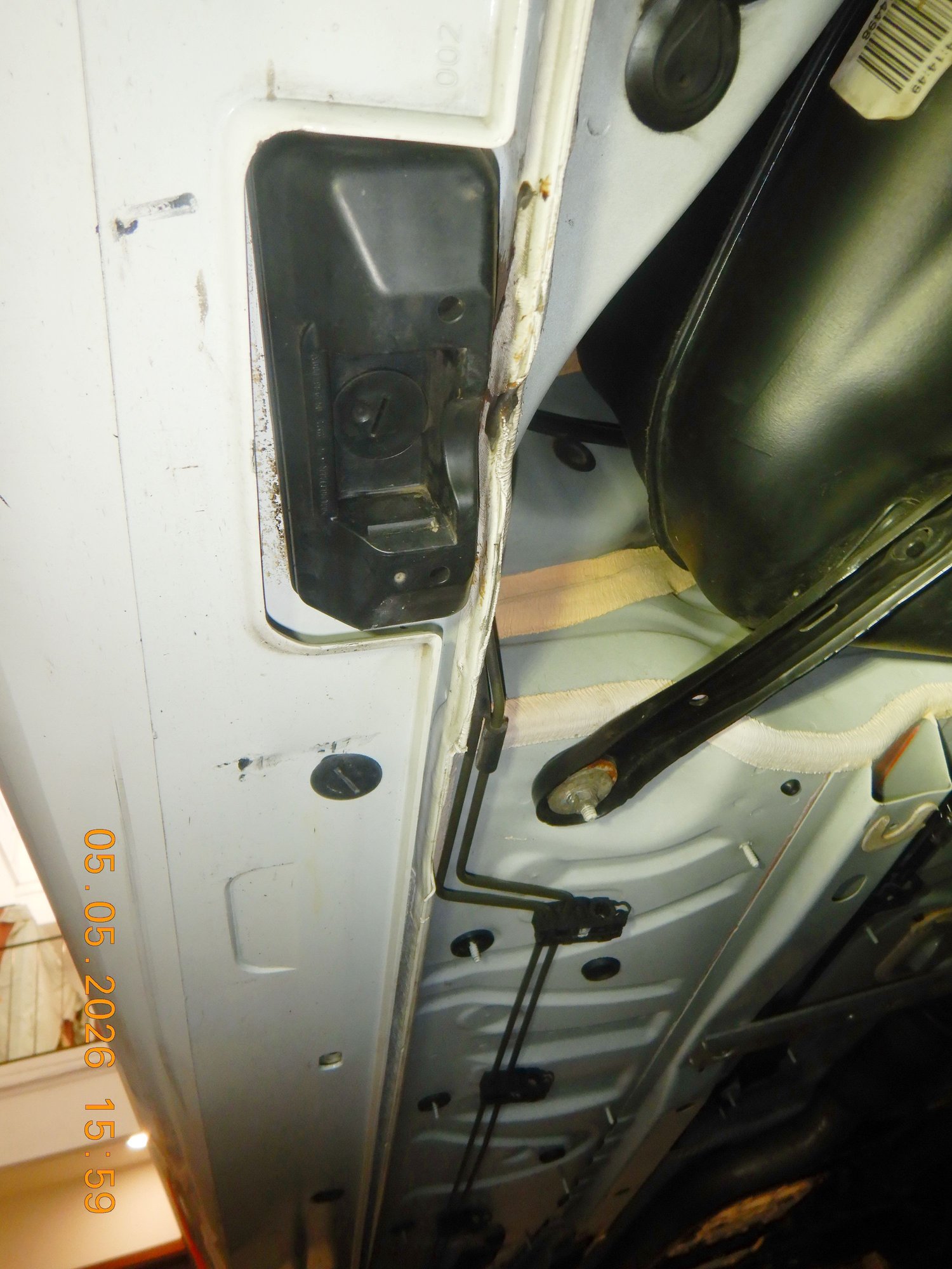

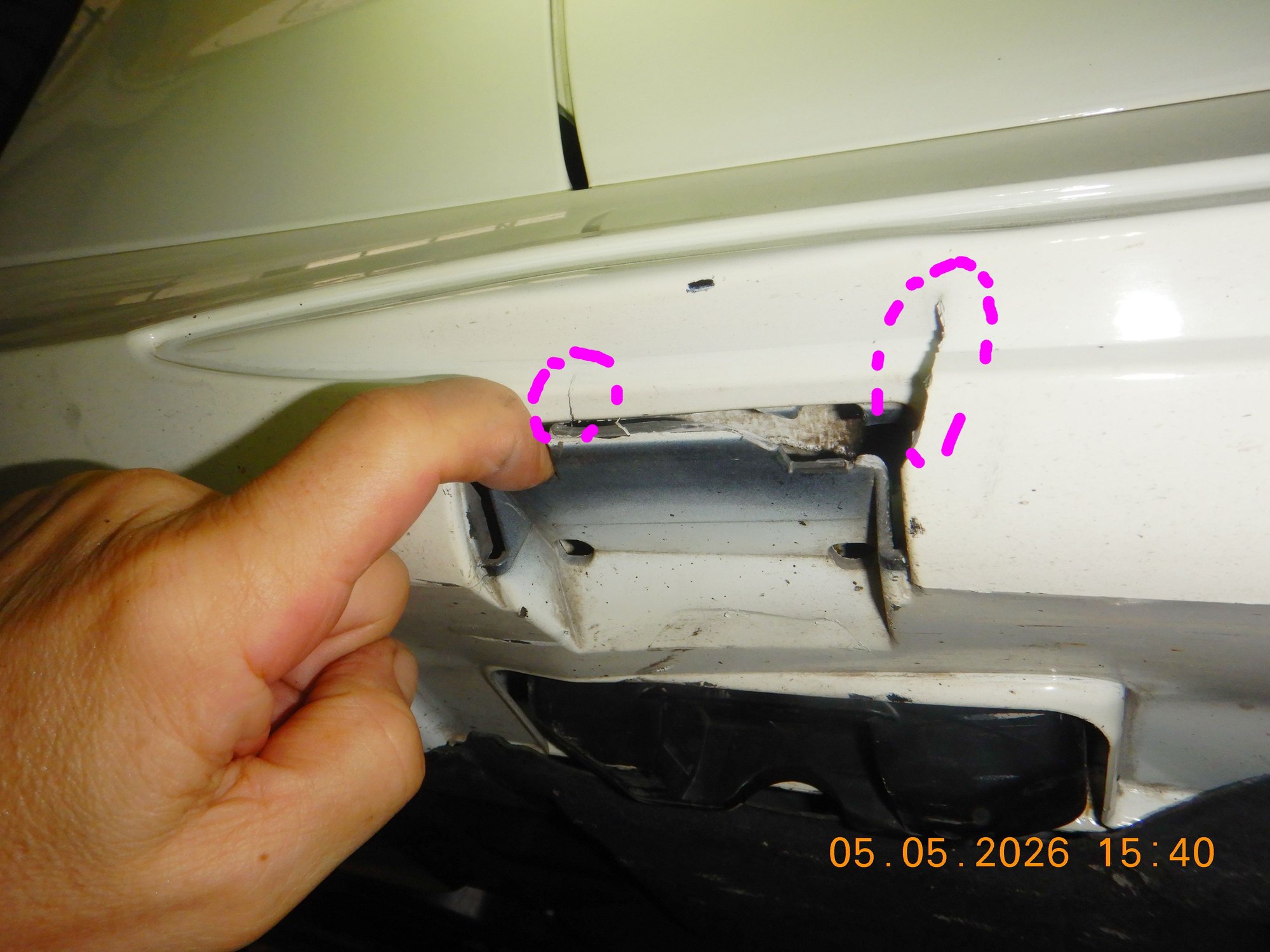

Good thing only this area torn. It is plastic side skirt. I was worried the brake line get squeezed.
Brake lines all good. FRONT LEFT.
LEFT side, rear. Brake lines OK.
The plastic side skirt is crazy flexible and tough. Few of the plastic screw pop out, but easy to put back.

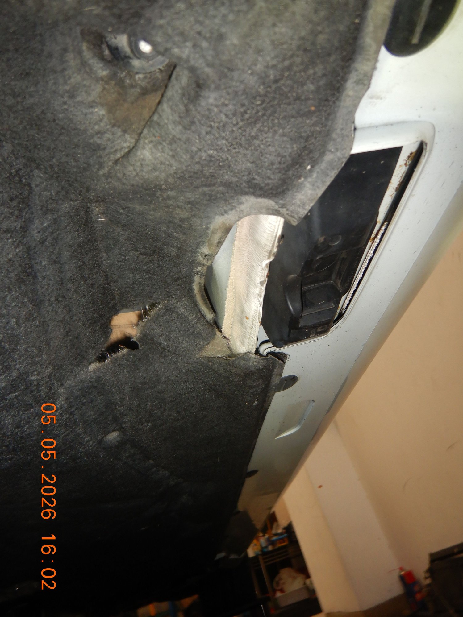

Damage/torn on the RIGHT side is at the hairy sound shield board, near rear tyre. This is from Quick Jack being shifted.
Good thing my thermocouple wire for DIFFERENTIAL casing /oil temperature did not snap. I made lots of freeplay/leeway
ALU tape came off...from the pressure being pushed up.

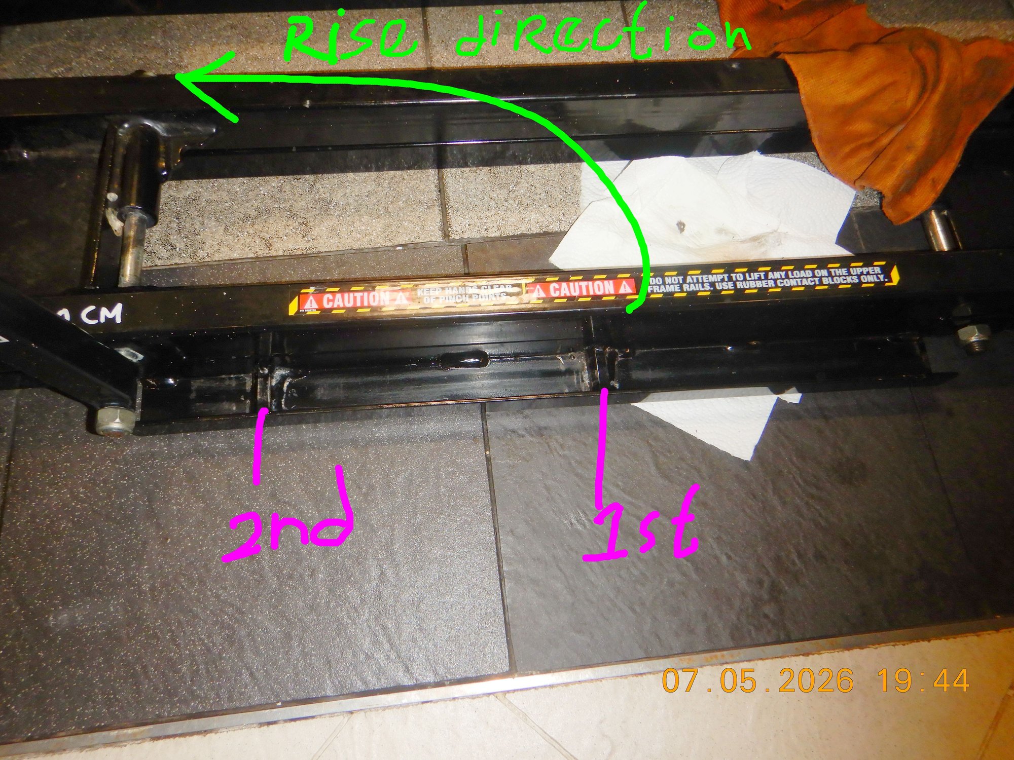

For future owners of Quick Jack :
01- Read the owner manual properly and completely.
02- User tips #1 :

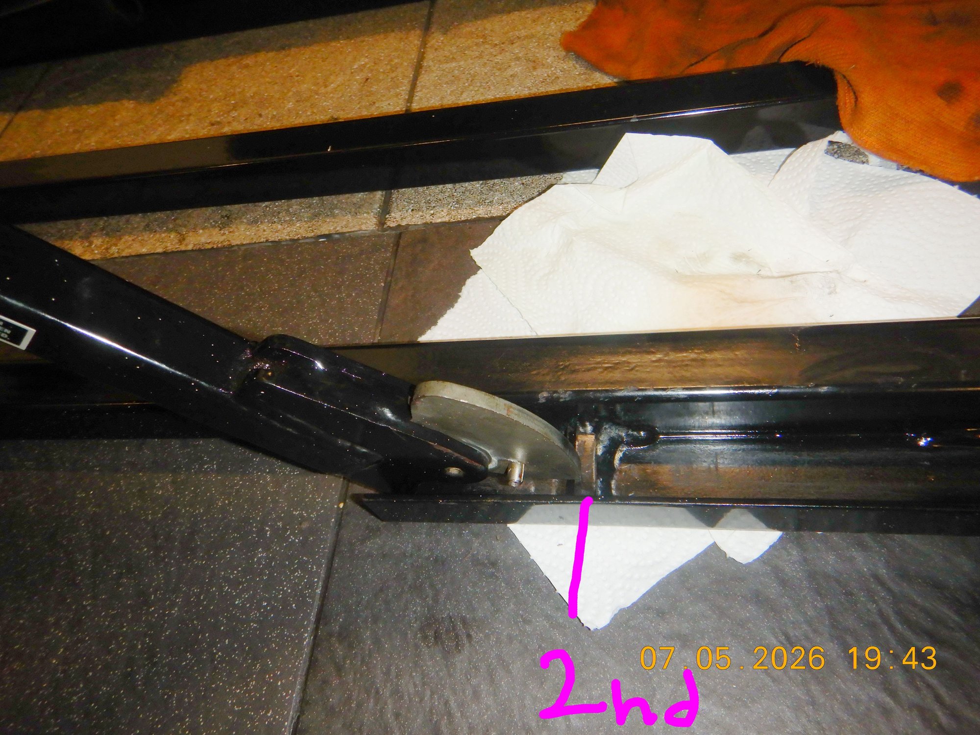

When lifting up the QJ, its CAM will first touch and jump over the 1st stop ( middle height ).
Listen to the sound of Left and Right CAM jumping over the lock/notch at 1st stop. They should sound either both at the same time of very close together, meaning .........
the lifting speed and height is near identical. Its never 100% identical to millimeters accuracy, but to CM accuracy is possible.
Practice first with your body weight and not using the car , how to manipulate the CAM to do its auto locking at 1st stop notch.
You need to play with rise and down of the QJ to learn this and if one side LOCKED and the other did not, disaster will happen when you try to lower both.
The same applies to 2nd stop/notch, the highest setting of QJ.
03 - User Tips #2 :
Raise QJ to maximum height till you hear the CAMs jumping the 2nd lock/notch, this is highest level.
To lock the QJ, you need to lower a tiny bit so that the CAM will auto lock to 2nd lock/notch.
Inspect by visual and touch, making sure the U shaped lock near the CAM indeed have locked.
The lock is actually not the CAM but the end of the steel bar where it has a U shape lock, where the CAM is at.
U shape lock at the steel bar end, near the CAM
The overall design is elegant.
All you need is to be extra vigilant and confirm each and every use where you truly get both sides of the QJ to be in LOCKED position.
Do not rely on the hydraulic cylinder itself as a locker, use the steel bar CAM-LOCK........ just in case the hydraulic cylinder develop a leak like mine
The QJ is now 8 years old. I bought it in 2018.
It has done a few hundred lift up-down operations.
Near miss in those 8 years ? Yes..........once at 1st lock, middle height .
All QJ trouble or accident is always one side get LOCKED and one side did not get locked...always.
Stay safe................
