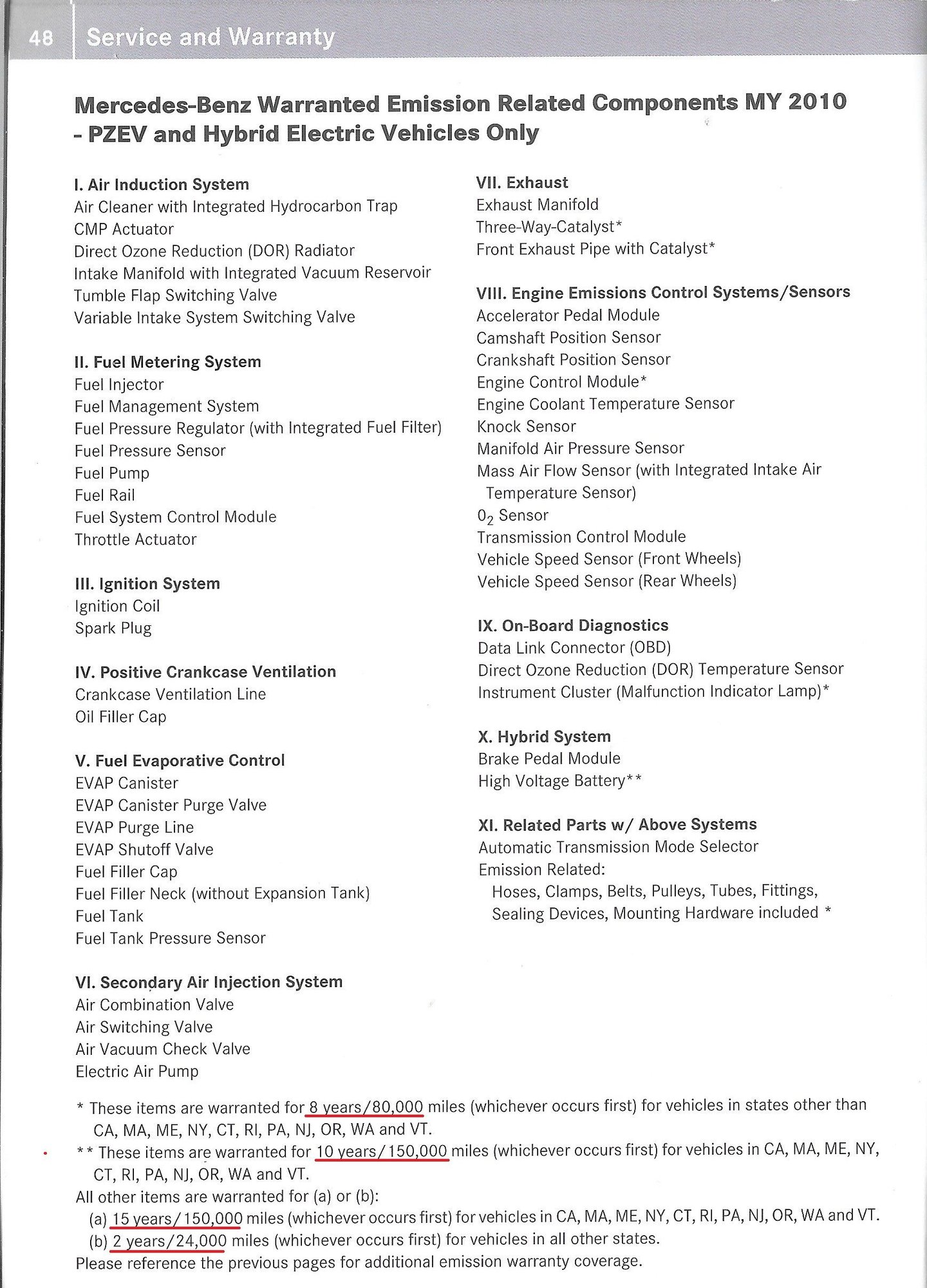

I’m reading if I have under 150k miles and my car PZEV that Mercedes replaces this for free… mine 2010 E350, is there any truth to this?

The PZEV warranty on emissions and fuel related parts is for 15yrs/150,000 miles.
So a 2010 is no longer within warranty period.
* I should have said the 15yrs/150,000 mile warranty is the max for specific states. The info below should be in your warranty booklet that came with your operators manual in the glove box.

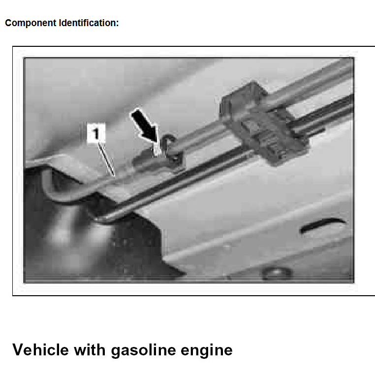

Photo below shows the fuel line where it comes down from the tank. The line next to it is the breather pipe (evap hose) from the tank to the purge valve.

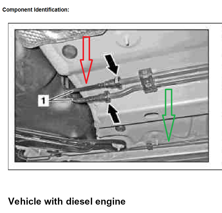

Photo below shows the diesel fuel line. Same location as the gasoline fuel line. Can better see where its located under the car, can see the brake lines (green arrow) off to the right.

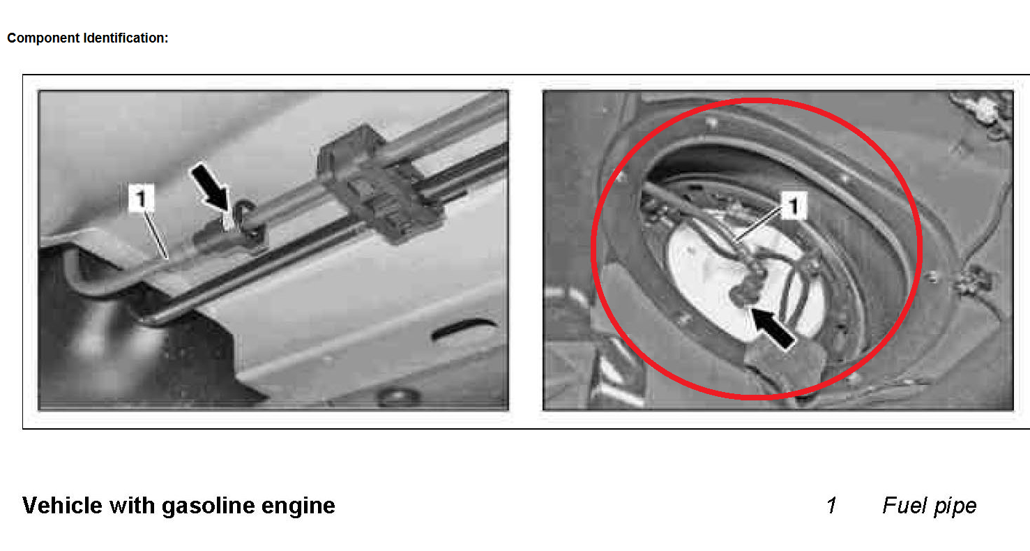

If you thoroughly check the visible parts of fuel line from rear to front of vehicle and still can't locate the leak, it's plausible that's it's the plastic line #10 in parts diagram above that has failed. You can continue the search for the fuel line link or proactively change out line #10 and at least you have a new plastic line in the end even if it turns out not to be the leak source.
Based on this link https://mbworld.org/forums/e-class-w...fuel-line.html, it seems like the contours of this line may make it impossible to replace unless you lower the fuel tank enough to gain enough clearance to snake new line in without damaging it. Would be prudent to empty the fuel tank before lowering and supporting with a jack of some sort. Maybe someone who has actually done the job on your vehicle can and will chime in.

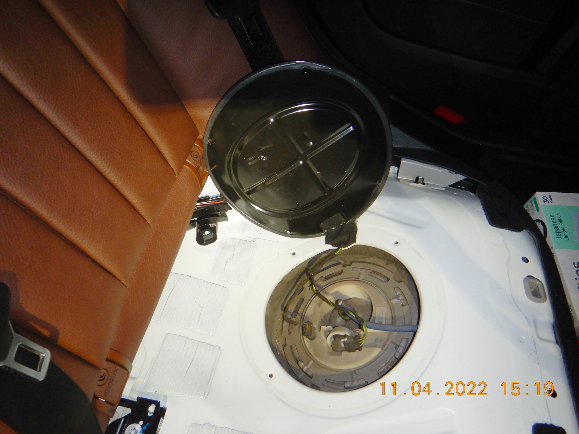

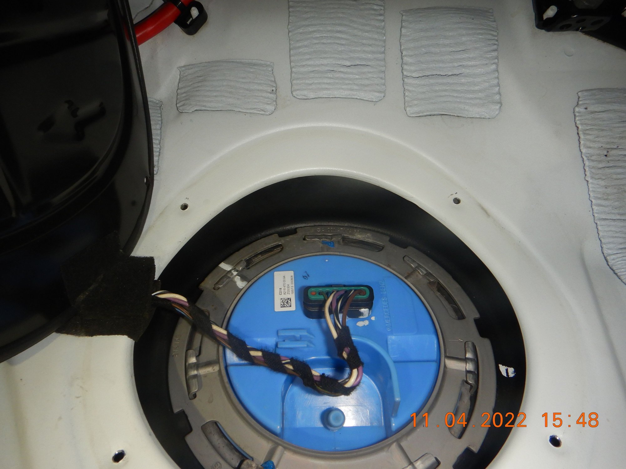

Take full photo of the tanks top two service holes. PZEV tank seems so different based on oldie W211 with such tank as per Youtube.
Supposedly W212 E400 PZEV tank, also different from W211 version
https://www.ebay.com/itm/376776177786
Regular fuel tank. My car.
Left side is fuel filter ( also called pump, jet pump...actually venturi effect pump and not a true pump ). The blue fuel hose to engine is here
Right side is fuel pump. Mine is a 3 phase fuel pump.
One CAN NOT simply replace the blue plastic fuel hose without at least dropping the tank a bit, say 3-4 inch.
The ODD shape blue hose will not come out or new one wont go in, unless the tank dropped a bit to create bigger gap.
This also mean the subframe has to be removed fist.
1st attempt : FAIL
2nd attempt ; YES, because I have removed the subframe and now I can "drop" the fuel tank a bit with better working room.
https://mbworld.org/forums/e-class-w...-subframe.html
The blue fuel hose replacement starts at 3/4 of the post.
Good luck man........... this wont be a fun job for your or your wallet .

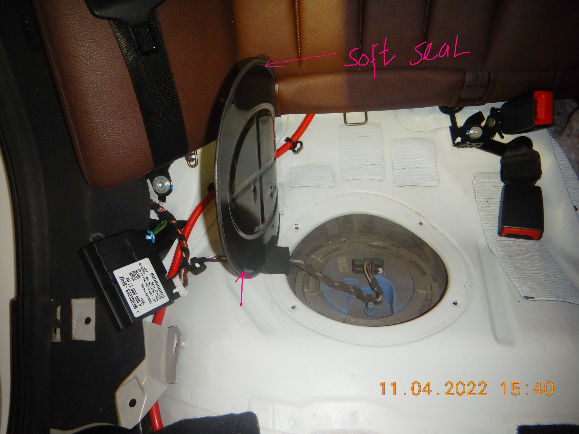

Another video of W211 PZEV fuel tank : Wow
So it is like a fuel tank inside a fuel tank.
No need subframe removal on W211, probably the same for W212 if one wants to really do it.
So left side is still a FUEL FILTER
The right side is a hidden fuel pump, where you must cut 7" hole to access it ..dugghhh. Is this real ?

Probably have to remove the plastic under tray to inspect the fuel supply line. The black plastic nuts should be 10mm, the metal silver ones up near the engine are 8mm.
