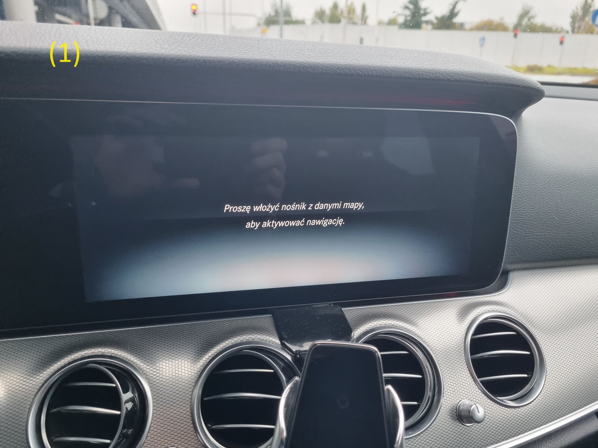

Hi,I have question after retrofiting NTG Unit 4.5 5.0 5.5 maps pin must be generate for this car VIN number or VIN where it was originally assembled NTG?
I buy pin for maps and (works)start installation new maps when finish unit make a reset and still the same ''please insert data medium ......''
When I hard reset unit maps working 1min. and I checked map version show exactly maps what I install but with xentry showing old maps version ??!!
Any Ideas ??

Did you manage to solve this problem, I have exactly the same situation,
Best regards/Pozdrawiam

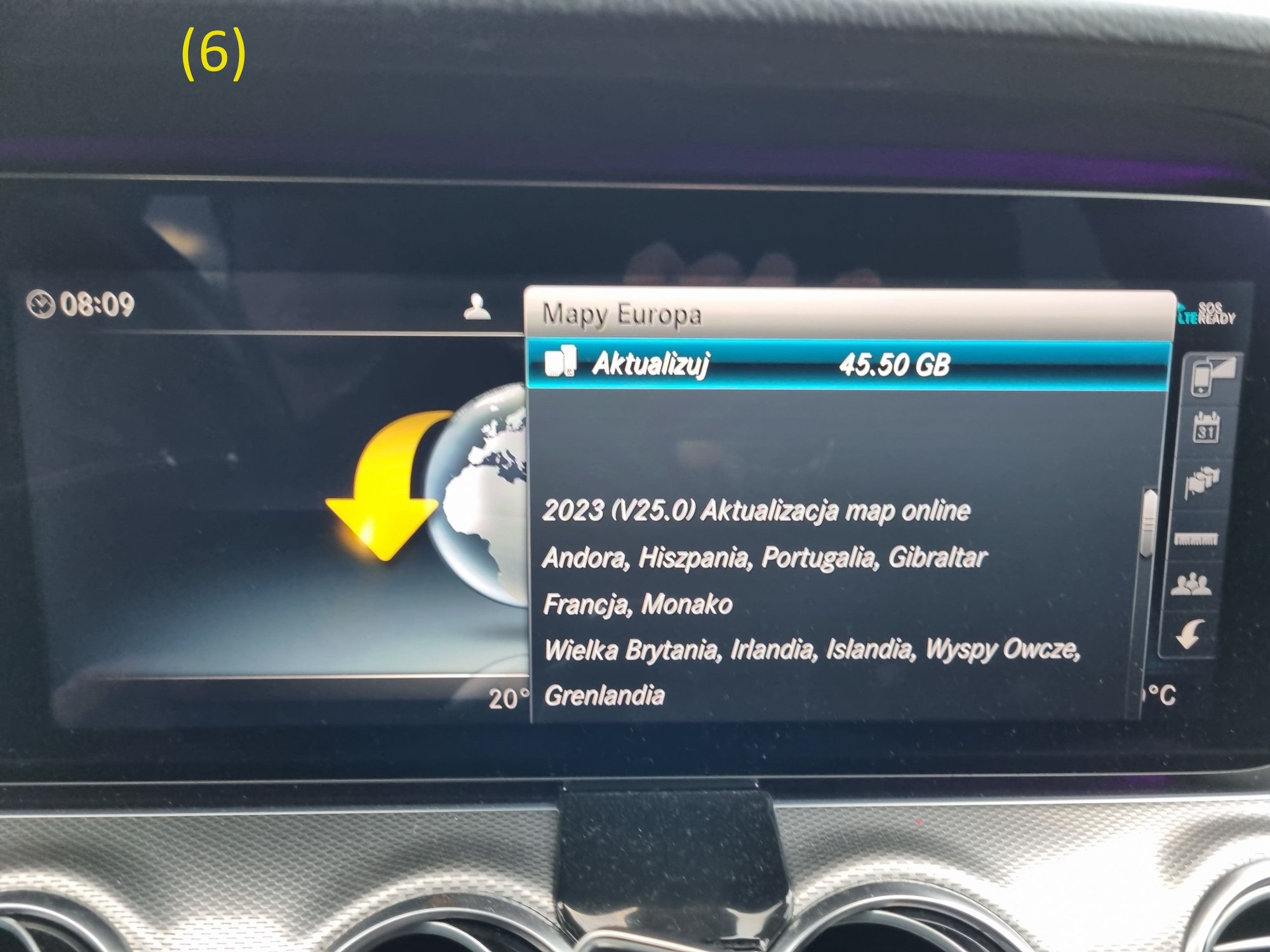

1. I have new unit unlocked and registered officially with XENTRY Online and it is working.
2. I have bought maps subscription in Mercedes me and uploaded via USB newest version ~40GB successfuly
Still have the same information to insert data medium to activate.
