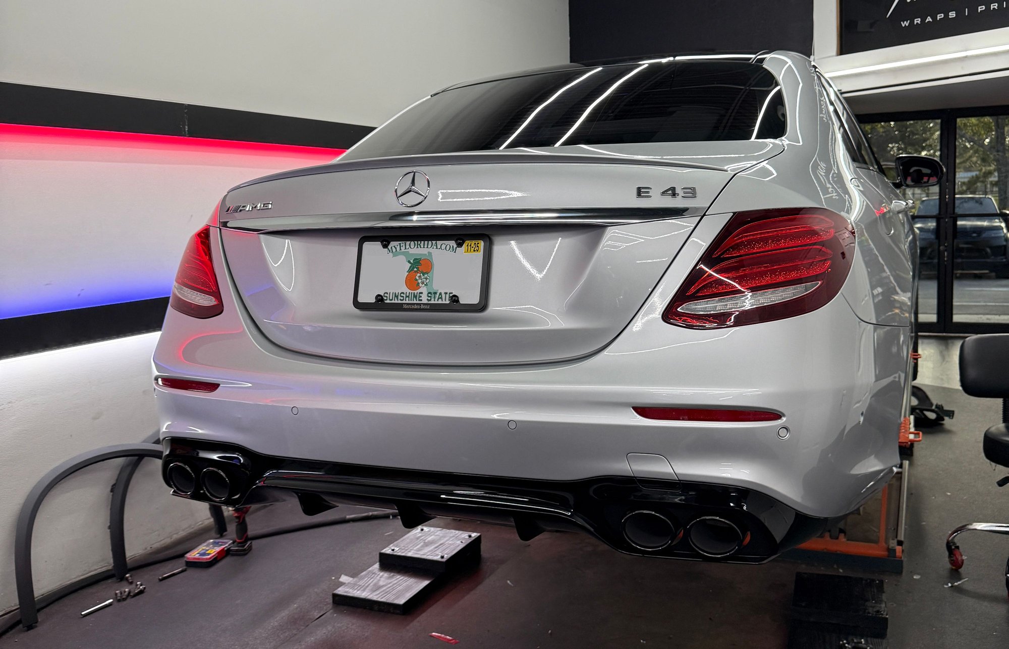

Can someone please confirm. I just bought E43 2017 wagon (pics will follow next week once I get it) and I would like to change to E53 exhaust tips. Do I need the tips only or do I need to replace the difusor aswell?
Thanks!

Have you finished this???
You need to replace all. I have an 18' E43 and am doing the 53 Rear Diffuser. I've seen it done two ways but rest assured it's a breeze if you have or can use a lift for the job. Doesn't look difficult, just tedious. There's multiple YouTube videos on it. Essentially, you build the the tips right into the diffuser , as it comes separate on most packages.

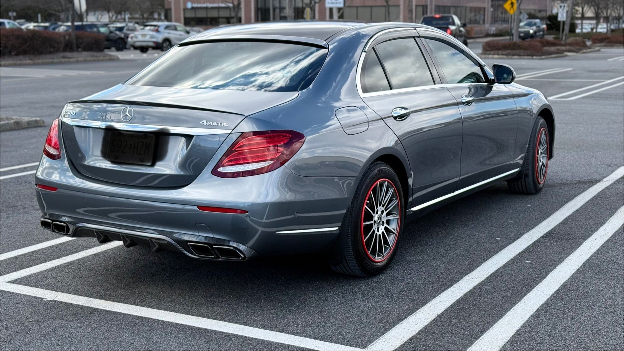

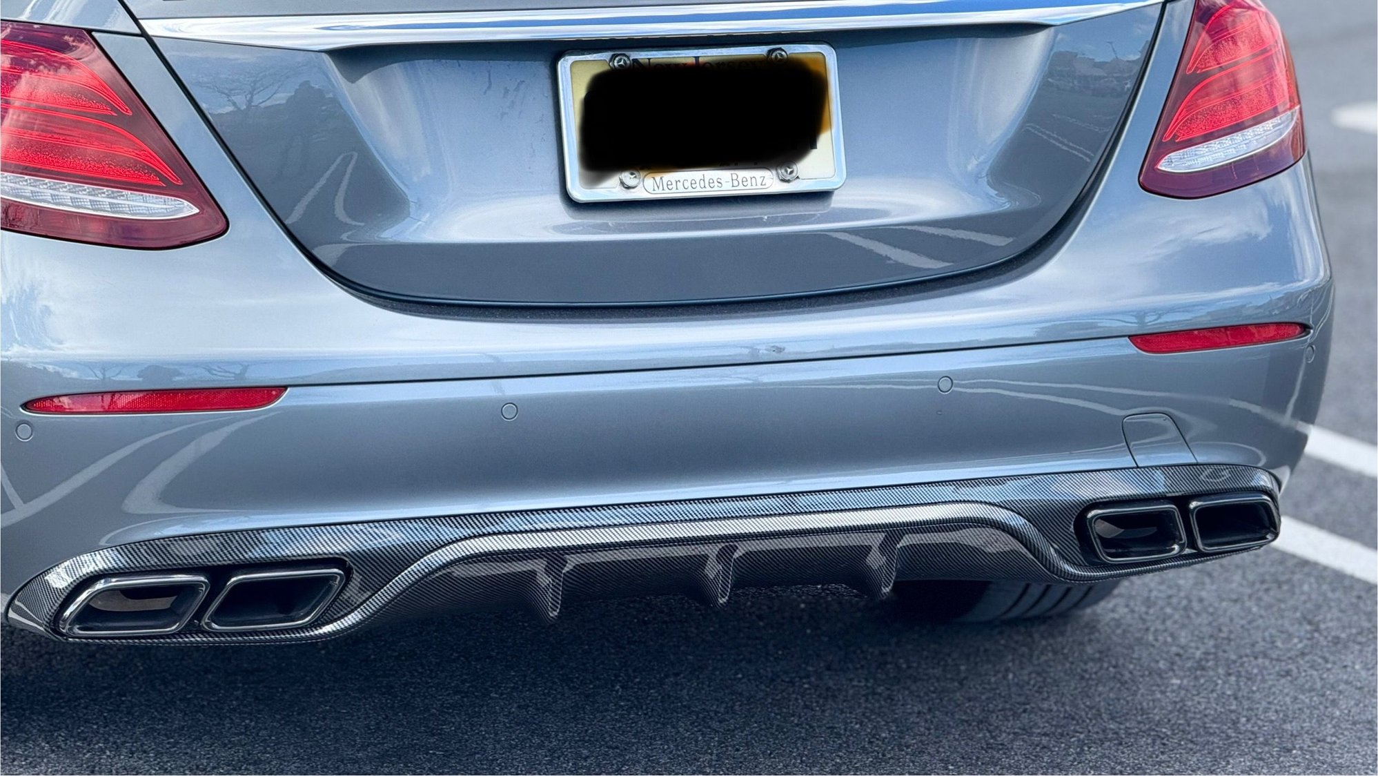

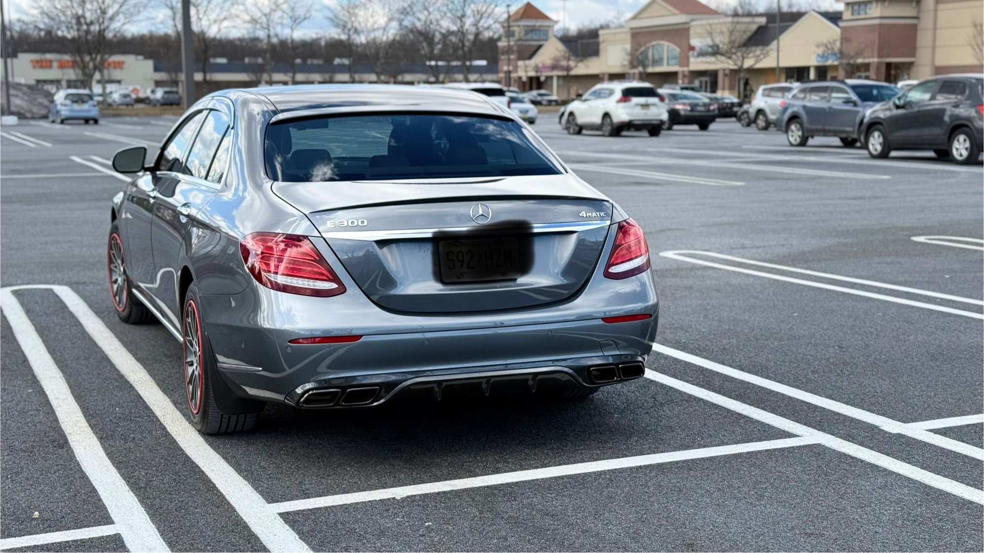

My car is a 2017 Luxury Model so OEM definitely wasn’t an option. Here’s an Aliexpress diffuser instead. I’m not a fan of the glossy black because it would shows dirt and scratches too much. Wanted carbon fiber look, however that was only available with black chrome exhaust pipes so that’s what I went with. Wanted chrome, however would have had to go with glossy black diffuser. I ended up having to pay for insulation as the rear bumper has to be removed for installation.
i like the look, really reminds me of the W212 E63

That’s exactly what it’s modeled after, a world of difference between this and stock OEM Luxury model diffuser and exhaust tips.
That looks like a pretty good fit! It's great what a simple diffuser can do to the overall look. I personally will go with a glossy black (to match the rest of the E43's Night Package) E53 replica setup.
What do you mean by insulation?

Installation, not insulation, silly phone

My car is a 2017 Luxury Model so OEM definitely wasn’t an option. Here’s an Aliexpress diffuser instead. I’m not a fan of the glossy black because it would shows dirt and scratches too much. Wanted carbon fiber look, however that was only available with black chrome exhaust pipes so that’s what I went with. Wanted chrome, however would have had to go with glossy black diffuser. I ended up having to pay for installation as the rear bumper has to be removed for installation.
I was able to get the old diffuser and exhaust pipes off, however the new exhaust pipes were too wide for installation without the bumper being taken off
