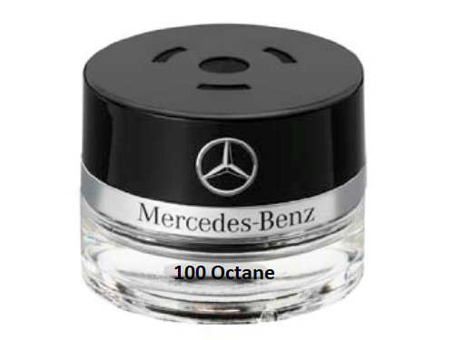

Check the glove box for the latest aroma.
