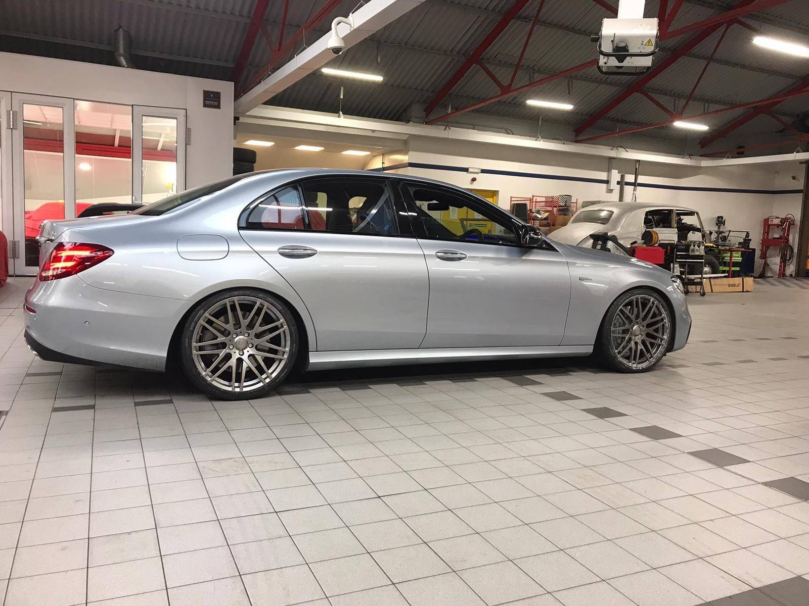

Dear Colleague,
I actually have an E43 which was given to Brabus two months ago full a complete Brabus conversion, which included an upgrade to 21-inch Brabus wheels.
I have the 20" E43 twin 5-spoke wheels that you are after, they are brand new and in absolutely immaculate condition. The car has only been driven on them once basically when it was on its way to Brabus for all the upgrades.

Clearly people on this thread do not know what they're talking about (no offense to anyone) since they're all over the place. I suggest you do a little bit of research on your own online before listening to anyone, but i'm telling you you'll be fine. I have E63 wheels on my E300 and they're fine. It's the tire that you should worry about as the sizing is the important part. The E300, E43, and E53 all use the same front fenders, bumper, and the rear bumper. Only difference between them are the grille, exhaust, and the wheels on the exterior part.
on my 2017 E350 I even had very aggressive offset wheels with SUPER wide tires and didn't rub AND it was lowered an inch and a half. The wheels i had were:
Front: 9x19 255/35/19
Rear: 10x19 285/30/19
Do not use spacers, don't lower it, and dont go too large with the tires either.
One other point is making sure you get the right tire size if you're going staggered (i don't suggest it as it's a waste of money). Unless you have a RWD Mercedes, you'll have to make sure you get the right size as the rolling radius and circumference needs to be the same for the front and rear tires. If you have 4Matic and the the radius and circumference aren't the same, you can screw up your transmission and differential.
I would suggest getting 245/35/20 front and 275/30/20 in the rears for a perfect fitment on these wheels you're looking to buy. Or you can even go 255/35/20 & 285/30/20 since your ride will feel like **** going from an 18 inch wheel to a 20 inch for a little bit of extra padding. Good luck.
