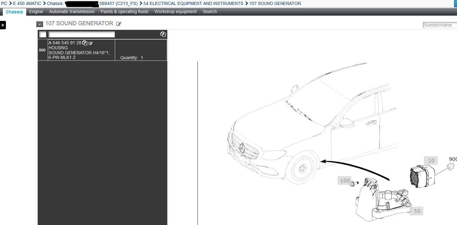

Old Aug 24, 2020 | 03:07 PM
konigstiger's Avatar
Posts: 15,901
Likes: 4,633
From: North Scottsdale, AZ
'71 Pinto
You can check front SAM (engine compartment) f109 (10A) and/or f122 (7.5A) but EPC shows your vehicle as not having sound generator.
