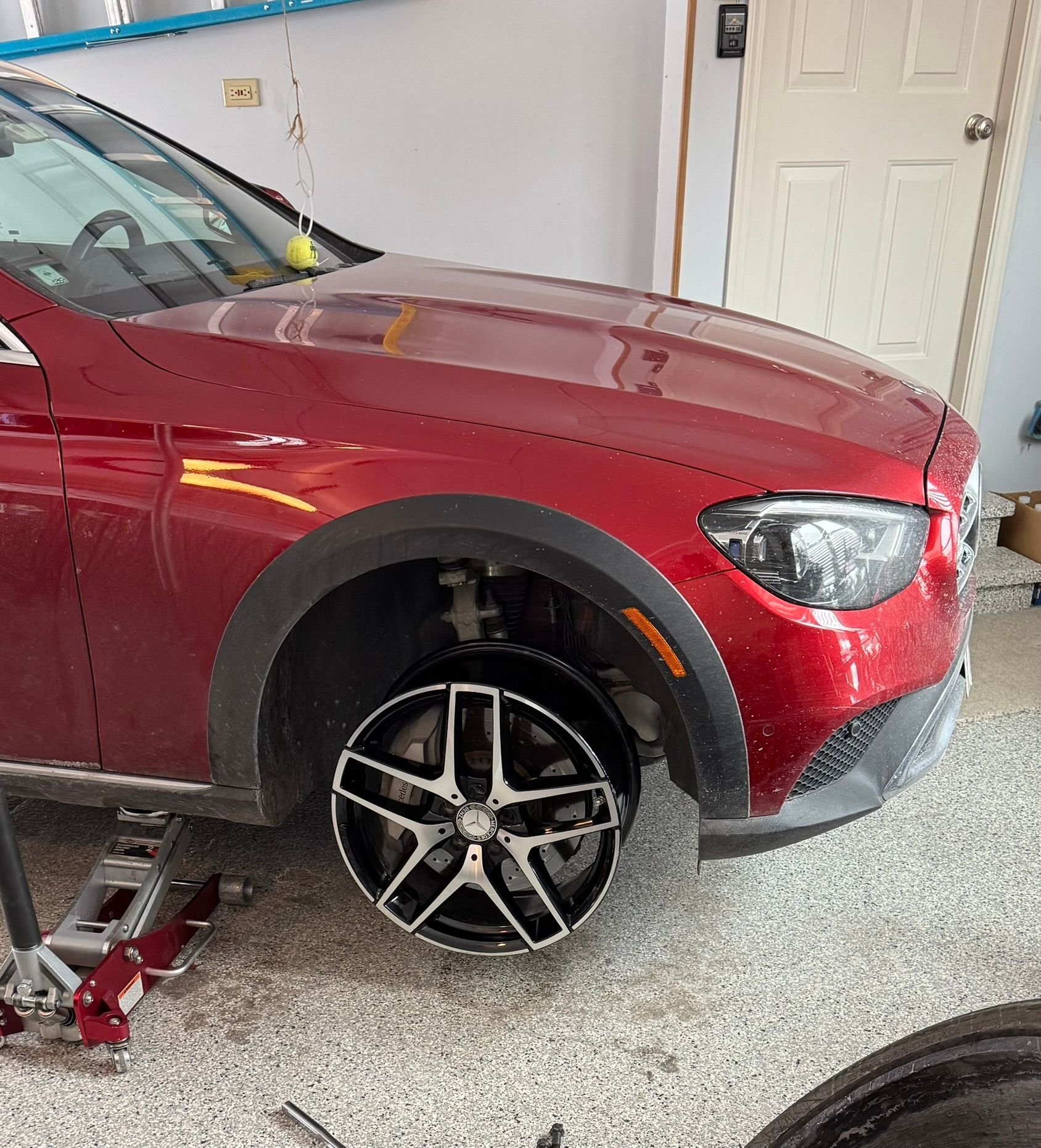

Old Dec 6, 2025 | 03:31 PM
Sightlinereader's Avatar
Joined: Dec 2025
2022 E450 All Terrain
W213 All Terrain 19" Wheels
I needed a set of wheels for my dedicated winter tire set up. I wanted an MB factory wheel rather than aftermarket so if I damage one, I can get a replacement. The All Terrain standard wheel is a 19"X 8" with offset of 38mm. Turns out the GLC 19" wheels have the same bolt pattern, hub bore and ET. Scored a set of 19" MB wheels off a GLC that should work great. Added bonus... They are closer to the optional 20" wheel in appearance which I prefer. The wheel is model 560-85483. Hope this helps other AT folks looking for a 19" wheel. There are other 18" and 19" options to from a GLC that should bolt right up and are ET 38 too. Use reading glasses? Check out Sightline Readers - my day job.
GLC 19
GLC 19" wheel 560-85483 on All Terrain
