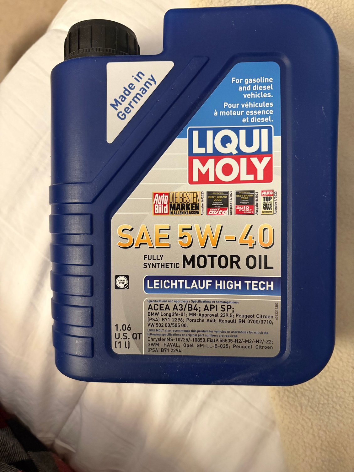

Best Engine Oil for MB cars from 2010 thru 2026
Originally Posted by PGH E450
For the life on me I can’t locate the recommended oil weight. It seems like 0-30. Anyone know the manual is silent.
If you want to use the best oil for your car the attached picture is it, hands down:
This engine oil is the best for 4-6-8 cylinder engines.
Change every year or 5,000 miles. Best of luck.

LM PAO lubricant
This is a premium PAO API-SP oil with extended lo/hi heat range - Great match for demanding turbo engines.
