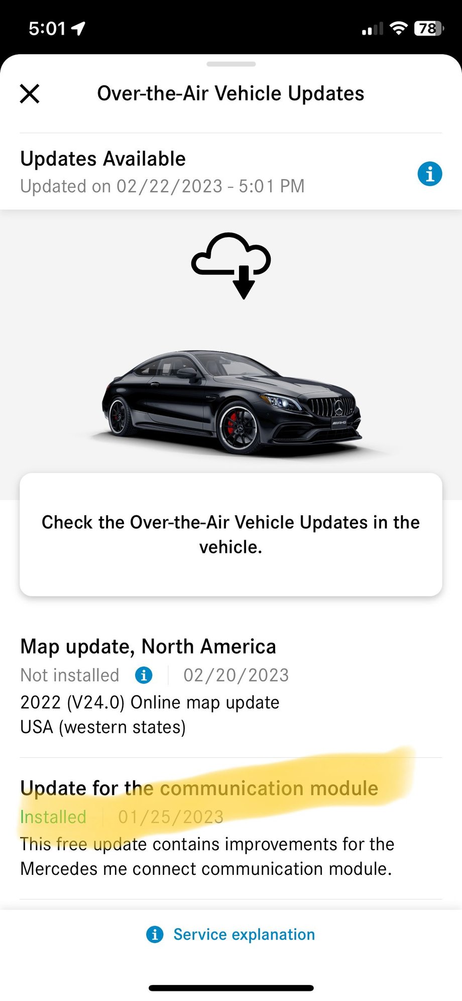

Old Feb 22, 2023 | 08:15 PM
The G Man's Avatar
Joined: Oct 2015
Posts: 1,583
Likes: 292
2019 E300
I downloaded the communication module update last month which is supposed to improve the Mercedes me Connect module. The update might have made the app connection less reliable.

Old Feb 22, 2023 | 08:45 PM
superswiss's Avatar
Joined: Nov 2018
Posts: 11,432
Likes: 5,342
From: San Francisco Bay Area
2019 C63CS
So far that hasn't been my experience. It's at least as reliable as before.
Old Feb 22, 2023 | 08:51 PM
superswiss's Avatar
Joined: Nov 2018
Posts: 11,432
Likes: 5,342
2019 C63CS
Originally Posted by Elvisfan0108
Except for maps, I haven’t had an OTA update since I got the car.
Probably wanna look into that. This is the second OTA update for the communication module. First one was a recall and your model year is on it.
https://static.nhtsa.gov/odi/rcl/202...1V058-3925.PDF
