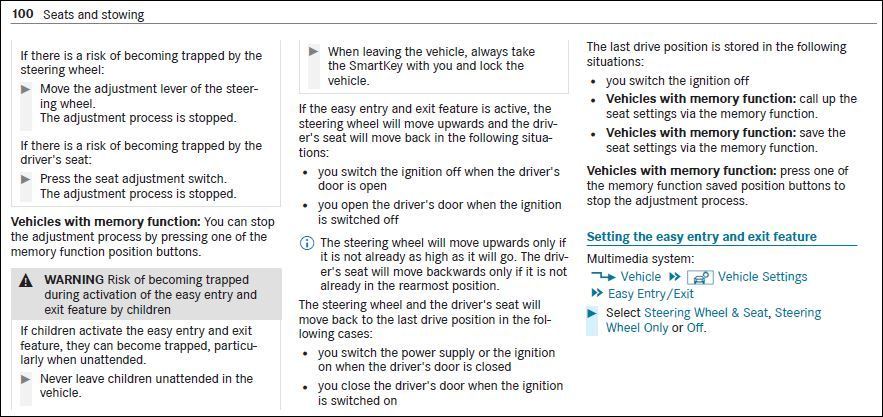

Turn 'easy entry/exit' feature off.

Great
THanks for your quick response and image.

I was going to ask on a new thread, but since it is related, I will ask here. I have the easy entry/exit activated for both steering wheel and the seat, however, it only moves the steering wheel and not the seat, and the seat is not normally pulled back all the way so it should be working. Any idea what I may be doing wrong or is it a software glitch? Thanks.

Thanks for the info, however, my seat is not pulled back all the way and doesn't fall under this scenario. I am not that tall so there is still a few inmches the seat could move back for easier entry.

The owner's manual is not clear on this, but it's not actually the rear most position that counts. What counts is how upright you have the seat normally and where your normal seating position is relative to the B-pillar. In a sedan, the seat actually has to move forward at bit to make it easy to get out from behind the B-pillar. So if you are tall, the seat may actually move forward with the easy entry/exit turned on. But if you are more average height then the seat may not move at all if it's already in a position deemed easy to get in and out. In my C63S coupe for example the seat doesn't move. Only the steering wheel moves. I'm 5'11" and my normal driving position is fairly upright and the seat is not all the way back, but at the ideal position to get in and out. There's no need to move it.

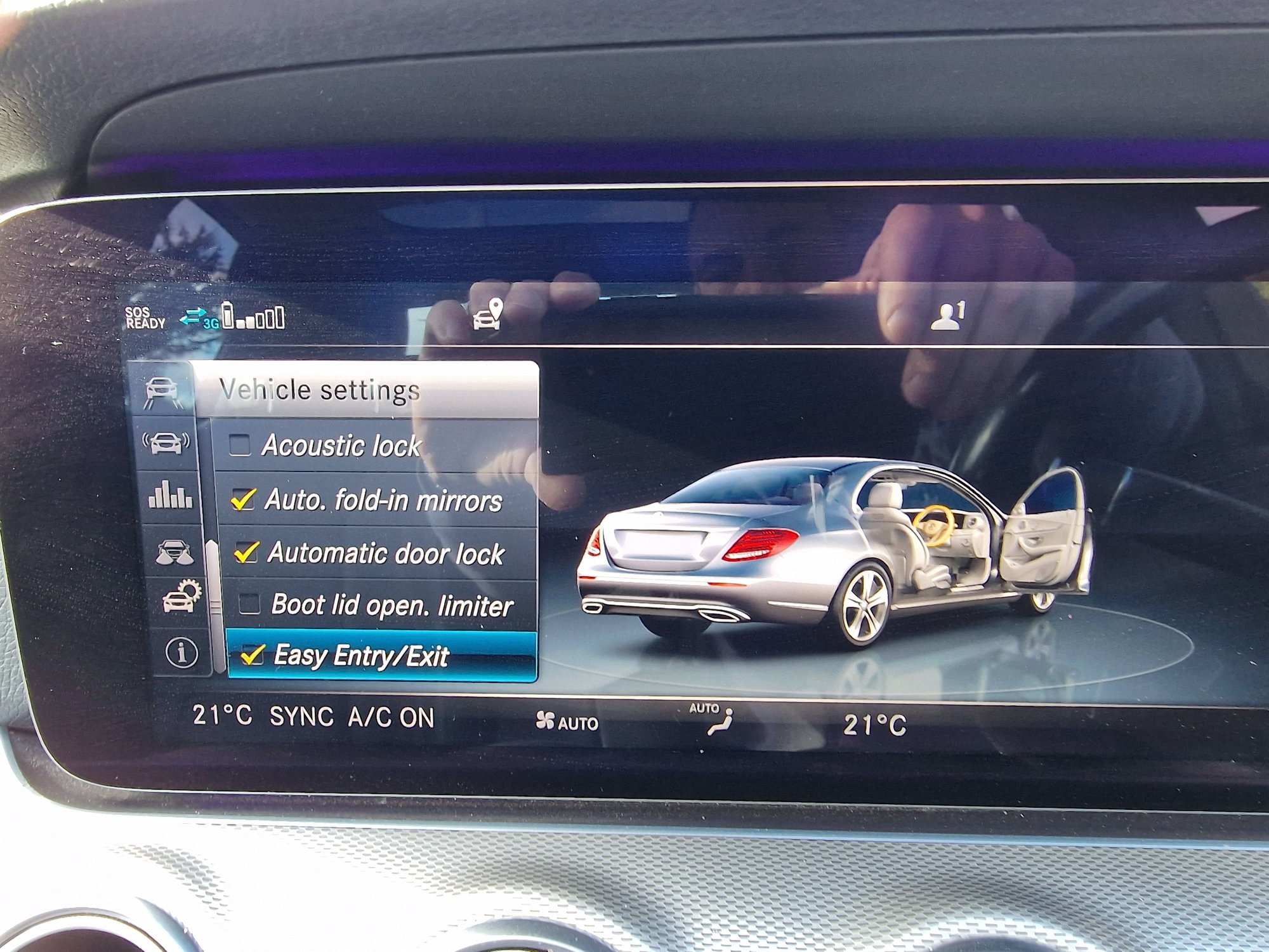

My seat does not move.
In the settings only the steering wheel is highlighted.

What does your operating manual say concerning 'easy exit/entry' feature.

From: Maldon
E220d
I'll find out when I get the car back from the garage.... it had to go back, as they didn't fix it properly.

My owner's manual just indicates the availability of the feature and that it has to not be at the foremost back for chair to function. On the on-screen menu it just has three selections for off, steering wheel, or both steering wheel and chair movement, which is the one I have selected. It seems like the TSB I have mentioned above applies to many MYs and models and seats are not moving unless the software is updated by the dealer.

So for your model year and/or market easy entry/exit only provides steering wheel feature.

Originally Posted by velryba
On my car (MY 2020 E450) when you click on the Easy Entry/Exit, it opens up another menu that you can either turn it off, select Steering Wheel only, or both steering wheel and the driver seat. You may try to see if you can expand the menu.
On mine it is only to tick or untick..... no moving seat in my barge.....

Confirmation is in the MFD menu it will show settings availability, if seat is not listed vehicle is not equipped with this feature.
