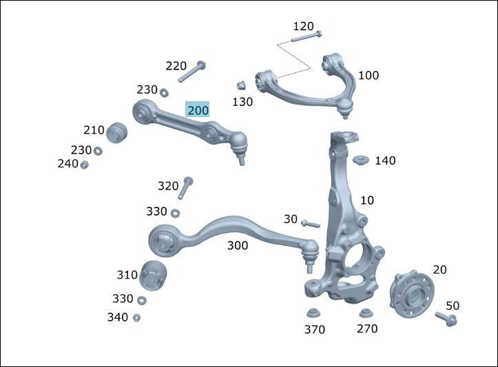

Mechanic says I need a castor arm to cure my squeaking, and occasional scraping sound. However, he is not around for a few days, and I need to source the parts.
Can anybody please confirm which one is the Castor Arm? I suspect it’s the cheaper one of the two examples posted below.

Front caster arm = MB ‘spring link’ w/adjustable bearing, rear = MB 'camber arm' if you want clarify front/rear, left/right and provide VIN I will pull correct part # to shop.

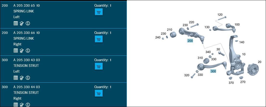

Both spring link & tension strut may be applicable, I would suggest you confirm with him before ordering, attached complete parts list for this reason.

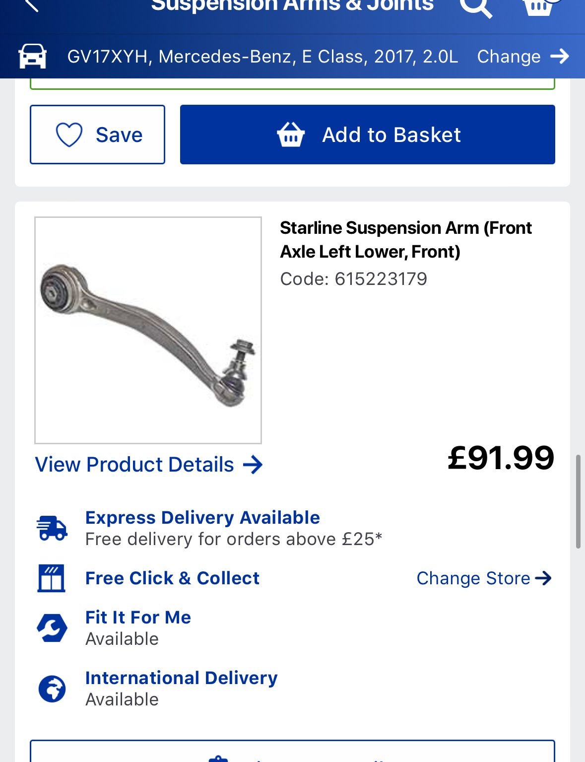

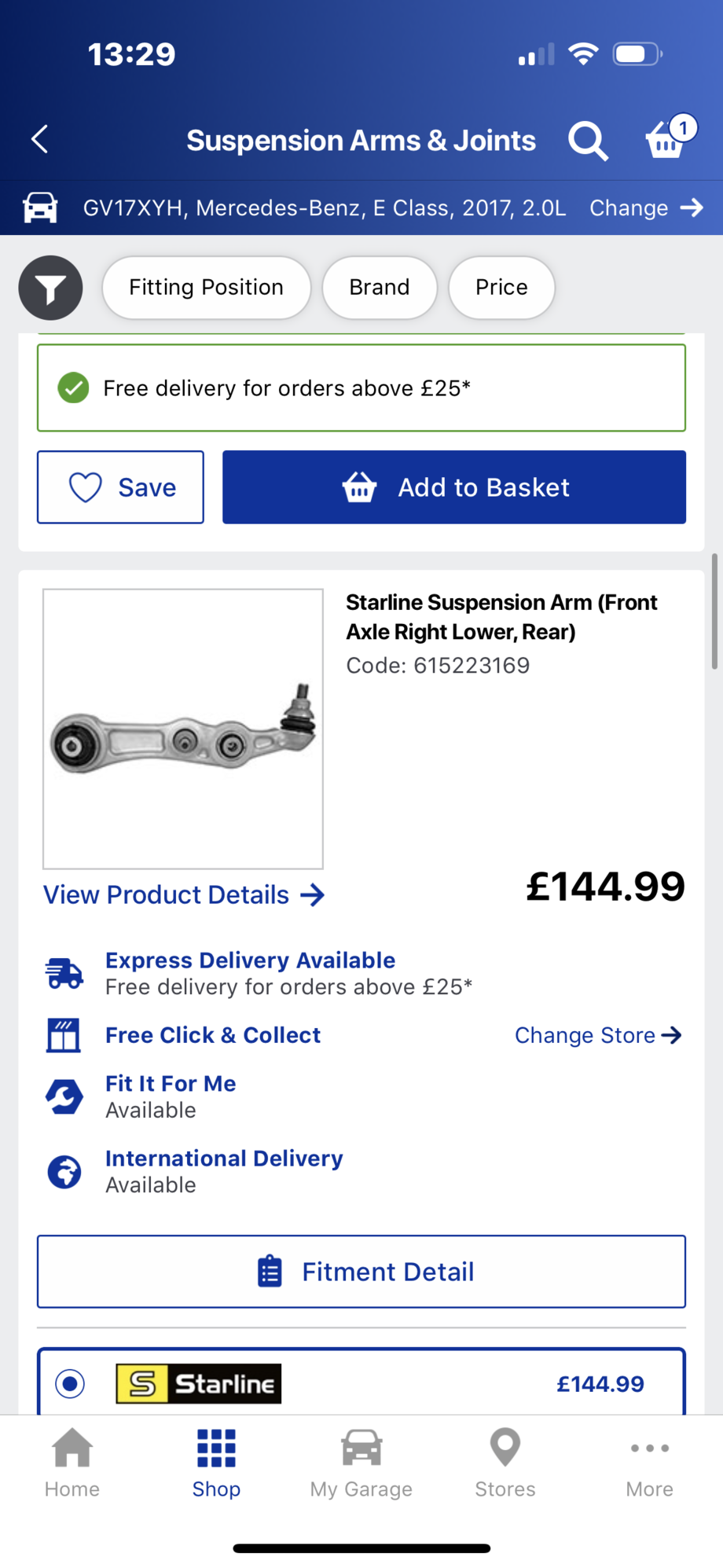

I have put the part number into Autodoc, but many of the options are out of stock. However, if I use my Reg, and give me various options, but the part number here is not on the list.
Are they likely to still fit?

Autodoc a2053306510 & a2053304403 bring up a number of aftermarket compatibles, try Google searching part #s without ‘a’.
