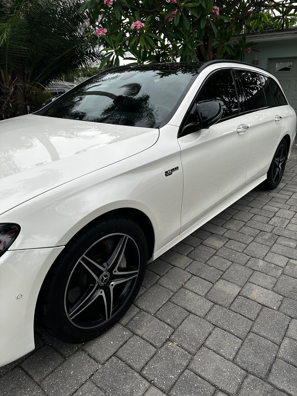

Good evening from South Florida!
So, I’ve read through other posts that I could find on this topic, and just couldn’t clear up my next steps to work on wheels, tires, and stance.
Wheels and tires, I plan on 20’s. All I’m positive on so far.
The confusion come with the current suspension setup, I know it’s not full airmatic, I’m almost positive that I have springs in the front, and some hybrid self leveling system in the back. I also have the “AMG” lowered stance from the factory.
With that said, what is the right path forward? I’ve seen a few different solutions; module for the rear and springs in the front, coil overs (unlikely), springs all the way around? Ugh, looking for help the fender to wheel gaps are triggering me 😂
Thanks in advance!

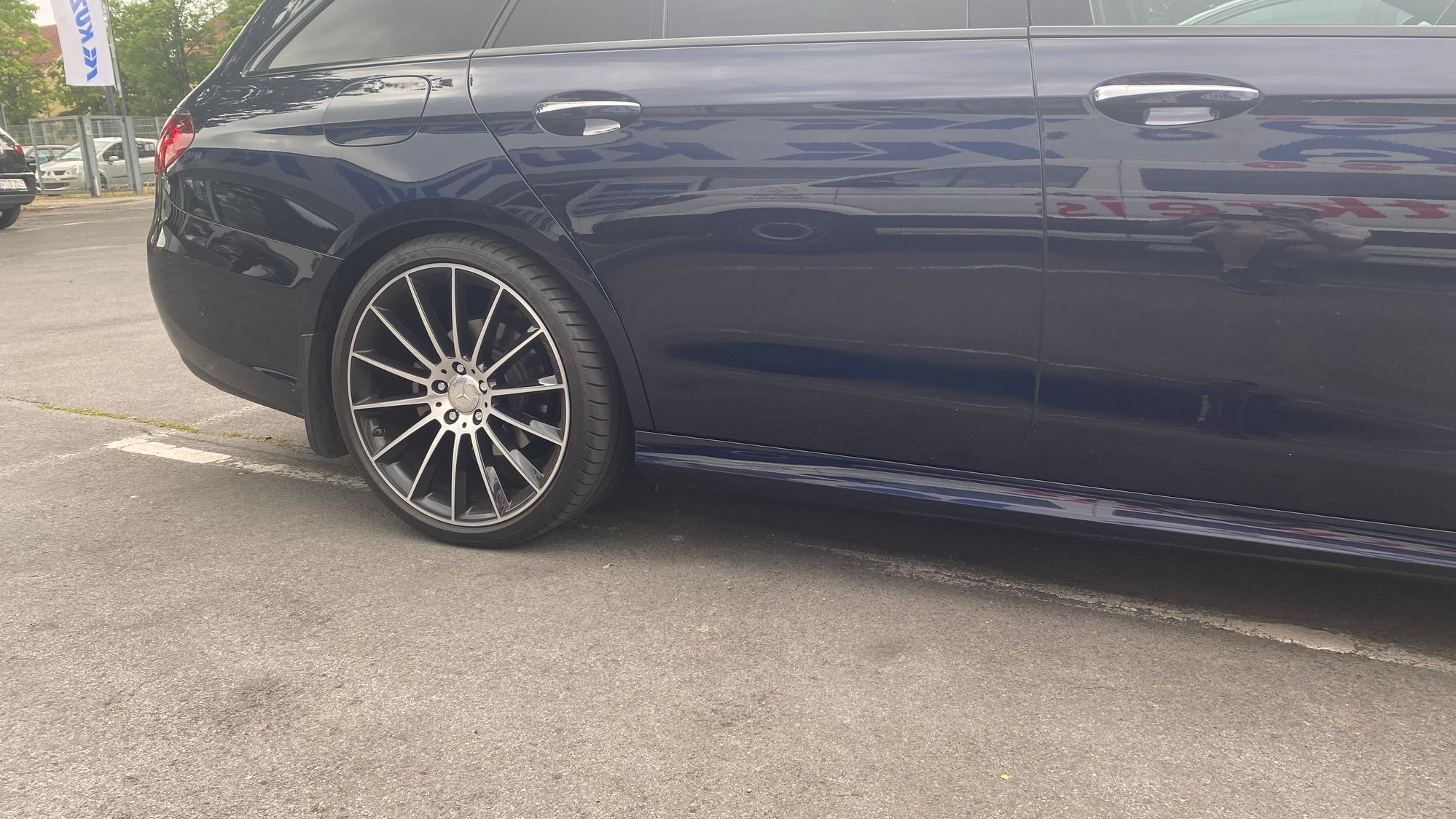

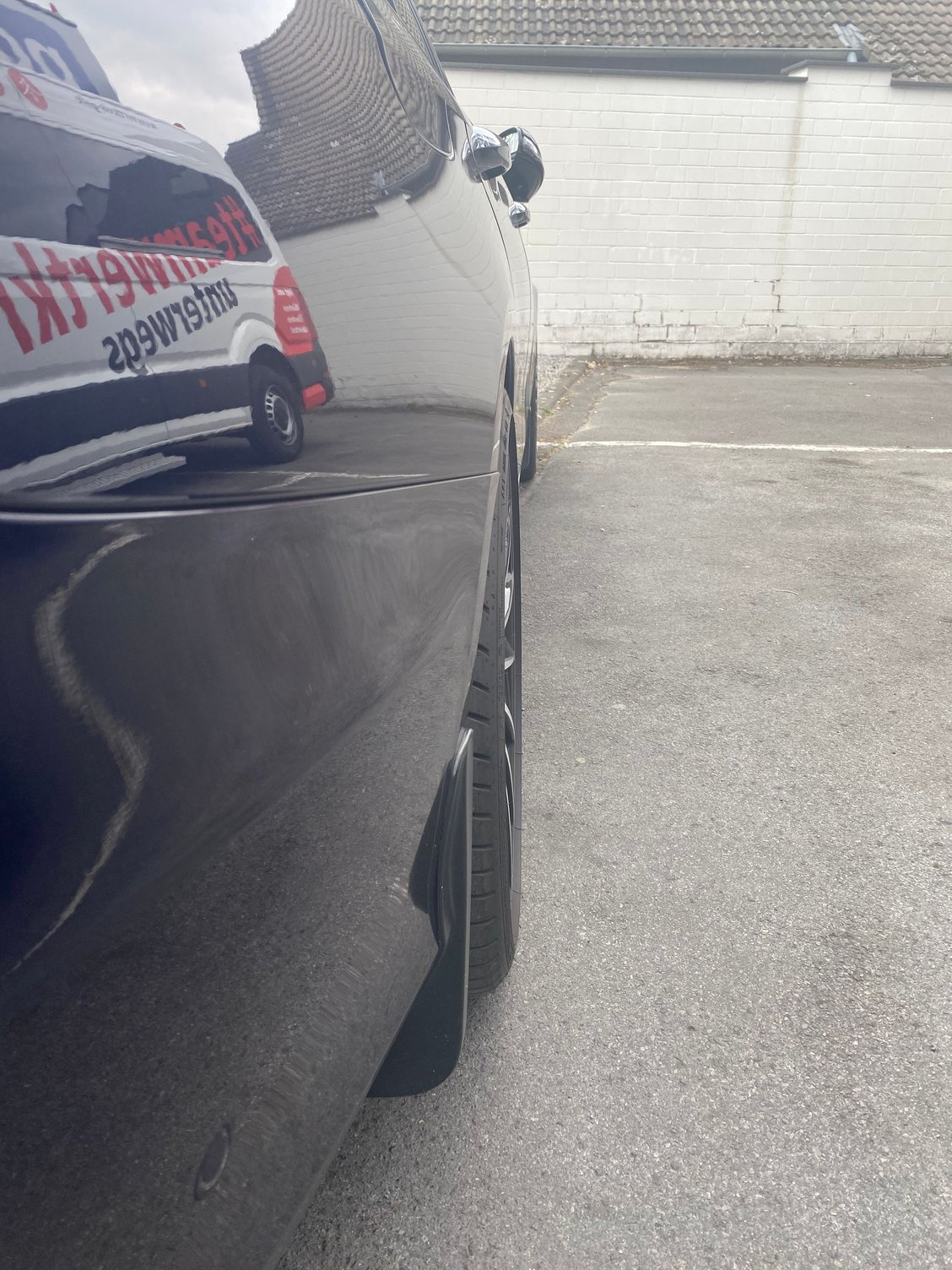

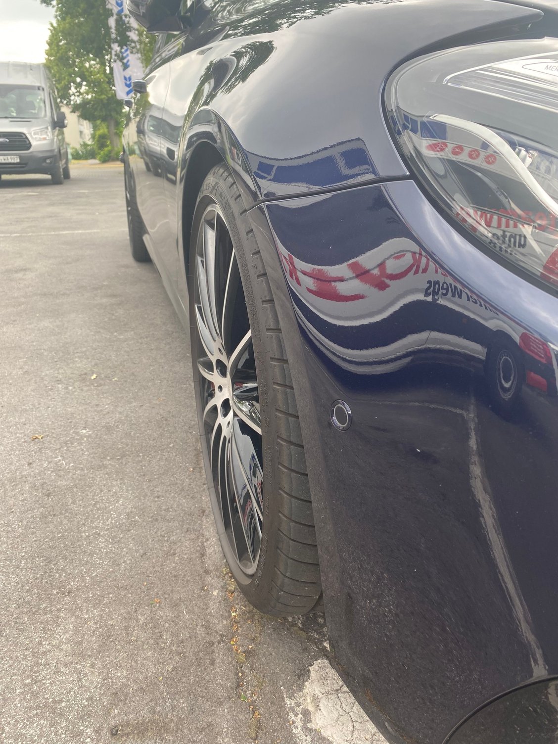

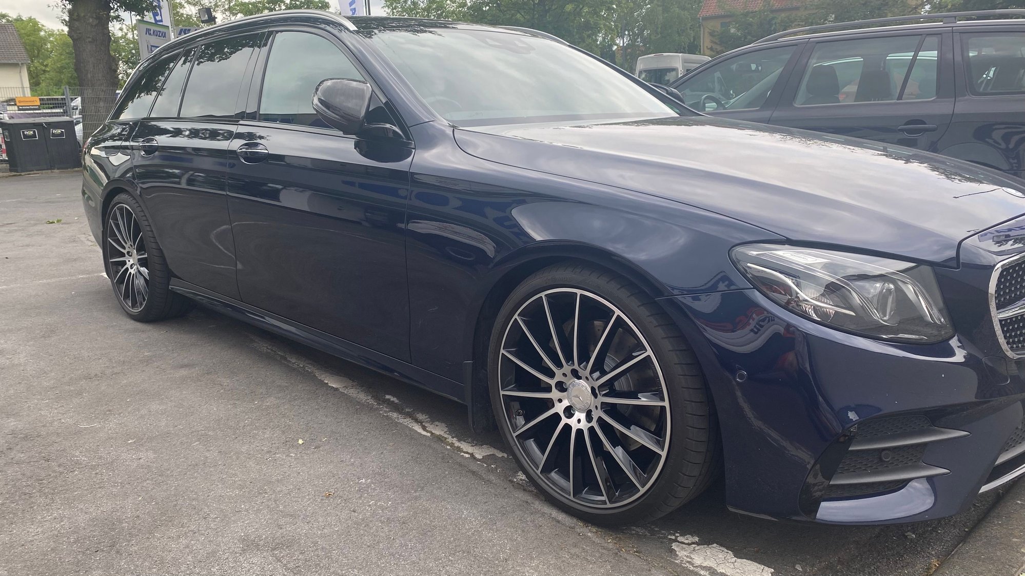

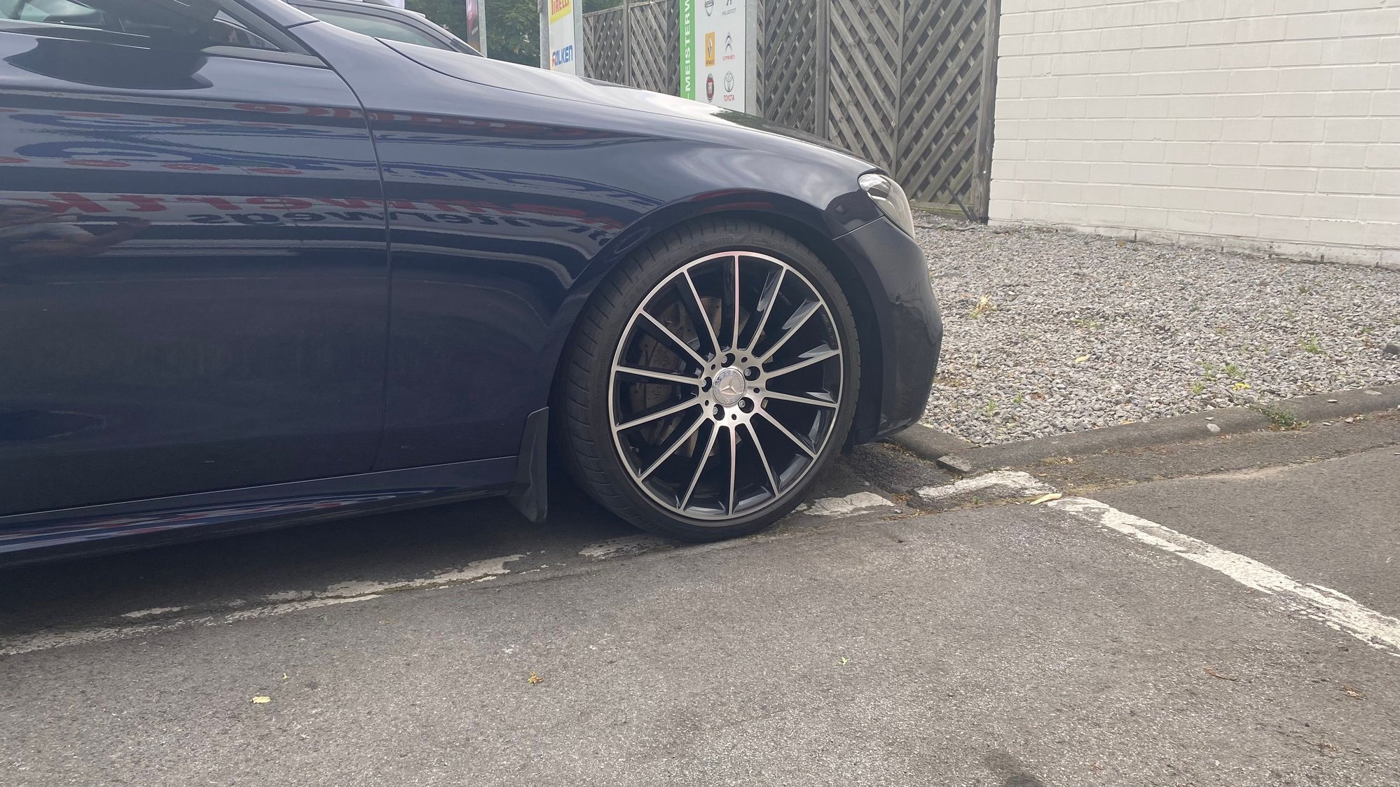

Old Jun 19, 2023 | 05:10 AM
Bfgslkman's Avatar
Joined: Jun 2018
Posts: 317
Likes: 102
From: Northern Germany and sometimes Southern Germany
Mercedes E220d AMG Line Estate (S213) and Mercedes E220d AMG Line Cabriolet (A238)
See attached. Currently in “Sport” so 10mm lower than the already 10mm lowered datum
