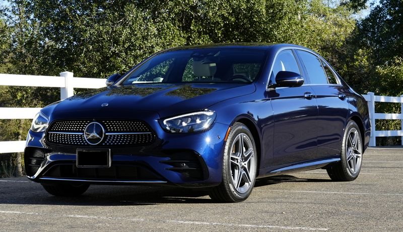

Back in the W213 fold with my newly acquired 2021 E350.
I want to like them...but, I just can't. I'm talking about the wheels. So I'm thinking about upsizing to 20", and brighter. I have my eyes on a set of the multi-spoke 20x8 AMG wheels.
My concern is ride quality. Love the aesthetics but don't want a harsh ride; firm is okay, and I don't have to deal with a lot of pot holes. The car is equipped with "Lowered Suspension w/ Selective Dampening" (code 677). Helpful comments appreciated.

By your post you already know the answer: the ride will deteriorate and although potholes are not a problem, if you ever encounter one it will be.
Originally German cars put function over form: you are doing the reverse: putting form over function.
As you asked for it, that is my $.02!

Thanks everyone, for the comments, but who isn't willing to sacrifice safety and performance for appearance and comfort?
I don't care for the appearance of the wheels that are on the car (it's not the first time). Even with a fancy name, gray is still gray. However, after reading comments and talking to others I think that 20" option is out from the comfort perspective. Oh well, there is always my fallback 19" option...Chrome.
