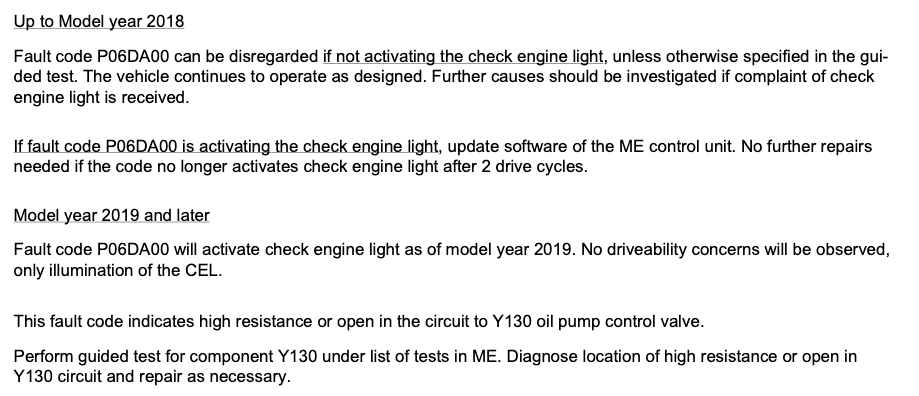

I know this is old, but here are a couple of comments if you get DTC P06DA00.
1. You can manually check your oil pressure using a pressure gauge and connecting it to the oil pressure test port located near the oil filter. (Search for how to do that. There is a procedure in WIS.)
2. Since the low pressure mode is at engine speed of less than 3500 rpm, if you need to take the car to a shop for further diagnostics and repair, don't drive above 3500 rpm. That is pretty easy to do. Keep the transmission in E/C mode.
3. Model years 2019 and newer will throw a CEL. Older cars will not, unless there is a more serious problem. In either case, DTC P06DA00 alone is not a cause for panic (or even the very expensive repair).

You have the M256 engine. The oil pressure regulation is a little whacky, in my opinion. You probably were smart to have the dealer fix it.
I really hate newer cars!
EDIT: Looking at the TIPS document again, it does imply that the P06DA00 is not a serious fault.

jumping in late here as I just got this code 200 miles after hitting 100k on my car. What is a TIPS document? How hard is it to change the solenoid itself? I’m pretty handy.

Do not change it, unplug it and then plug a dummy solenoid outside the engine once measuring pressure is good.
