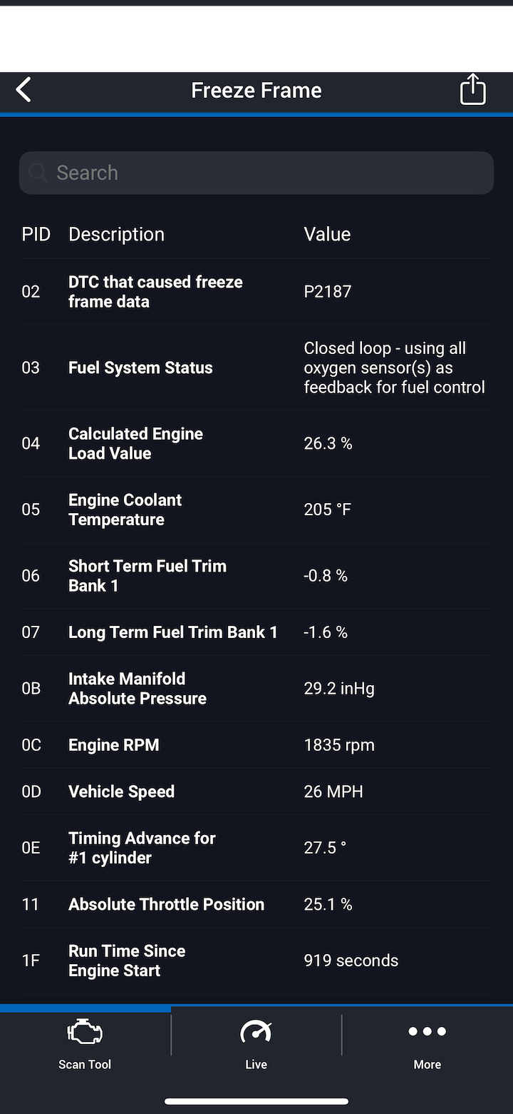

I have a 2021 e350 sedan base. So last night I literally pull out of my drive way, drive maybe 5 mins and turn on this bumpy road. Immediate I feel the car start to shake and my check engine light comes on along with eco mode off. The car feels slow and funky, and after some research into this forum, I now recognize it as limp mode. Drive it back home limping and pray that the CEL disappears by dawn. No luck, in the morning the car was still limping and CEL is still on solid. Take it to the local parts shop and the OBD2 read pulls code P2187 "air-fuel mixture ratio is too lean" and P0191 "Fuel Rail Pressure Sensor Circuit “A” Range/Performance". I have done a fair bit of researching those so far but no definite answers.
To add to my misery, the car just hit 41k miles .
Had bought a at home OBD2 reader and pulled some more info of the triggering event that I am attaching here.
Anybody had a similar issue or any ideas what it could be?

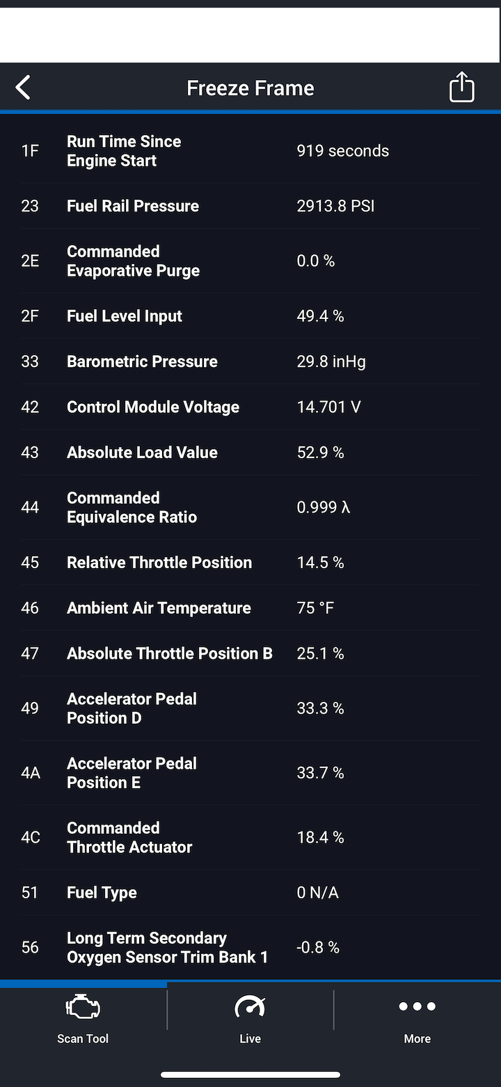

I read through your freeze frame data.
Your HPFP seems perfectly well near 3000.Psi
Your Bk1 LTFT are perfectly good as well
Your power supply voltage is great as well
The ambient was 75F: easy mixture!
It all seems like nothing could be better... yet ECU bug checked into limp-mode cause of lean + pressure.
You've got an unusual glitch condition at 40kMi.
> MISSINGS....
What I miss is the low side fuel pressure
and Bk2 LTFT
along with a scan of all chassis modules.
