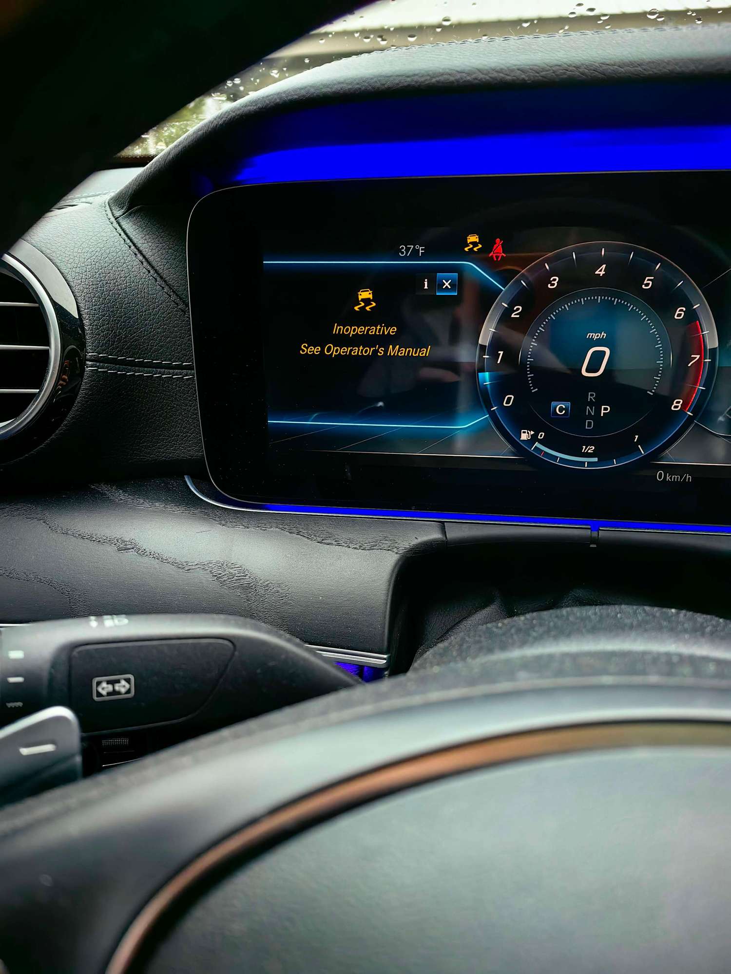

I have a 2018 E300 4MATIC that is giving me these messages on the dash screen:
(Traction Control icon) Inoperative See Operator's Manual
Active Brake Assist Functions Limited See Operator's Manual

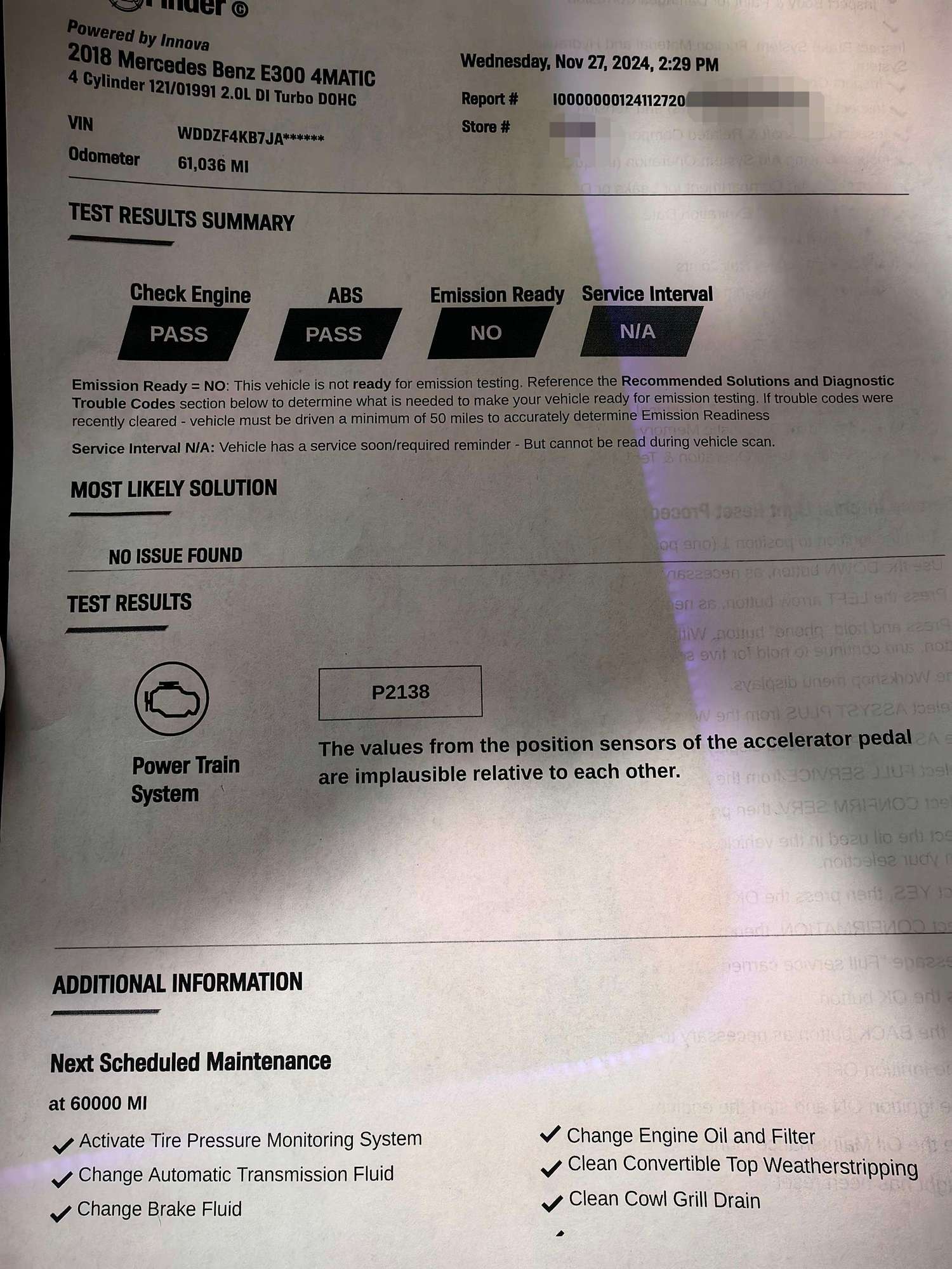

I brought it to an AutoZone to read the CEL and it doesn't seem to be anything serious regarding the CEL:
"Power Train System code P2138 - The values from the position sensors of the accelerator pedal are implausible relative to each other".
The CEL is a solid light (no flashing), and now stays on regardless of whether the TC Inoperative and Active Brake Assist Limited errors comes on or not. I was planning on driving 3 hours tomorrow to my mother for Thanksgiving, has anyone encountered a similar issue?
