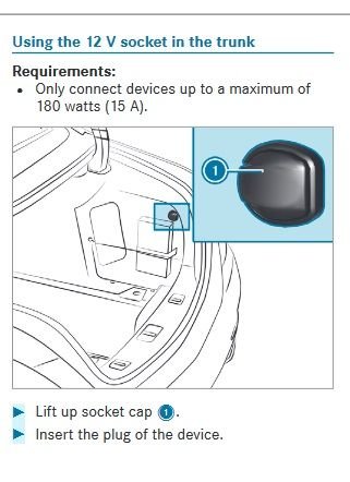

I know this is an old thread but there are 3 pages of 60 post now about this issue and I felt the need to add a final note on this discussion for safety sake.
Please, please, please do not ever even attempt to charge your car battery using any of the USB ports no matter what type of adapter or charger you might have. Just DON'T do it or your going to cause damage at some level. It might get to the point of starting a fire and then...

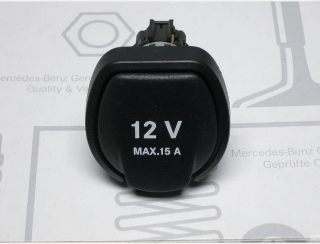

Not sure why people are afraid to open the hood and connect a charger the preferred way that MB shows in the owners manual. But it seems they are and want to just plug into a cigarette lighter receptacle to connect their charger. This is an alternative and acceptable method (as shown by MB) but there is one requirement that is overlooked by many who have found out the hard way. Not all cigarette lighter receptacles are the same. Some are rated for a higher current value and are designed to hand a larger load and likewise also able to handle a larger charging current your battery and charger decided you need. You need to do a little reading to see what the maximum value your outlets are rated for. Not all cars are the same so the owners manual is the best place to start and the fuse size for each outlet is also a good indicator of maximum amperage allowed.
Cigarette lighter receptacles that have a label indicating they are rated to handle 15 Amps is appropriate for charging the car battery. Many battery chargers are capable of producing a solid 10 amperes of current and the typical cigarette lighter receptacle can't handle that size load for an extended period without problems. Having a rating of 15 Amps will allow enough headroom to accommodate a full 10 ampere charge load without problems for an extended amount of time.
Here are a few items to note in the owners manual for connecting a battery charger:
