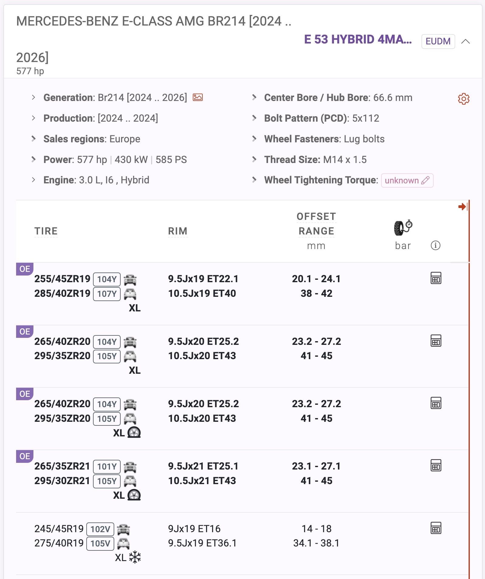

From the link I found my model: https://www.wheel-size.com/size/merc...r214-2024-2026
Here is an image of the page that seems to show the 19" OE options with 9.5 J and 10.5 J wheel widths with ~ 22 and 40 mm offsets.
If I went with the first set of OE 19" wheels and tire sizes Front: 255/45R19 andRear: 285/40R19 my overall tire height: 28" front and back which is well within range of the 21" set that this vehicle comes with.
The sidewalls would increase from 3.65" / 3.5" (front/rear) to 4.5" (both) which seems an impressive upgrade in the comfort category given I have no intention of launching, racing or drifting in this daily driver. I would put the OE 21" wheels/tires back on when I wanted those thrills.

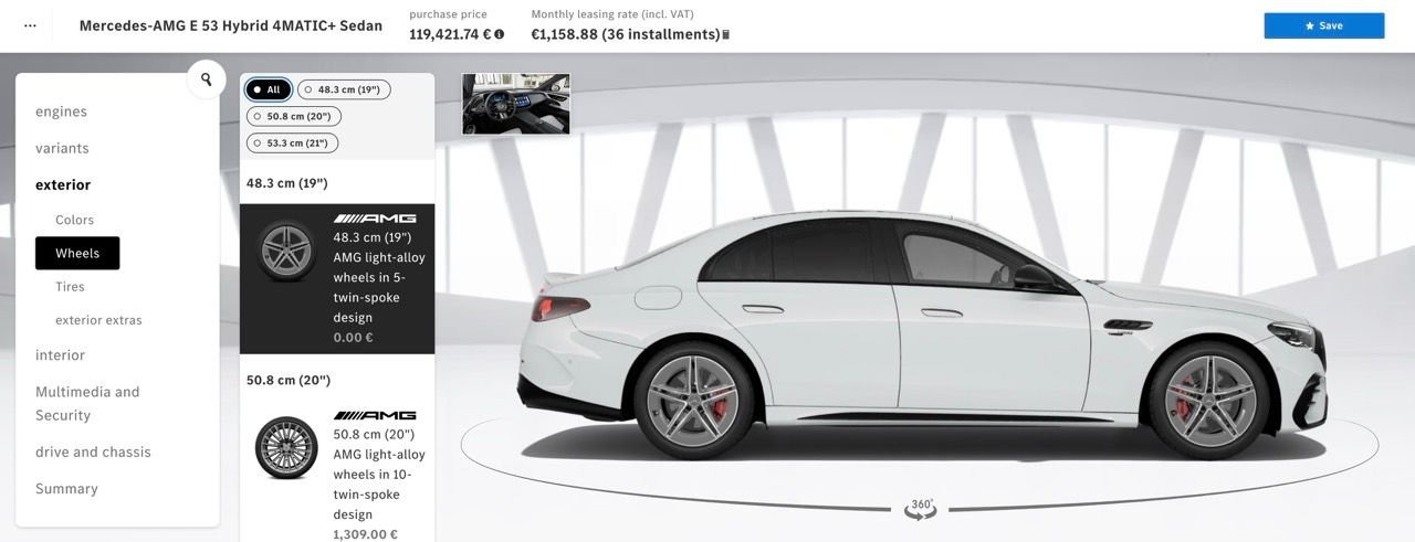

UPDATE: Fairly official - You can safely put 9.5J x 19 inch wheels on the front of your E53.
My local dealer did some investigation for me and found that Mercedes-Benz in Germany offer a 19 inch wheel option for the AMG E53 and does not give you a warning if you equip the Dynamic Plus package that includes the 390mm brake discs. Here is the German build site with these 19 inch wheels (grey). I don't love the style of those wheels, but this is good news since it means the fitment is probably ok for other 9.5J x 19 inch wheels.
