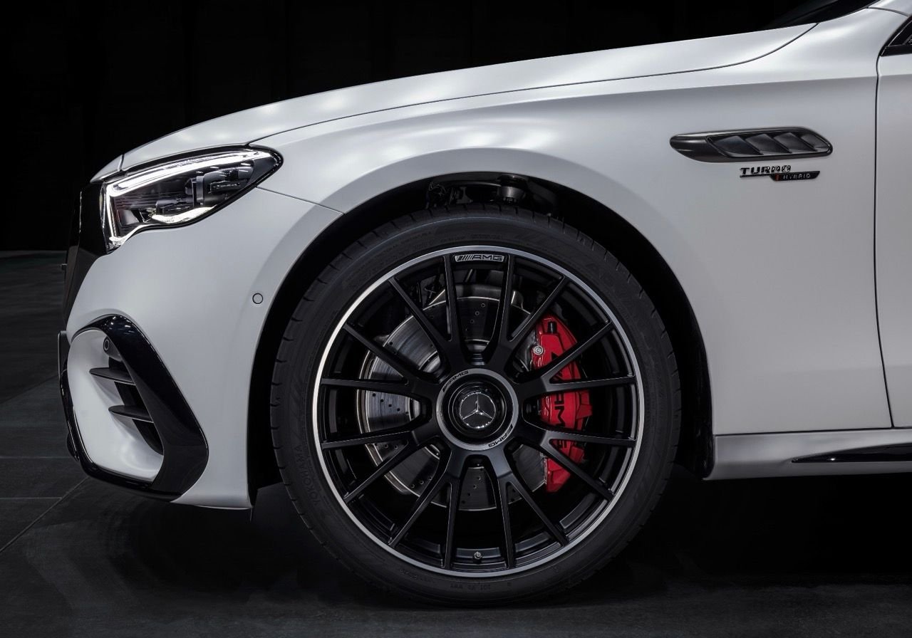

Advice: How / Where to sell stock wheels
I have the wheels / tires below on the E53 that I ordered and I will take delivery in about a month. I will be replacing them immediately (before I leave dealer) with 20 inch OEM wheels. Long story.
Q. The dealer says these are too specialized for them to sell to any of their local customers, which I'm beginning to believe, so what is the best approach to selling them with the least silly business? On MBWorld?
4 x 21-inch AMG forged cross-spoke, black, with Michelin Pilot Sport 4 S
Any feedback is appreciated. Assume I already know how dumb it was for me to change my mind AFTER spec'ing the 21 inch wheels.

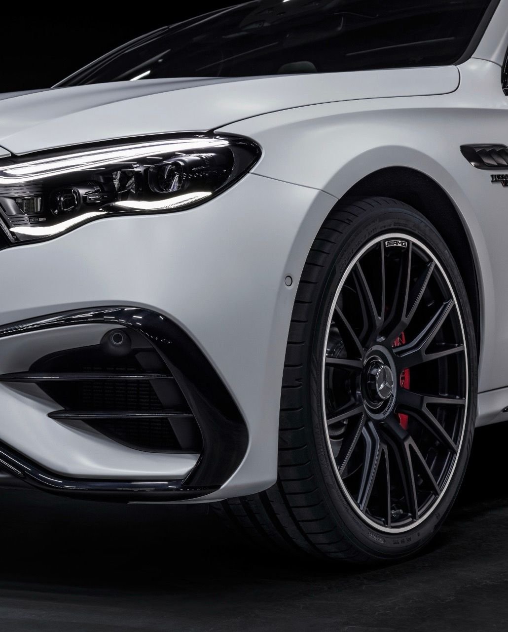

If anyone in North America has a 2025 E53 with the 20-inch AMG twin 5-spoke wheels (see top image), but want the 21-inch AMG forged cross-spoke wheels (see bottom image), maybe there is a deal to be made.
If I'm posting this in the wrong place please point me in the right direction. Happy to adhere to forum protocol (once I learn it).

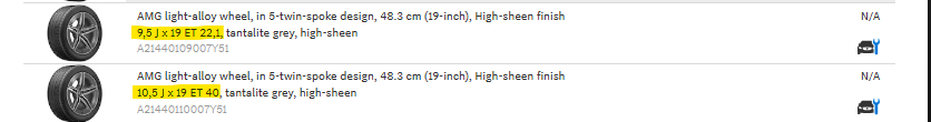

@LAZARU5 My dealership parts expert found these 19 inch wheels (see part numbers below) in Germany. Can't be ordered in North America currently. They are for the E53 in Germany and you can spec them when you do a build online there, including when you have the AMG Dynamics Plus package with the 390mm front brakes.

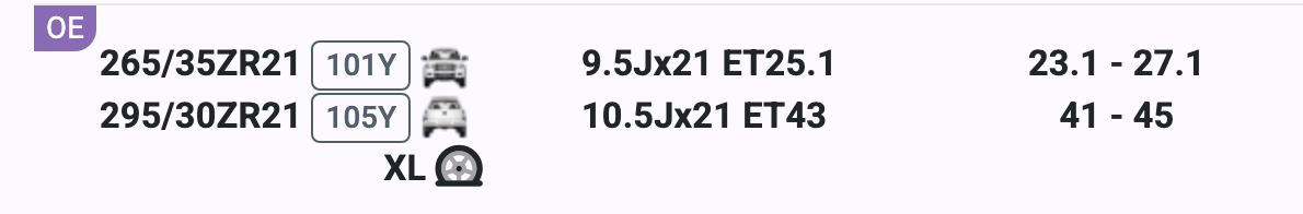

As for the wheel specs, I found this data online (I don't have the car yet): Tires / Rims / Offset Range (mm).
When I get the vehicle (about 30 days from now) I plan to drive on them for some amount of time. I may want 19 inch options to emerge before parting with these and that could take some months (or more).

Where did you find the specs which show the ET range? I would like to know the range for the 19" wheels you reference in Post #10 above.

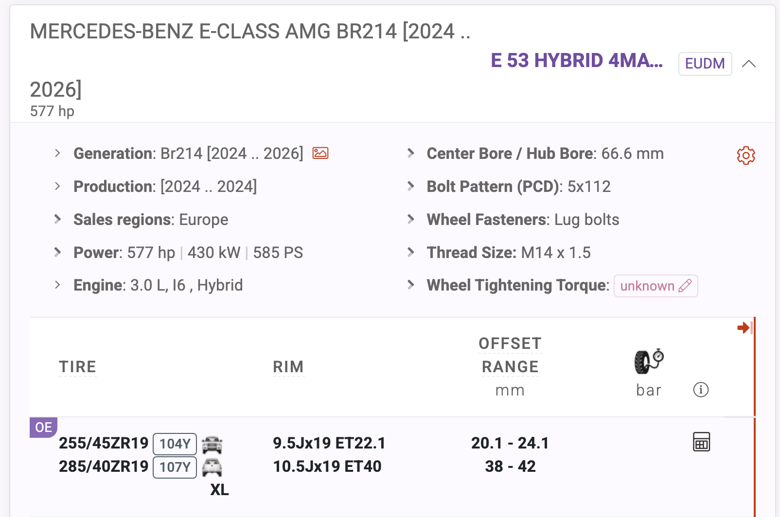

@LAZARU5 I found this website hunting on my own, and then my parts guy at MB said this helped him find the 19 inch OEM wheel listed here on the MB Germany website for the E53. You can spec that wheel there (it has grey accents).
Image from site with the 19 inch OEM wheel specs:

@Huleyman I found a source for a set of the E53 19" wheels with TPMS, shipping, and mounted Pirelli Cinturato P7 tires for $5400. If I can sell my 20" wheels with TPMS and partially worn AS tires for a reasonable price I plan to downsize the tire size to improve the ride comfort.
My current wheels are front
A21440115007X21 9.5 x 20 ET 25.2 and rear A21440116007X21 10.5 x 20 ET 43.

I took a close look at the clearance between the 4-piston calipers for the 370mm rotors and the 20" wheels and I think the clearance between the 19" wheels and 6-piston calipers for the 390mm rotors could be as little as 5mm. Also, the rear calipers for the base E53 come fairly close to the wheel barrels.
This is very helpful information. Fingers crossed I won't have to downgrade my brakes to fit 19 inch wheels in the future. I got a response from MB USA today that they've passed on to leadership the recommendation to include 19 inch E53 wheel options from Germany, into the North American market to better accomodate All Season & Winter tires, and also to improve ride comfort. Fingers crossed. Breath not being held.

Given the wheel widths you are listing are different from the German OEM E53 19" wheels in my image, I'm guessing these new part numbers are for different wheels.
Not a problem though if they fit the E53. And then the fun becomes which tires will balance ride quality and overall diameter (to avoid rubbing and speedometer issues).
