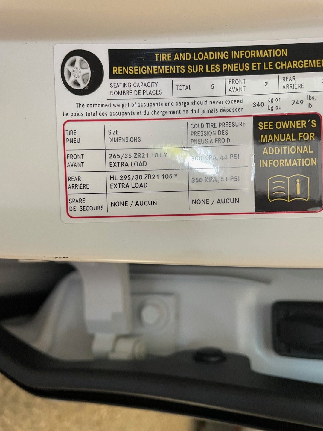

I was getting a "front" tire pressure warning last week and I spent some time over the weekend and failed to get rid of it. The warning says to refer to the recommended psi inside the gas cap. I have 21" wheels and the tires recommend 40psi. The sticker inside the door says 44psi. The sticker inside the gas cap says 39-44psi. Over the weekend I adjusted the psi anywhere from 36-44psi and am still getting the warning light. If I remember correctly, I think the original psi was around 44 before I got the warning light, but not totally sure. Which makes me think, why would I want to run 44psi when the tire says 40psi? Any recommendations, or anyone running 21" wheels can you tell me what your current tire pressure is for you fronts tires? Thanks!

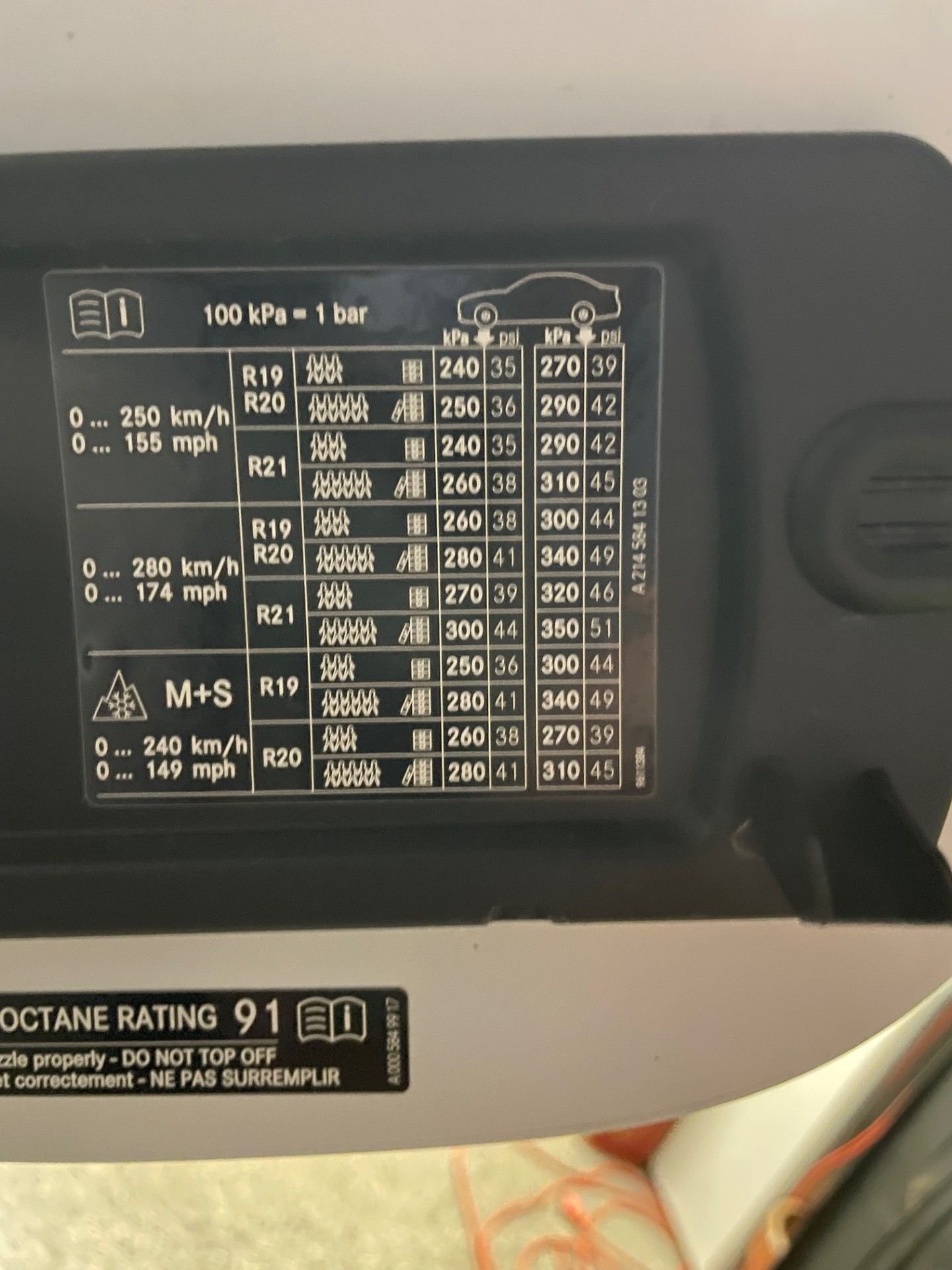

The PSI on the gas flap is for cold tire pressure and should be used. This has been discussed in numerous threads. After adjusting the tire pressure as per the cap, reset the tire pressure. Your warning light should then go out.

You go by the fuel tank sticker...and from there, assuming you are not on Run Flats (ditch em if you are :-) ....I go to the high end to protect my rims.

To add to what has already been said, the tires do not have a "recommended" tire pressure on them. At least I've never seen one that does. What is on the physical tires is the max pressure. If the gas tank flap is saying a higher pressure than the max pressure of the actual tire something is wrong. Are you saying that the tires themselves have a max pressure of 40psi? Seems pretty low for a max psi of a tire.

You are correct: there is only a max pressure on the tire, not a recommended pressure.
The same tire can often be found on different vehicles so a "recommended" pressure is not possible, as each manufacturer determines the ideal tire pressure for their cars.
I have never seen a situation where the recommended pressure as found on the gas flap, exceeds the maximum pressure on the tire.

I haven't either. If it does, then it is likely that the wrong tires are on the car. I doubt that is the case for the OP. They likely just read something wrong.

I have the Michelin Pilot Sport 4S and the tire says 40psi...that's why I am confused. Why would the gas cap say up to 44psi when the tire says 40?
The tire has no idea what car it is going on, what that car weighs and on and on and on...never, not ever go on what the tire says. Not even on a bicycle.
Can you provide a picture of the tire saying 40psi?

Just went to Tirerack.com to look up the maximum pressure for the Michelin Pilot 4S, 21 inches which I assume the OP has on his car.
The max pressure, according to Tirerack.com is 51 psi.
Mystery solved, I hope!
See: https://www.tirerack.com/tires/tires...20295%2F30-21R
