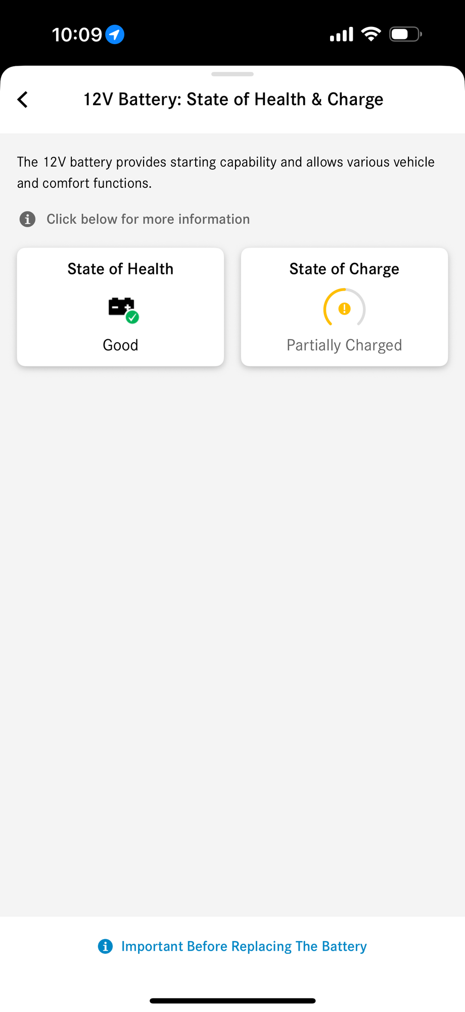

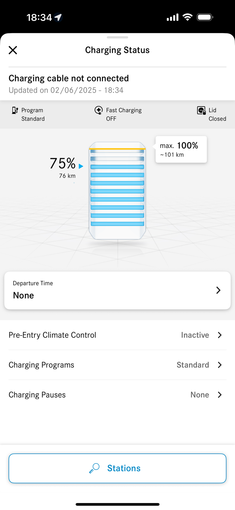

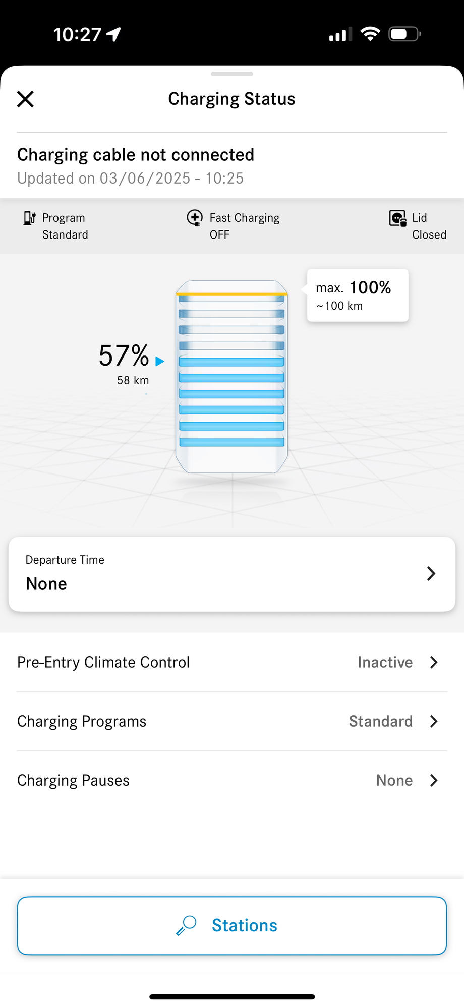

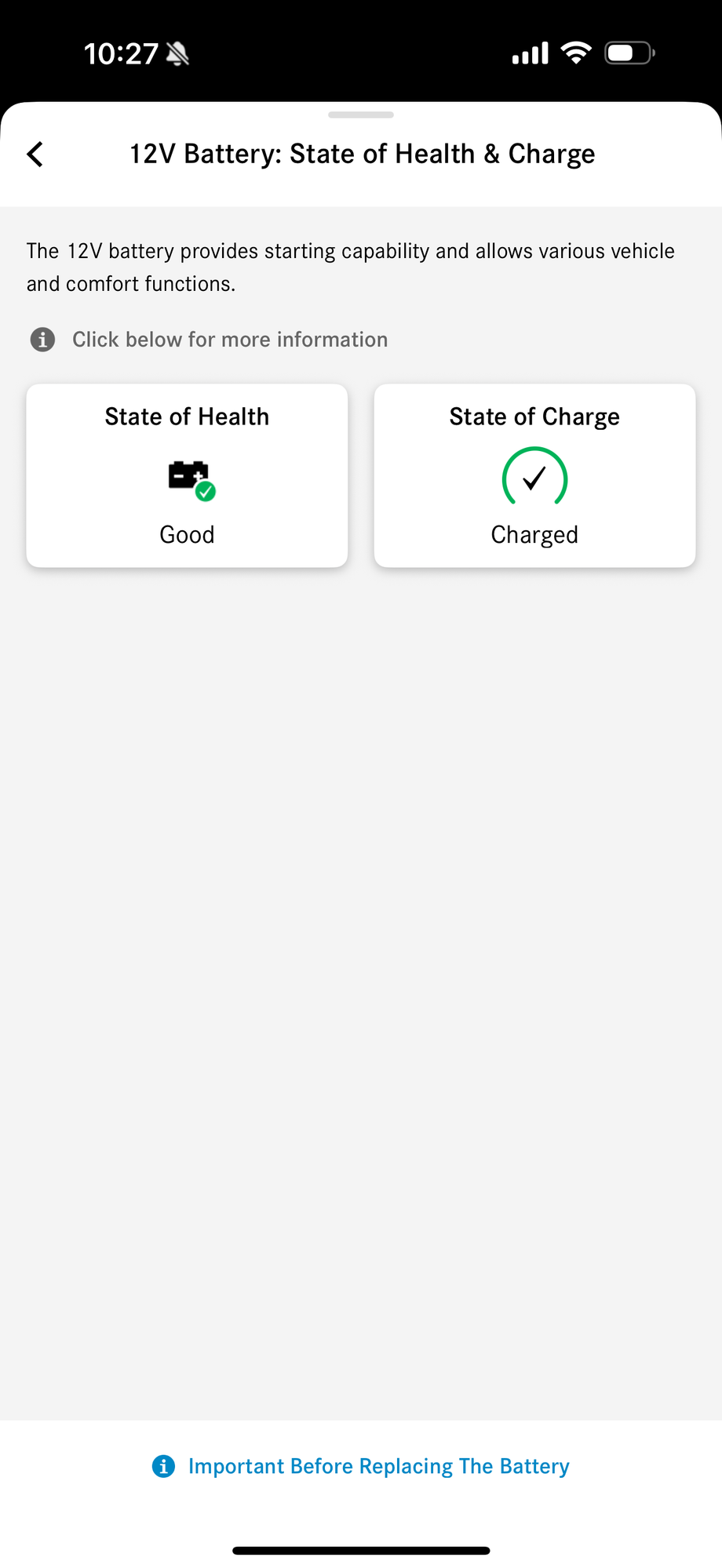

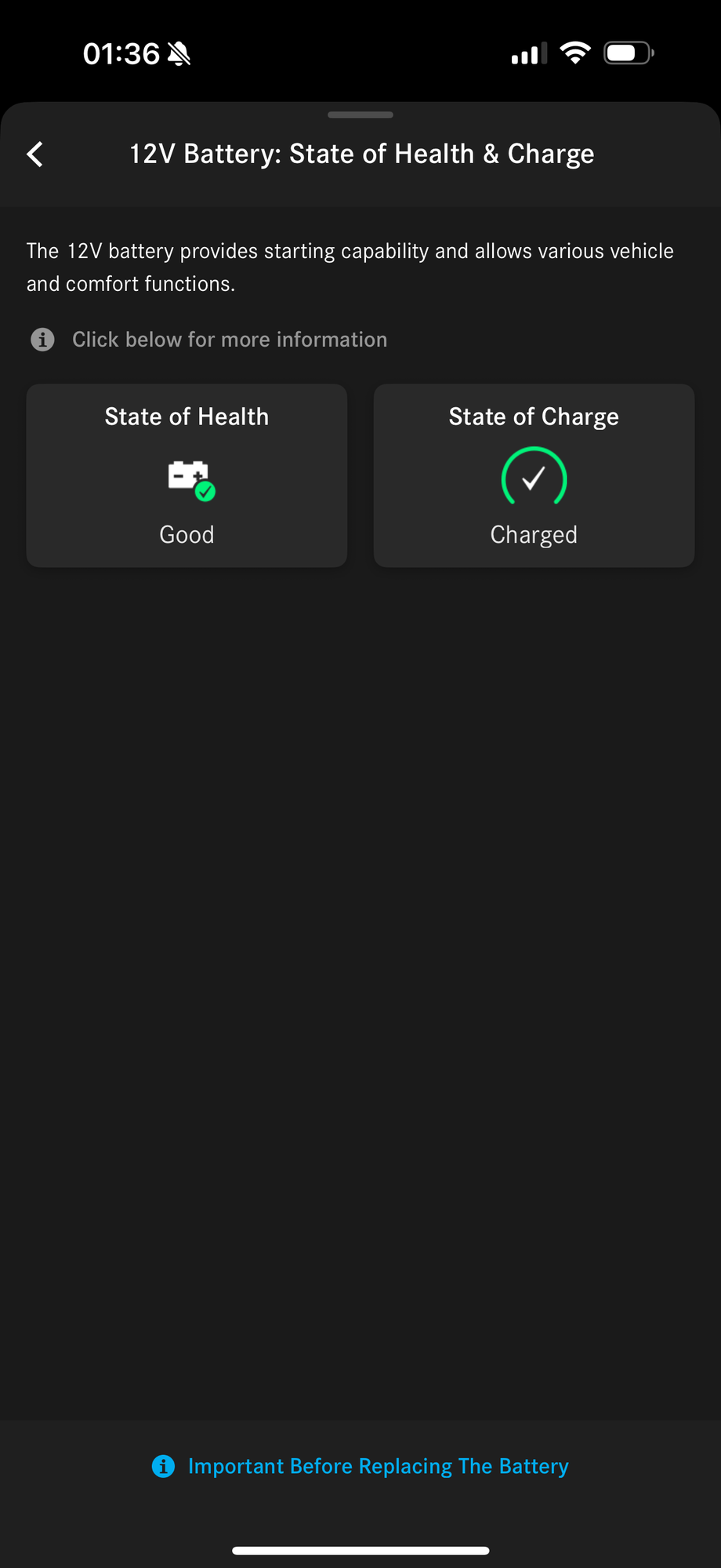

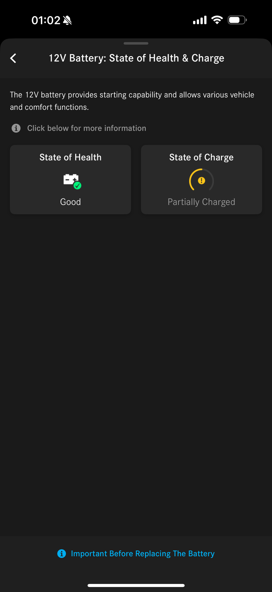

I’ve monitored the 12V battery and it seems that it gets drained and the high voltage battery charges it constantly. That’s why my hybrid battery gets drained. So the question is what is eating up the 12V battery now? MBUX maybe?
