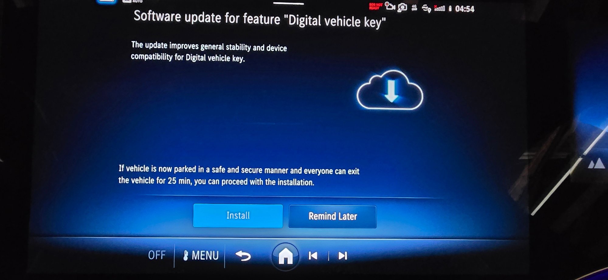

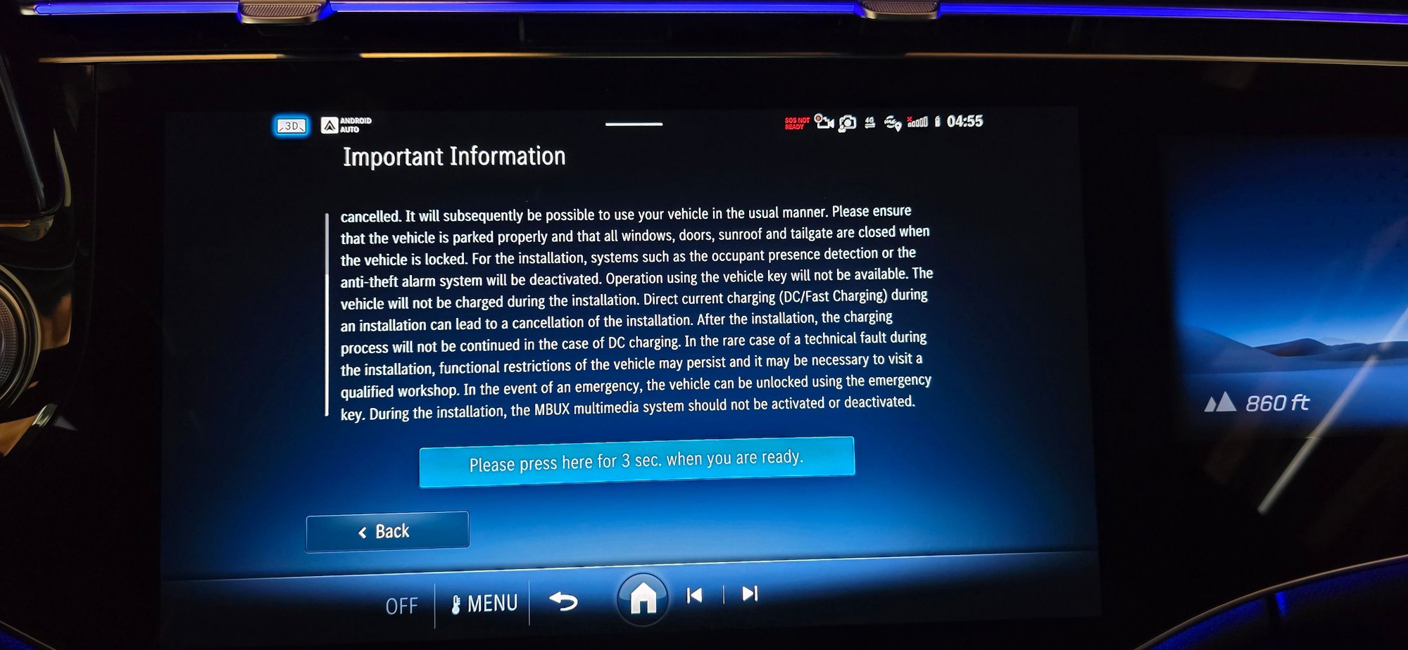

Jun 5, 2025 | 06:19 PM
This update is very different than all the past updates. I allowed it to begin when started an hour long drive home. When it finished it said that I must turn the car off before I could continue with the update. Once I got home and parked in the garage I hit continue and it walked me through a series of steps. The car had to be parked in a safe place and parking brake engaged with engine shut off. Once turned off I had to press a button for 3 seconds when ready. The vehicle must then be locked from the outside within 1 minute or the update will cancel. While the update is running you cannot use the vehicle for 25 minutes and the theft protection will be disabled. Charging cannot be initiated (for PHEV versuons) and it made a point about the update cannot be canceled once started. It was a lot more prescriptive then all the prior updates. I haven't gone back out to check on it, but I did hit the timeout because I had to get several things from the car before I locked it. I had to get back in, and start / stop the car before it would allow me to continue again. I've attached some screen shots of what the process looked like.
Reply 3
Jun 5, 2025 | 07:59 PM
That makes sense as this is an update to a security core function. Basically the whole locking and ignition system is going offline while it's being updated, so no locking/unlocking/starting the car while the update is in progress.
Reply 0
Jun 5, 2025 | 08:52 PM
One thing to keep in mind is that the 1 minute time limit was not mentioned in the instructions. When you start the process, don't take your time like I did to exit and lock the vehicle. Otherwise, you will have to start the process again. Not a big deal, but a hassle none the less.
Reply 1
