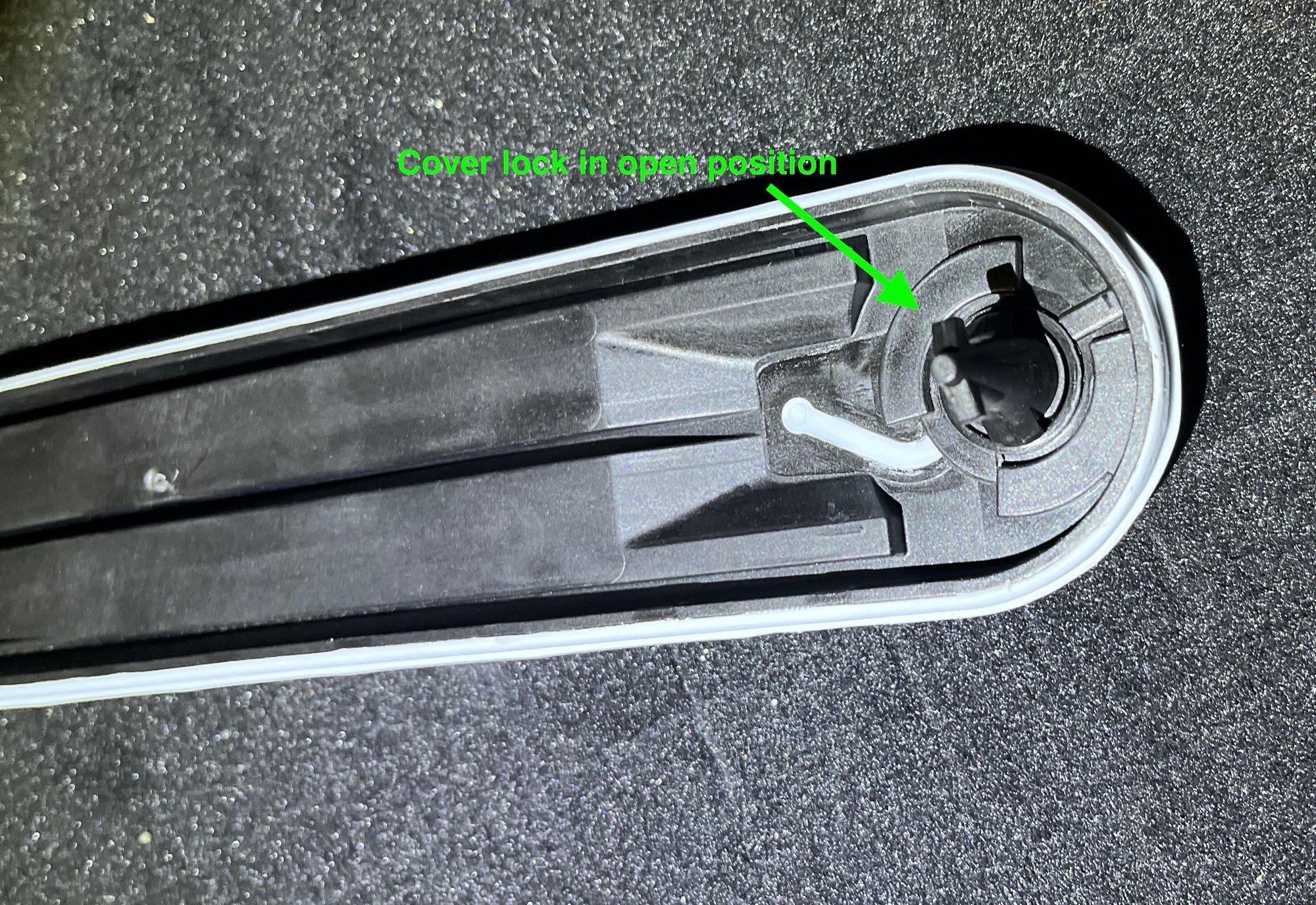

6) Remove the cover from the bottom of the cabin filter by turning the cover lock 90 degrees counter clockwise. Pry the lock-end of the cover down and shift the cover towards outside of the car to disengage the “tab” on the console end of this cover. This is more difficult than it sounds because a Silicone gasket around this cover holds it very securely in place.

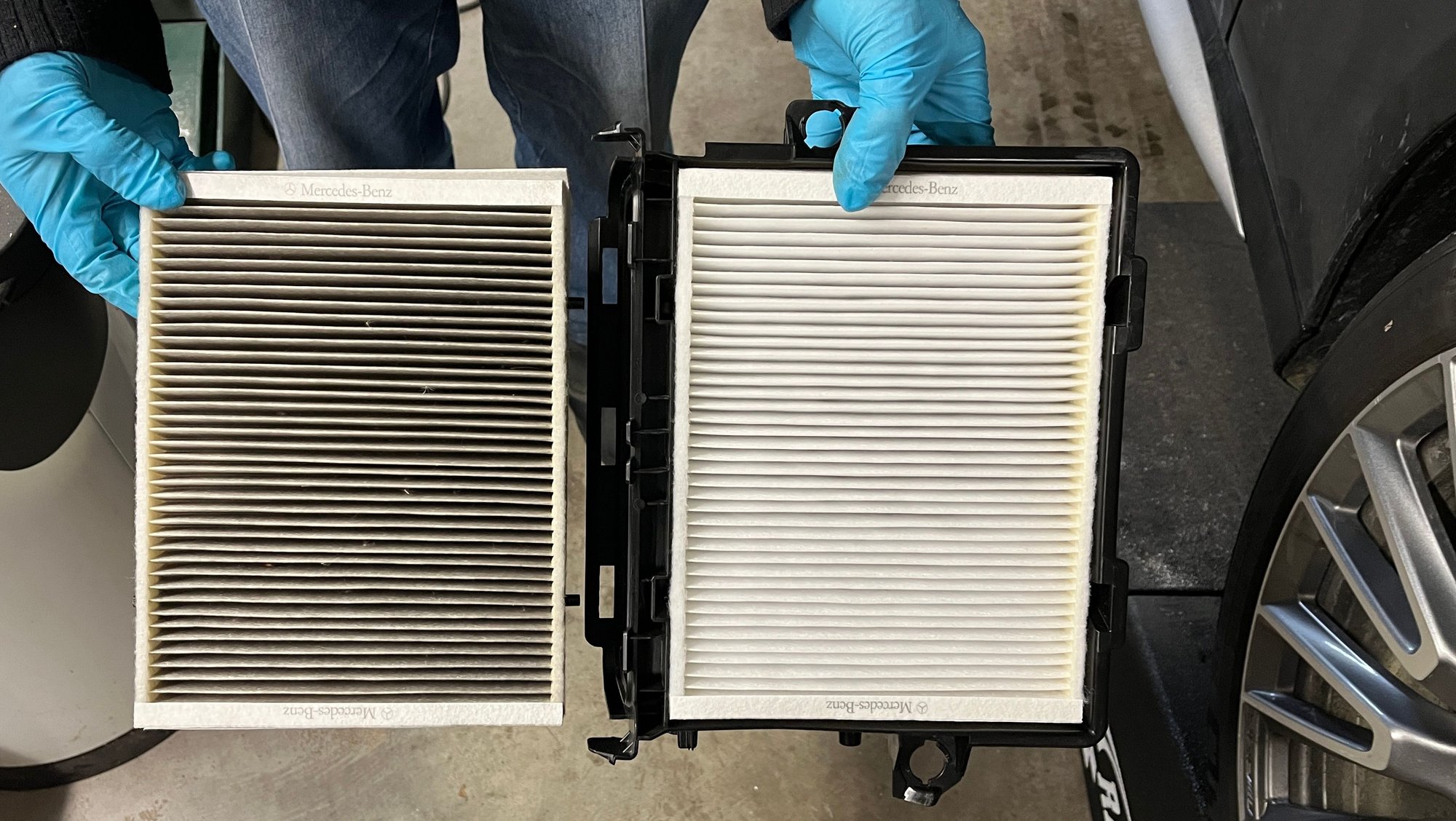

7) Pull the old filter out of the housing.
8) Insert the new charcoal cabin filter. It may be necessary to squeeze the two sides of the filter together slightly to coax it into the housing. Make sure that the black plastic fitting on the lower right corner of the filter is properly seated into the housing. The post on the filter cover lock will be inserted into this plastic fitting.
9) Reinstall the filter cover and secure it by turning the lock 90 degrees. I found that this step was the most difficult. So much so, that I may consider stretching the next cabin filter change by another 10K miles.

Cabin filter cover and lock.
Backside of cabin filter cover.

I did the DIY Service B at just over 19K miles and 10 months as I was preparing for a 2500 mile trip and did not want to stretch the oil change interval. I am still seeing an intermittment CEL and decided it would be best to strictly adhere to the required engine maintenance to avoid any warranty drama with the CEL. I changed the dust and cabin filter at the same time as the oil change since I am not certain how to record partial service work in the Workshop Menu. I selected Full Service when resetting the maintenance counter.
At 19K miles the dust filter was noticeably in need of a change. There was really no difference in the appearance of the new and used cabin filter. Twenty-five years ago when MB included maintenance in the purchase price of the car, the Service A and B intervals were 13K and 26K miles. Stretching the cabin filter change interval to 30K miles should not be an issue. In my judgment the filter change is mileage based and the brake fluid flush is time based. I will change the brake fluid in 12 to 14 months down the road.

Like you I did the filter in the engine compartment. Very easy. After watching videos on YouTube, I decided not to change the inside charcoal filter myself: I paid to have it done. Your description is excellent. One thing you did not mention is that a lot of the work has to be done on your back - a non starter for me! The dealer did mine at 20,000 miles under pre-paid maintenance. I did it myself at 40,000 miles.
Like you the filter in the engine compartment needed to be changed. The charcoal filter looked almost new and I wonder if it really needed to be changed.
