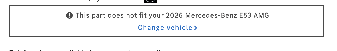

MBUSA parts seems to have a trailer hitch compatible with the 2025 E53 sedan (maybe the wagon too?)...
907-310-23-00 - Trailer Hitch 2019-2025 Mercedes-Benz | Mercedes-Benz USA Parts
Does this not work?
Does this not work?
believe that part is for a Sprinter van.

Originally Posted by geektoad
Don't know if it's for a sprinter, but it's certainly not for an E53.
The 907-310-23-00 is a genuine OEM Mercedes-Benz trailer hitch designed for 2019–2025 Mercedes-Benz vehicles, particularly Sprinter vans, and is used for rear-mounted towing. It fits models without a step bumper and typically retails for approximately $840–$1,240. It is designed for secure, high-quality towing.

Old Mar 1, 2026 | 09:44 PM
yossarian1's Avatar
Joined: Aug 2025
Posts: 145
Likes: 40
2026 E53 Wagon
Oh…nevermind…now I see that box in the middle that says it does not fit. It is strange that it came up anyways when searching for E53 parts. I mean, if it doesn’t fit, why does Mercedes show it at all…my bad. Glad y’all are part of this forum and keeping us straight…

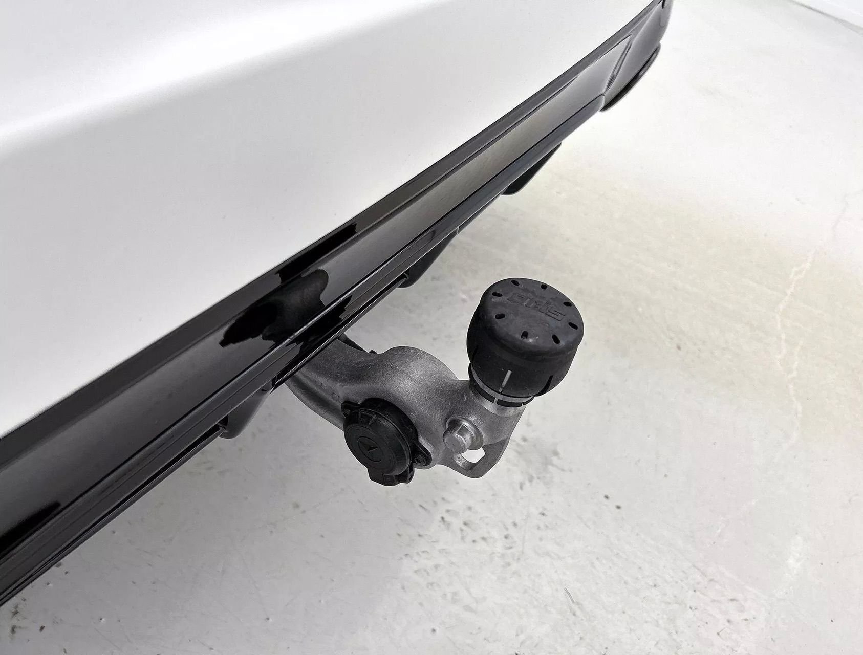

It is also unavailable in Canada. Nearly all NAR (US + Canada) cars use a 2" fixed square hitch receiver and a separate 2" hitch mount and ball. Not the more common swivel hitch found on many EU models. The only exception to this that I know of was a few Volvo models that got a semi-automatic swiveling hitch with a square receiver, specially developed for the NAR market. My sister's XC90 had it.
EU cars use a 50mm (1 7/8”) diameter ball, so US accessories won't fit. Cars with the tow hitch also have additional cooling fans and engine/transmission programming.
It probably wasn't a priority for Mercedes on these models in the US market, whereas it's almost impossible to find a car in the EU without it.
EU hitch on my car:
And then the NAR OEM on this GLE 167:
