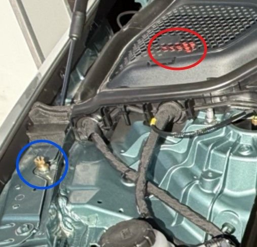

My car doesn't drive much and I'm planning to leave it unused for a month and a half.(Holiday)
I'd like to know where exactly I connect the cables of a charging device (Bosch C7 charging device. connected to electricity from one side) to the connection points in the car? for a full charge before the period of non-use.

Your owners manual should show where to connect a charger and cables for jump starting. Normally the positive terminal is under a red cover that you slide to access. The negative connection is a close-by brass color stud mounted to the chassis.

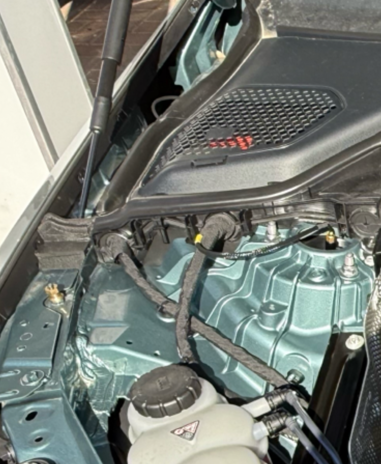

Quote: Your owners manual should show where to connect a charger and cables for jump starting. Normally the positive terminal is under a red cover that you slide to access. The negative connection is a close-by brass color stud mounted to the chassis.
The positive terminal for jump starting is under this plastic cover, quite obvious anyway how to access it. Cannot remember but I think the traditional sliding cover is under this plastic panel (I have removed the top panel permanently from my 223, needs charging so often).

Quote: The positive terminal for jump starting is under this plastic cover, quite obvious anyway how to access it. Cannot remember but I think the traditional sliding cover is under this plastic panel (I have removed the top panel permanently from my 223, needs charging so often).
Thank you.
Indeed the traditional sliding cover is under this plastic panel.
