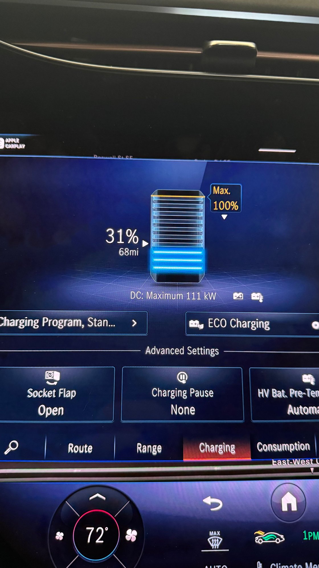

This is what the car was showing today… I’m not connected to a charger either

111 kW is pretty normal when not having a charger destination programmed in (and therefore pre-conditioning not yet deployed).
