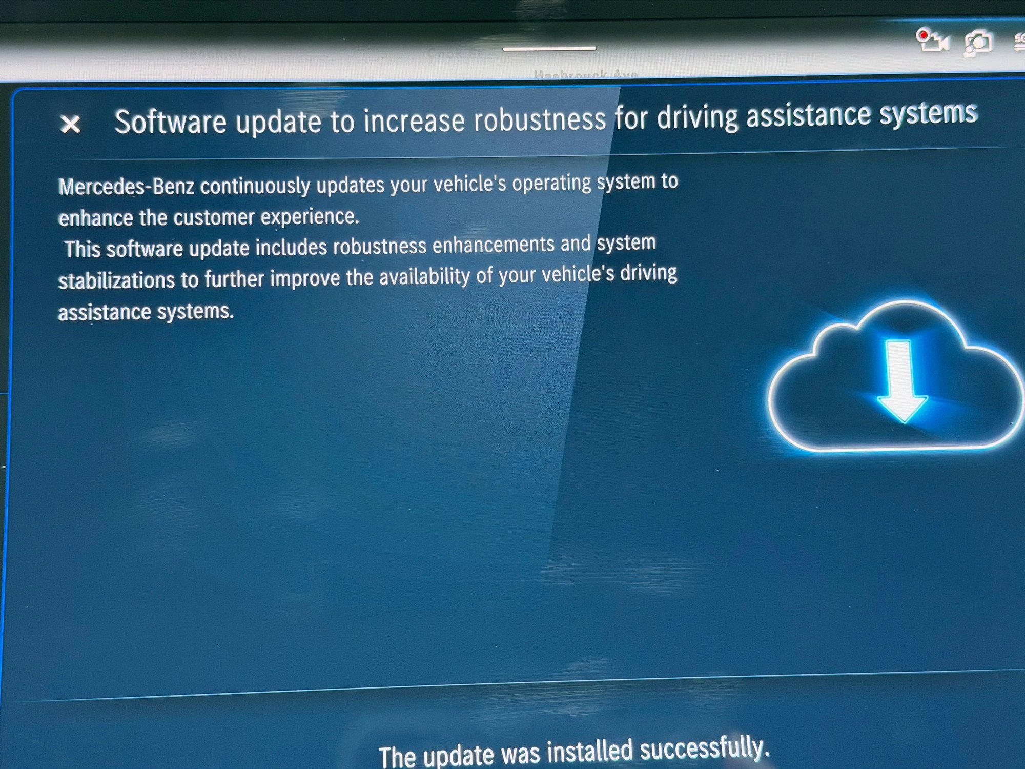

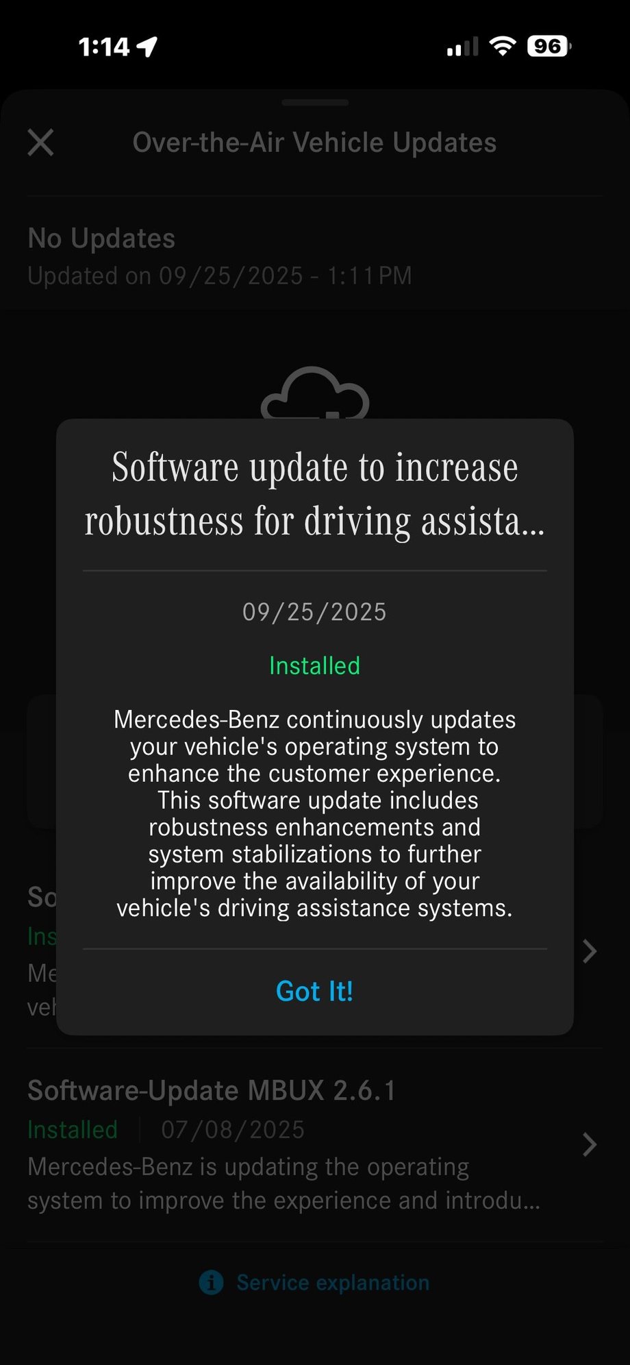

new update
Old Sep 25, 2025 | 09:55 PM
bytemaster0's Avatar
Joined: Nov 2013
Posts: 1,030
Likes: 492
From: Louisville, KY
2023 EQE350 4MATIC, 2023 EQE 350 4MATIC SUV, 2015 E250 BlueTEC 4MATIC, 1995 E300 Diesel
Originally Posted by JERSEYGUY
Nice! What model year is your car?
