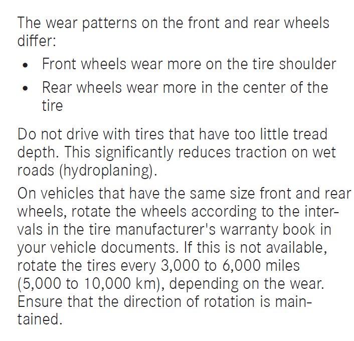

From page 441 of the owners manual:
It would appear owners with a 3rd row (staggered wheels) cannot rotate their tires based on these instructions.
