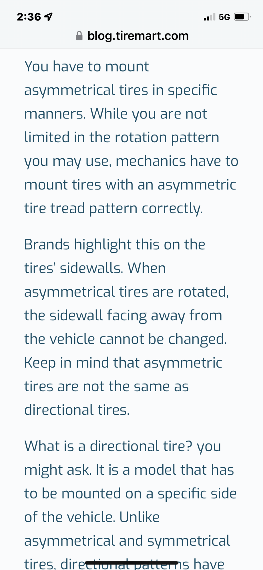

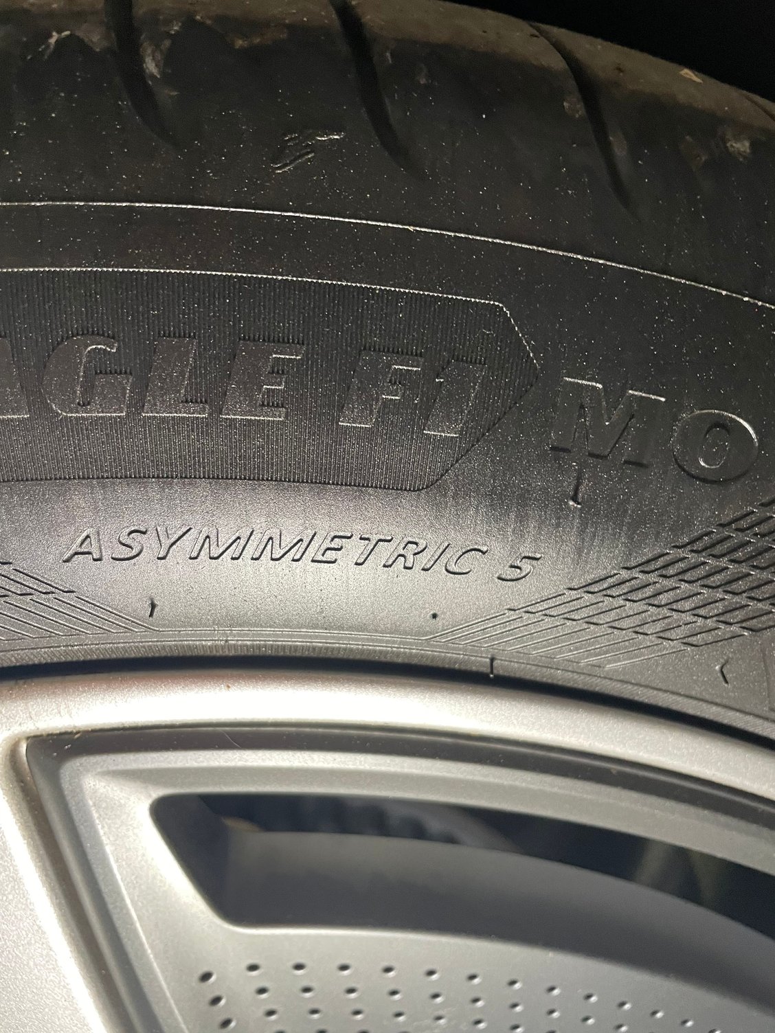

The Goodyear tires on my 580 SUV are asymmetrical meaning they can be rotated to any location as long as the outsides are always kept to the outside. I follow the expertise of the tire manufacturers, not a car company when it comes to tires.

According to Goodyear the tires on AWD vehicles should be rotated front to back and side to side in an "X" pattern.
https://www.goodyear.com.ph/learn/tire-rotation-basics
The problem with Vehicle Owner's manuals (and not just MB manuals) is I suspect that they start out as a cut-and-paste project from an existing manual. I would not be surprised to find some stuff only applicable to ICE cars in the EQS SUV manual.
