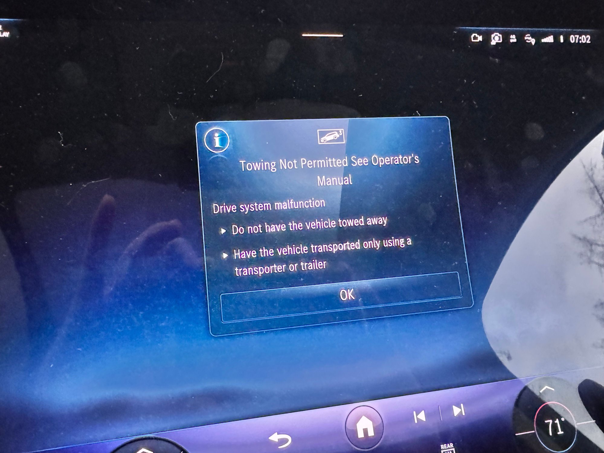

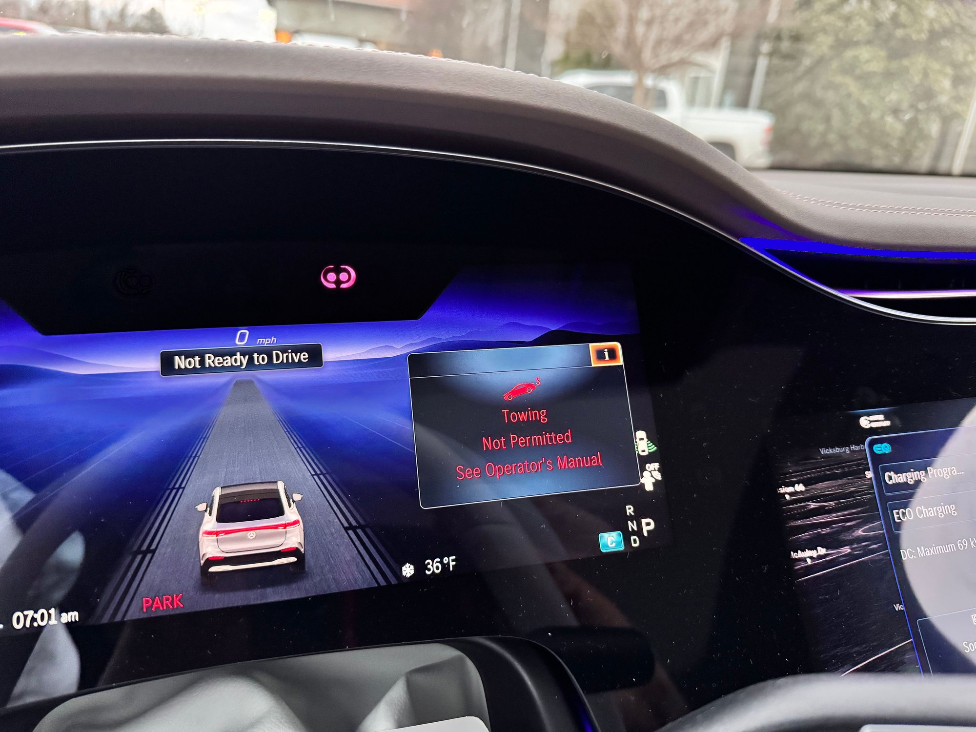

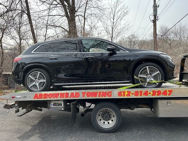

A few days ago, out of the blue moon without warning, my EQS poped these warnings (see pics): RED "Malfunction" & "Towing Not Permitted" and nothing I could do to start my SUV... DEAD on my driveway. I contacted my dealer/service department, of course, Service Adviser to call MB Roadside Assistant. Got the SUV to the dealer and so far we are waiting for Germany engineers who will look at the SUV's historical data to determine the root cause of this malfunction. At the mean time, I am driving a GLC350e PHEV loaner.
https://cimg4.ibsrv.net/gimg/www.mbw...09bde75462.jpg
https://cimg5.ibsrv.net/gimg/www.mbw...0eed110e8b.jpg
https://cimg7.ibsrv.net/gimg/www.mbw...f23fb06143.jpg

Dec 5, 2024 | 07:04 PM
Update: SA just update status of EQS and it will get a new pack of battery shipping from Germany ETA of 2 weeks. At the mean time, I am keeping the PHEV GLC350e to drive. Just FYI, So far, I like it for the purpose of PHEV and driving around local mostly EL mode; Hybrid on hwy switching between Gas and Battery automatically as power demanded. Confirming the sound of the engine is not pleasant but it's smooth operation gas/battery seamlessly though. For gas savings purposes, it's definitely saving some gas if it's plugged in overnight at home and at work. The 1st 20-30 miles it may consume 10%-20% of gas, mostly on EL... and battery level drops almost empty 0%... then It's a gas only vehicle and the gas meter going down really quick. I will update with the new battery once it's installed.

Jan 5, 2025 | 10:50 PM
Update: Xmas gift to me a New battery pack installed. Everything is back. Wish me luck on the new battery.

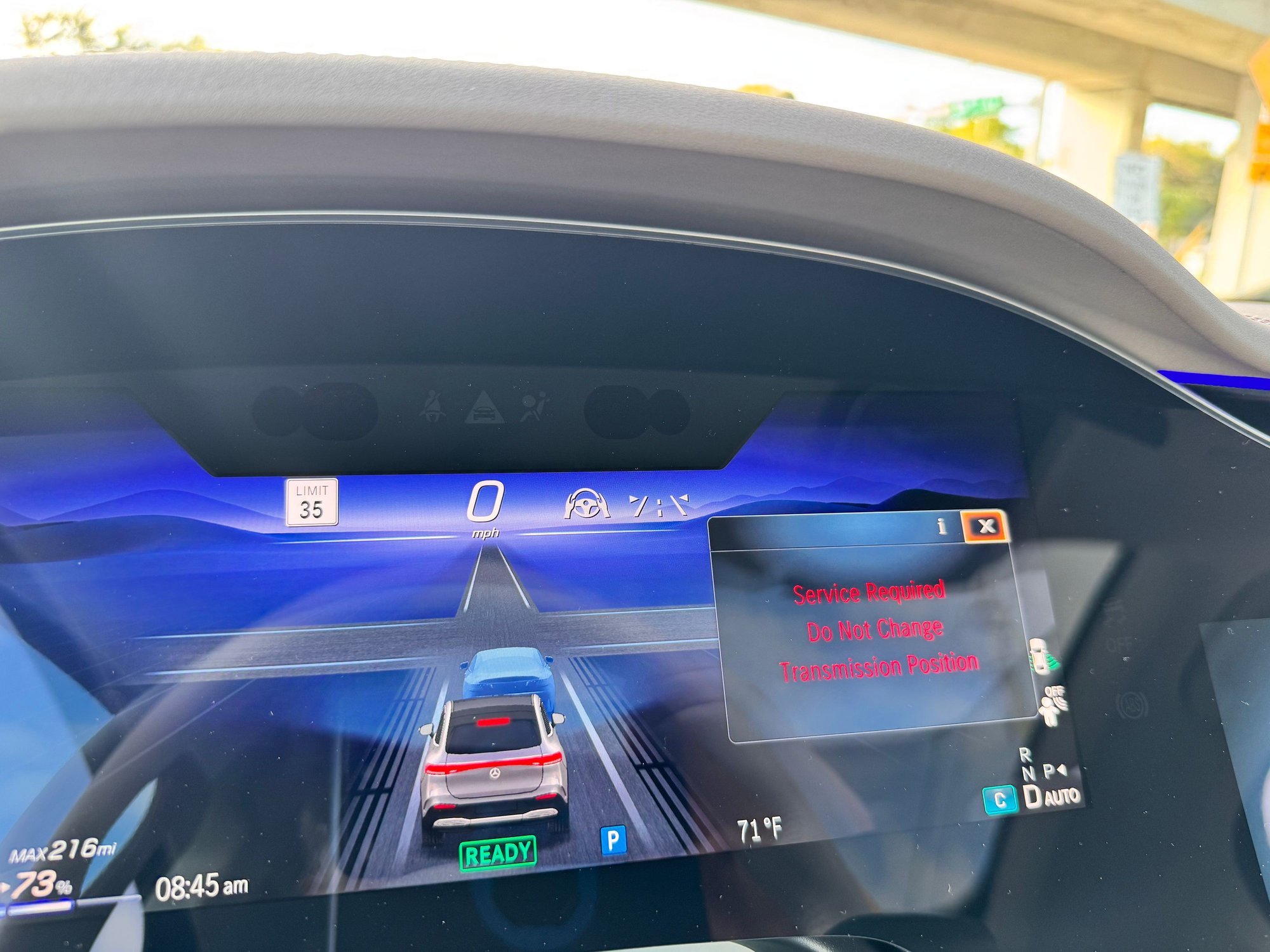

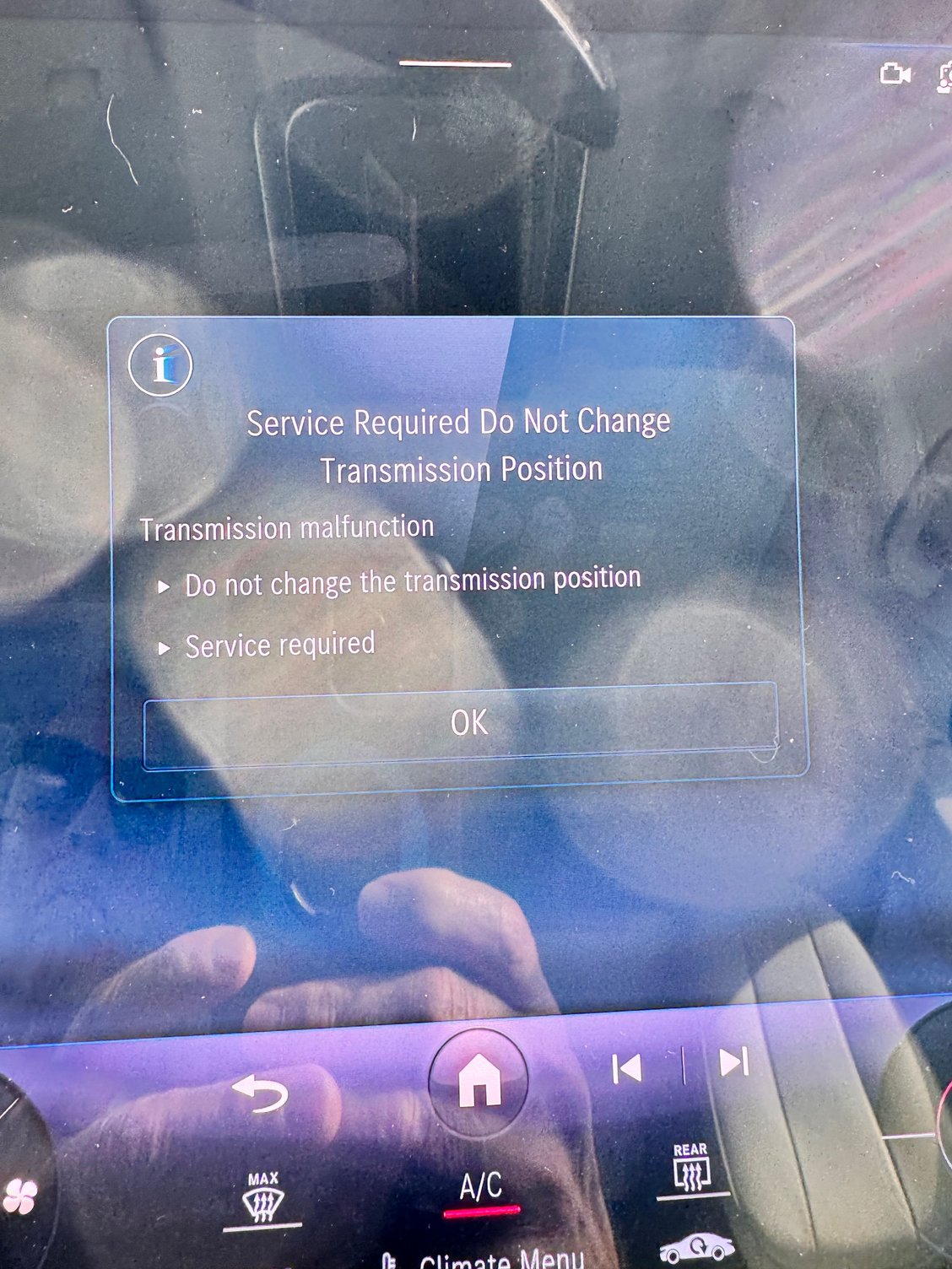

So, the saga continues. I left Miami for the return road trip to Texas on Saturday morning. I made it as far as Vicksburg, where I overnighted. At 7am, I got in the car to hit the road for the final leg home, and got the malfunction messages below. I tried rebooting, locking the car with the key fob three times, and walking away for 5 minutes. Didn’t work. Had to schedule a tow to Shreveport, and MB gave me a Lyft to Longview. Car is at dealership again, twice in a week. I still love driving the car, and the user experience is usually top notch. I hope this gets all sorted. It’s my 2nd EV, first was ‘22 Mach e GTPE… never had to have it towed…
Fault message.
Fault message.
fault message
fault message

Resolved
Hi, yes was resolved. Tried remotely to reboot the system. But didn’t work. Had to call for a tow. The dealership had to install software updates. My car, before I bought it, had not been driven or updated for over a year I imagine and was way behind on updates. I’ll upload description of updates done in a couple of days. Good luck! I still love the car.
